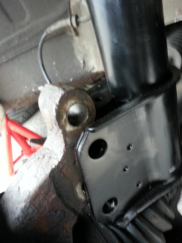

I've swapped over my front suspension damper so that is in place (so to speak) but the 2 bolts/holes whereby the brake and hub, etc fit onto the damper is proving a total b**ch to line up...
Any hints/tips greatly appreciated!

Get one person to lever the hub down, whilst person two pulls at the shock and gets one bolt in. Once one is in, you're fine. It's better to do one than the other but I can't remember which way, sorry.
Also, make sure the top mount isn't tight tight, or it'll be a pig.
As Rob Said. Put some weight on the wishbone/hub. You're basically fighting the ARB.
Get one bolt through and then push/pull the hub to line the second one up.
lift the bottom of the suspension arm up and slot thehub bit into it, if you get the bottom bolt in first the top one is a piece of p*ss lol
but the top one makes it a b**ch to put the bottom one in if you try putting that in first if that makes sense....
basically wiggle it about until you get the bottom one through, then do the top bolt

Wrong. That'd make it further away.
Use a ratchet strap/rope or something similar that can be removed when the bolts are in. Put it round the wishbone in a loop and stand or kneel on it to pull the hub down.
Make sure the cars jacked up both sides too as you will just fight a loosing battle against the ARB.
Ah...idiot boy was jacking it up on one side!
Make sure both sides are jacked up first that'll make it a lot easier.
Then just give it a few good pushes down and have a bolt ready to go in.

I usually wedge a screwdriver through on hole and prize it until one hole lines up then fire the bolt through.
Cheers guys...will need 2nd pair of hands I think to cover it...as can't pull hub down AND manipulate the holes for the bolts to go in...
If you're really struggling, stand on the hub with one foot, and stick a thin screwdriver in the hole when it's close. It's a lot easier than getting the bolt in and you should be able to lever it from there.
Why has no one mentioned a dose of mtfu yet?!
If its still a struggle a lever bar (or say a trolley jack handle) over the arb and under the wishbone will allow you to lever the hub down a little bit.
screwdriver trick works wonders but its not that easy, as in use a bit of force. Can be done by one person but having an extra pair of hands helps. Word of warning if its the passenger side - be careful you dont pull the driveshaft out of the seal on the box as it rotates inside the end of the seal itself. I've done that before and lost my gearbox oil and had to do an emergency run to the motorfactors to top up. Getting it back in can be a pain too
Have you only jacked one side up?
If you have you'll never do it because the ARB will be pushing that arm up to match the compressed other side
Get 2 axel stands and get both sides in the air

It was up on one side...I've put it up on both sides, but still can't get it aligned properly...so waiting for pair of hands later on to give me a help...that and brute force!

I didnt know you'd be available mate. Was doing it on my own...then got another pair of hands and done it in 10 mins...
Brute force, ignorance and a bit of luck and its all sorted...pmsl :)
