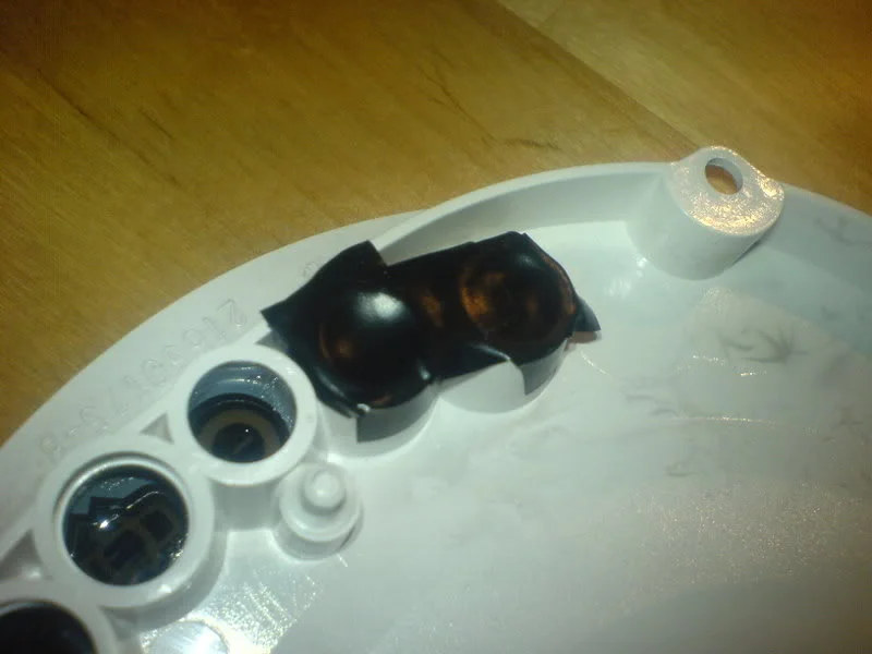

^^^^^ Nothing was "chopped" the recess was covered blocking the light!!!^^^
You may be a lucky one if you got all the resistors to work!

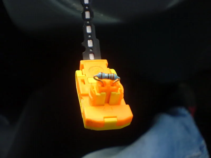

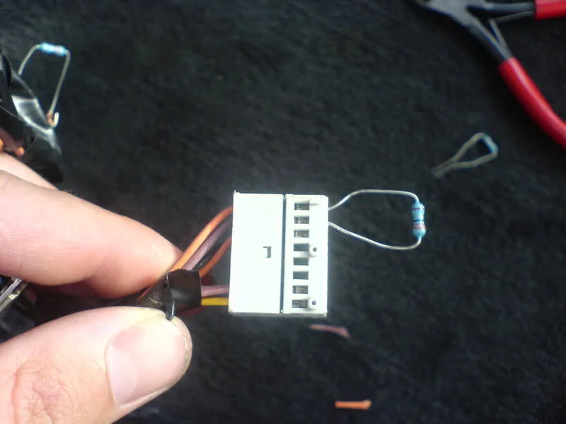

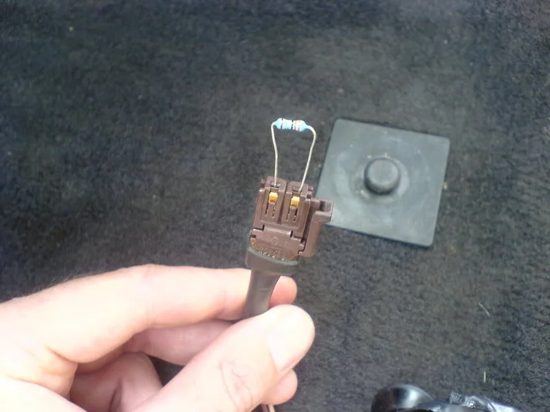

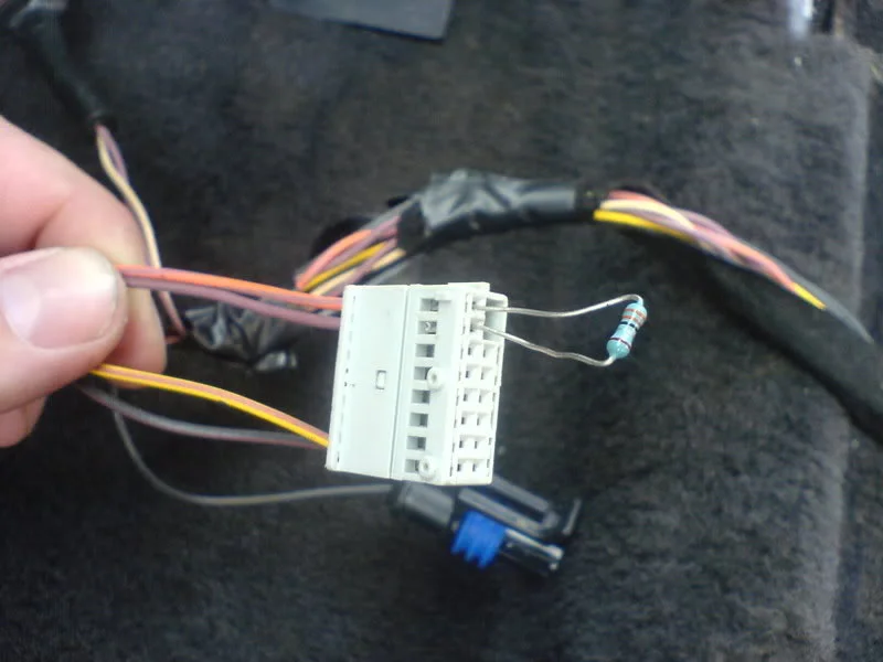

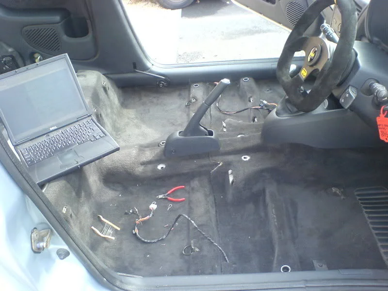

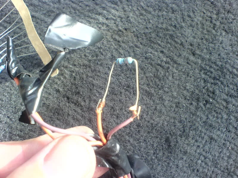

I fitted 3.3ohm resistors to all relevant pins in the the whole car [done following edde's notes] and got all of them working including the pretentioners, and seatbelt circuits, except for my drivers airbag - hence tape over the recess in the display.

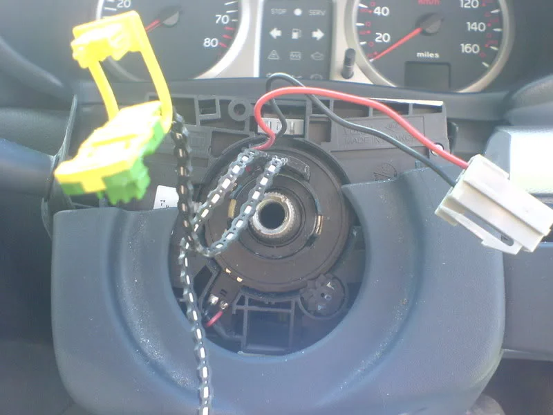

http://renaultsport-clio.blogspot.com/2006/09/omp-superquadro-steering-wheel-fitted.html#links
Some pics:-

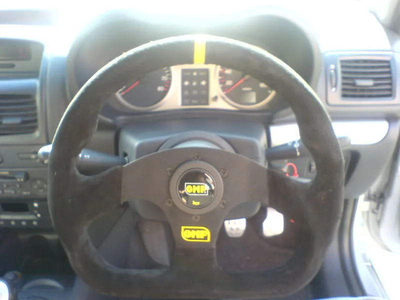

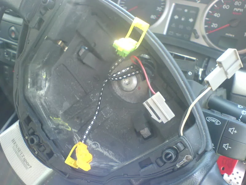

Wheel:-
Here is one of the 2 x airbag connectors - they connect to a main connector which I tried the resistors in and they still didnt work!
Seats:-

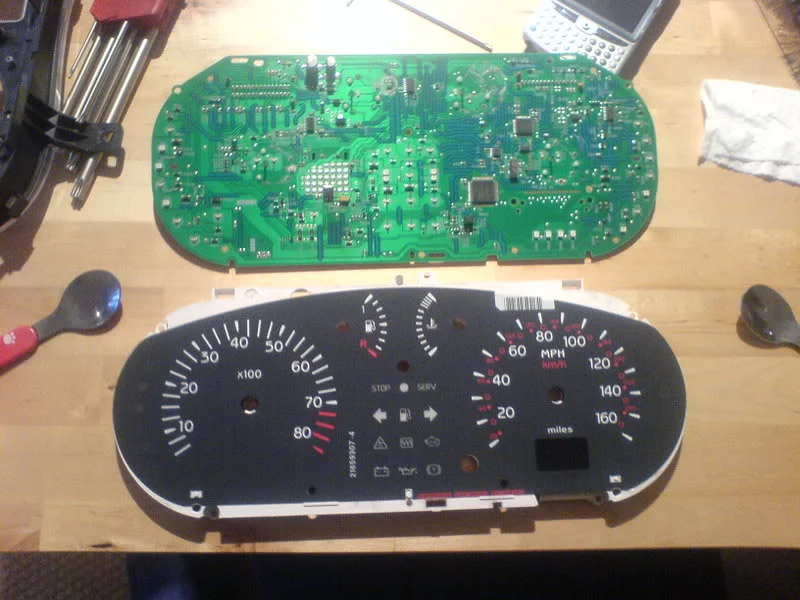

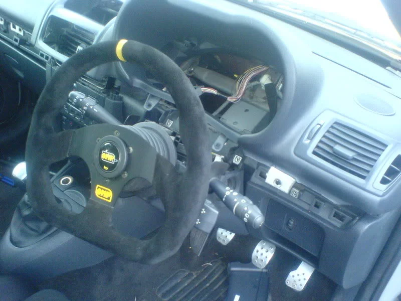

It took me the first time about 1h 30mins and thats not knowing where the screws, clips, or how to do any of it!
2nd time took me about 30 mins if that.
I knew my speedo was about 5-10mph because It just seemed wrong! So I plugged in my Tomtom and snooper S4 to find out exactly how 'out' I was! I then readjusted it [by taking the dash off again! Doh] and measured it against Snooper S4.
You will be fine if you mark out where your dials point to when in standby mode [I didnt!]
