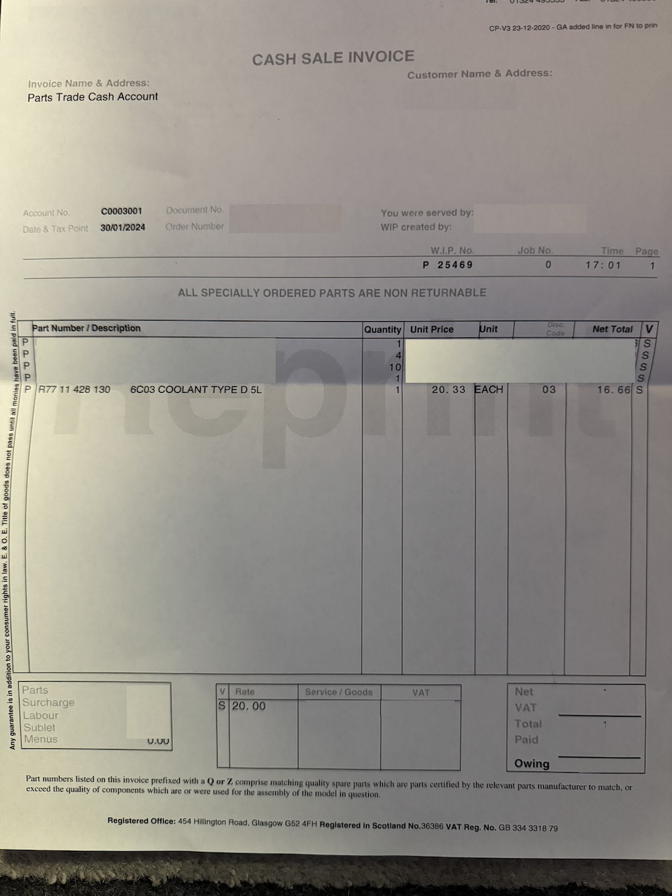

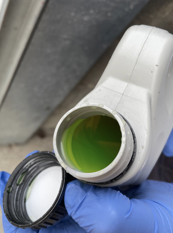

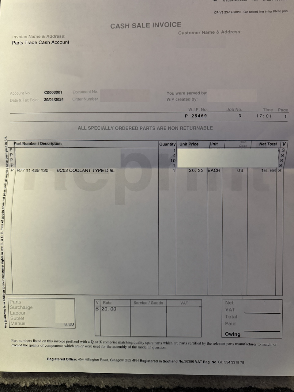

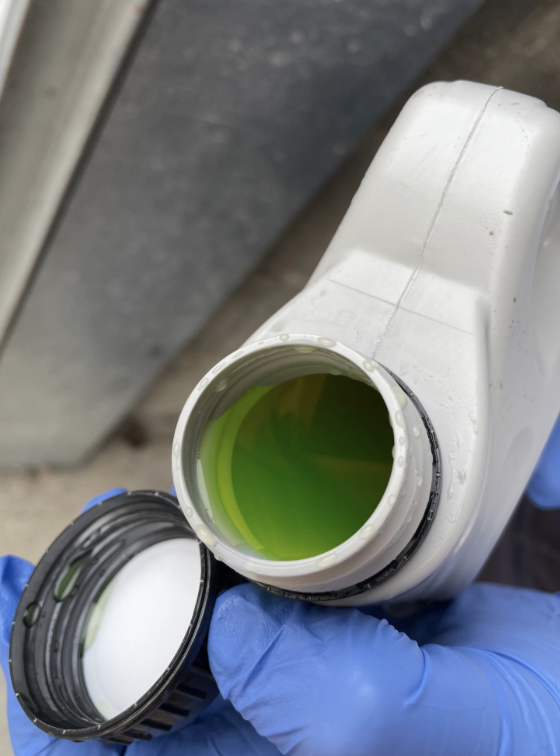

Utter W**K as I bought 5L of Genuine Renault Type D today

I called up my local Renault dealer and they said type e is the new type d you can mix it no issues, they said any type d on the shelf will be old stock @MarcB whats the date on that bottle?

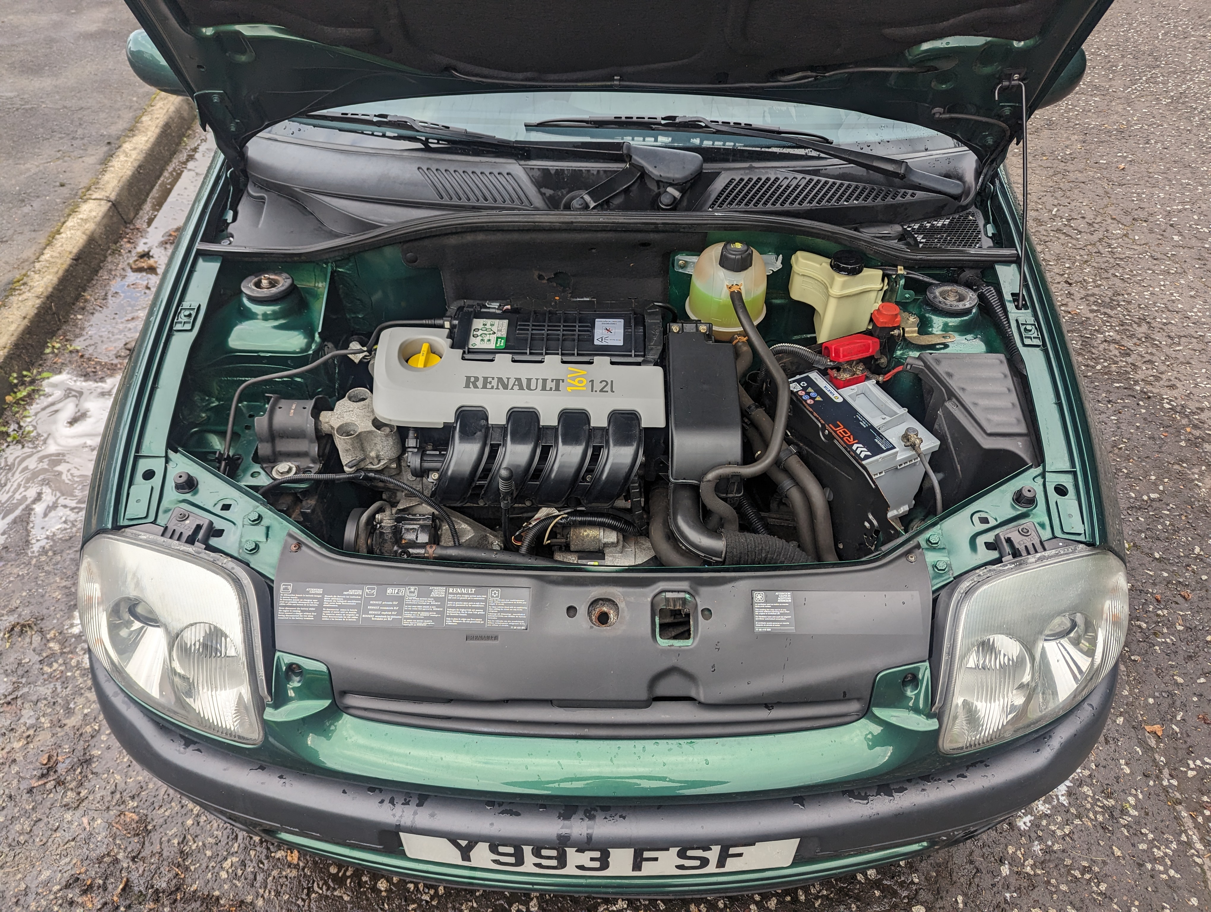

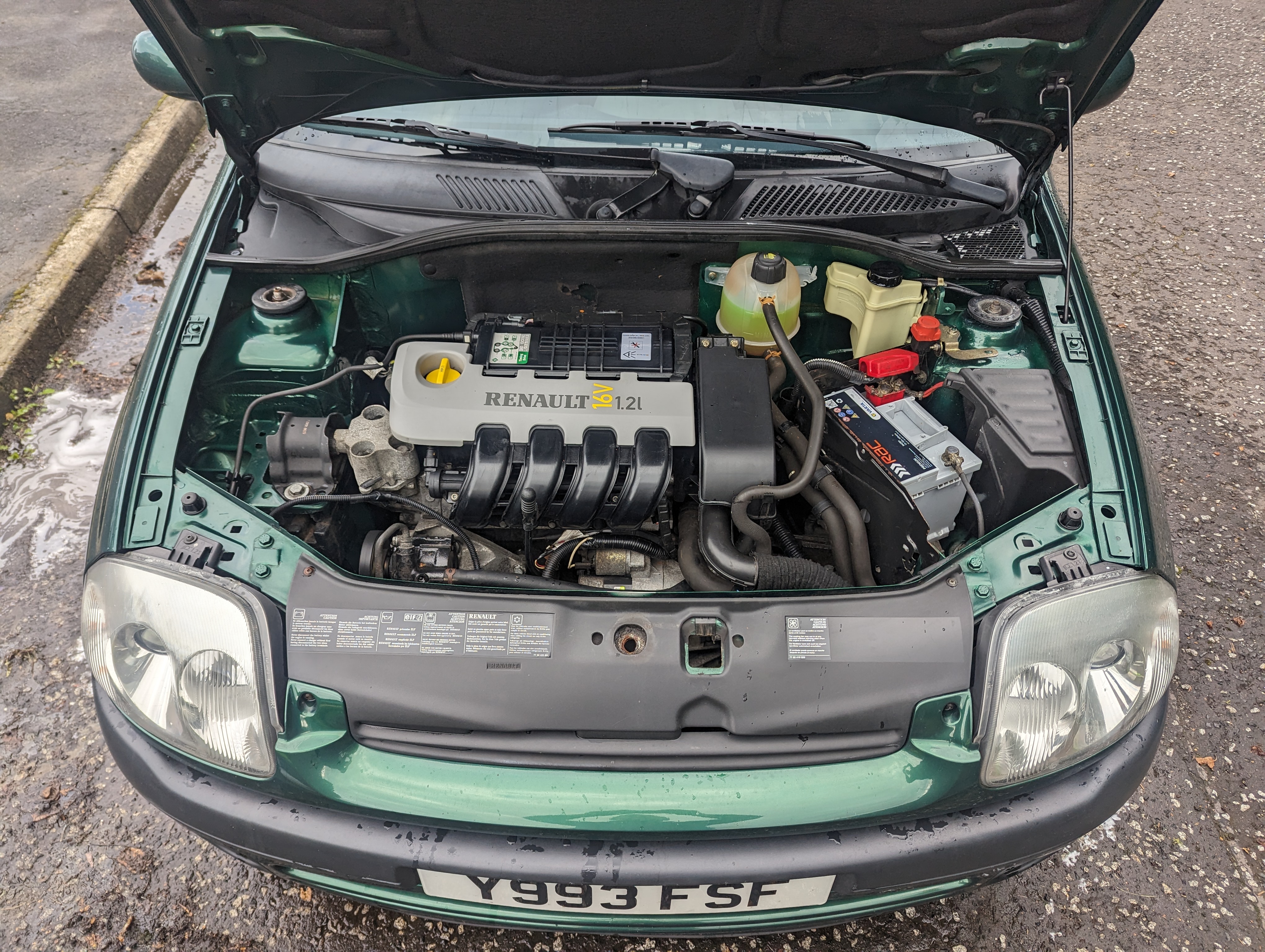

my 1.2 Sport had orange stuff in it when i got it, i flushed it all out, new water pump, expansion bottle, new radiator, flushed out the matrix etc, filled it with fresh type D, few heat cylces later its got an orange tinge to it, drained it all again, flushed it all again, another 5l of fresh type D, its now got a slightly less orange tint to it! its not getting done again!
even the new bottle is stained from the orange condensation!!

if you run it with distilled water for a bit it should get it all, maybe have to do it twice.

Oh yeah look at that, it’s almost like it’s given off orange fumes.

* UPDATE *
Just spoke with my Renault man and he has just went to Renault Uk Technical and YES Renault are 100% stopping Type D coolant and changing to Type E LDR.
Luckily my Renault parts guy has well over 250 bottles of Type D coolant to move before he needs to use the new Type E LDR and he had said that he only uses a couple of bottles a month in the workshop.
I Have just managed to buy a decent amount at a good price so I will be sorted for the next couple of years.

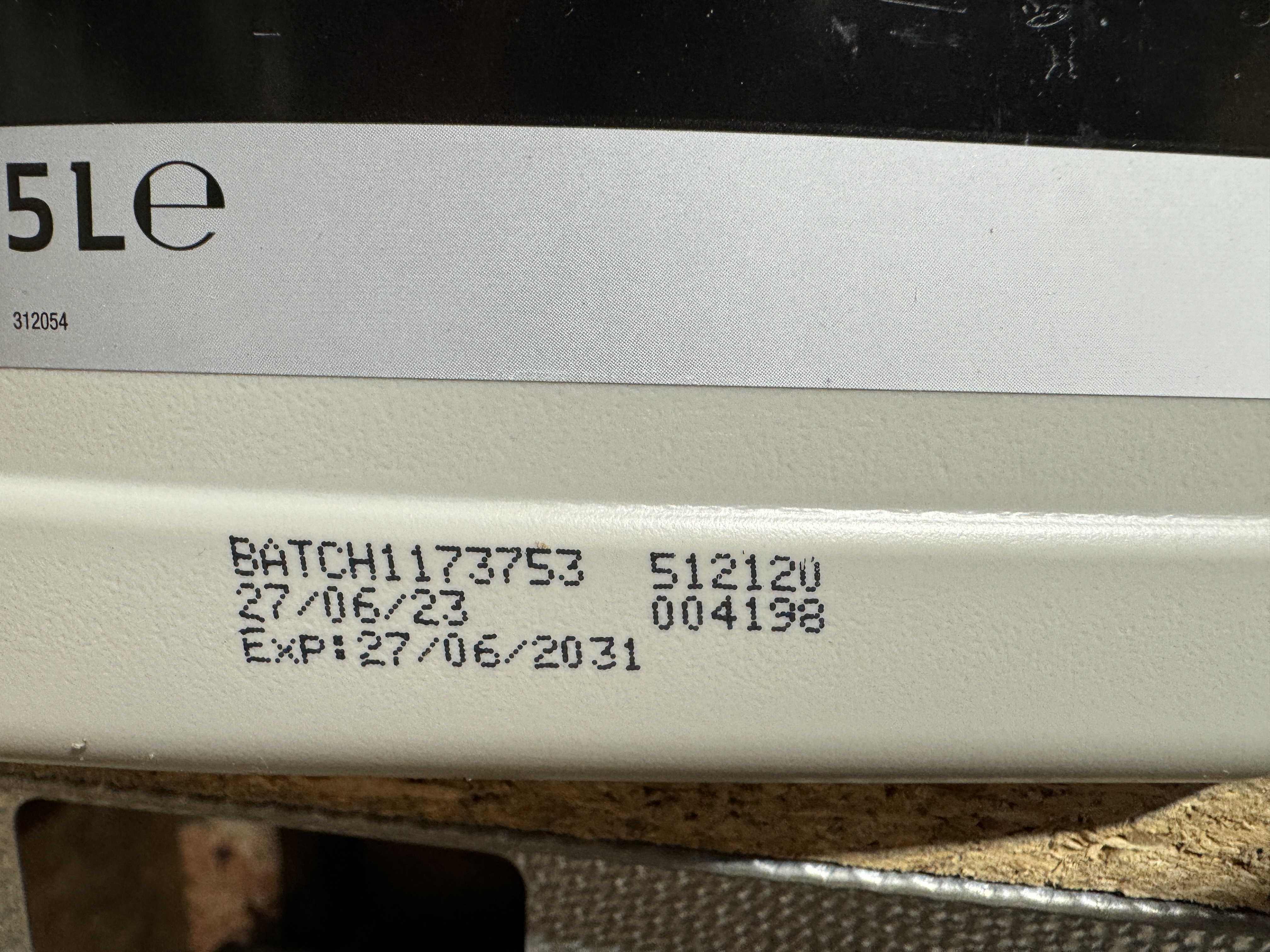

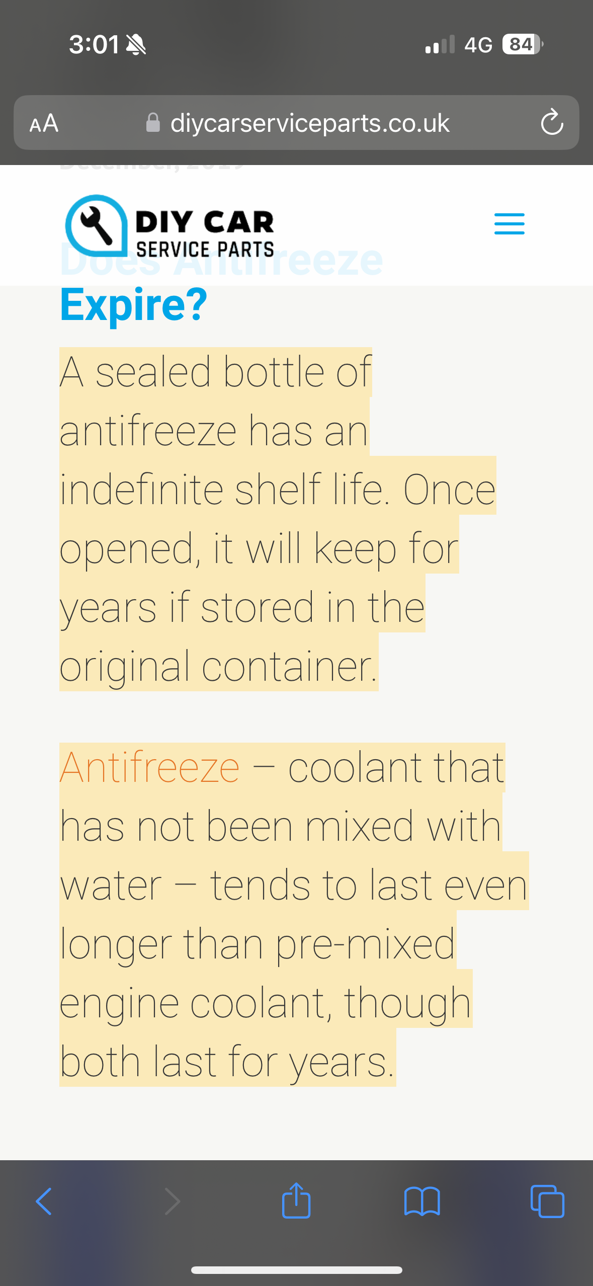

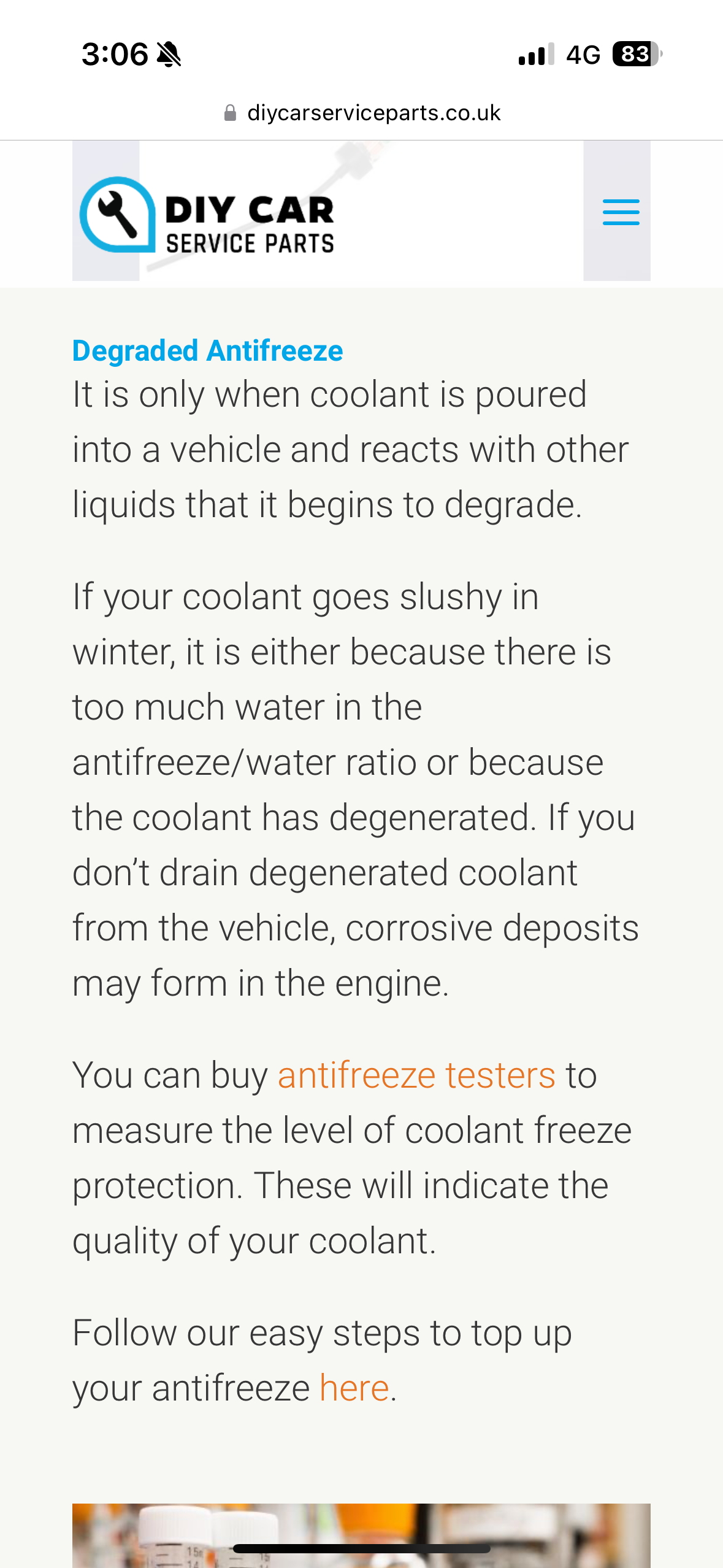

Would coolant degrade if you stocked years of it up?
There is a shelf life on it but I think it’s a long long time.
Think of the stock that’s sitting in Renault Uk warehouse and then the dealers that’s been there for possibly months so yeah it will hold but I would not want to be using coolant that’s sat for over 10 years 😂😂
MarcB
  Too Many
Check your bottles as the production date and exp date are on them.
It’s on the front of the bottle at the bottom

I have a bottle that I have had since 2017 and the EXP on it is 2026 so still have 3 years to use it.
I have managed to get myself a few bottles as with every major service I normally get a coolant flush on my cars and it won't go wrong.
I would rather have 10 bottles that last me 8/9 years or none at all.
