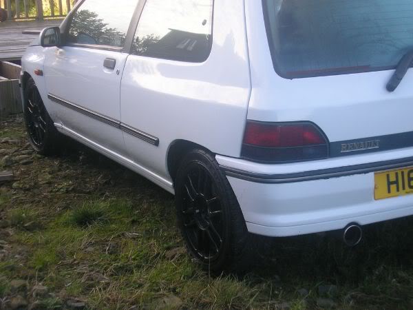

Going to look at this tomorrow...
Car  RB 182
Its a 1.8 16v on a K plate, but private reg, 72k on the clock. No tax or MOT, and it needs a clutch, but no problem because im a mechanic! Gonna put it on a ramp first though, because the only thing that'd put me off is if it was rotten!
He wants £400 for it, good deal? What are these like, will i be impressed?

Well i bought it, got it for £300 as its stuck in 3rd. Im sure its not a clutch problem, the gearstick will move into other gears, but the actual box is still in 3rd, which makes me think its a linkage problem. Also, the fan is in the boot lol, and i had a quick look but couldnt see and fixings for puttin it back where it should be! Any help?!
Might just want a set of gearcables then - or adjusting if possible
Get down the scrappy mate for the frame that the fan sits on if you need it.
