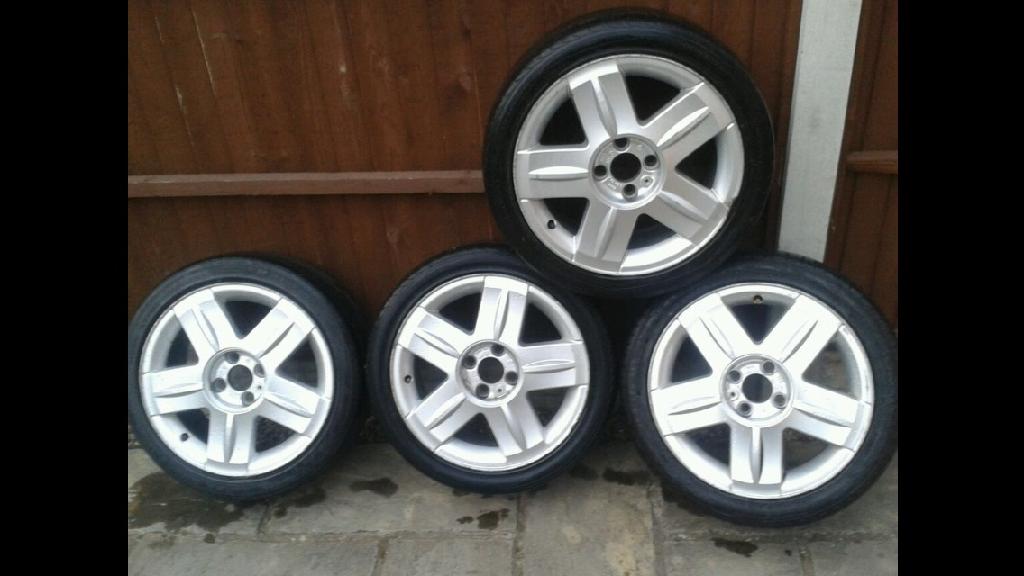

Just ordered 4x t1-r's, brakes next... I think I'm going with brembo hc disc's + ferodo ds2500 (upfront). standard rear disc's with matching ferodo rear pads. Probably best she has a fluid change aswell, This all being dependant on my visit to mick Monday. Gotta make sure she's worth the cash
  182/RS2/ Turbo/Mk1
Would just put standard pads in the rear. Ds2500 are fairly quick to react but do still need more hear than standards and the rears on these cars generate very little heat at all.
  Clio 172
In which case you've just saved me £50, thanks again chip
