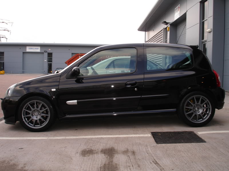

raising mine
I went for a compromise between handling and sensible height for the use I give the car (often over uneven/unsurfaced tracks while MTBing) and ended up with this:
Clio%20on%20coilovers%2030-08-06
Heights (measured from ground to top of wheelarch, through centre of wheel):
Front: 600mm
Rear: 605mm
and had camber and toe-in set up accordingly. Handling is brilliant, only problem is slight rubbing occasionally, and a fooking rattle from the rear of the car - think it's the springs where they mount onto the platforms (metal-to-metal). IS that a normal noise?

shouldn't have any rattling, you should have a rubber 'cushion' on the car side of where the spring mounts. If your running coilovers, the bottom of the springs just sit on the adjusters

Yep, I've got the rubbers between the car and spring at the top. The rattle is - I think - coming from where the bottom of the spring sits on the adjusting platform. Hard to identify exactly where it's coming from - anyone with any other suggestions? Definately from the coilovers at the rear anyway, rattle only appeared since fitting about 4 weeks ago.

platforms wound down fully at the back? ie, not loose rattling around?

Sounds like the exhaust knocking/ rattling on the rear axle, as when lowered it gets closer to it...
Maybe??
Nah, standard exhaust and it's not that sort of noise. Thanks for the idea though. It's definately from the platform/spring interface judging by the "tone" of the rattle, if you know what I mean!
