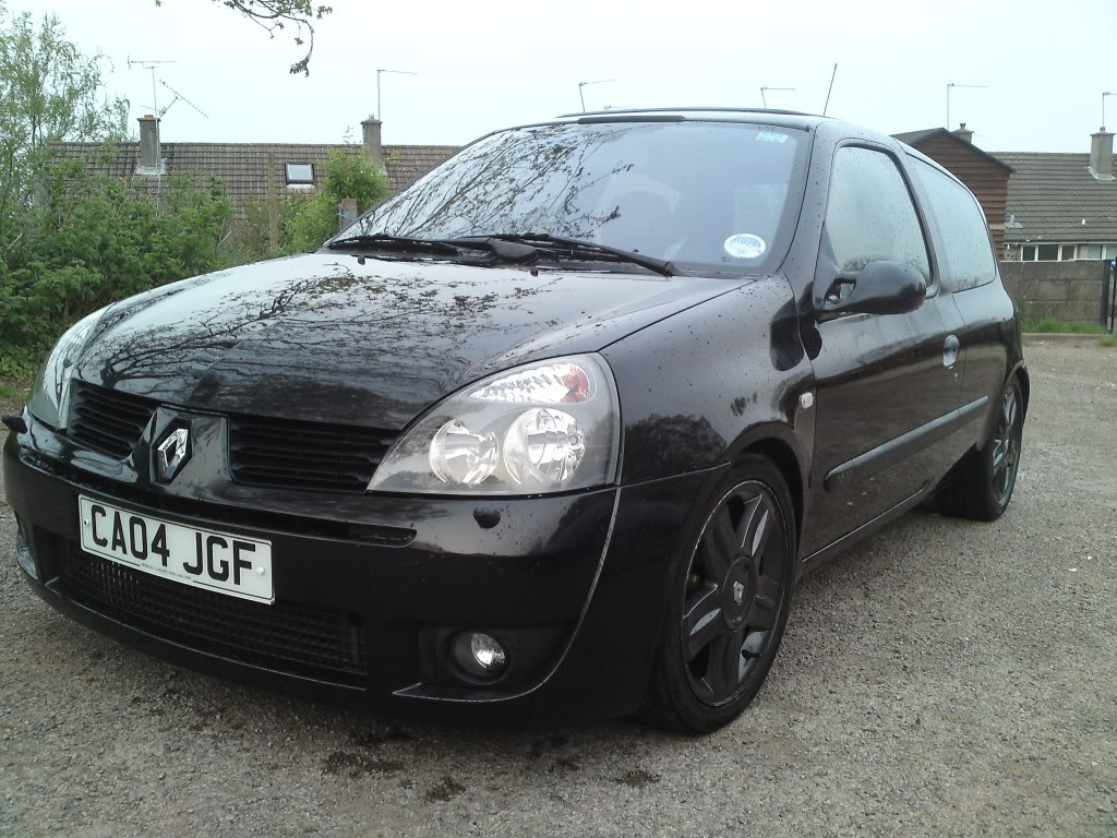

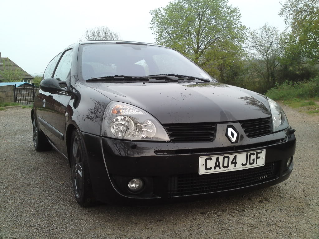

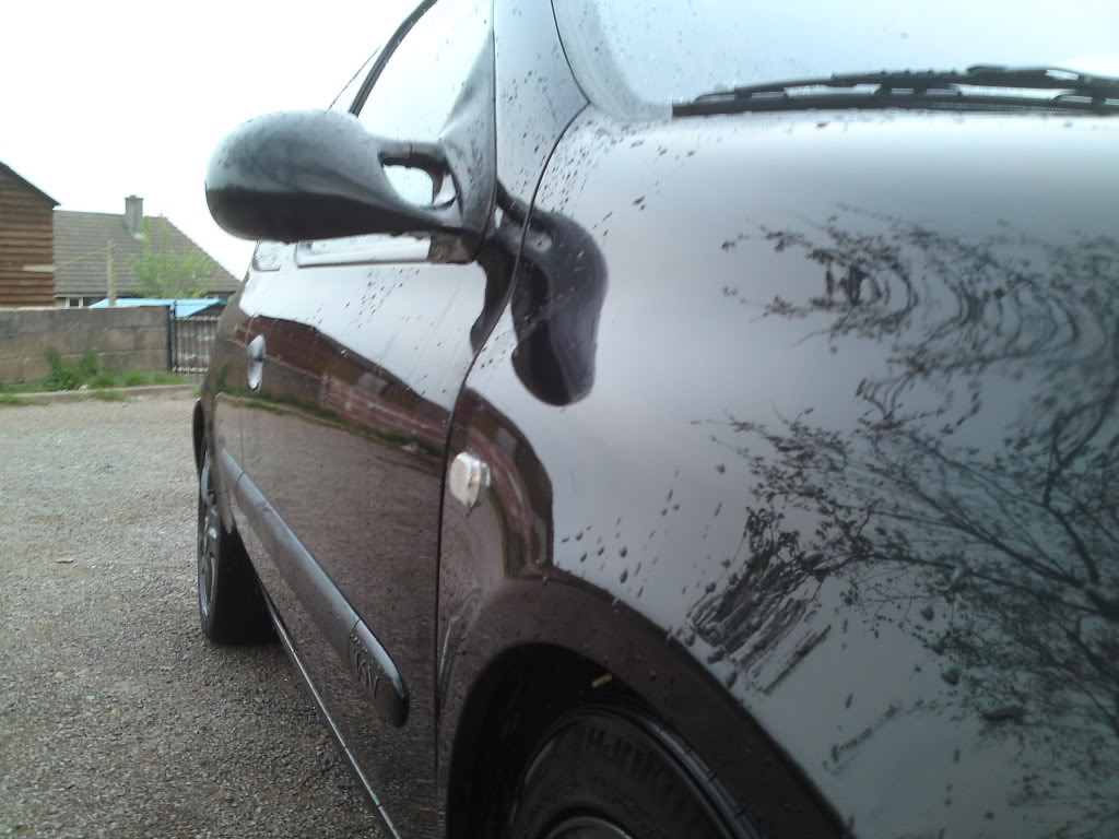

Started the detail today, first began with a wash using the two bucket method, I then clayed the car and washed it again.
I didn't start 'til late, so started to run out of light at this point, and decided to call it a day. Will do the rest tomorrow.
I couldn't believe the difference in the feel of the paintwork after it had been clayed, or how much it shined, and it hasn't even been polished yet!!
Video: (listen to the difference in noise) The first bit is the back of the car that has not been clayed, then it's the side of the car which has already been done.
http://s596.photobucket.com/albums/tt50/jujuju3004/?action=view&current=V230409_1750.flv
Some piccys:
