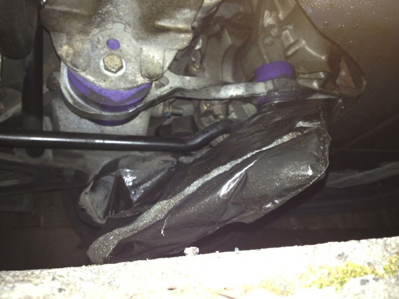

So I picked up my first 172 Cup today - 2003, 59k on the clock. Driving it home I've noticed a few more things I didn't spot on the test drive - don't think it's anything major, just not entirely sure what they are. Here's the list:
1 - What is the purpose of this? Is it important or is it simply a little cover to protect something? It fell down during the drive home.
2 - Possibly related to the dogbone but not sure - my girlfriend was following me home and she said that at some point on the motorway she noticed what appeared to be a small purple ball-looking thing bounce away from under my car. She doesn't know if it came from my car, or if I just ran over something. Any ideas?

1. Looks like the insulation they put inside the undertray.
2. No idea!

Yeah that's the insulation, mines looking equally as knackered! But looks like yours is hanging off much more.
And yeah as said the 4k rattle is your noise. Not the cat, most likely the centre silencer. Replaced my exhaust cat back and it's cured the problem.
