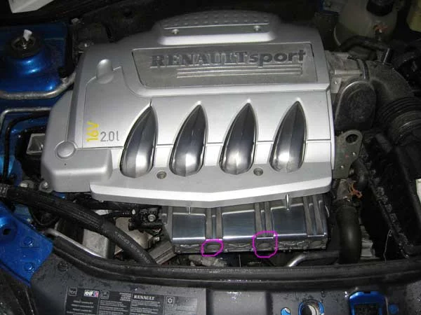

Hi mate, very shiny. Due to you polishing what i think u have called the fuel rail protector (5th picture) i think your the right man to ask. how is this fitted becuase mine has come lose and is constanly rattling when driving. Hope u will be able to help.
1 10mm nut down each of these
use a socket, small extension, and small ratchet to get in there.
