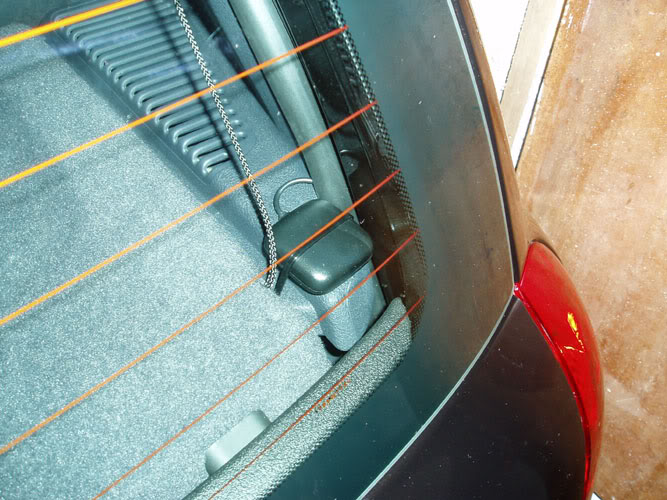

Wanted to avoid additional cables and clutter. Nothing worse than turning the dash of your 182 into a maze of cables! This was my choice option if the "trick" didn't work.
How did you mount the additional antenna? In the square patch on the windscreen or some other place?
KnightAzul
Not got GPS but my Road Angel one is here
Wire runs down back of the dash, under the door rubbers etc along the drivers side sill, to the rear parcel shelf. All nice and tidy.
