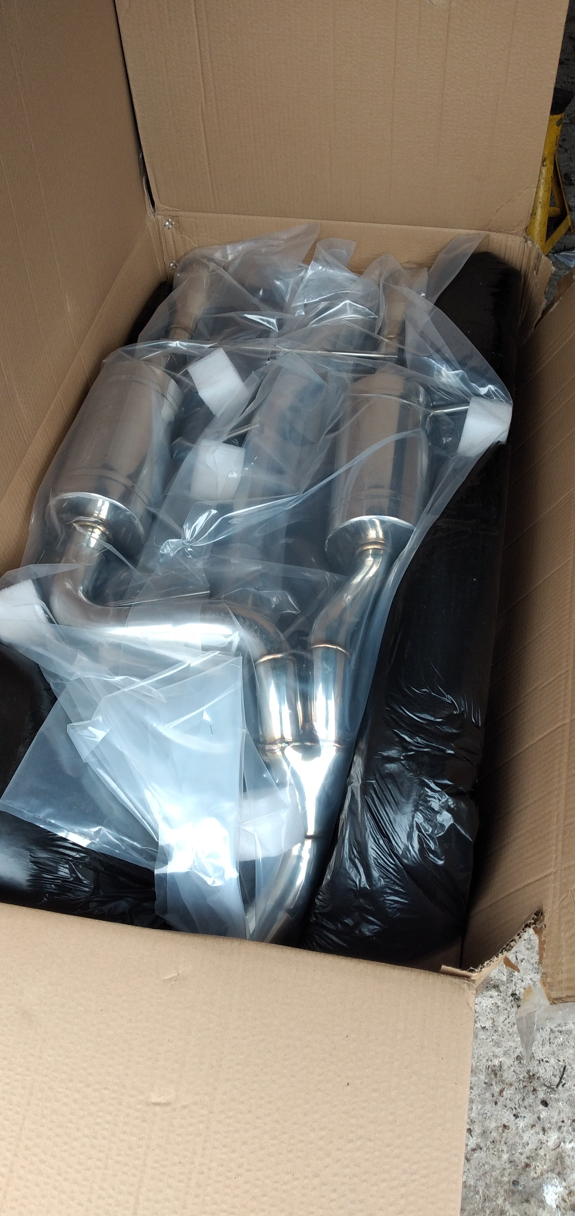

I ordered a Gravity Performance cat-back system for the 182 on Tuesday and it arrived today.
It was well packed, and certainly looks decent quality.
The whole thing weighs 11kg. I don't think there will be much weight saving, but maybe 1kg or so. I'll report on that once I get the current one off and weighed.
Price-wise it looks really good value, £270 all-in, delivered.
I will fit it at the weekend, so will be able to report on 'fittability'

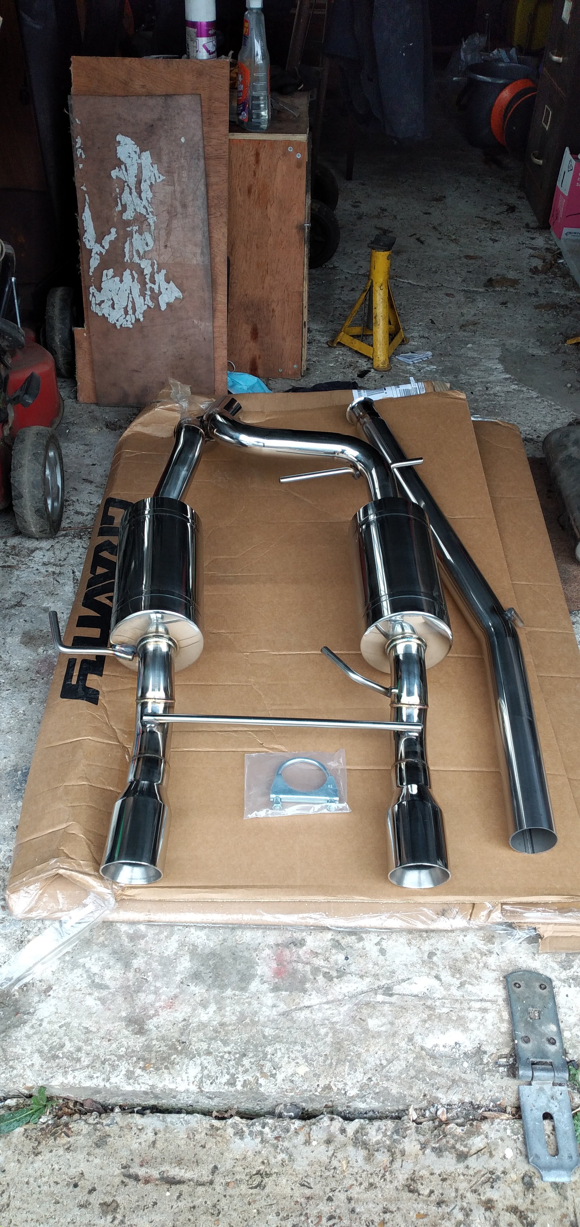

Simple to fit, all the hanger positions are all present and correct.
Only comment on the fit is the tailpipes are a touch closer together than they should be.
Also I haven't put the rear wheels back on the ground yet, so can't tell exactly how it will sit.
So to the main concern, the NOISE!!!!!
Actually it's not too bad, but could be a bit close for some track days.
Used two different noise meters and got 99 and 101dB at 5500rpm. I'm not sure which is more accurate so will have to say 100dB until I can do some more tests.
Race 105dB so no problem
Brands Hatch track days generally 102dB, so should be ok.
Lydden Hill track day 100dB, so maybe a bit too close for comfort.

Good news....... the Gravity exhaust passed the 100dB static test by quite a margin, and didn't trigger the 92dB drive by.
Also had a few 'car sounds great' comments from other drivers on yesterday's track day.
I can only report from inside the car: it sounds RASPY rather than BOOMY. I'm pretty sure this is F1 technical exhaust rating terminology!
Raspy is quite good as it penetrates your helmet (no inyourendo intended), and helps you drive by the sound rather than the rev counter. It almost immediately reports your throttle inputs, which is an audible giveaway to my multiple stabs at the throttle out of a corner, rather than the smooth laying down of power.
I don't think anyone would want this on their daily commute, but for a track car looking for a decent free flowing exhaust at a bargain price it might be worth a look.
