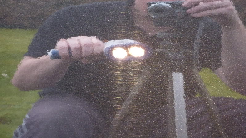

Aim of the day here was to give this Dodge Caliber a bit of love. It was an ex demo car, so had been a little neglected wash wise, and was covered in swirls and holograms, which were seriously robbing the car of its potential finish wise.

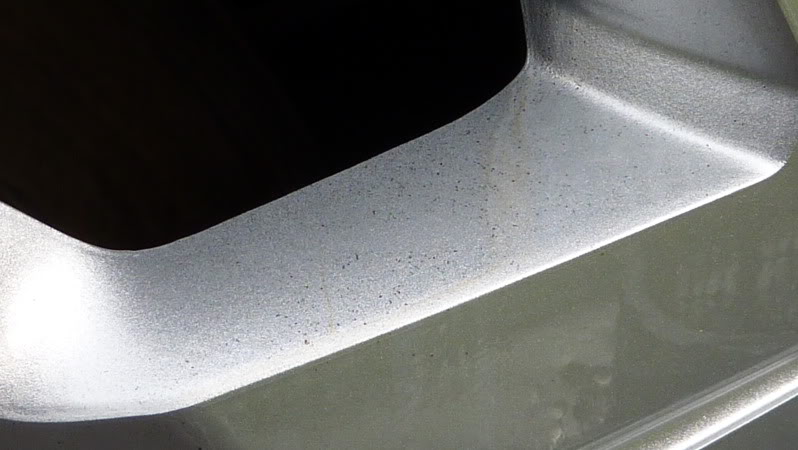

I was surprised at the amount of tar of the wheels, so I used Tardis to shift this:
However, it was still suffering from what I assume is brake dust pitting, something which I wasn't able to deal with on the day

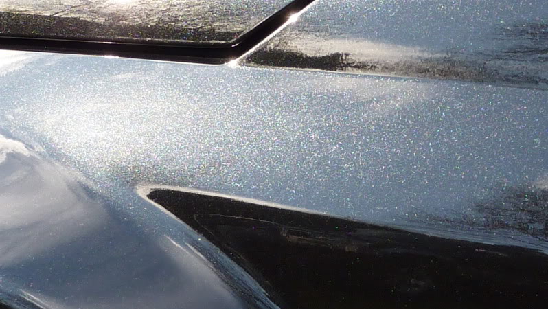

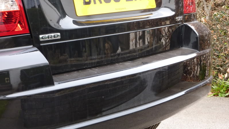

It showed an average of 200 microns very consistently all over. I knew that the paint was relatively soft, so I decided to try Lime Prime via Rotary on a 3M polishing pad first.
Before:
To this!!
Not bad for a paint cleanser! I upped my pressure a little for the following passes, and achieved about 95% correction, with only a couple of deeper scratches remaining (as you can see in the pics)

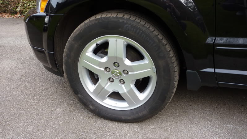

- Planet Polish WS&S on the wheels
- Pinnacle Onyx on the tyres

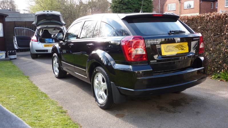

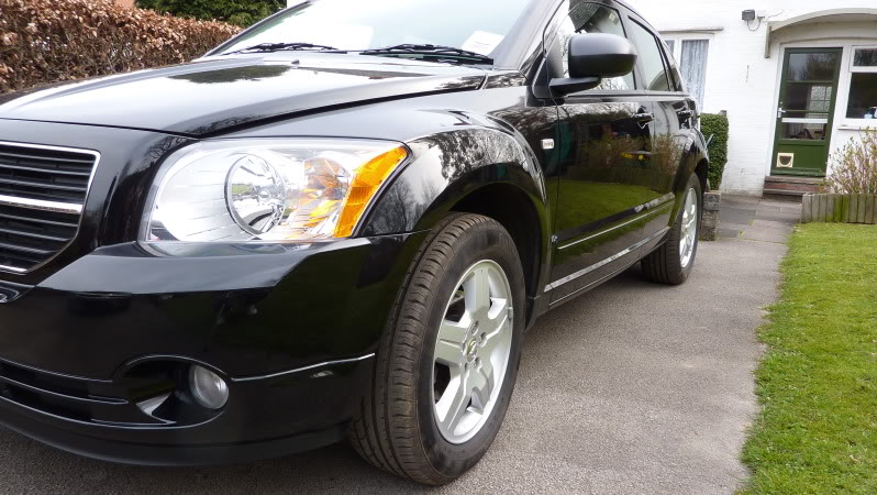

- 2 Layers of Swissvax Onyx on the paintwork

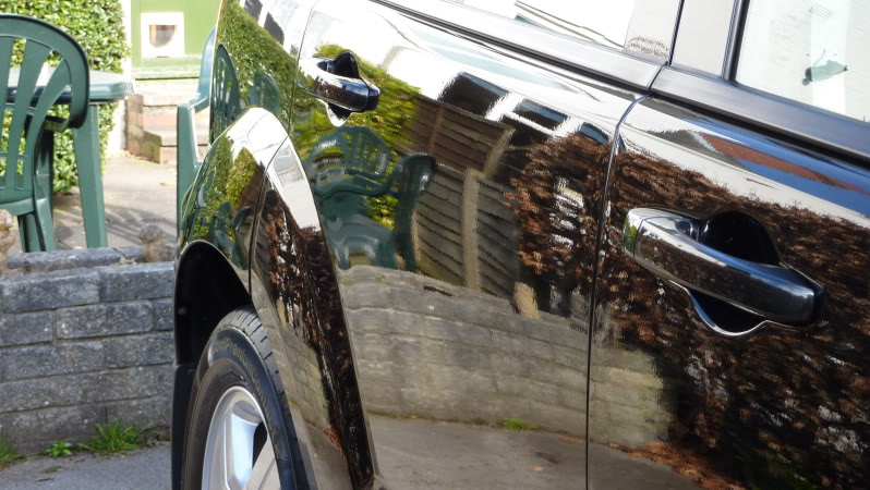

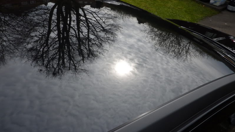

A few afters:
Thanks for reading :)
