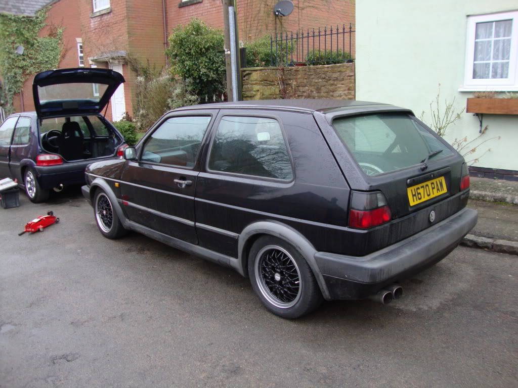

I've just got a Vw golf gti 8v (pb) mk2 1991 in black (Big bumper). It's going to be my new daily but i will also be modifying it along the way. This aswell as my saxo will sort of be demo cars for GT Creations. The golf will be oem+ themed and the saxo will be a full on track car but still remain road legal. Here's the link too the saxo....
http://www.cliosport.net/forum/show...axo-Vtr-(Going-Into-Hibernation!!!)&highlight=

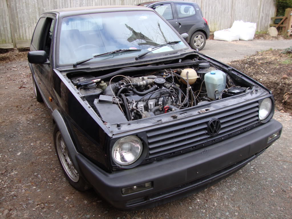

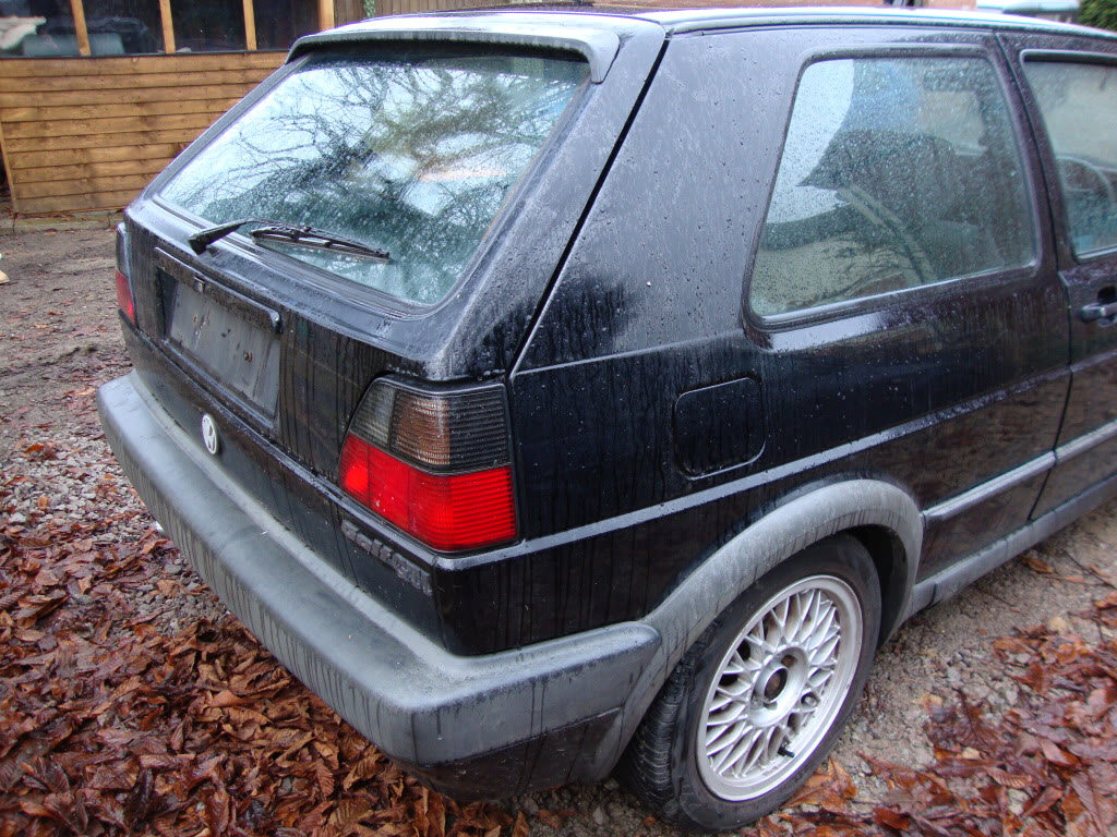

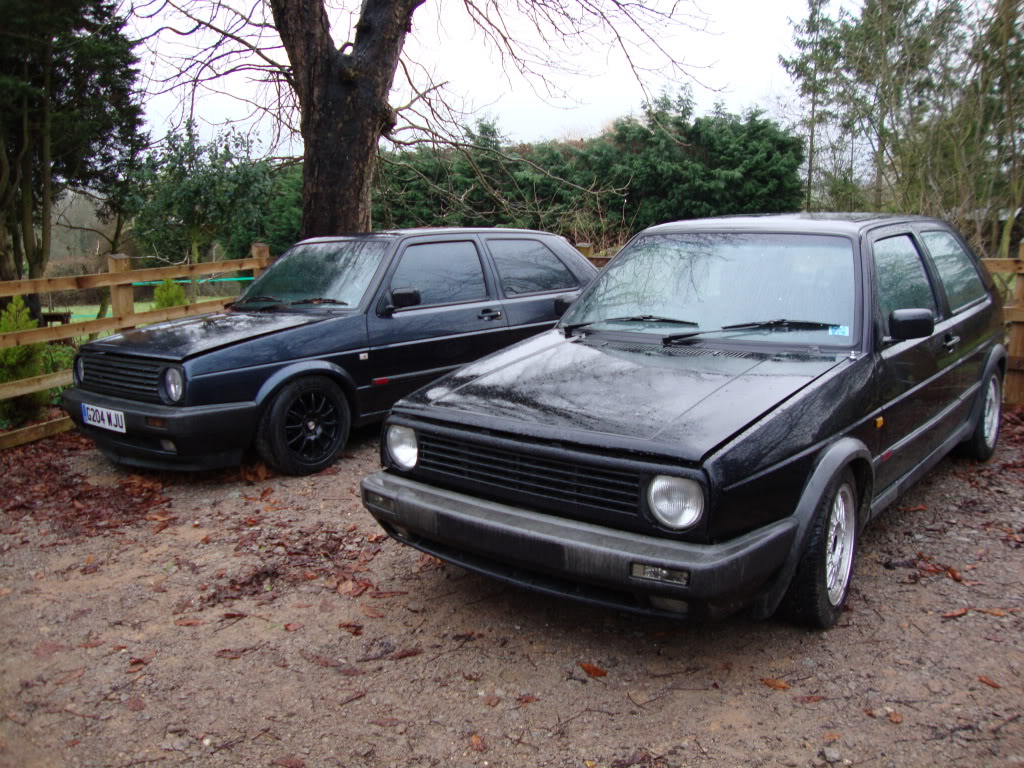

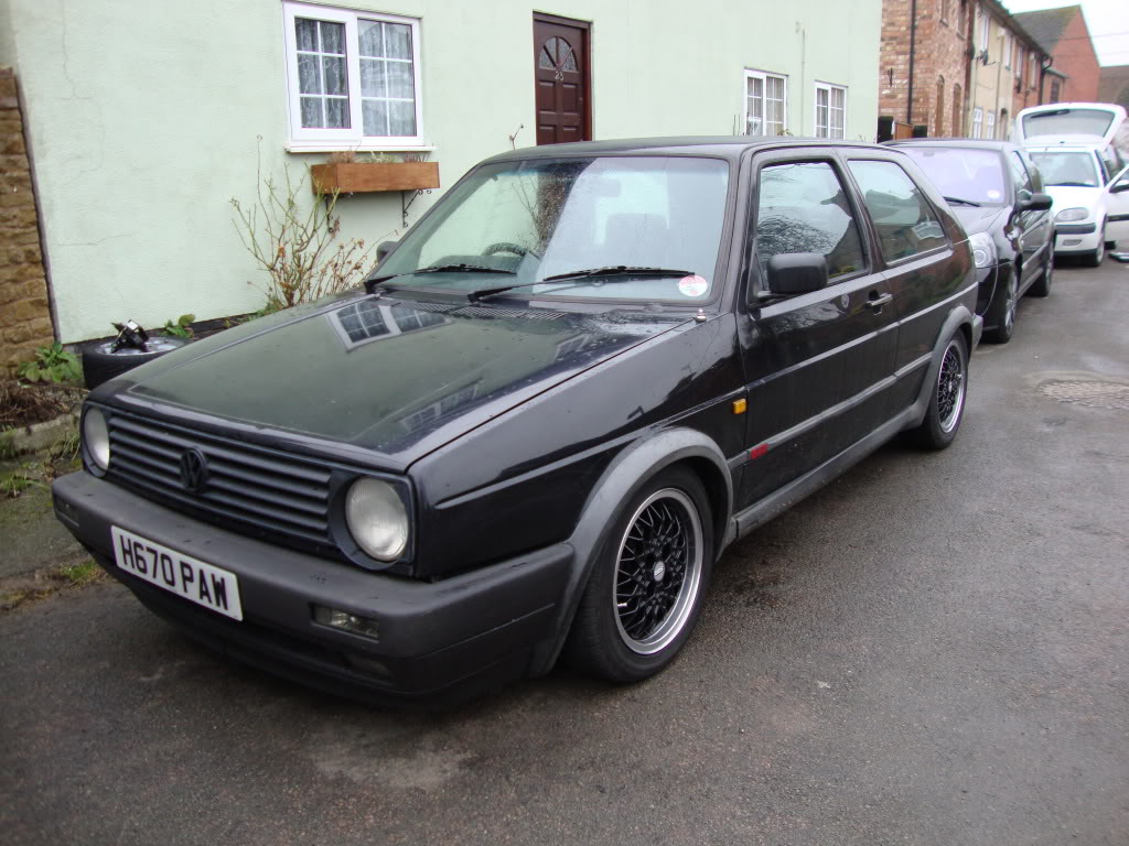

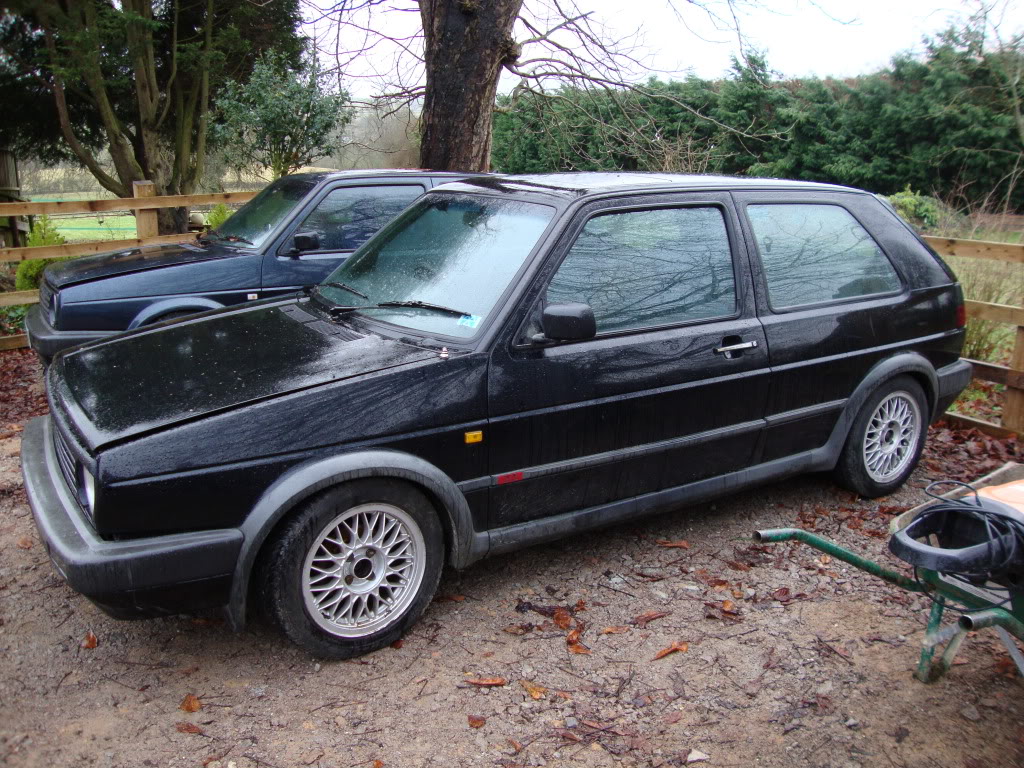

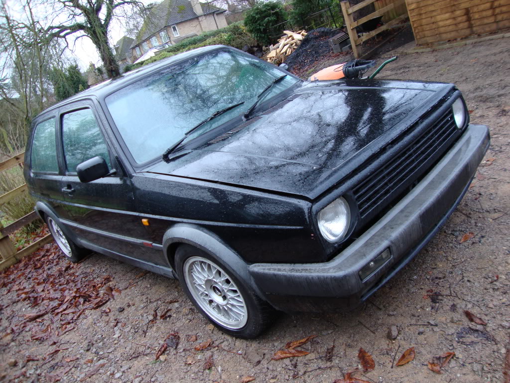

Here’s the only pics i have at the mo. The cars been sat alittle while so it’s filthy and it was raining. The bumpers not fitted properly and the bonnets not shut...

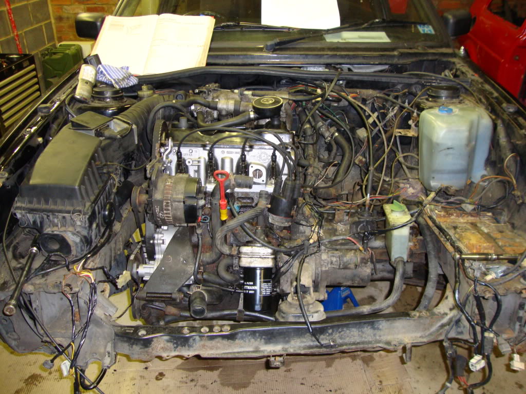

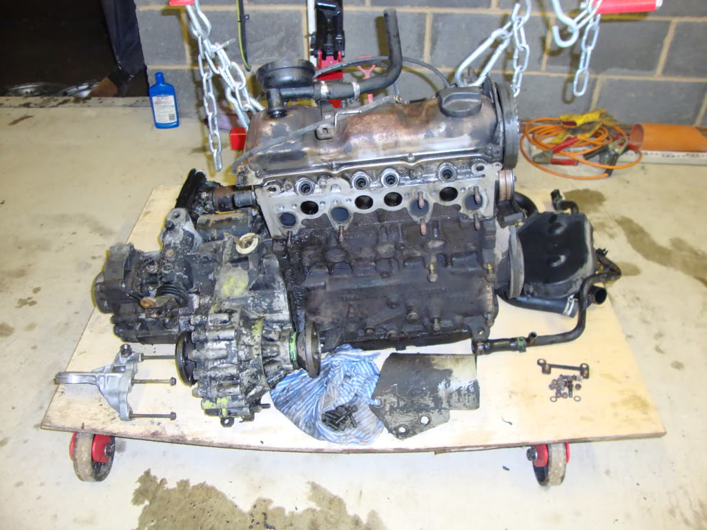

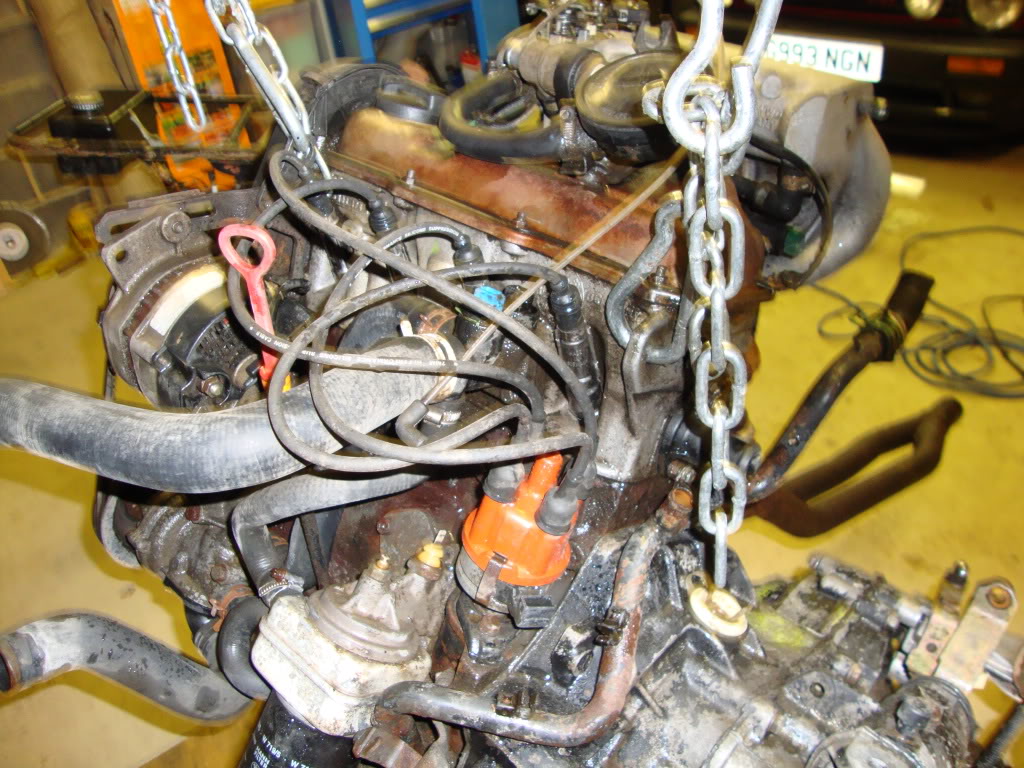

I bought the car from a mate and its currently at his house. The car came with a blown head and we decided to swap the engine for another. He had a spare 8v lump from an everyman racing golf which they were breaking for spares. We don’t know if the engine runs but it looks clean. We have started stripping it down for inspection but were just going to fit it and see it runs. If it runs and sounds mechanically sound then the engine will be removed again and will have the headgasket replaced, head bolts, gaskets, cam belt, waterpump, etc replaced. The engine's also going to be cleaned and painted aswell as the engine bay.
Heres some pics of the engine after having alittle degreasing...

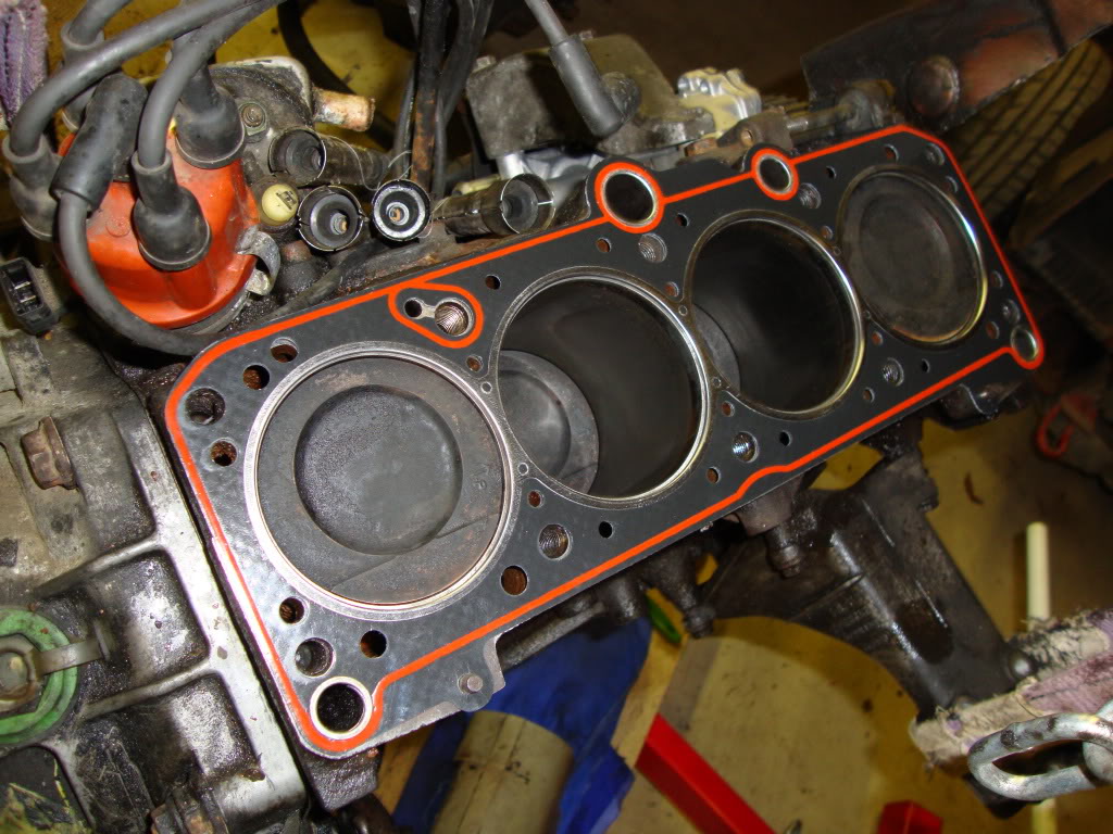

We stripped bits off with the intention of taking the head off but were just going to fit it first to see if its a good runner. It looks to be in good condition with no sign that the headgaskets gone and looks like its been well looked after so fingers crossed the blocks ok..

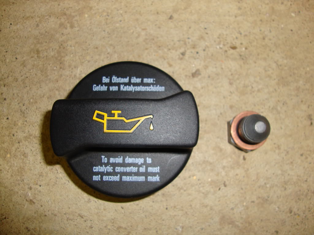

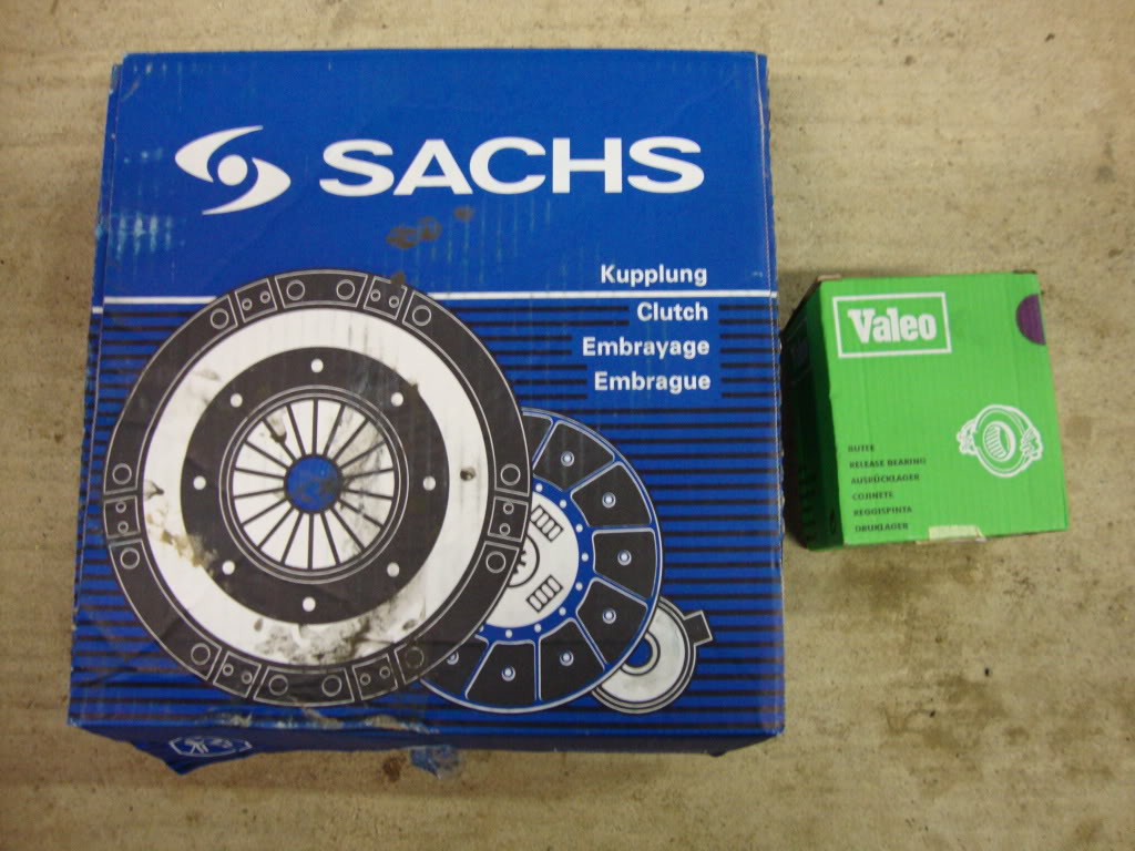

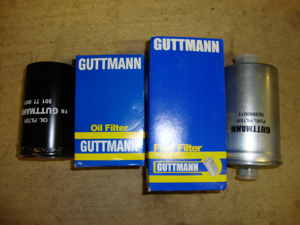

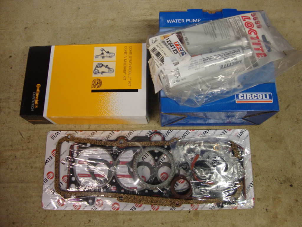

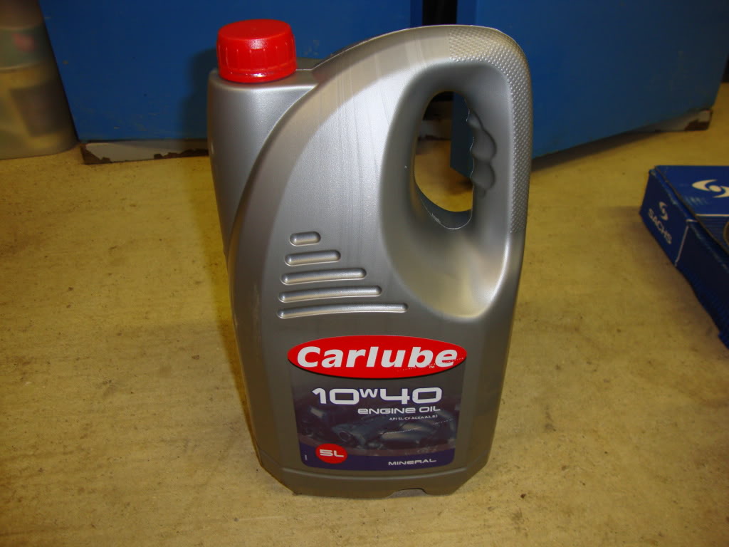

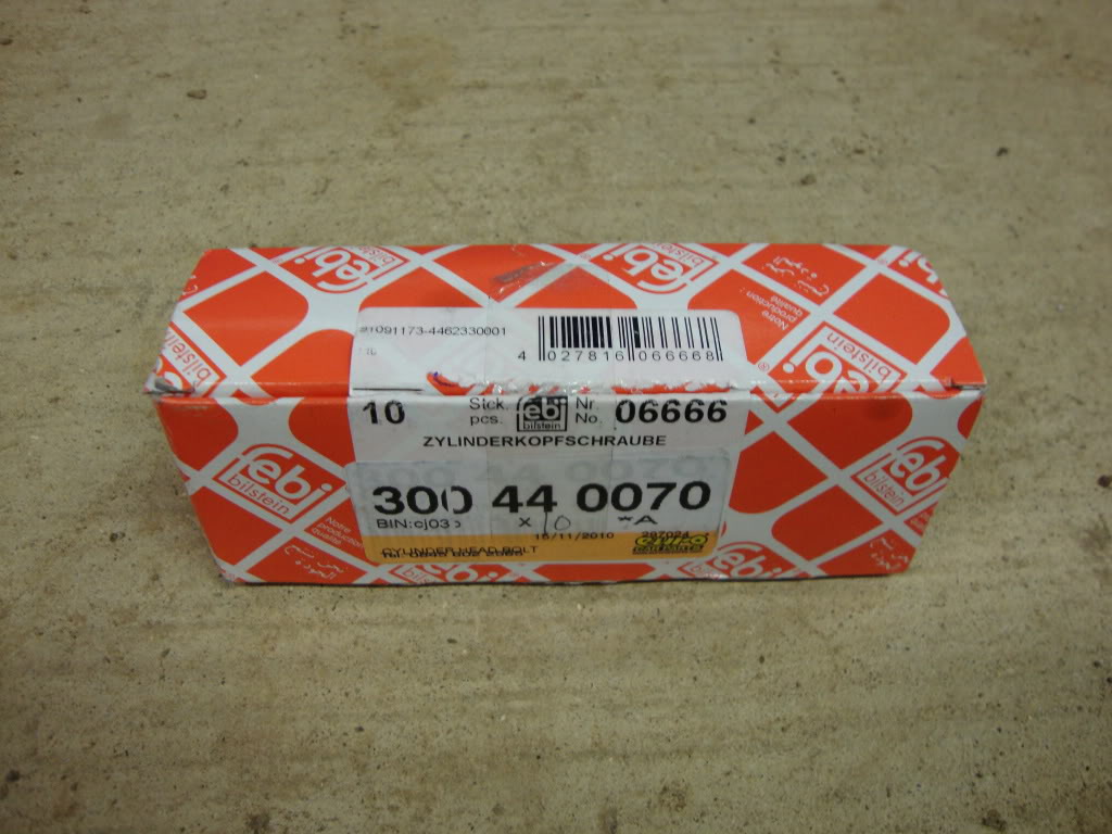

Heres some of the parts ive got for the engine/gearbox overhaul...
At the minute i have...
Headgasket set,
Headbolts,
Cambelt set,
Waterpump,
Engine oil 10/40,
Oil filter,
Fuel filter,
Oil cap,
Sump bung & Copper washer,
Spark leads,
Spark plugs,
Clutch kit with release bearing,

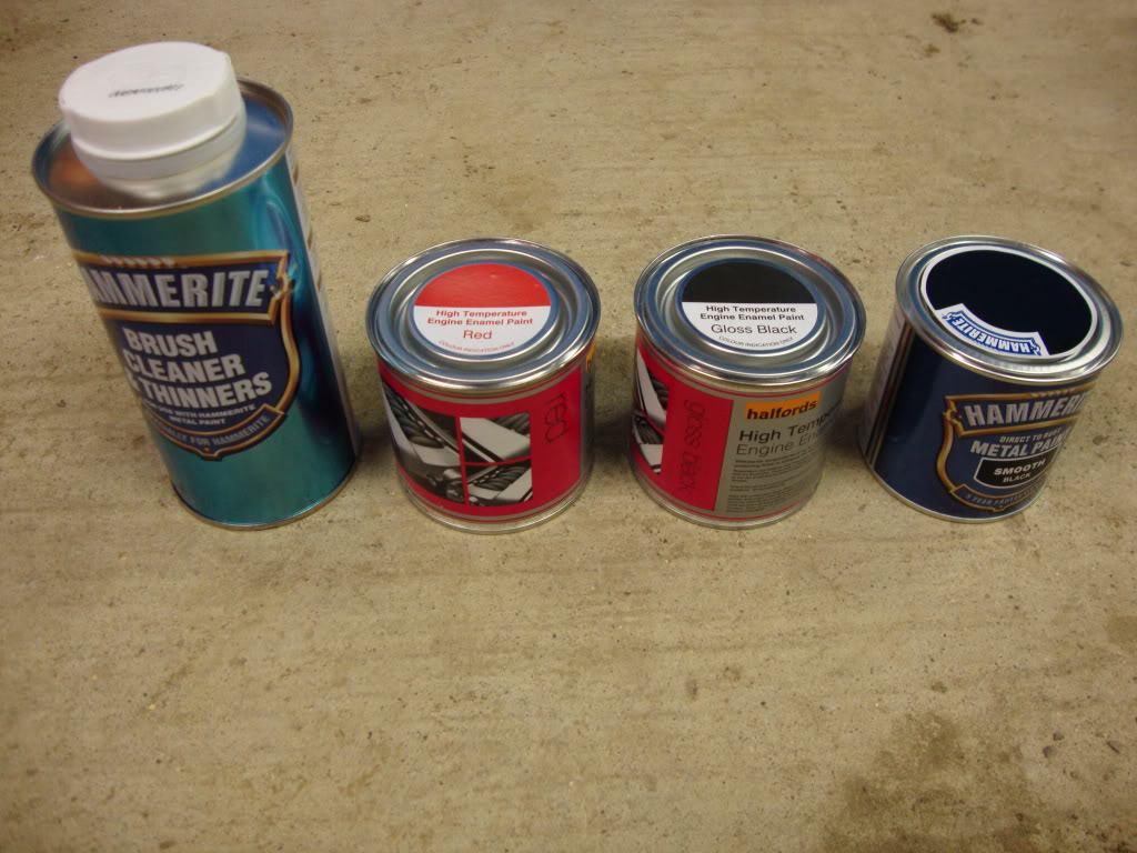

Engine enamel paint red and gloss black,
Hammerite smooth black.
Iv'e still got too get...
Dizzy cap,
Gearbox gasket,
Driveshaft seals,
Gearbox oil,
Manifold copper nuts,
Sump gasket.

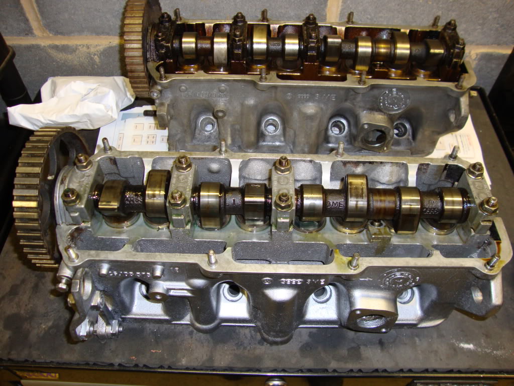

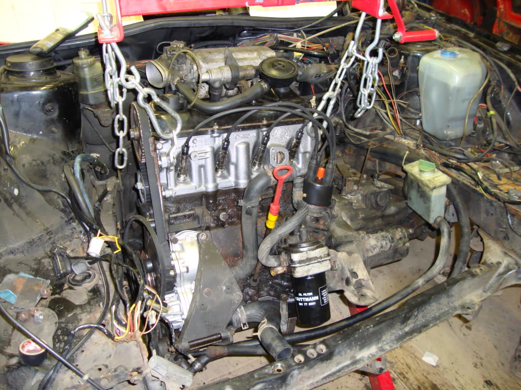

Hoepfully by the end of the week ill have a nice update. So far the original engines been removed after we decided to refurb the original insted as we knew this engine runned but just leaked oil. The heads been skimmed, all seals replaced, de-cocked and painted. The original headgaskets been removed from the block and all water/oil ways have been blown threw with an airline to clear any blockages. The sump has been fully cleaned of the old manky oil and refitted with a new gasket. A new clutch has been fitted also. All thats left to do really is to wack on the new cambelt and pulley and refit the engine back in. Theres loads of other little bits that have been done but ill go more into detail with the update. Once the engines in and its running i can finally start to detail it.

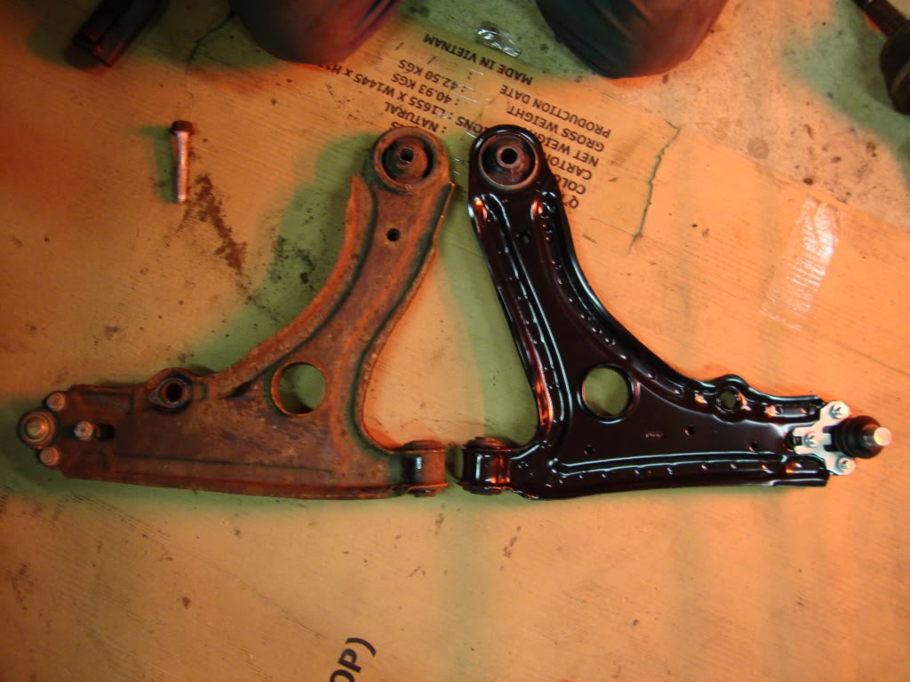

Got the engine running properley last night after tweeking the dizzy and it now idles perfect. The only problem atm is the lower rad hose is cold so it looks like the thermostat isn't openening. So ill whip it off and test it. I've also fitted brand new driveshafts and wishbones. I will hopefully have the full update tomorow.

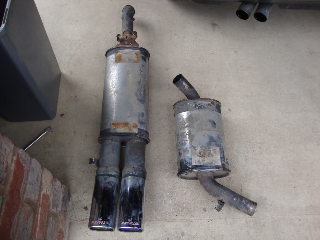

Nice one John, the shell is mint no rot on it atal. The paint work looks s**t but its been sat under a tree for about 4 months so just needs a really good detail. The engine's running sweet sounds really good for an 8v. Just won a remus exhaust system on ebay for £30 :) Mines got a hole in the mid pipe so needed changing anyway so that should be a nice temp replacement. I need to do a frigging update but im being lazy :(

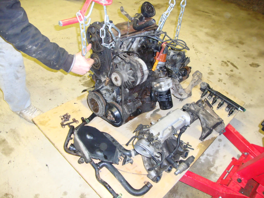

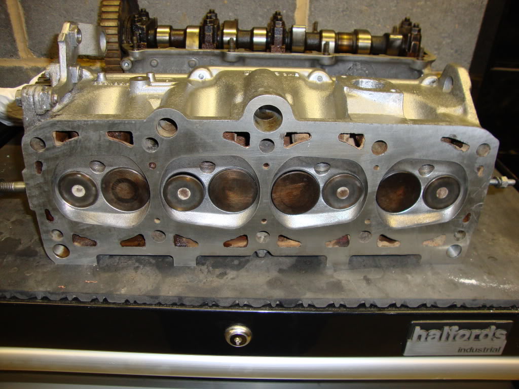

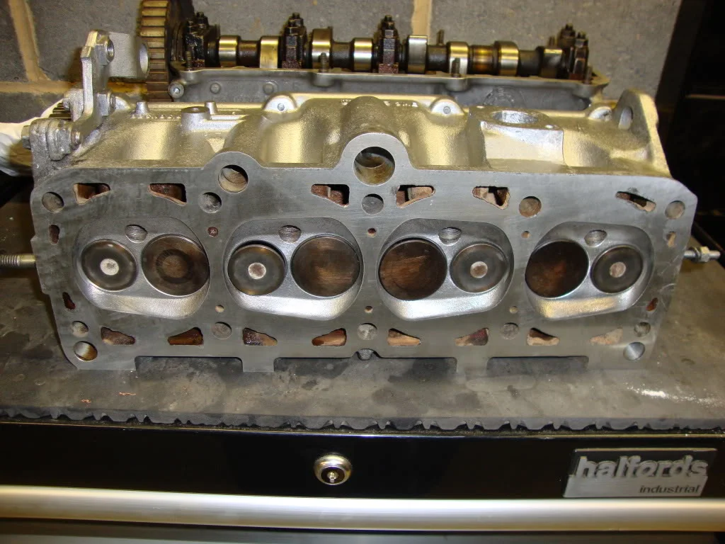

Right then, heres some pics of the engine being dismantled with the head reoned..

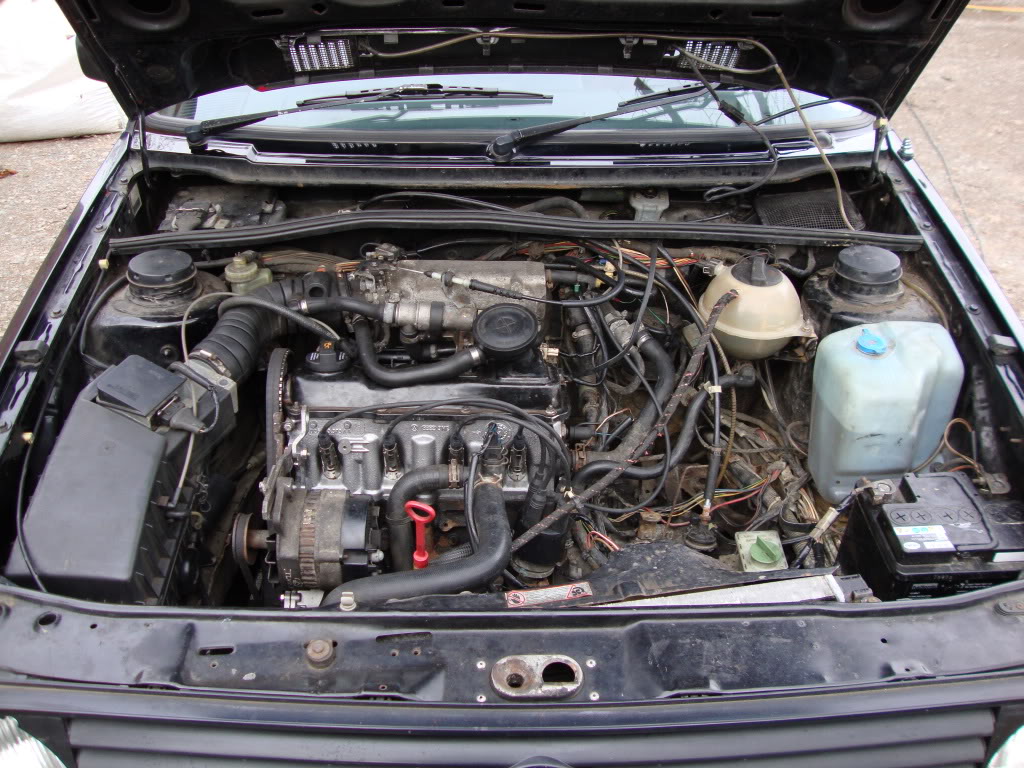

Back in the car..

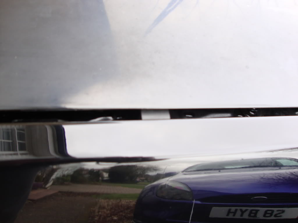

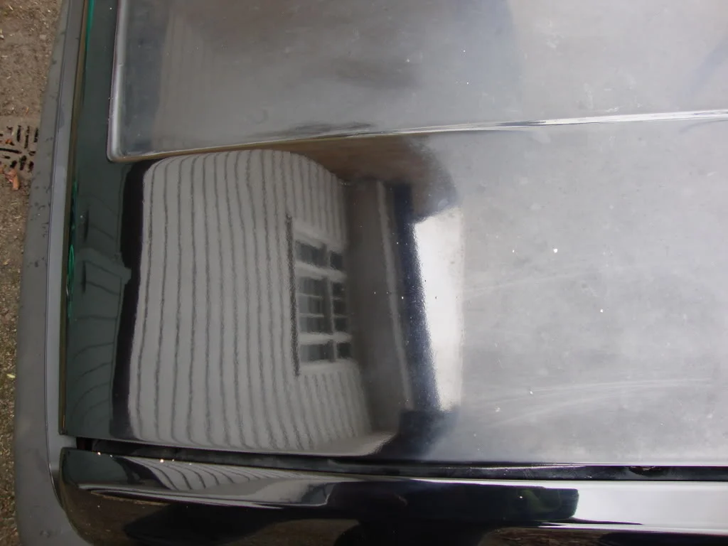

The paintworks quite faded and oxidised so i gave it alittle black t-cut and it comes out beaut again..

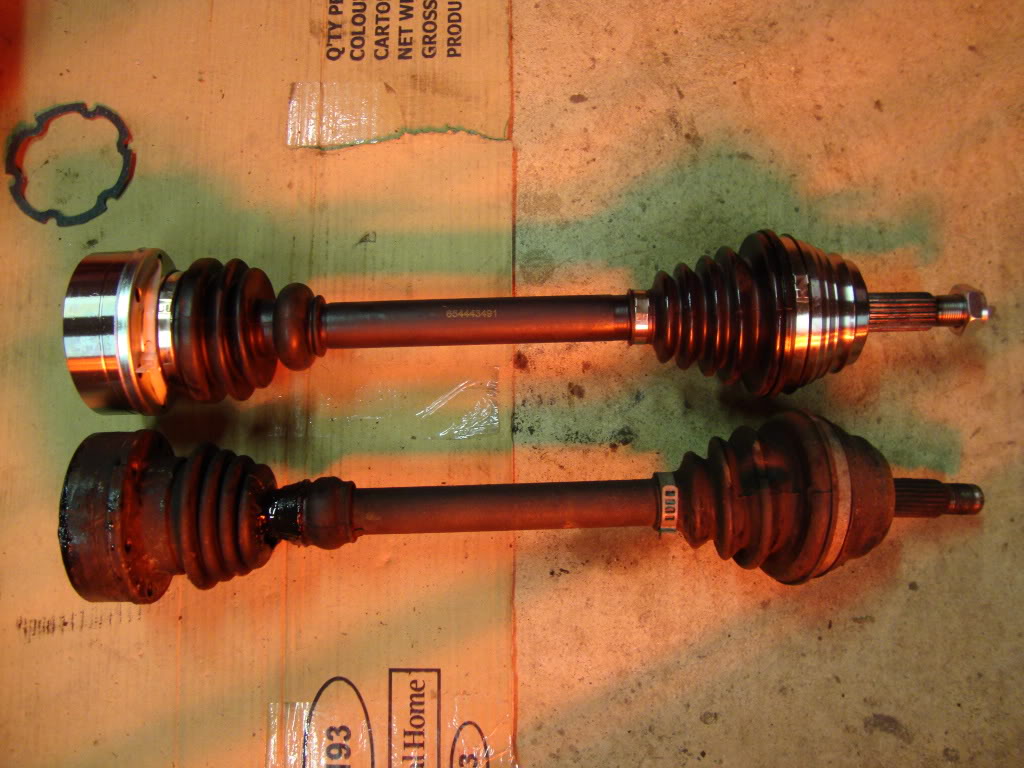

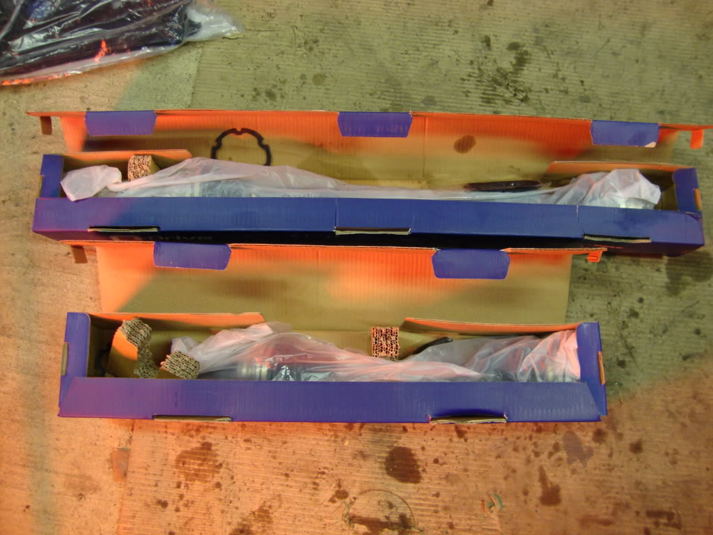

New driveshafts...

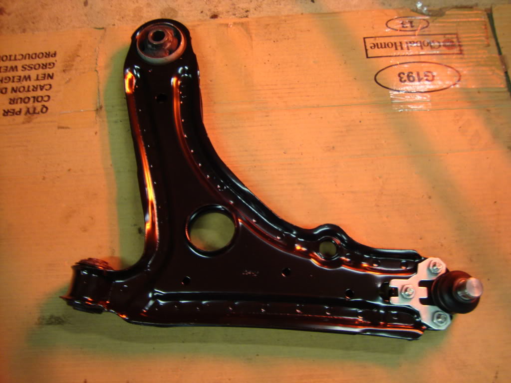

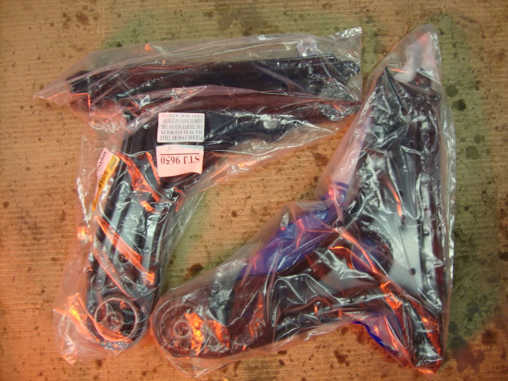

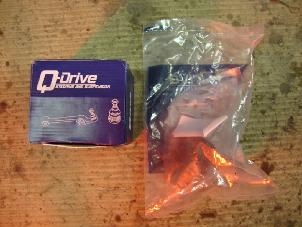

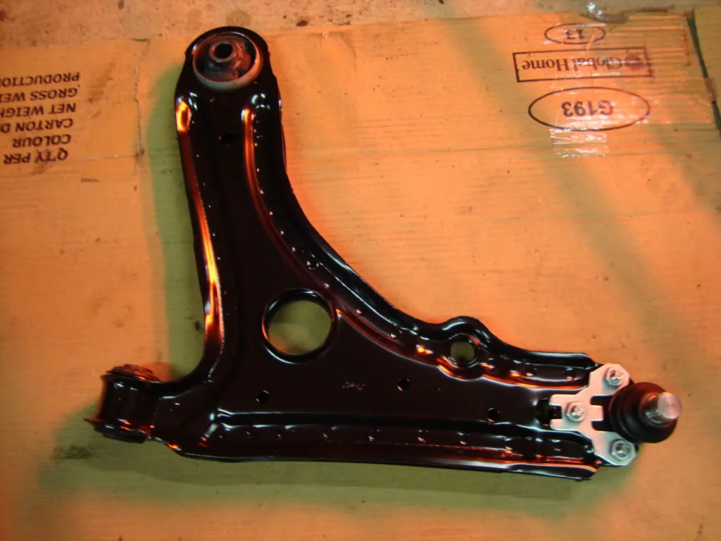

New wishbones and ball joints...
My ebay bargain remus stainless system..

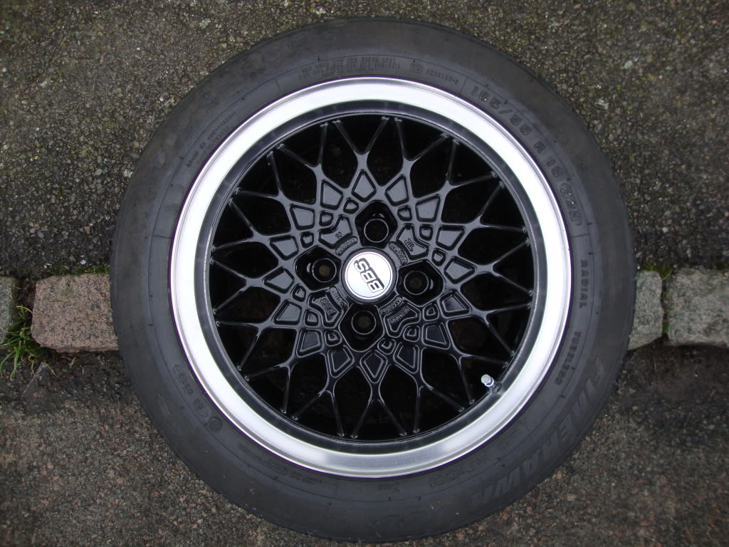

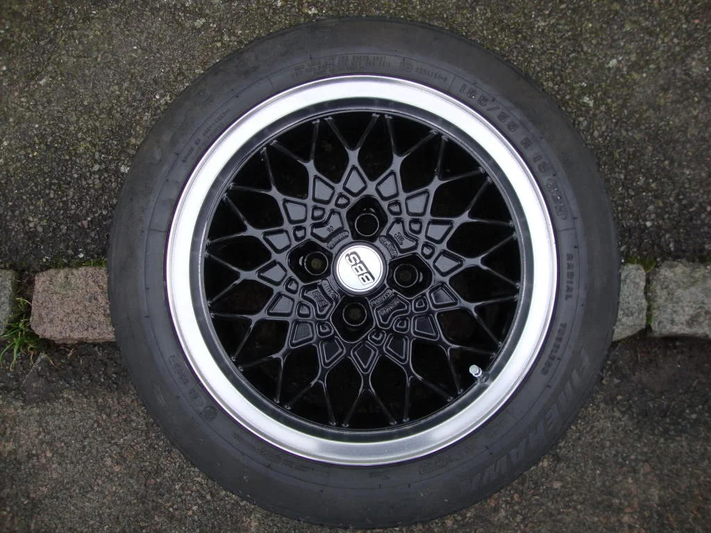

The new wheels, bbs ra's in black with polished lips..

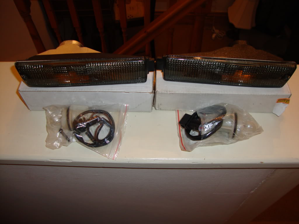

New smoked front indicators to go with the 16v rears....

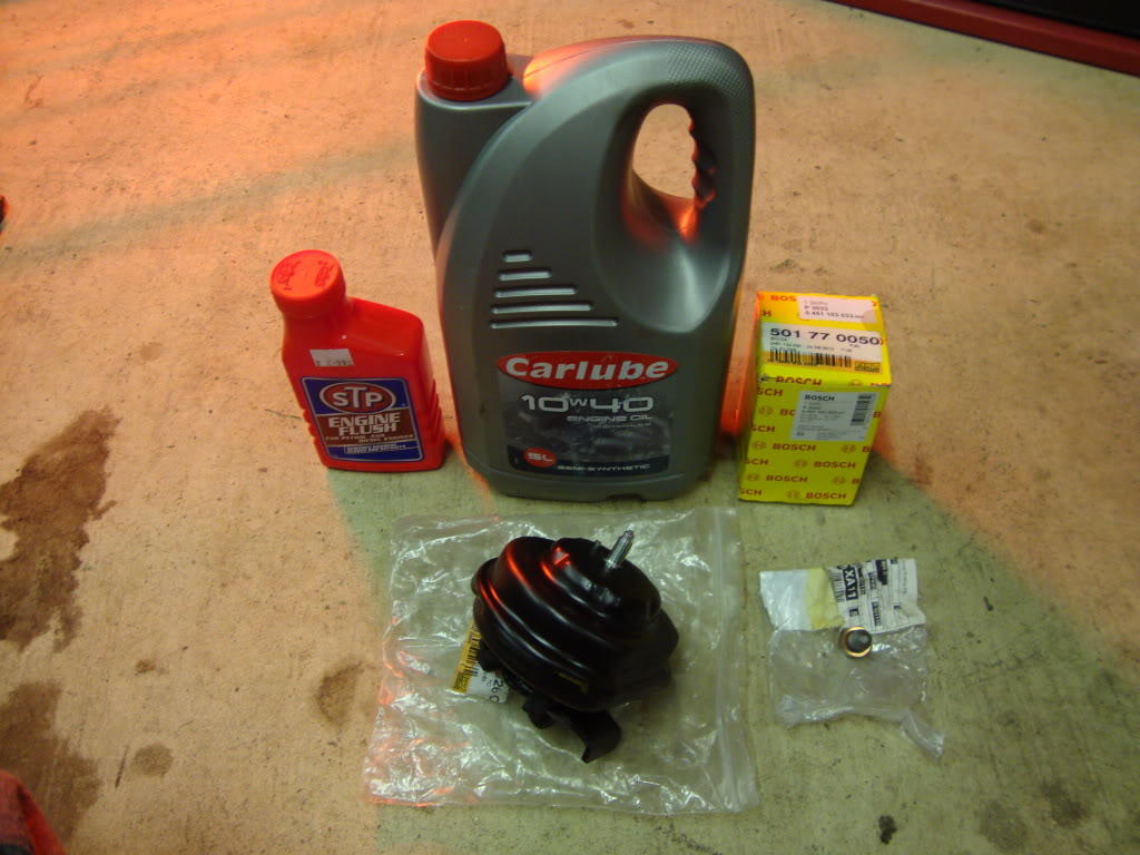

New oil filter, oil, engine flush and front engine mount..
Sadly Im having to sell her now as the heads gone again. I literally havnt got the time or space to get a recon head and fit it. I would love to keep it but i need a more practical car hence why the saxo's back on the road :). I hope she goes to a good home, I've spent alot on the car already and only had 600 miles use out of her :(. If anybodys interested from here, heres the add on ph.....
http://www.pistonheads.com/sales/2551678.htm
We think it might be fractured dan. The oil galleries looked ok but there definatly something wrong with that head. The previous owner had the head skimmed and that was apparently the 2nd time so when i had it done it would of been the 3rd. I think when the **** before ran it so hot it must of cracked something internally. It really needs a recon head tbh. I thought by getting the head skimmed and a slight referb ide get away with it but i didnt. Like i said i would love to keep it but i just havnt got the time to keep it off the road. Ive had a good offer for it at the mo so it looks like its going. The money i get from the golf will be ploughed into getting a 16v plus rallye gearbox for the saxo. So its going to a good cause.
