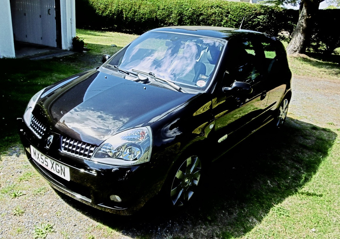

Last summer I decided to sell my last 182 as I didnt like it and try and buy the best 182 I could find.
I spent months on the look out for an immaculate blackgold 182 with as low mileage as I could find. I was tempted by a Trophy but Ive never really liked the colour and was set on a black 182. Around the end of July there was a member on here who put up for sale a 182 with 23k mile 2006 182 - the production date shows its pretty much the last off the line. It looked perfect so made the call and shot up to Long Eaton to look at it. Everything was pretty much 'as new' on it. It hadnt been modified in any way, belts had been done a month or two before I bought it by Mick at Diamond Motors as well as the MOT with no advisories.

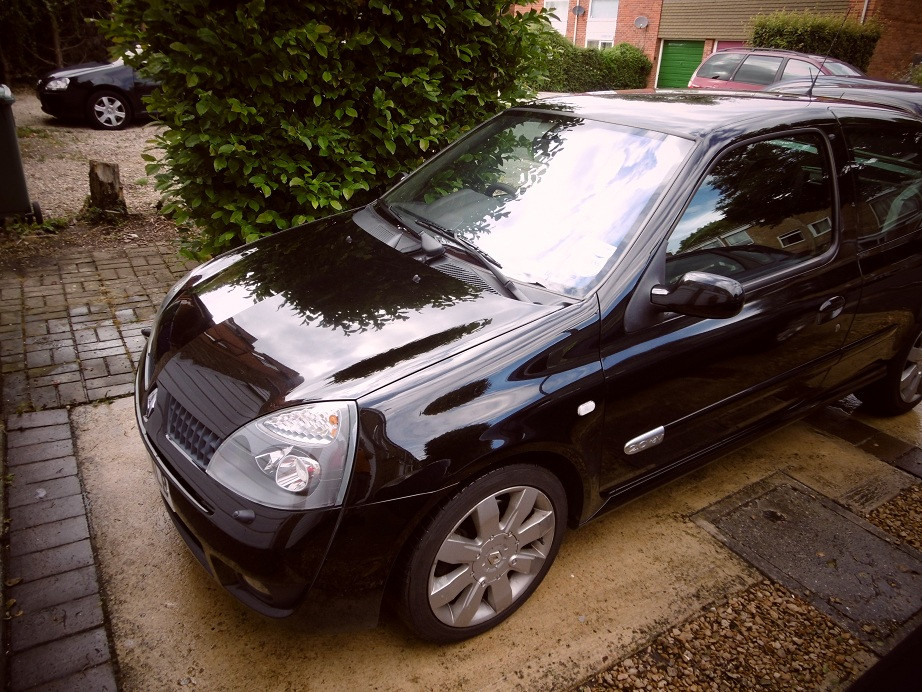

Here is a pic from the sellers ad:
and here are a few from when I got it and took it to France:
Having a car in such good condition makes it a joy to work on which is what I intend on doing.

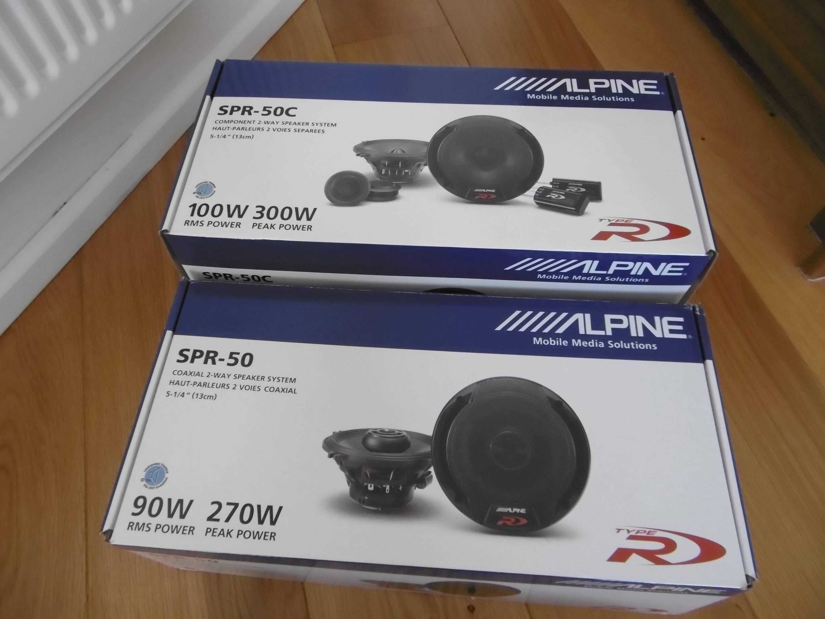

First up was the stereo - I do a lot of driving around so need to be able to have in-car bluetooth phone handsfree and decent sound quality. I didnt want to add massive weight to the car and dont think this package added much more than 1 kilo. I have done the stereo install already in this thread: http://www.cliosport.net/threads/perfect-underseat-sub-stereo-and-speaker-install.758455/
here is what I chose to use:
Headunit -
The inline amp - this thing is awesome ! small enough to hide behind the climate control panel:
speakers front and back including tweeters and cross over:
And an underseat sub - the plan is to get another one for the drivers seat. They fit so so well, see the thread link above.
It has made a massive difference and I love it. It was expensive but worth it in my opinion.

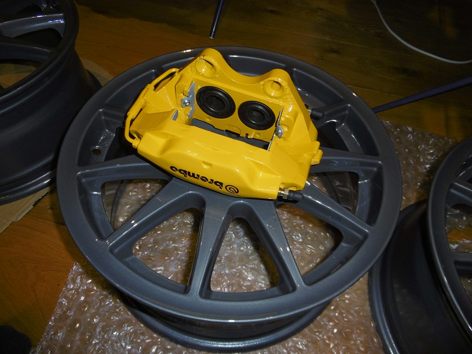

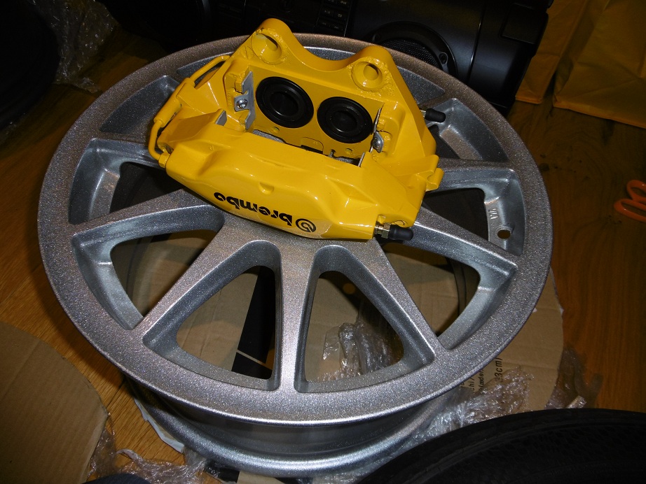

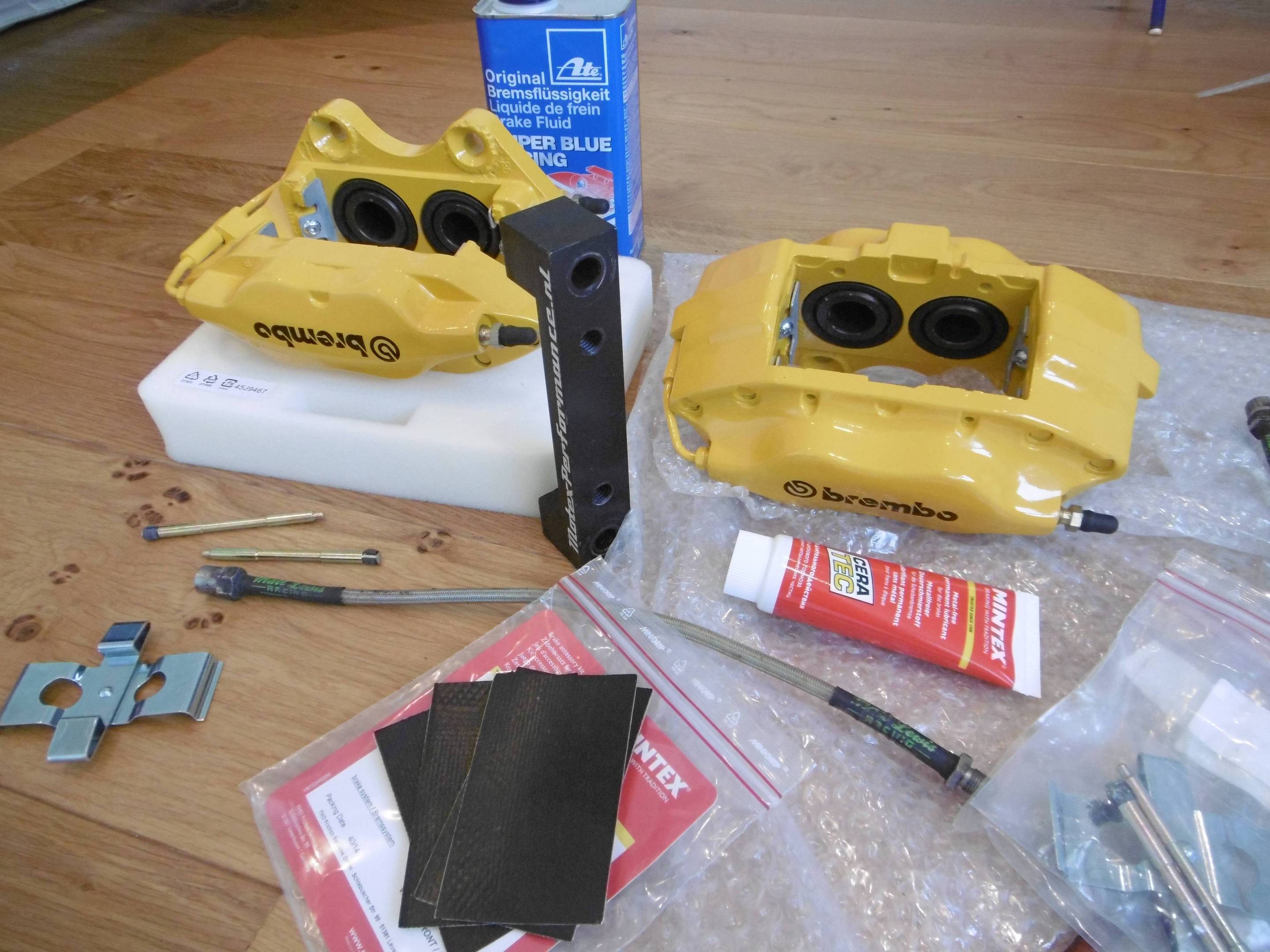

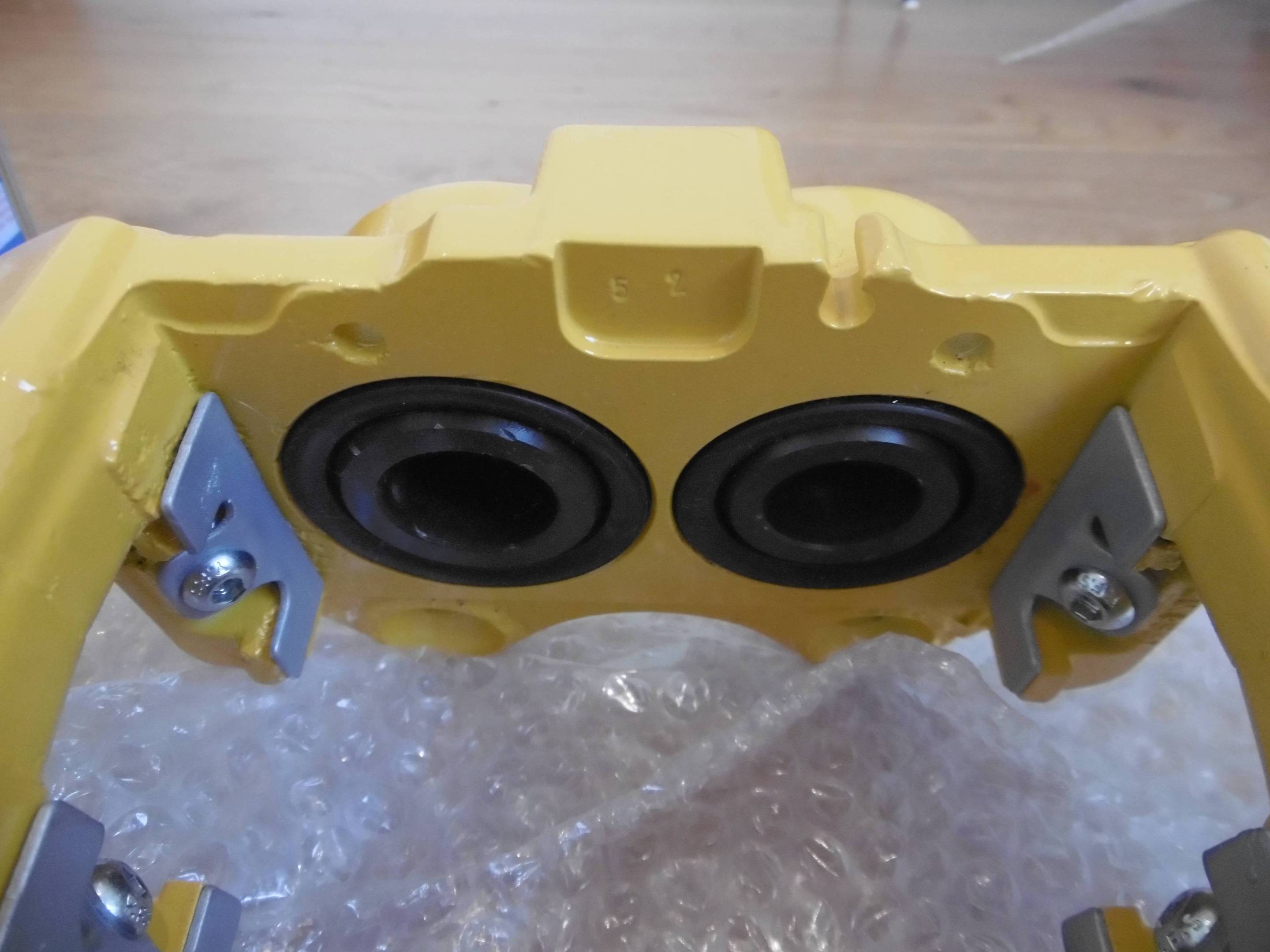

Next up I decided to get a brake upgrade. I spotted these on here a while back and they have been completely reconditioned - new seals , pistons , powder coated in porsche yellow (not my first choice but starting to come around). They are peugeot Brembo 4 pots, with motrex performance adapter , 300mm discs ( not pictured) ds2500 pads , extended braided brake lines, some stuff to help with possible squeeling, new pins and clips, some spacers that I will show later, a load of bolts and some superblue form the main man G172.
on to the pics:

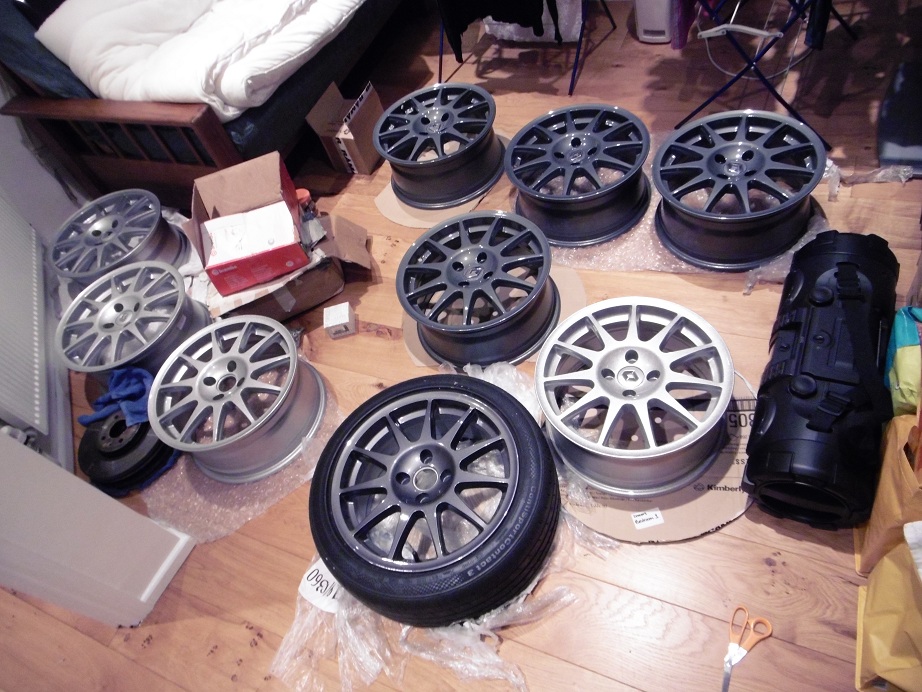

I like the standard anthracite 182 wheels, they look right and will be keeping them as spare wheels but have always wanted a set of turinis. I have not been sure of what colour I wanted so get a set of silver and trophy ones. I preferred the trophy ones so sold the silver ones.
the trophy ones would look much better with yellow brakes I thought:
Gus

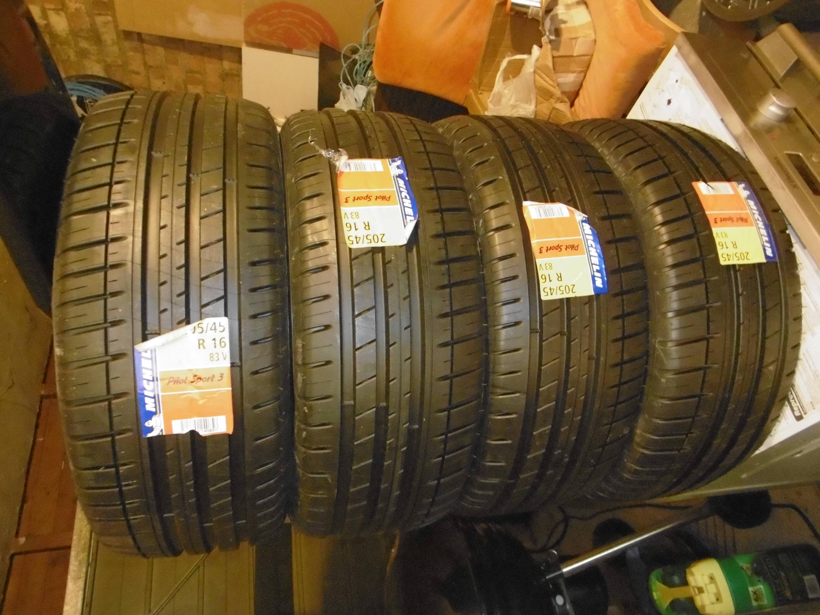

Next was tyres for the Turinis, went with Michelin Pilot Sport 3 from Tyre leader which were pretty cheap.
I also got the old Skoda Fabia splitter :

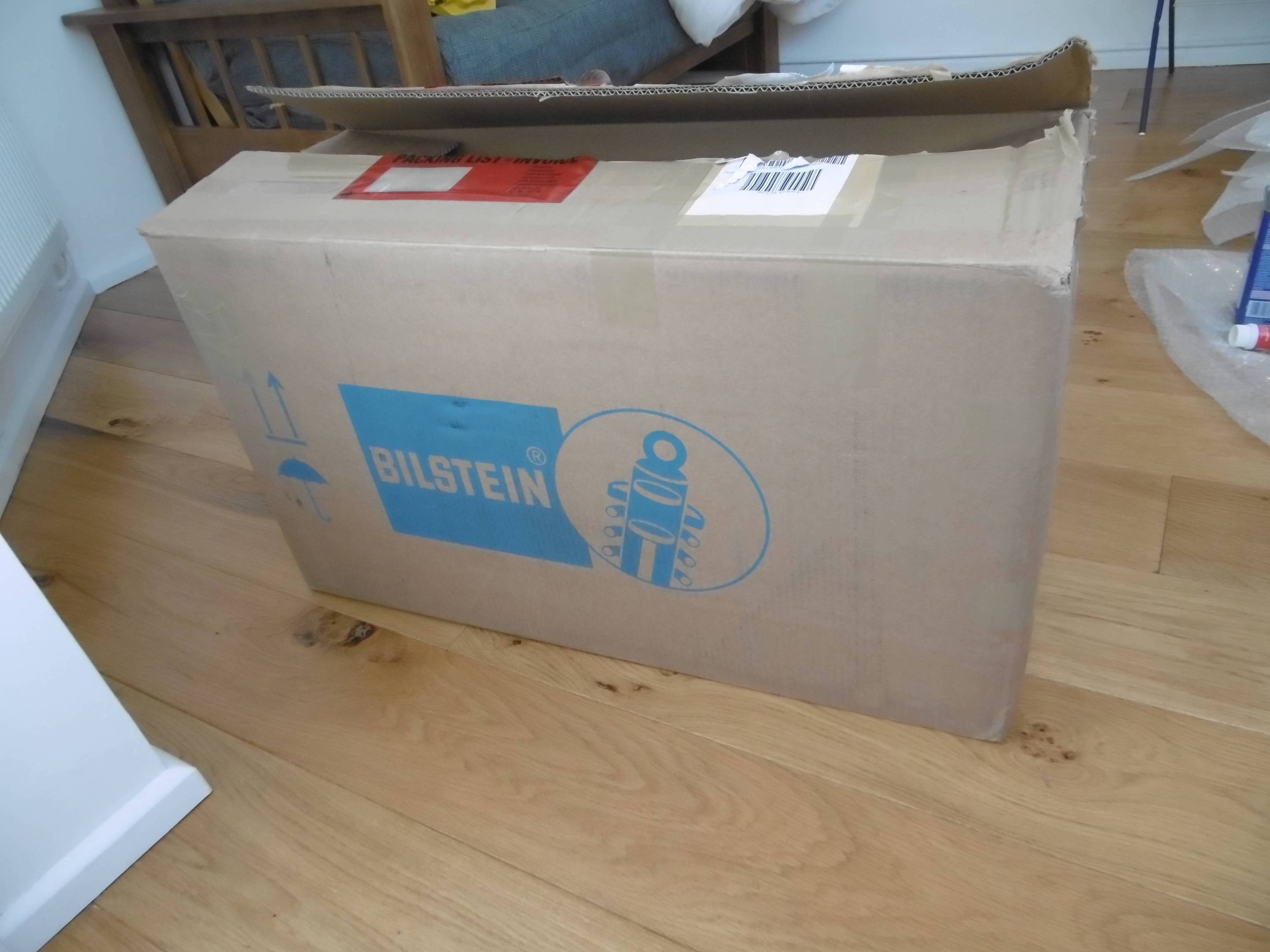

For suspension I have gone with Bilstein B14 - managed to get a fantastic deal with @dann2707 on these from Germany - Usually they are £700+ here in the Uk but only £560 from Germany.

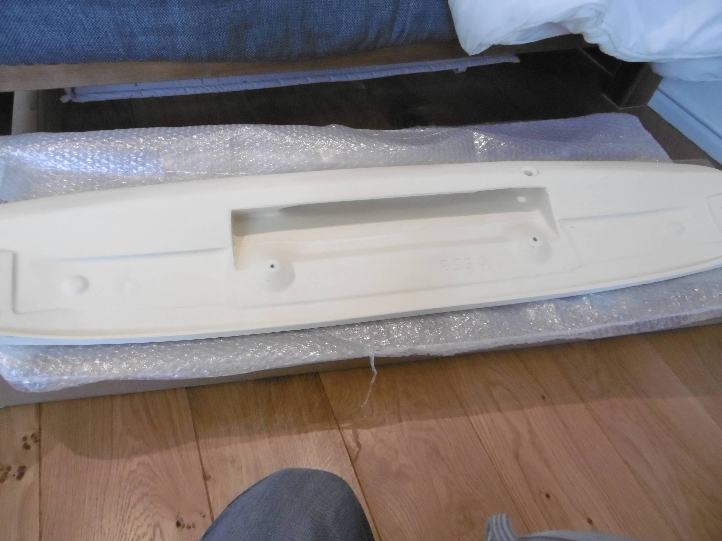

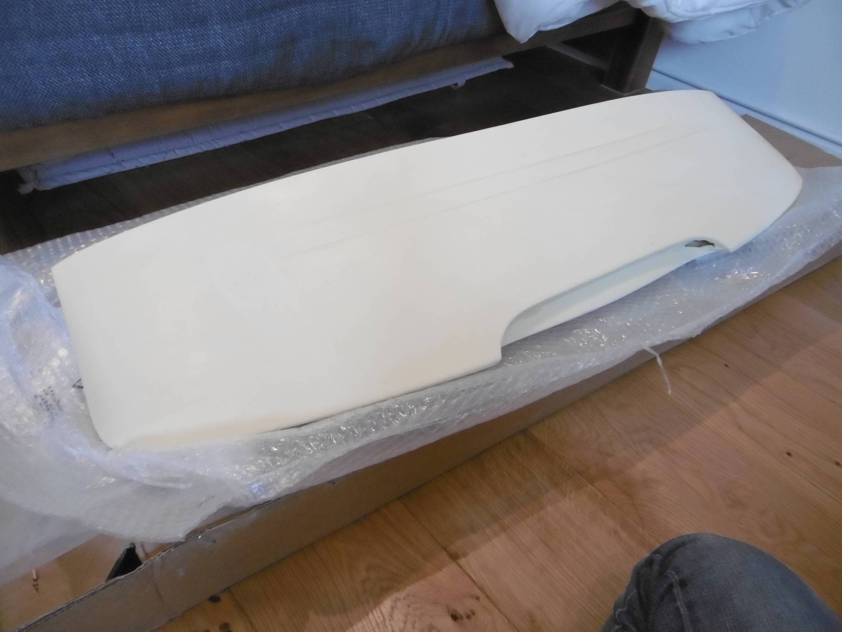

I have always like the V6 Trophy spoiler but finding real ones for sale is quite hard so bought the replica one off ebay for £90ish. It needs painting though.

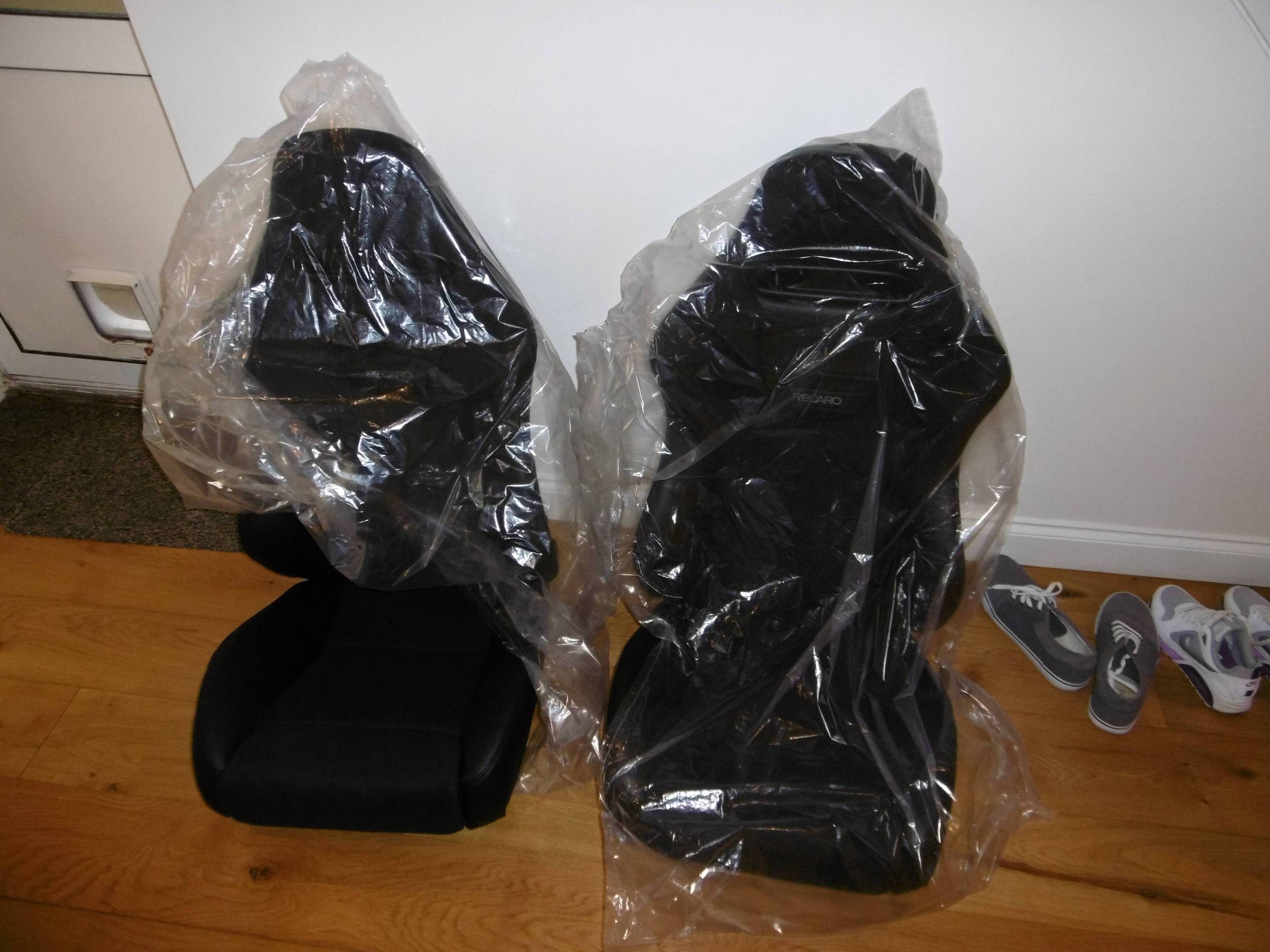

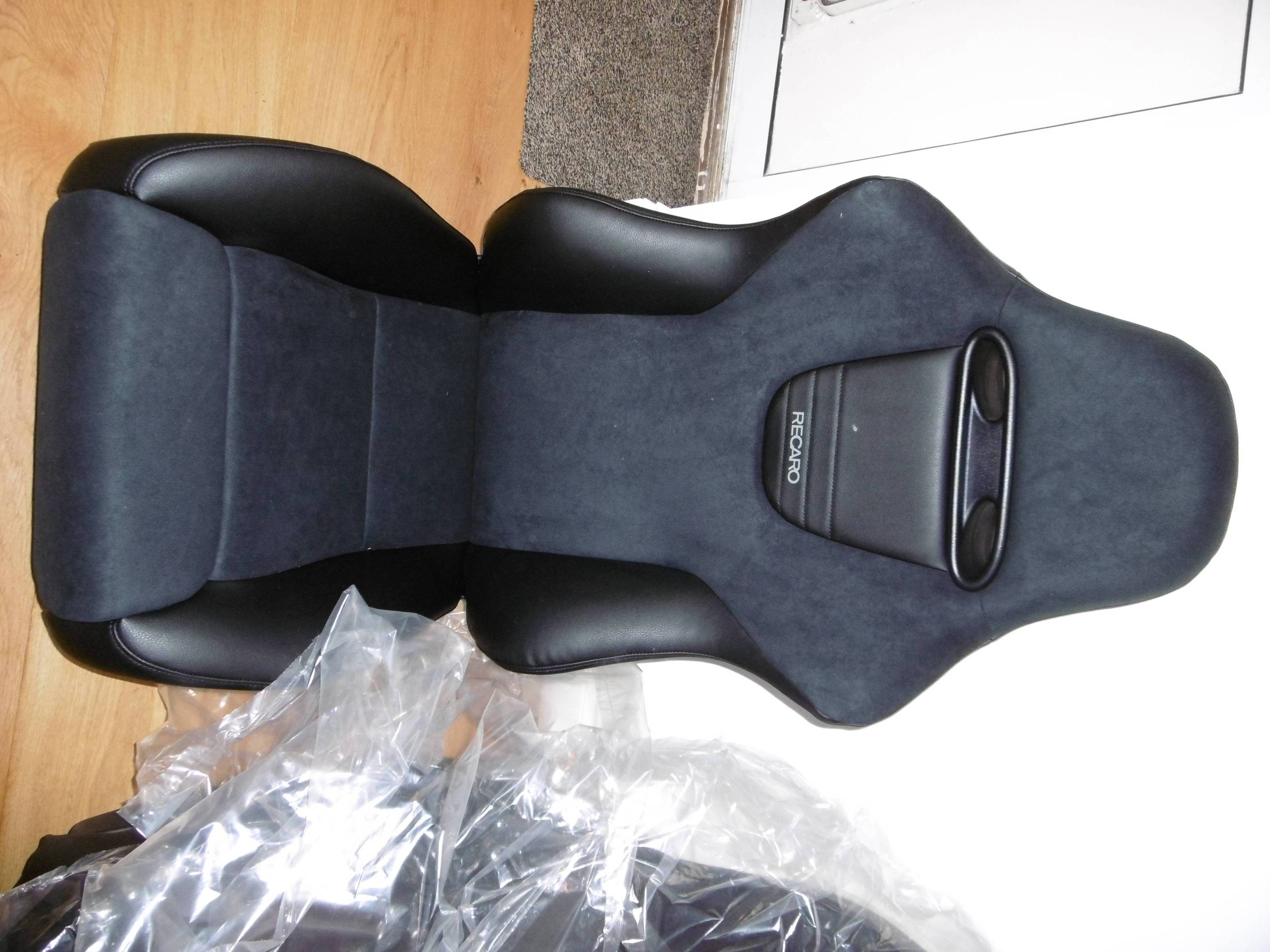

Now there is probably a load more stuff that I need out get out of boxes which I will do later. BUT... my favourite thing by far is next....

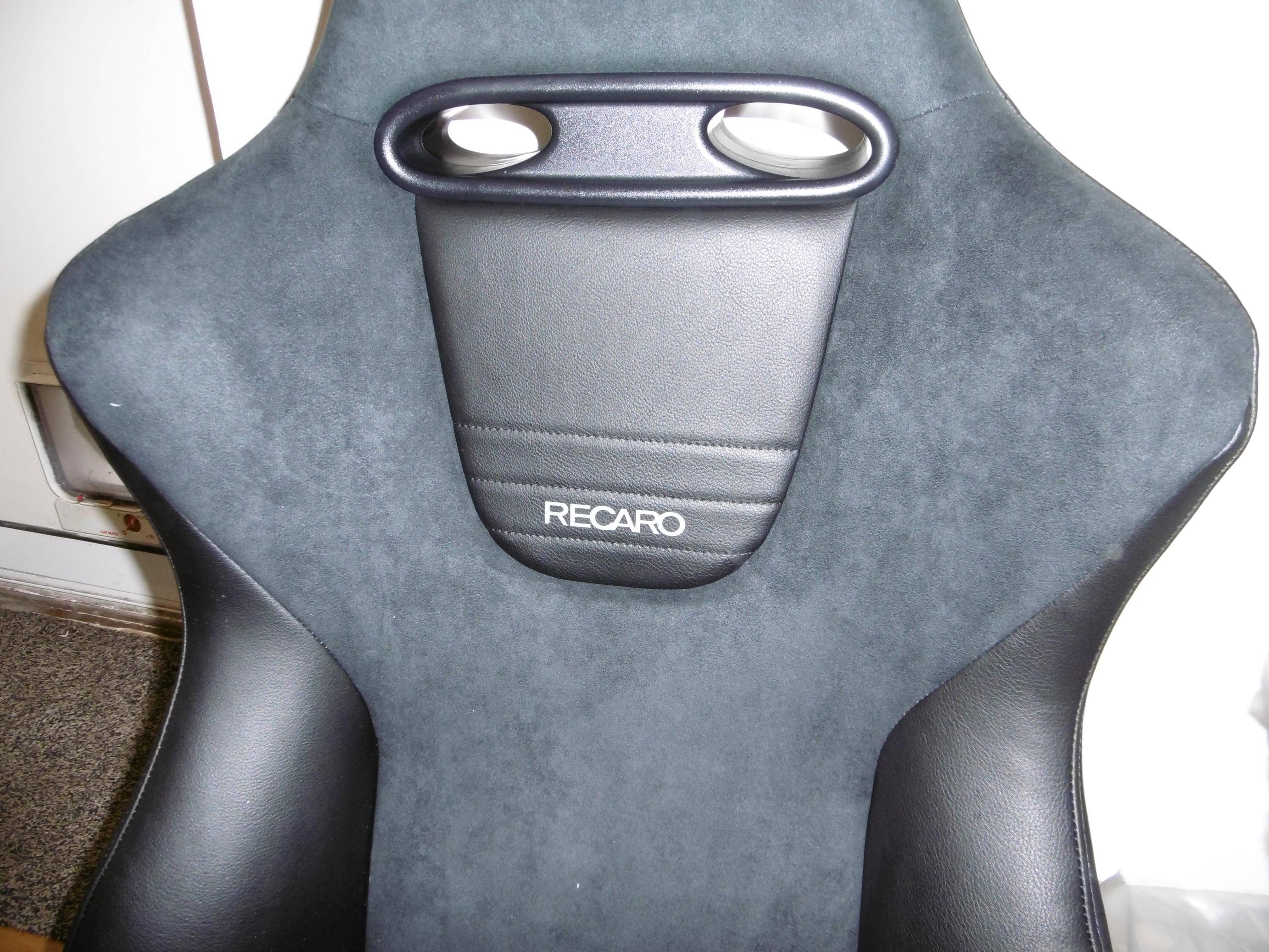

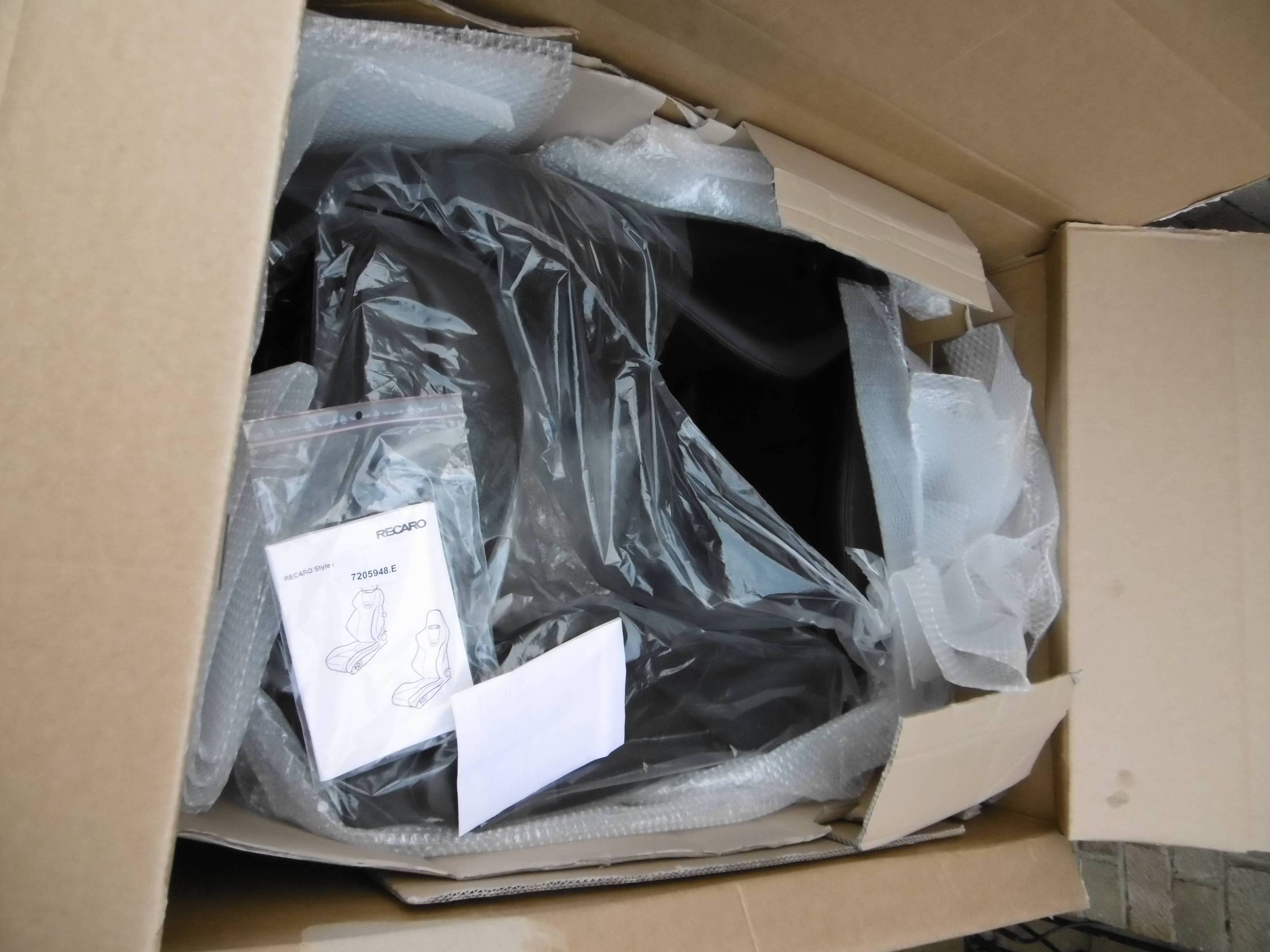

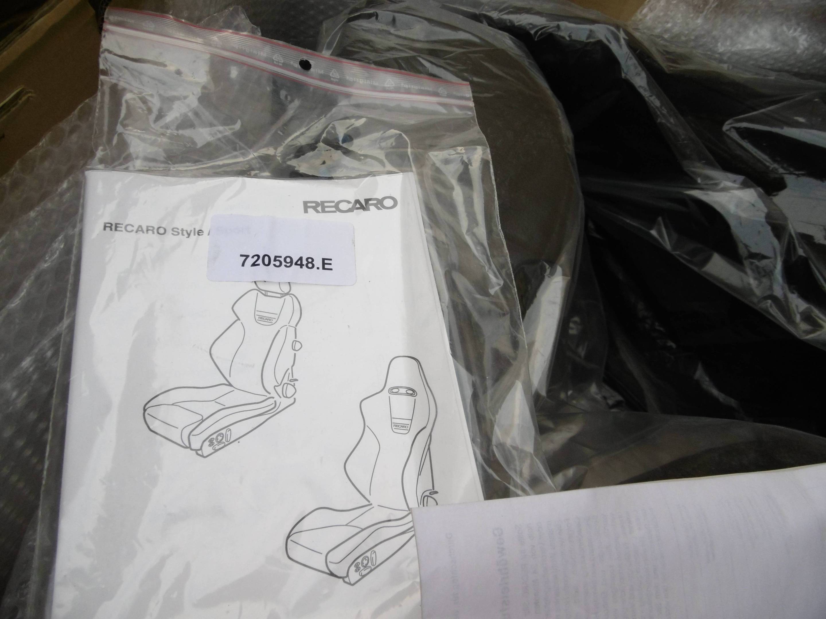

They stopped making these years ago and they are pretty hard to come by as well as expensive even second hand. Imagine my amazement when I found these BRAND NEW on Ebay in Austria. Will let the pictures do the talking (sorry for not rotating a few of these) :
Im f**king happy with these I tell you. Cant wait to get the mounts from @JON FOZ

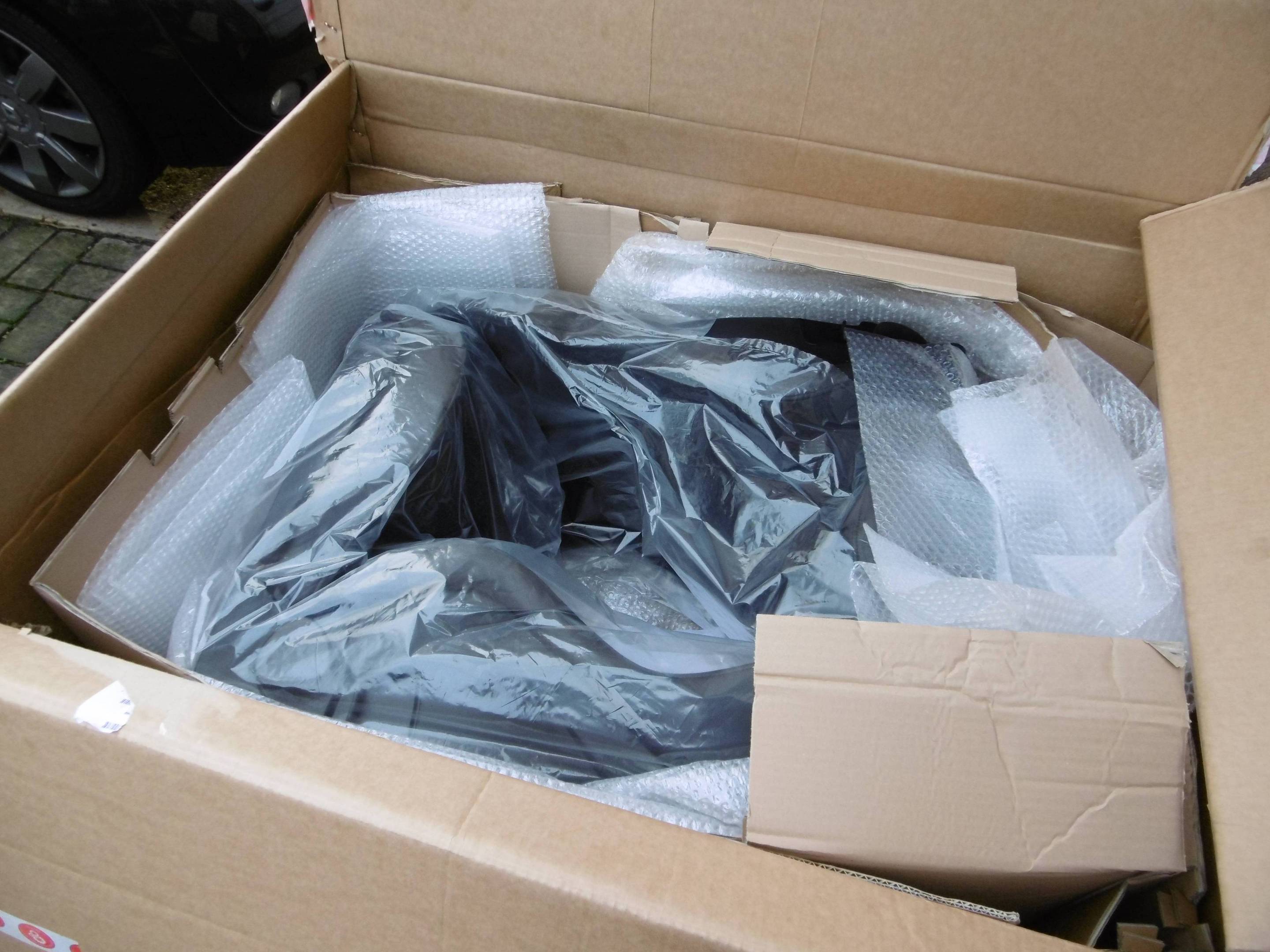

There was trouble with getting these though - they were meant to be delivered yesterday but when the lorry pulled up he had 5 packs of floor boards instead - It turns out the seats went to someone in Norfolk with a similar name to me and I got their floorboards. The freight company sorted it out though and they were delivered at 9 this morning.

Was on Ebay a few weeks ago and saw them - emailed the guy and asked a few questions - the seller asked if I knew simon (chip mk1) as he had bought a set. I talked to chip and he said that the seller was sound and not to worry even though he was in Austria. The seller had bought a load of trendlines to deck out a VW camper with as well as a porsche engine. He had fallen on unlucky times and needed to sell up.
The seats had been sat in boxes in his warehouse since 2010 I think. I said to the seller that I would hold off bidding on the auction (starting price was £1100 + delivery) and if the seats went unsold I would pay him £990 including delivery. No one bid on the auction and I ended up buying them for £990 including delivery. Delivery probably wouldnt have been cheap for him either. Renault used to sell the trendlines back in 2005 for £550 each without frames so didnt do too badly.
I still need the frames that the seats sit on that will bolt to the car. They can be pretty expensive for Recaro ones but am getting copies made by Jon on here.
The Bilsteins were from https://www.mk-fahrwerkstechnik.de/ they are a great company and have amazing reviews on some german review site. They came in 5 days boxed up well, as in the pics above using DHL. They have loads of coilovers for 172/182s as well as spacers , worth having a browse and if you use google chrome browser right click the page and select translate.

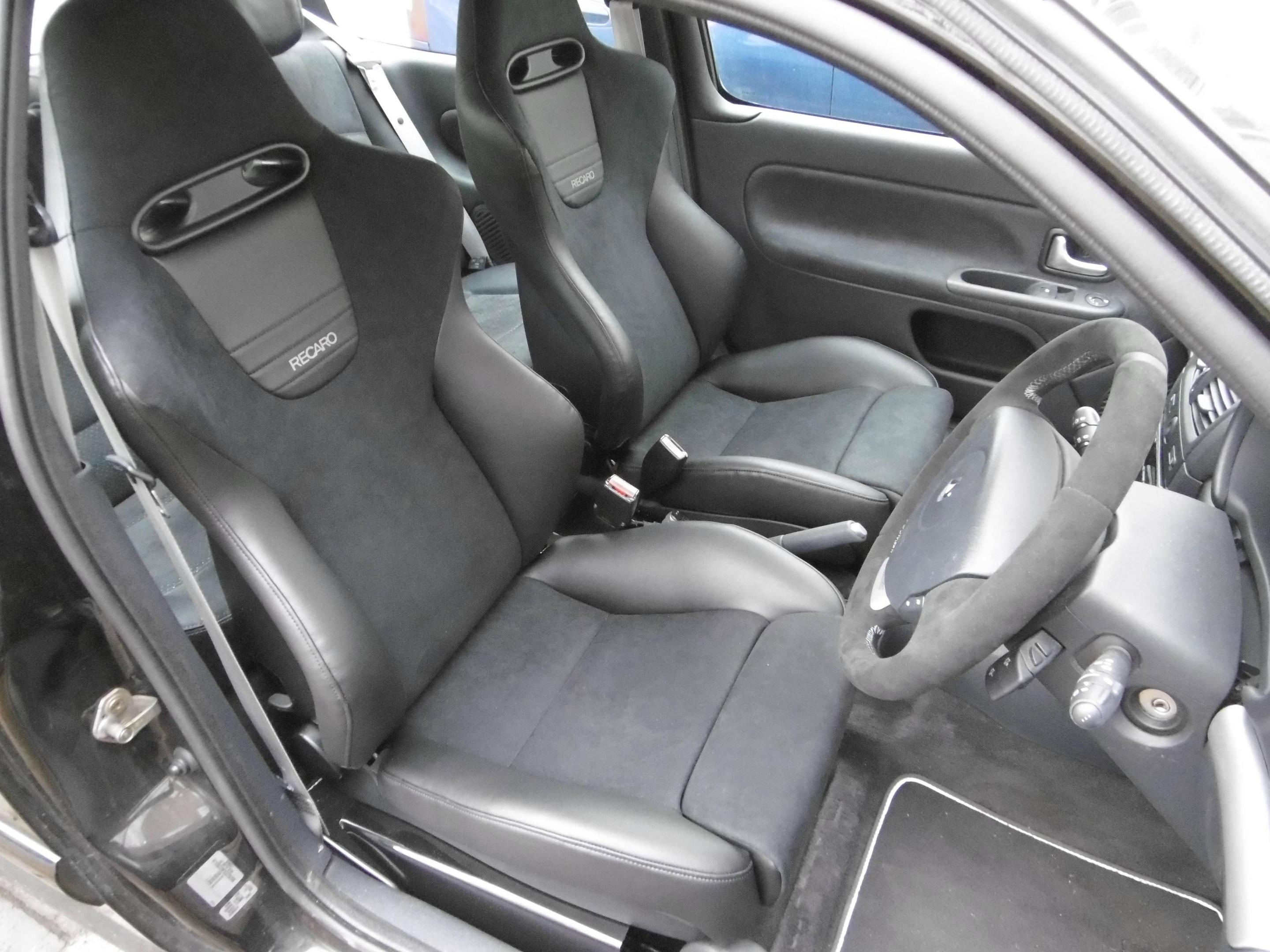

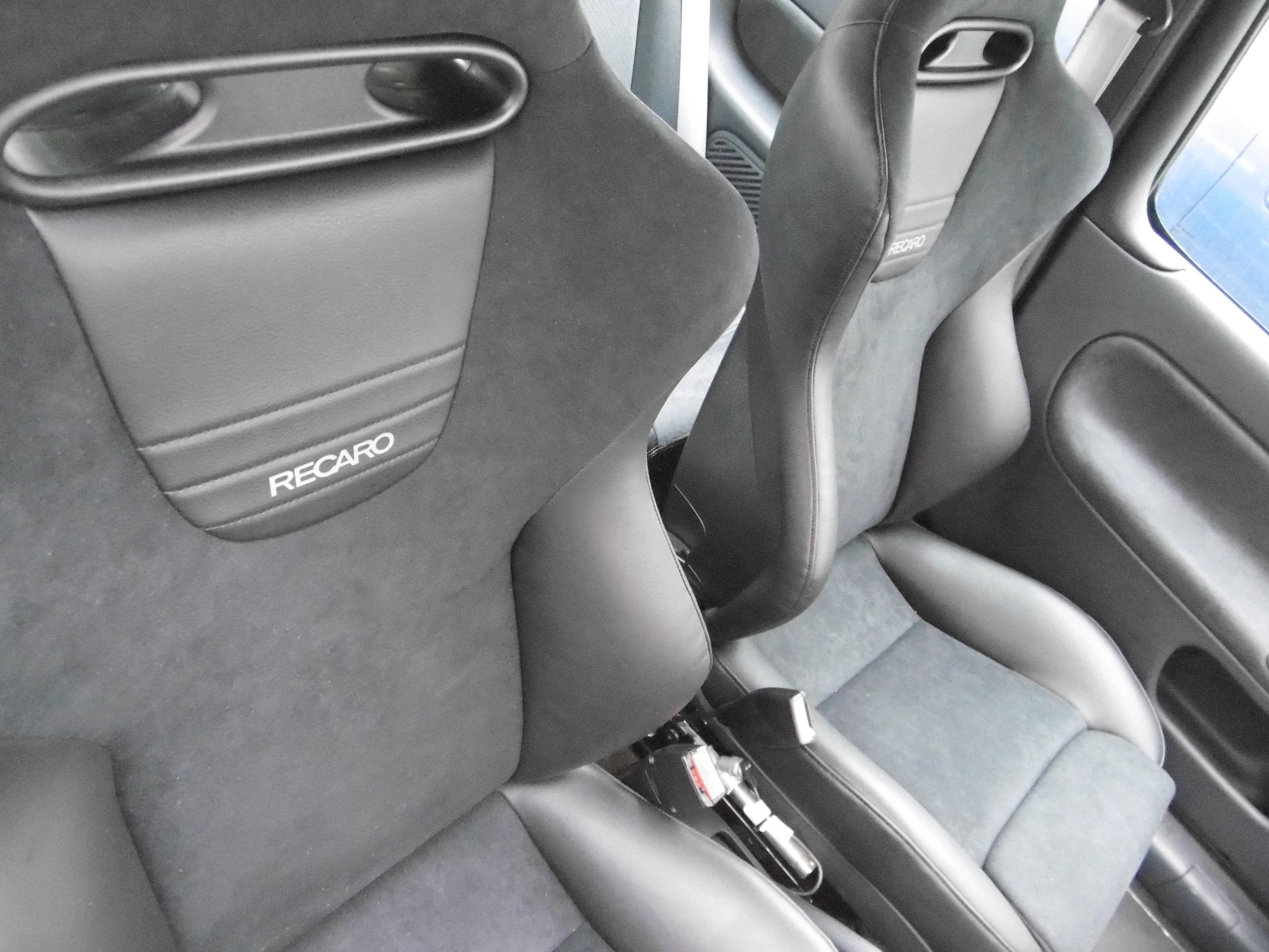

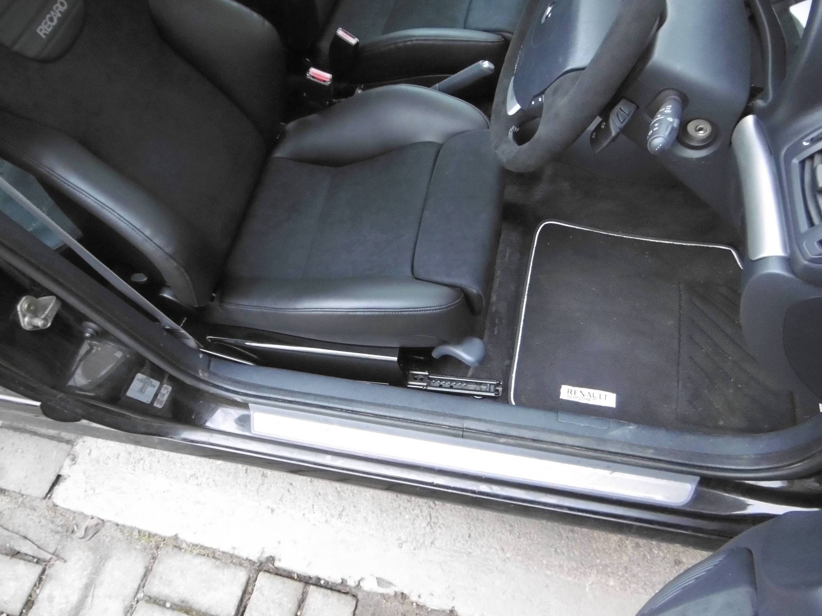

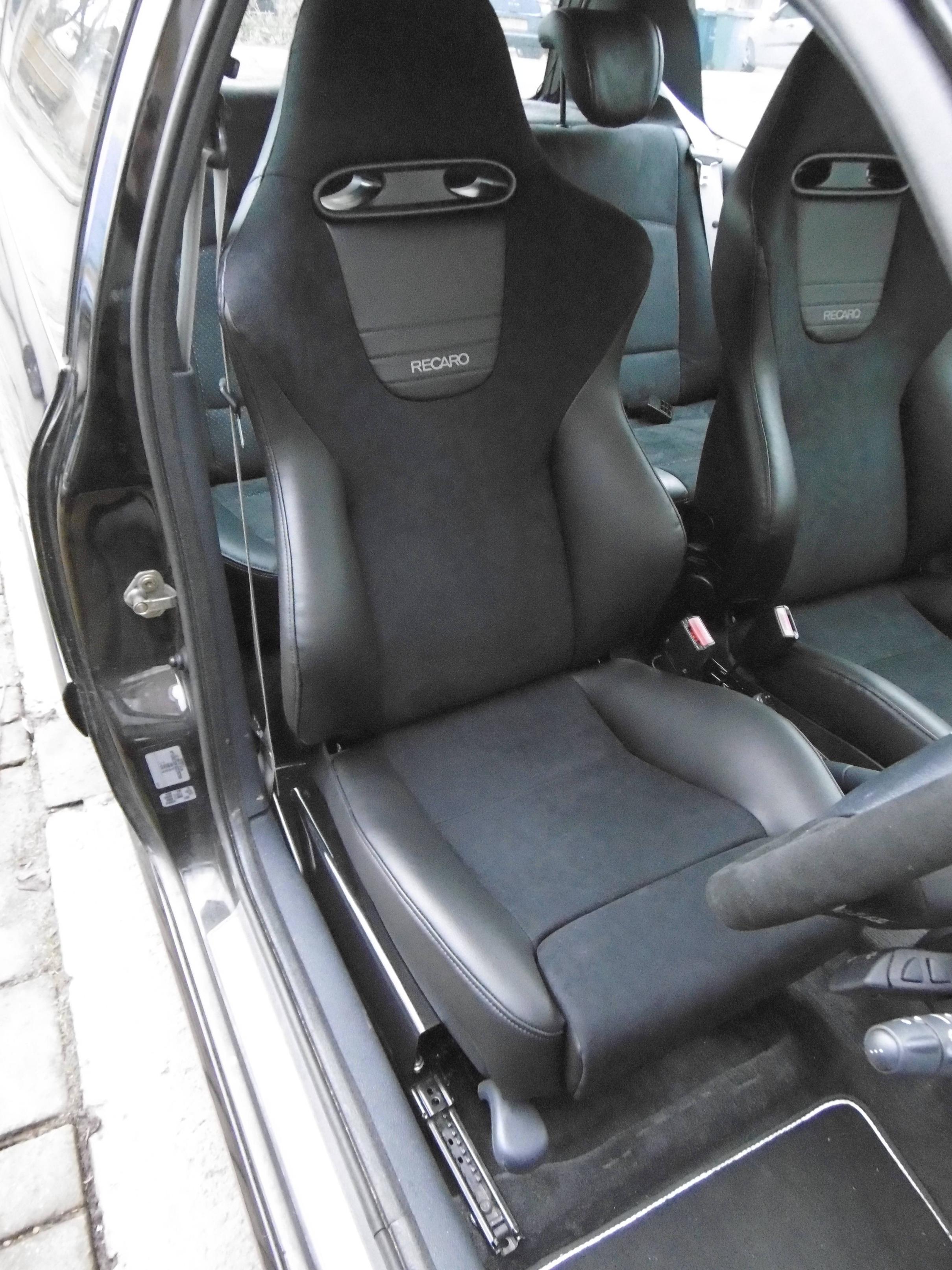

Had a quiet weekend so thought I would start getting my interior sorted.

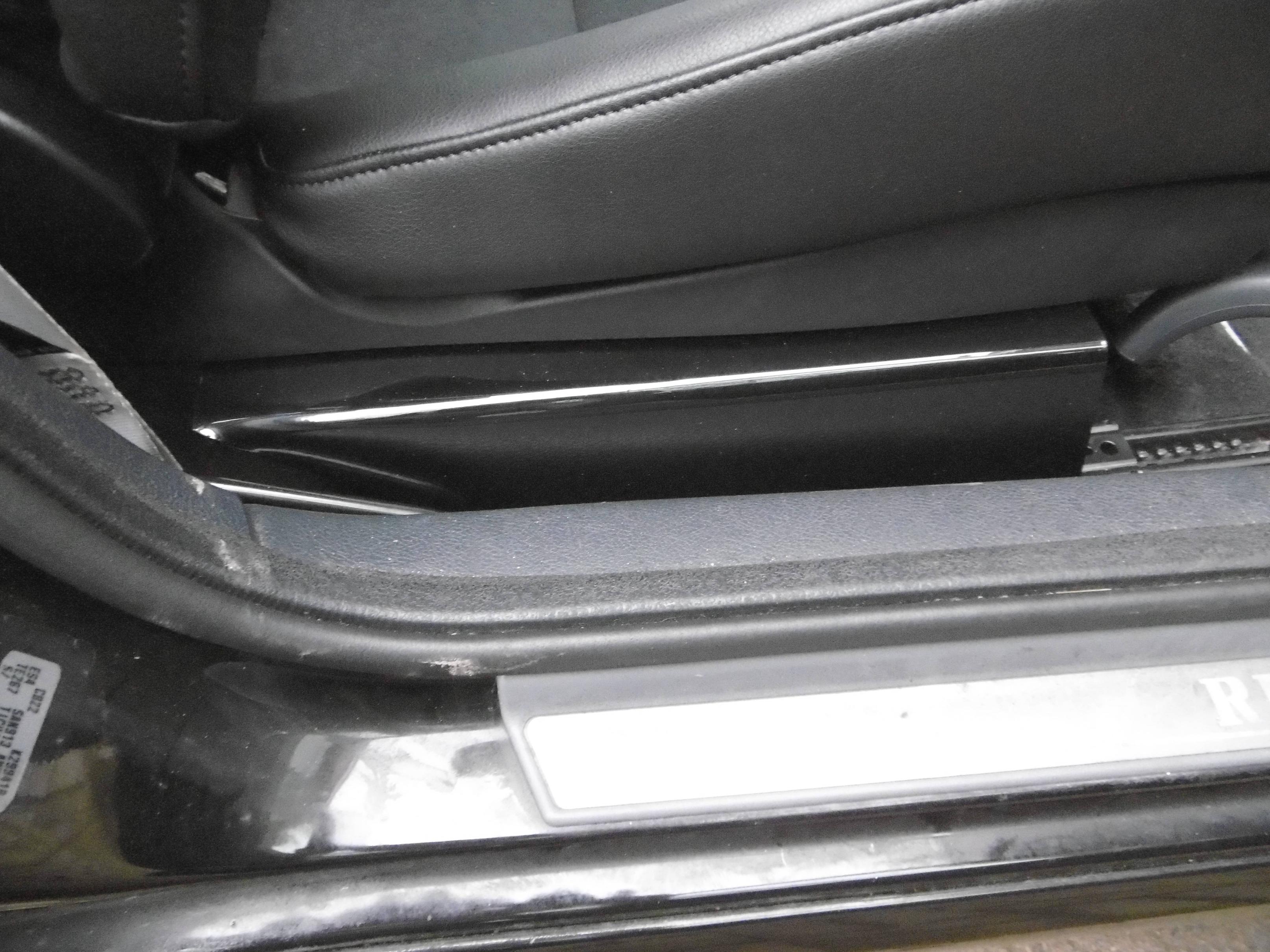

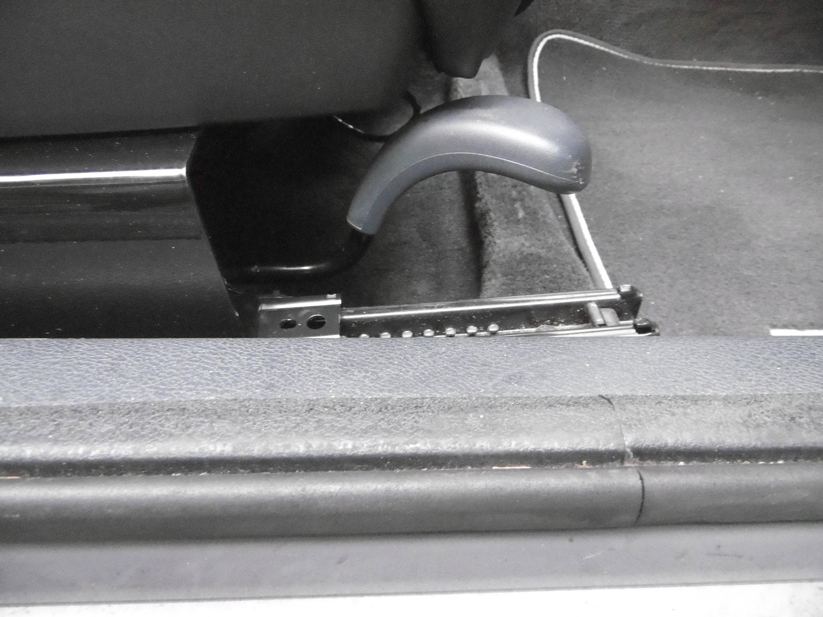

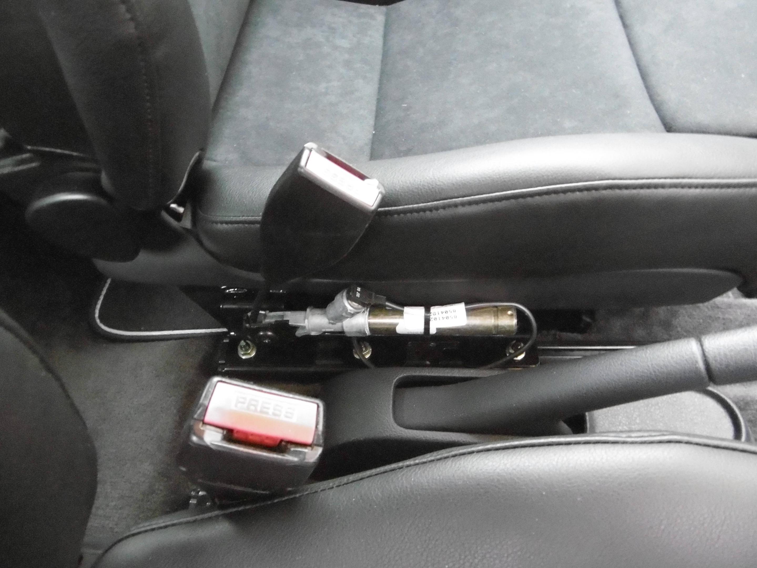

Got these brand new Trendlines a while back and just needed the frames so I could install them. Got the frames off @JON FOZ and they are absolutely fantastic. The frames are identical to recaro Frames but made with better materials and powdercoated in a nice and oem black. The frames fitted perfectly and didnt have any troubles with them. I did have a few problems with getting the old seats out though. Two of the seat bolts were under my Milltek centre section. I ended up having to undo the olive joint to move it enough to get to the bolt. This was fine but now that I have refitted the olive joint it is blowing a little. I have ordered a new renault olive joint along with some exhaust paste to help it seal.
I also soldered in the 3.3ohm resistors and that worked a treat. No airbag lights for me. need to cable tie the cables as they are loose at the moment.
anyway here are some pics.

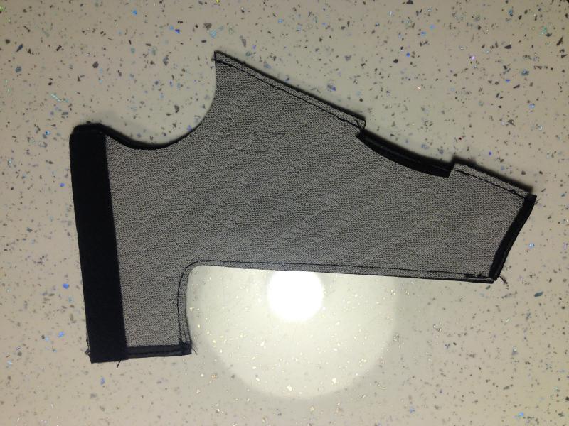

Need to get a leather cover made up for the seat belt pre tensioner.
I have got decals for the frames but to be honest I think they look better without.
These frames also retain the slider handle

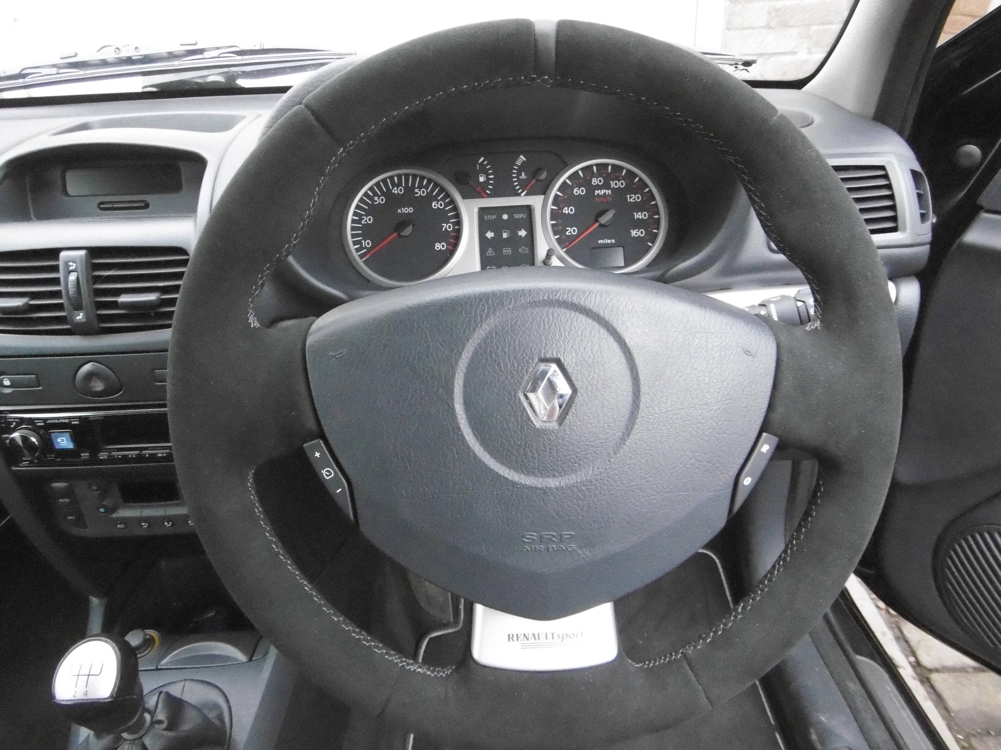

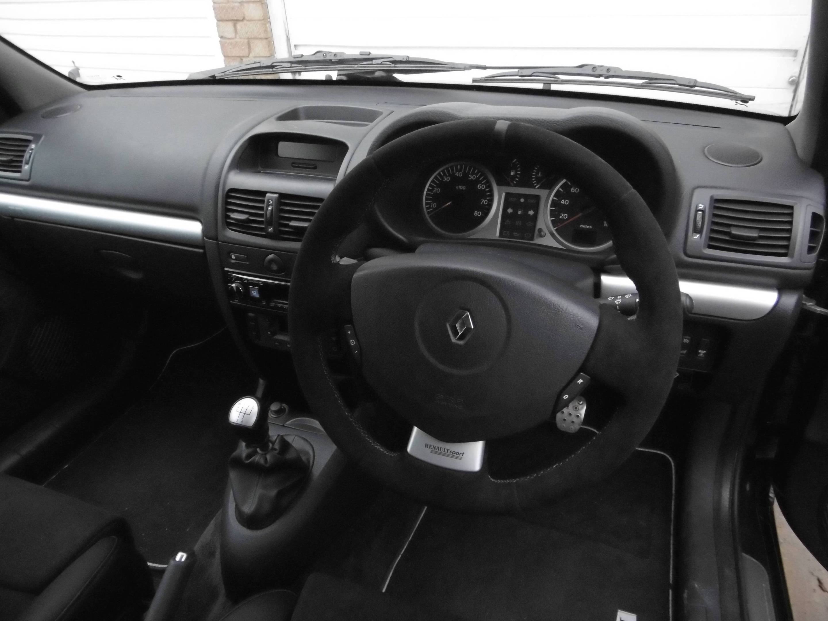

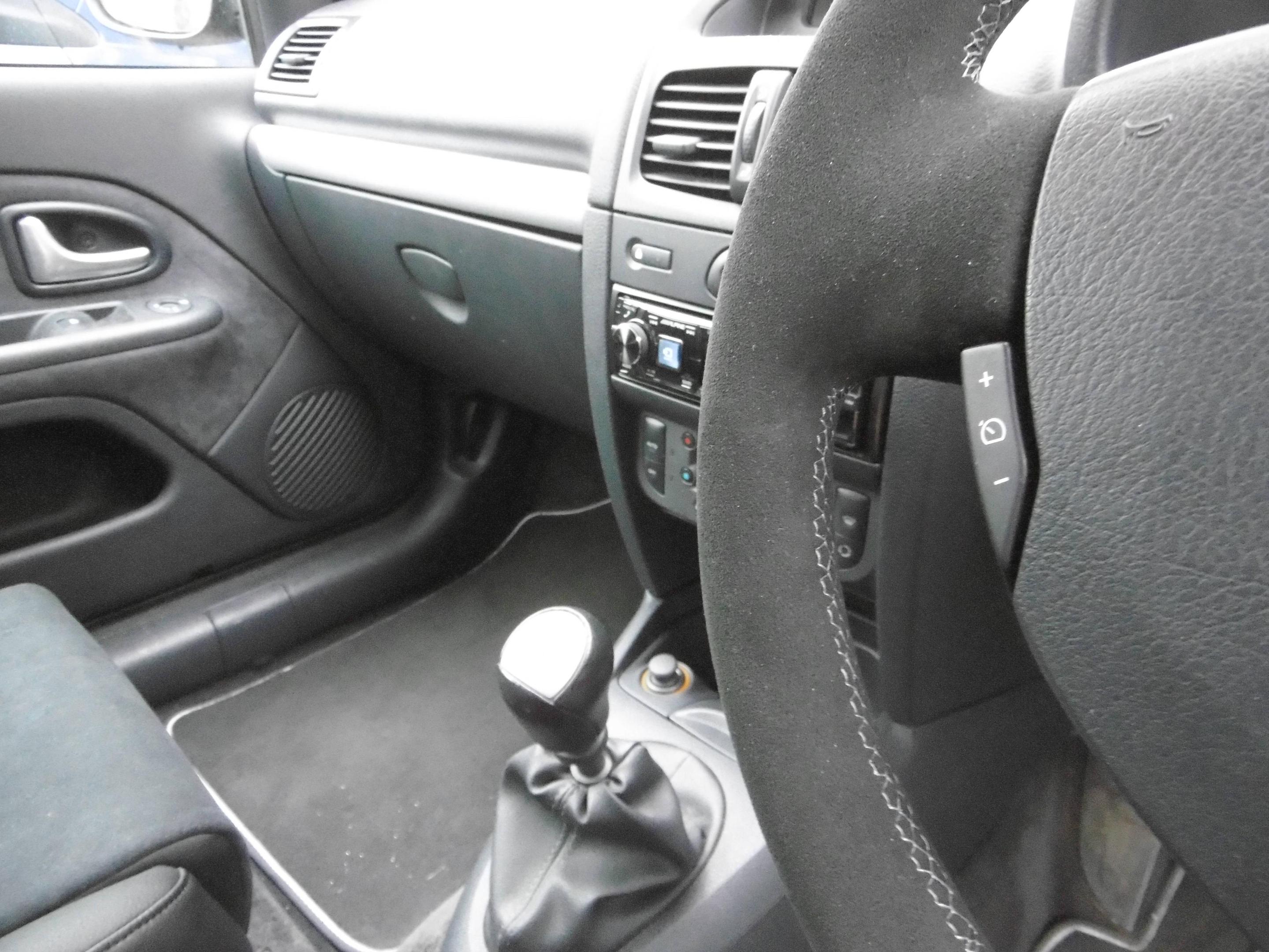

I have also had a steering wheel retrimmed by Royal Steering wheels in Aylesbury. After seeing Anthony's @gambit steering wheel I knew I had to have a chunky alcantara one. It feels so nice in your hands.
I was really pleased with myself after fitting the steering wheel. But that was short lived. I connected the battery and switched the car on and got the dreaded airbag light. I will need to remove the airbag and check the connectors but will leave that for another day.
After that I tidied up my underseat sub which I had run the cable under the carpet to the day before. Looks great now.

JON FOZ
  EVO 6
Looking good,I bet you are scared to sit in those seats,I've got a leather cover here you can borrow if it helps to get some made for your pre tensioner.

Hi Jon, that would be amazing. thank you for the offer. Can I still buy those bearings off you, that way you could put the cover in the same package. Is it Ok to borrow the cover for a week , two max as I need to buy some alcantara off ebay. Will pm you this evening.
Cheers
Gus
JON FOZ
  EVO 6
Yes,I've still got bearings,can pop them all in together tomorrow if you want,I didn't think about getting the covers made but alcantara ones sound nice,will look into that to offer them with the adaptors,thanks for the idea ;)

Yes thats the one, few advantages and disadvantages:
You dont need different boot struts and the boot will open all the way (trophy boots only open silly low and will catch your forehead guaranteed a few times over the course of your ownership.
Its cheap, comes with all the washer jets , nuts bolts etc.
Disadvantages are you will need a standard light strip off any mk2 clio (not the cup spoiler light strip) They are cheap though.
Also it will need a bit of messing about to fit it. I had to expand a mounting hole on the clio and also dremmel a hole too. easy though.
Painting it cost under £100 for me and luckily the shop did a great job and it hasnt reacted or anything, its perfect.
All in all its about £200 for everything - however you might get some money back from selling your old spoiler so not too bad.
