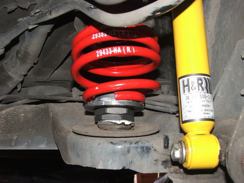

Fitted the coilovers today, fronts when on fine and are fine at the moment.
However, i have the rears set as low as they will go but they a riding higher than it was on eibach pro's by 10mm. I can't see any other way to change the way i have assembled everything, yet it doesn't look right?????. Anybody got any ideas??
Pic of how it is now.

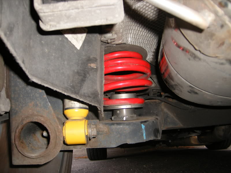

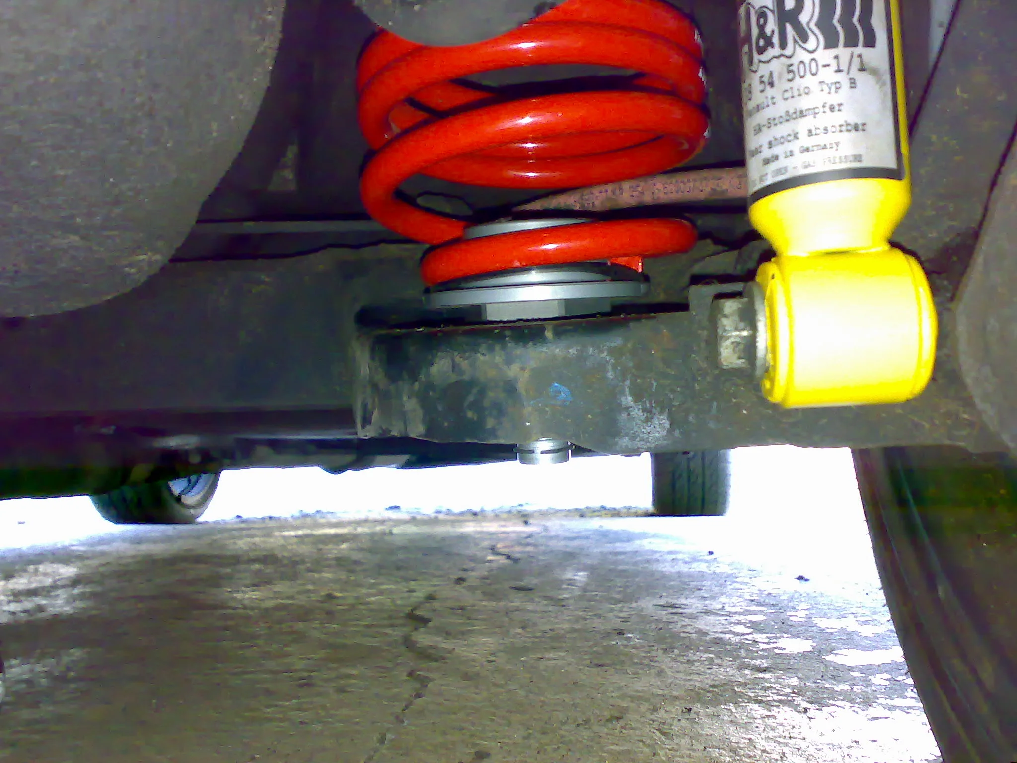

fiited wrong, take the rubber off that the old spring sat into.
Push the adjuster in the hole in the axle and put the nut on the bottom.
me either.. well dodgy..
ping... pong... smash... "what was that?" eh that looked like your spring going thru the windscreen on the car behind!
Bloody hell, im glad you came on here and asked for advice and didnt just drive it!. That looks damn dangerous!
