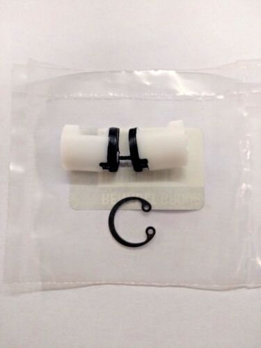

Is that definitely your gearbox? The sharp clunk and loss of all drive is exactly what happened when my driveshaft let go. Plus the crunchy grind when trying to engage any gear.
Granted, it did damage part of the gearbox in the same process, but you might have been lucky?
I had a look at both driveshafts, and they were in place and not loose
Ive changed 2 x driveshafts so far, with varying degrees of noise, and it doesnt sound like either of them
I wish you were right, but feel that it is gearbox
Was my original thought within about 2 seconds of the problem happening
Hollidog
  182
It's just a circlip that holds the Bush in place, they can fall out. Can access from under the car easy. It doesn't sound like what you describe through, you can still get into gears but not the one you're expecting, 5th where 3rd should be, can't find reverse etc.

So, I have now got a used Cup gearbox (129) in the car (Last friday)
When the Mechanic took the old box out, clutch needed replacing too. Fair enough, thats done too.
He then told me the circlip is fine, so the original box must be damaged elsewhere
He then called me this morning, saying clutch and gearbox replaced, and issue is still there................. (So the original box is fine???)
He then takes out the drivers side driveshaft, and apparently there is a "spider" mechanism he referred to it as, in the driveshaft, which has failed, and that was only replaced last year. He has another driveshaft which he has fitted, which he thinks will do the trick, but has yet to road test it. He has contacted Autodoc and complained about the driveshaft he fitted last year, and they will refund or replace under warranty- but he doesnt like the quality of it
All very bizarre- The videocam of when the box failed, dont half sound like the gearbox gone (Circlip) and several others have said so
All very strange.
