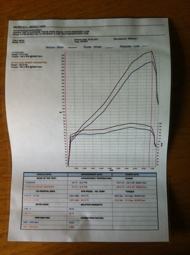

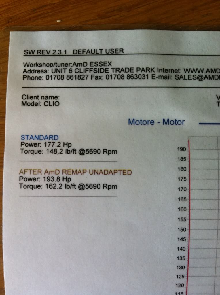

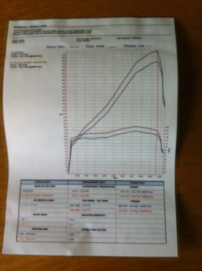

As stated above i had my car remapped at AMD essex, an all i can say is im very happy yet skeptable about it....My car only has a full decat milltek system and a JMS induction kit and thats all, so here are my results ;
First run was at 177hp
After the remap and run it put out 193.8
Has anyone had there clio on the rolling road at AMD essex, i am over the moon, but i can definatley see a few people in doubt lol, but hey im the one driving lol enjoy.
177bhp sounds about right really. Give or take. A lot of 182's are lower than that as standard.
But 193.8bhp from just an extra map is laughable!

their pre-map figure looks quite an accurate figure for the car, so don't see why the post map figure would be wrong, but i prefer wheel horse power figure as its not a 'estimated' flywheel figure :)

according to your graphs it was done at 0 deg and even tho nothing has changed the correction factor from the first and second run has changed ??????
Most dynos can be altered to read harsh / generous. Bogg brothers did it for a laugh with Thorpeys vts'd Citroën ax. It ran and made 380hp at the wheels on a standard engine.......

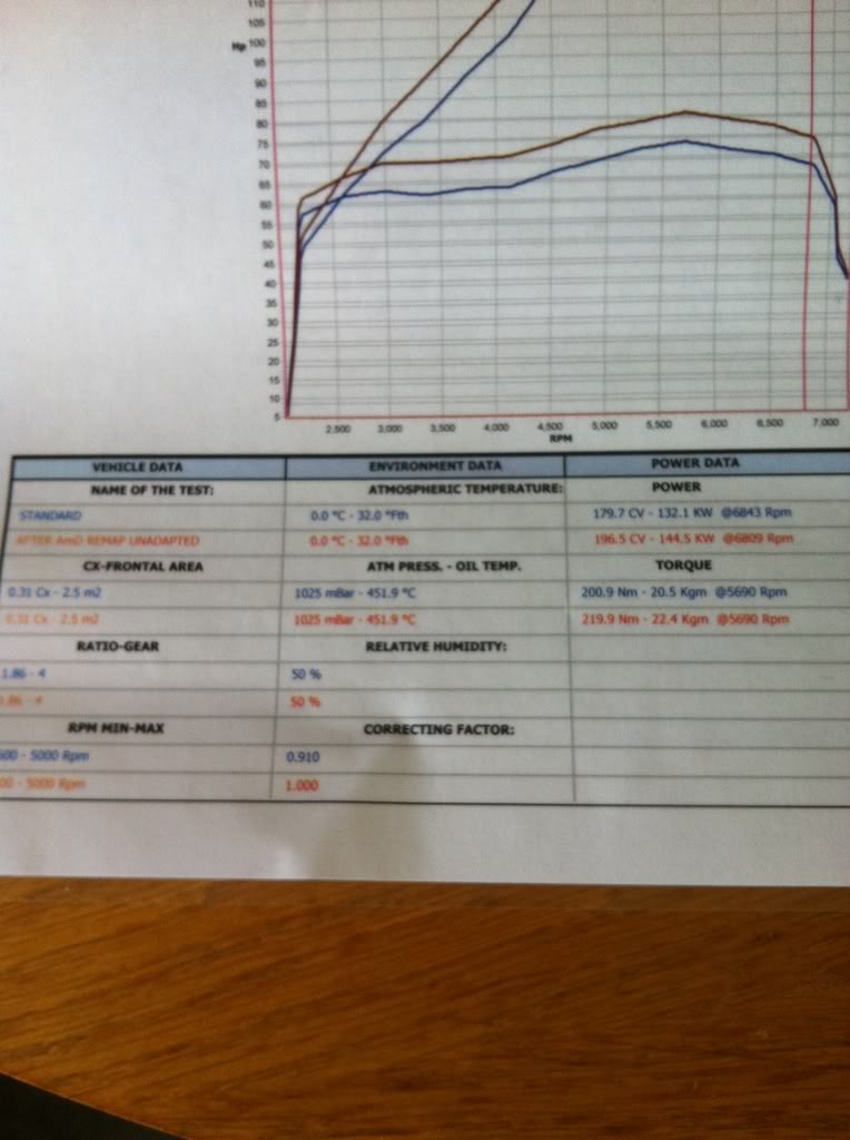

Correction factor @ 0.91 = 177 bhp
Add 9% to make:
Correction factor @ 1.00 = 193bhp
Now, i dont know the ins & outs of rolling roads, & correction factors, etc - hopefully someone will help me out here?
But is it coincidence that the correction factor has changed by exactly the same percentage as the power?
From a maths perspective, its looks like they changed the correction factor, & got more power.

I think that correction factor is quite simply a fiddle factor to multiply the result.
Add 9% to make:
exactly my point, the correction factor is worked out by the air temp(which is 0???), pressure and humidity which none have changed but they have changed it to suit them

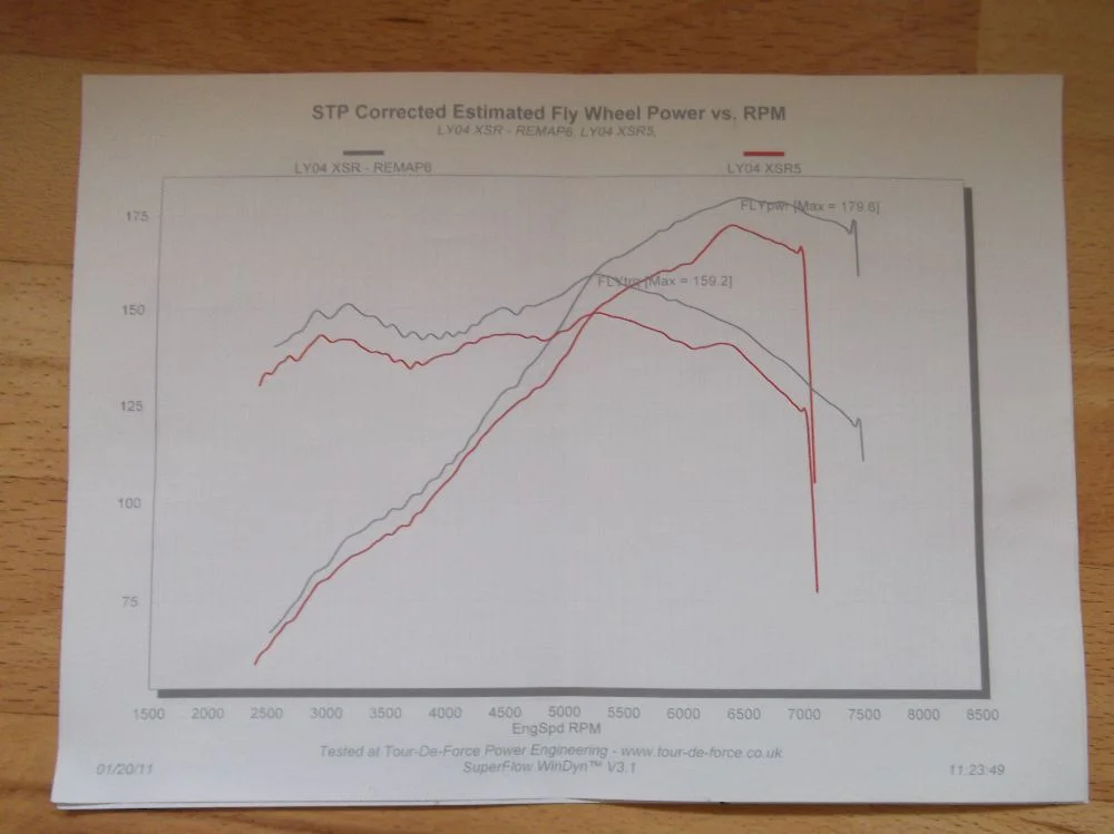

What a real dyno would say,before and after remap.

Before mapping 172.2 bhp 149 ftlb
After mapping 179.6 bhp 159.2 ft/lb
And as other people have said the car feels much better to drive,no more bunny hoping from cold and much better torque lower down the rev range,the 5 k kick is smoother and more willing to hit the limiter.This is what a remap is all about really,how the car drives,and imo its the best value mod out there.
