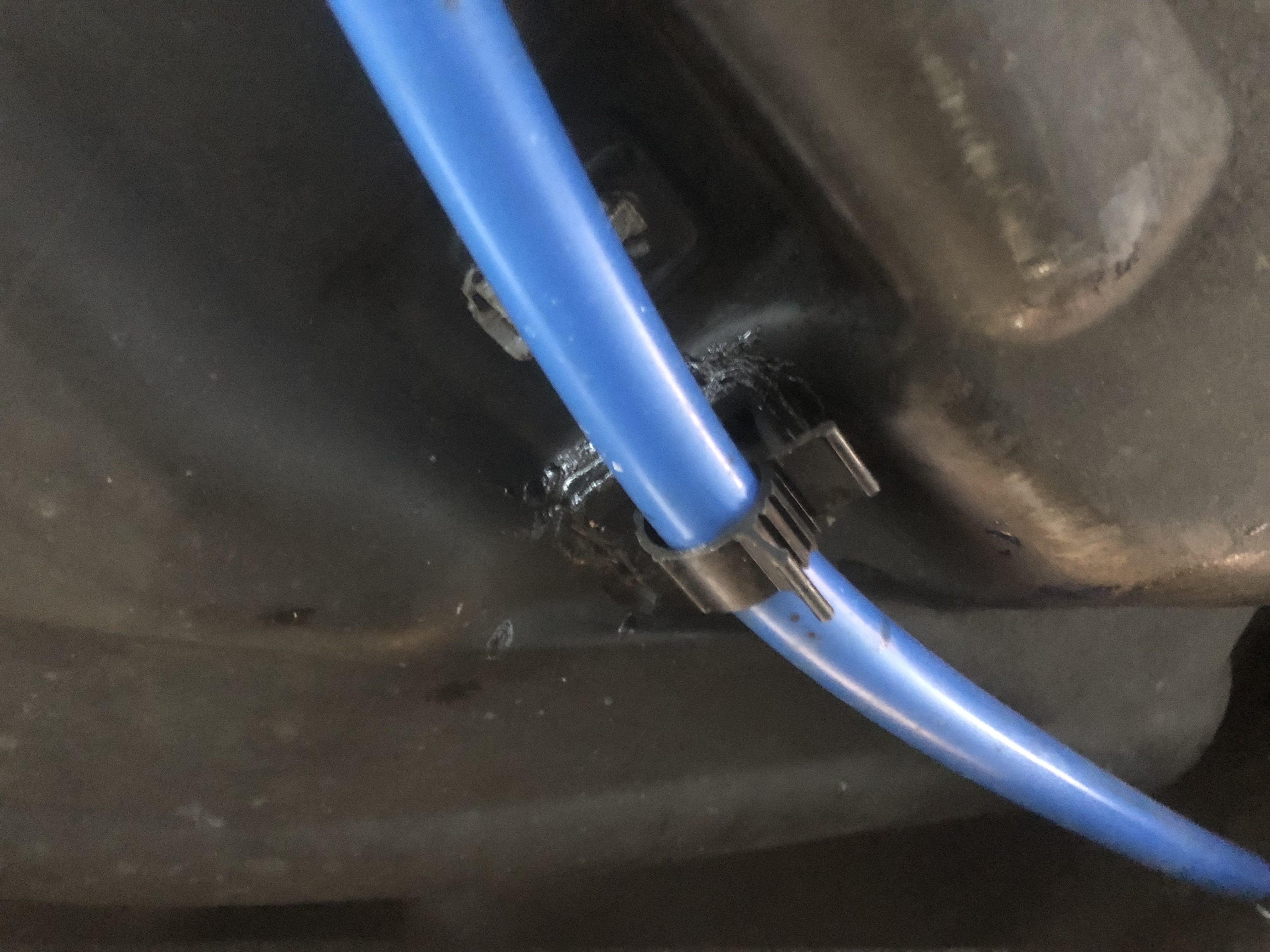

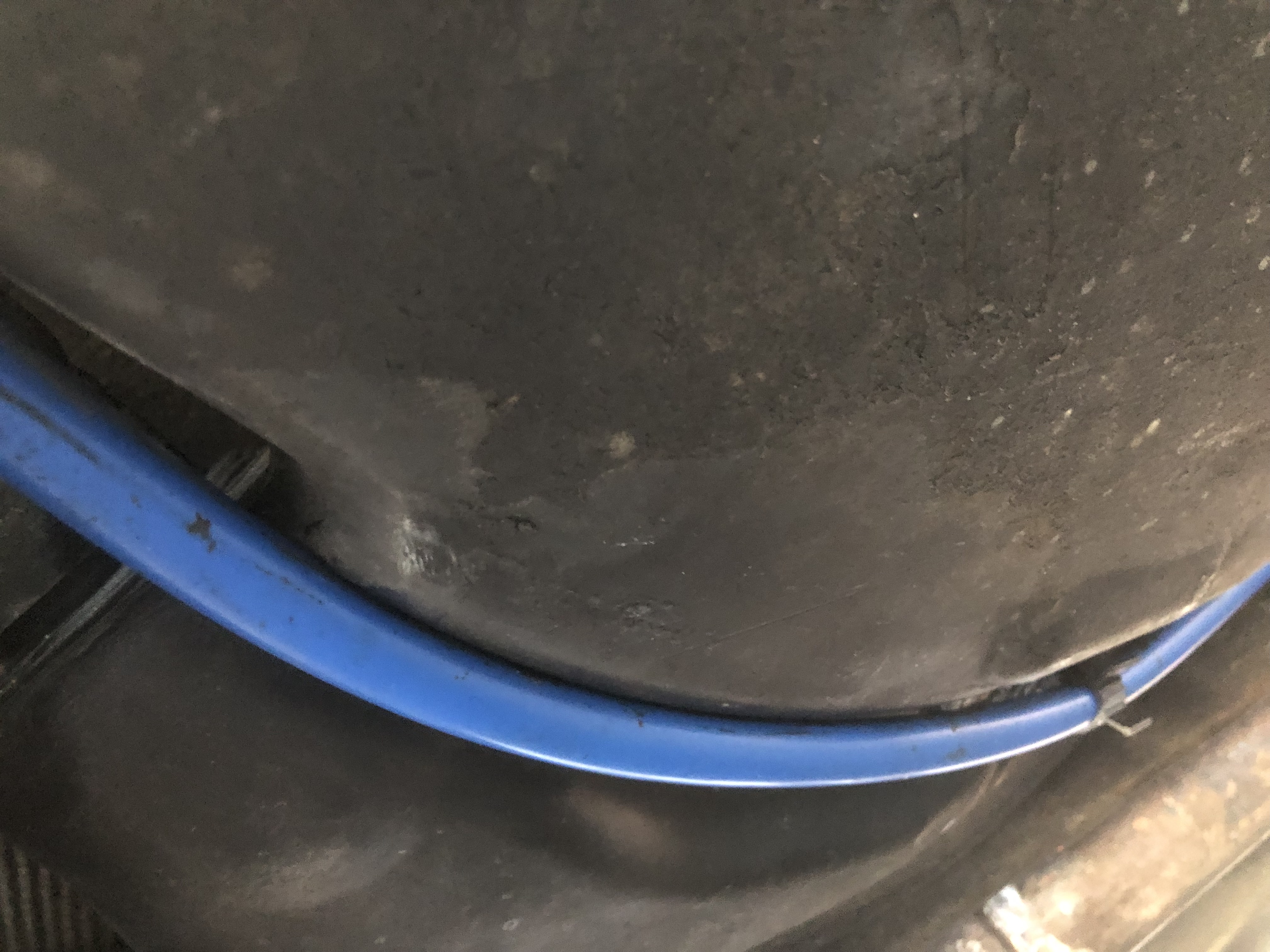

Hi all,
Noticed mine has completely sheered off at some point and my handbrake cable is just sort of dangling down a bit and im slightly worried about my impending mot.
Has anyone had any luck replacing this and what with? I'm hoping its just one of those push fit 'fir tree' connectors and I can shove one of these in instead link
(Sorry s**t pictures from eBay listing)

Pretty sure the clip is plastiwelded to the tank, either that or glued. Id be interested in this too as mine is the same. Ive used a zip tie but would prefer to replace the clip with something.

Yeah it looks like you're right.
I've ordered some of these: https://www.carbuilder.com/uk/self-adhesive-cable-clips-assortment
Im going to scrape the adhesive off and then use some JB weld plastic bond to stick it on where the original was but who knows how long that will last

I scraped off the adhesive on the clip and used JB Weld plastic bond to stick it on. You can get that on amazon for about £6.
I just cleaned the tank and scuffed it up with some 240 grit paper to key it but that’s probably overkill
