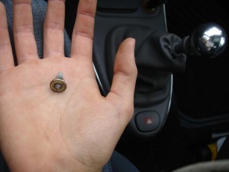

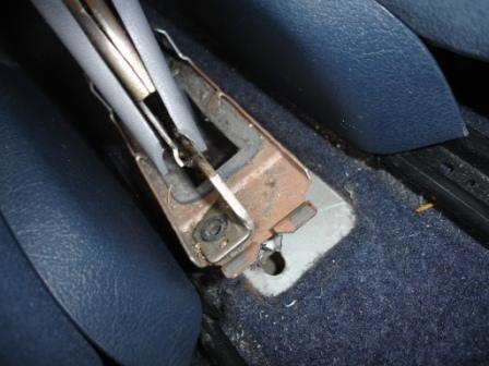

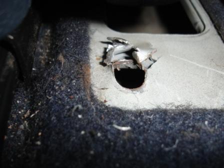

My hand break is BROKEN!! the cable is fine but the problem i have is that the screw that holds it 2 the main body of the car has come loose, snapped and broken and now the hole is rather large!!
Here are some PICS!!!! Any help would be good!!

Re: HAND BREAK HELP
is there enough room around the area underneath the car where the nut lives to be fitting a bigger bolt/nut/washer combo - or is it a box section?
Re: HAND BREAK HELP
woops! those handbrake turns didnt pay off well then ;)
Just going to be a case of a bigger bolt and washer mate. Get to a good DIY/screwfix or something and see what you can find. Don't panic. Make sure the bare metal where it's stripped out is painted over, otherwise you'll have rust issues later
Re: HAND BREAK HELP
i had a quick look under the car but i think its a box section so it might be tricky 2 replace. But i will see if i can pick up a larger bolt and see if that works, Cheers
Re: HAND BREAK HELP
You can buy from some motor factors and i know tweeks have got them as a kit is a threded insert which is almost like pop rivoted into the metal and that can take bolts in various sizes, ideal for box setion and double skinned panels.
Re: HAND BREAK HELP
fat nut and bolt and some washers will sort it
ive seen a clio handbrake which had rusted rite through the floor on a 52 plate lol
GRRRR damm thing, still cant fix it, The problem is that i cant put a nut and bolt through it because there is some rubber in the way which i cant remove, Also i tryed 2 undo the other bolt that is holding the back of the handbreak but i cant because it just spins and i cant grip it because of the RUBBER!!!!!!!!!!!!!
I dont really know what you mean, I dont think i can do that because the hole in the main body of the car is now alot larger than the hole on the handbreak, unless i made the hole larger by drilling it!!
Fixed at last!!! i put the car on axel stands found out that the hand break is not in a box section and found out that if i remove the exhaust heat shield its right under there, so fat bolt and washer saved me, cheers 4 all your help!
