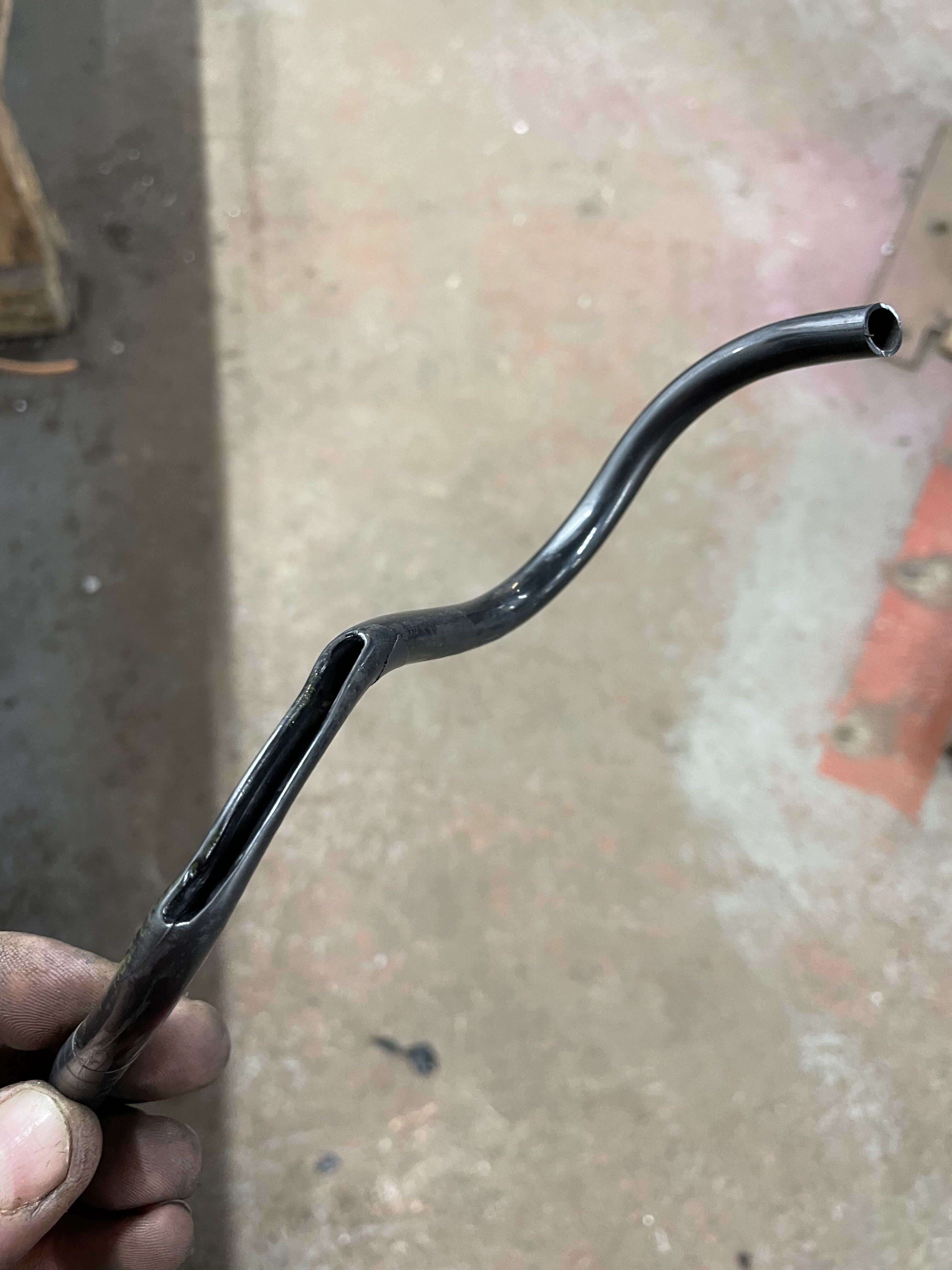

I’m planning on replacing discs and pads all round and the rear brake pipes,I’ve managed to get the o/s/r but no look with the n/s.however I’ve noticed when I press the pedal all feels ok and the brakes work fine,but if I go to press the pedal again it feels very hard and there’s little effort which can be concerning as I found out at Croft lol,any ideas ? Cheers

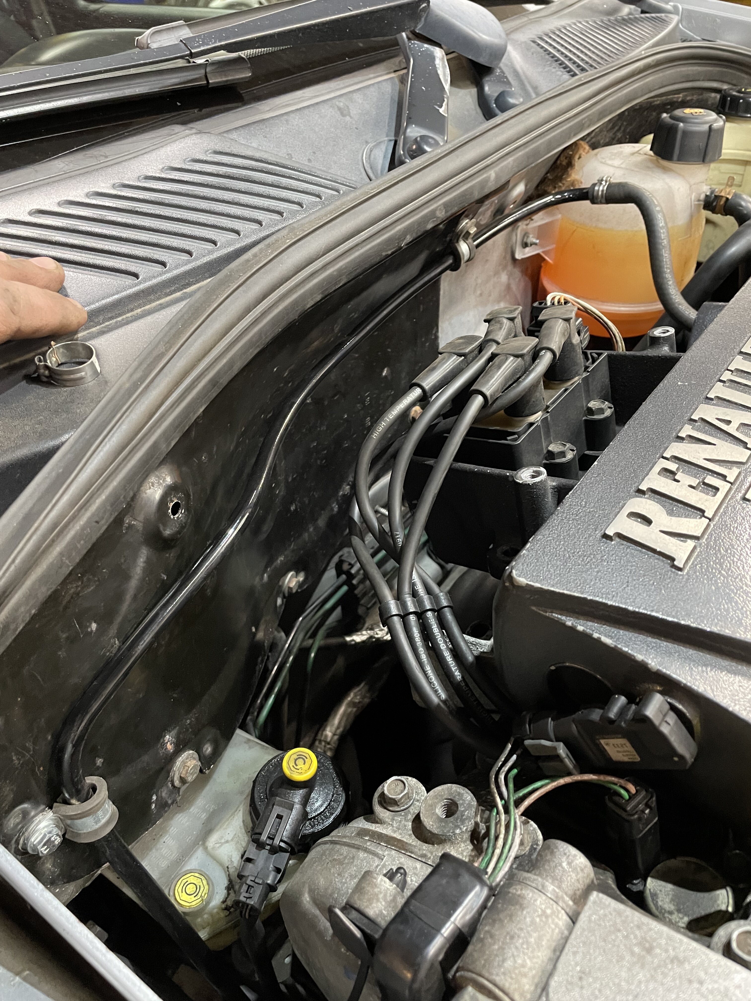

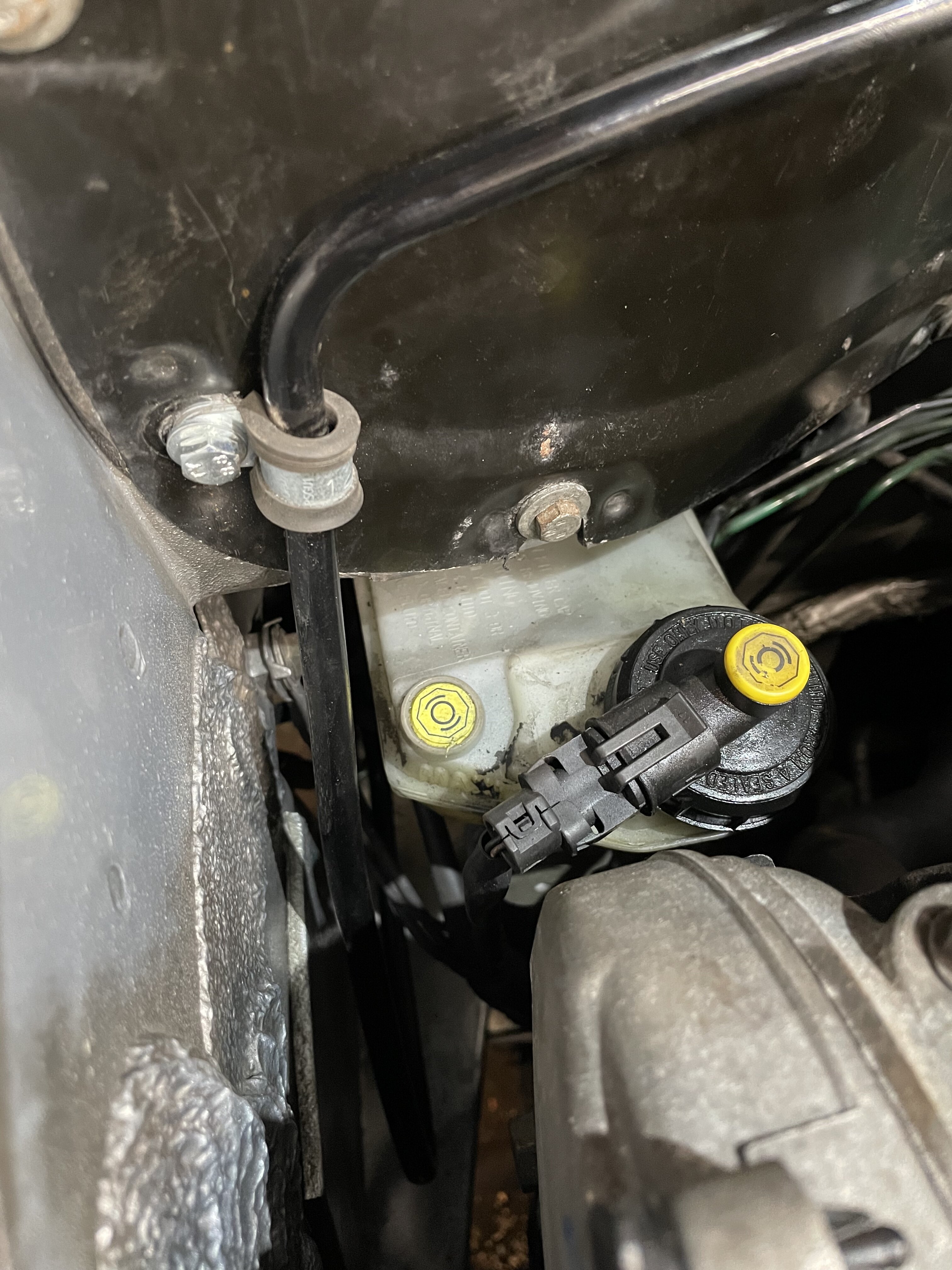

Have a look at the hard plastic vacuum line from the inlet manifold to the brake booster.
They can melt and collapse, giving you the symptoms you've described.
I’ve checked the pipe,it’s been wrapped in foil and insulation tape as it’s looks to have melted,also not available from Renault.

It’s had been well and truly bodged I’m surprised it even worked,I’ve made my own out of some 10mm brass pipe,thanks for your help 👍🏻
