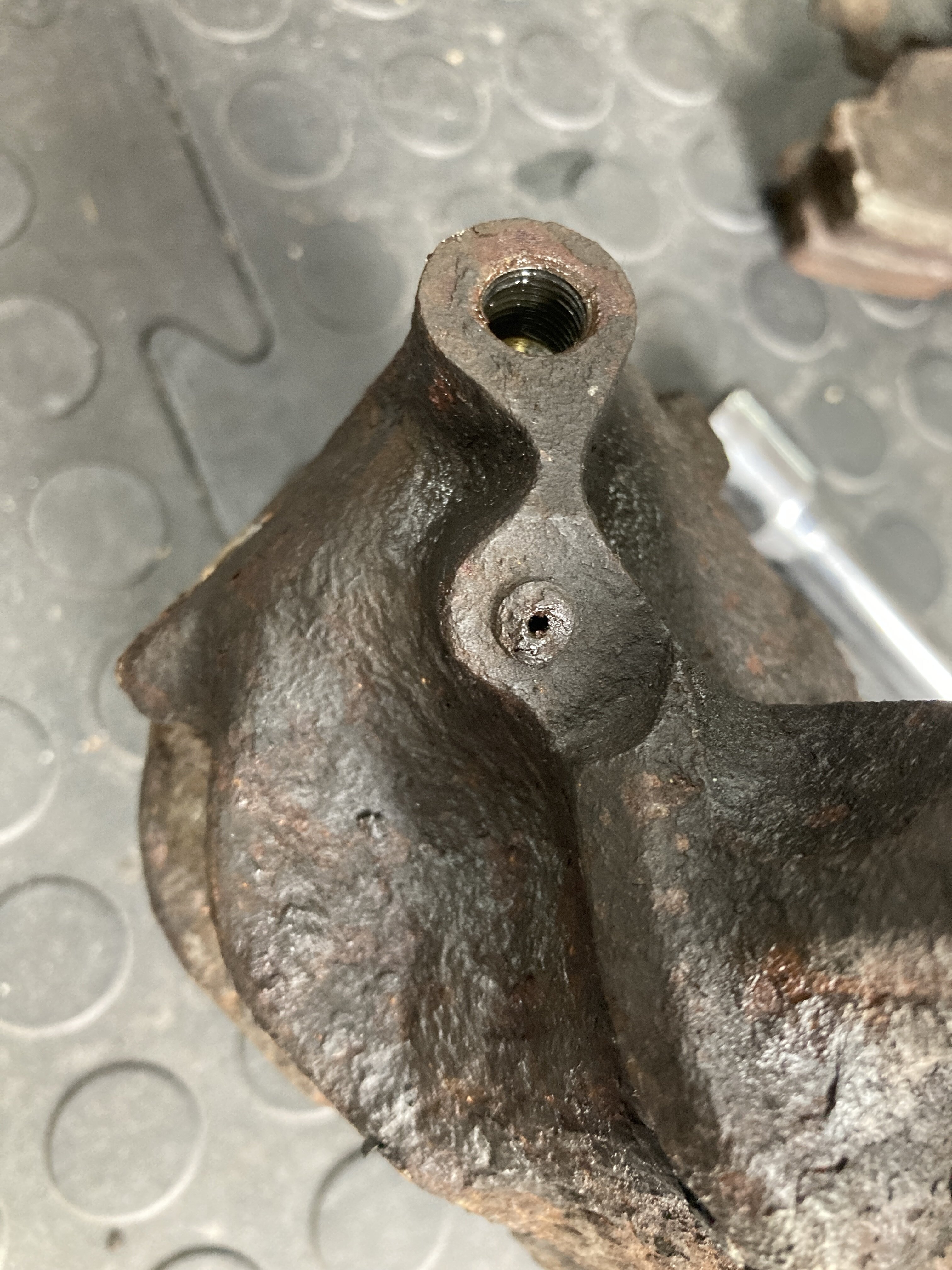

Thanks, no leaks that I can spot. I’ll probably need to replace the callipers. One of the bleed nipples has rusted off so unable to bleed it 😩

Rather than replace the whole caliper get the bleed screw drilled out and replaced.

I'm not sure if this is too obvious, but has my brake fluid leaked out of the bleed nipple snapped hole?
