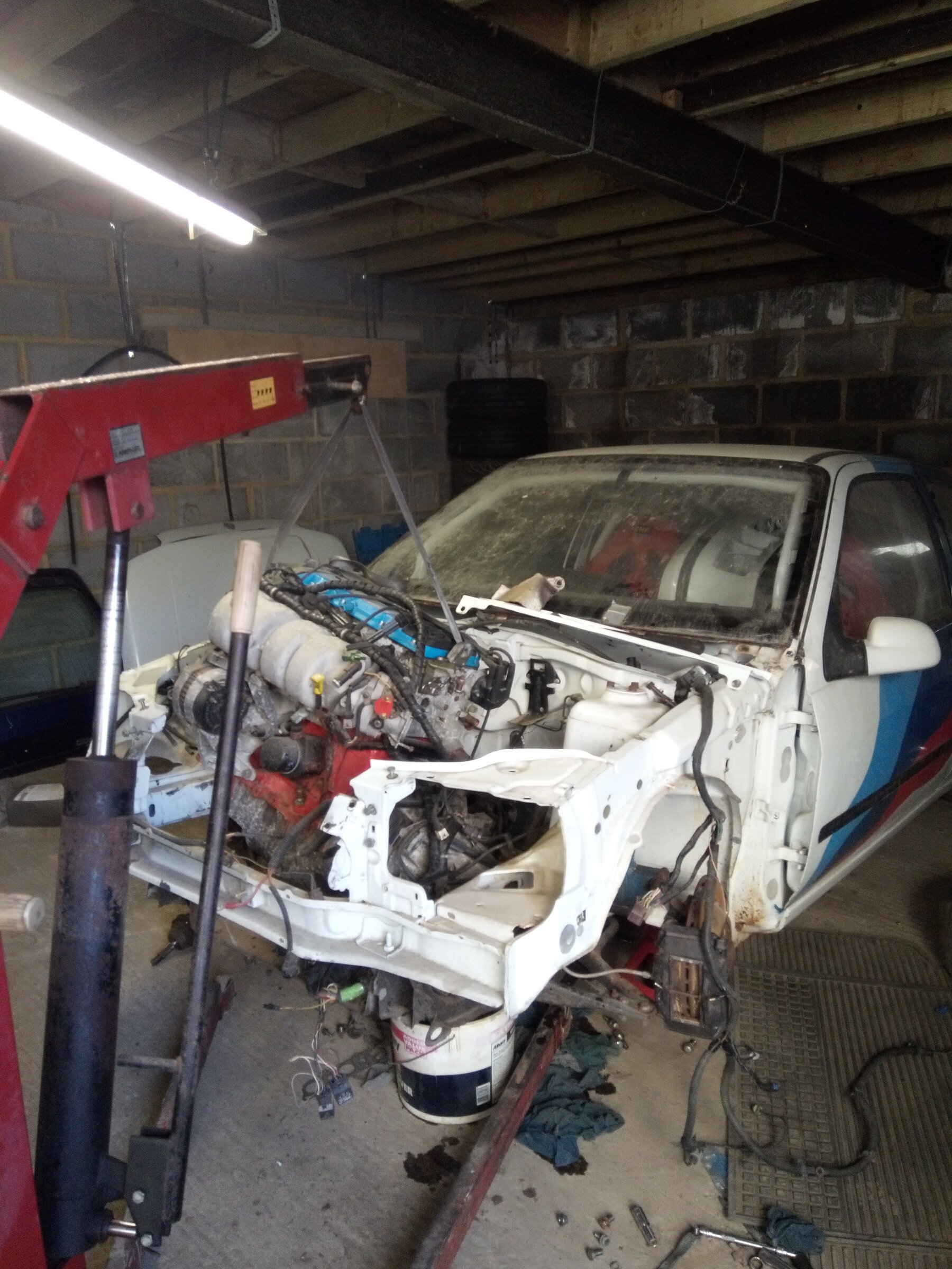

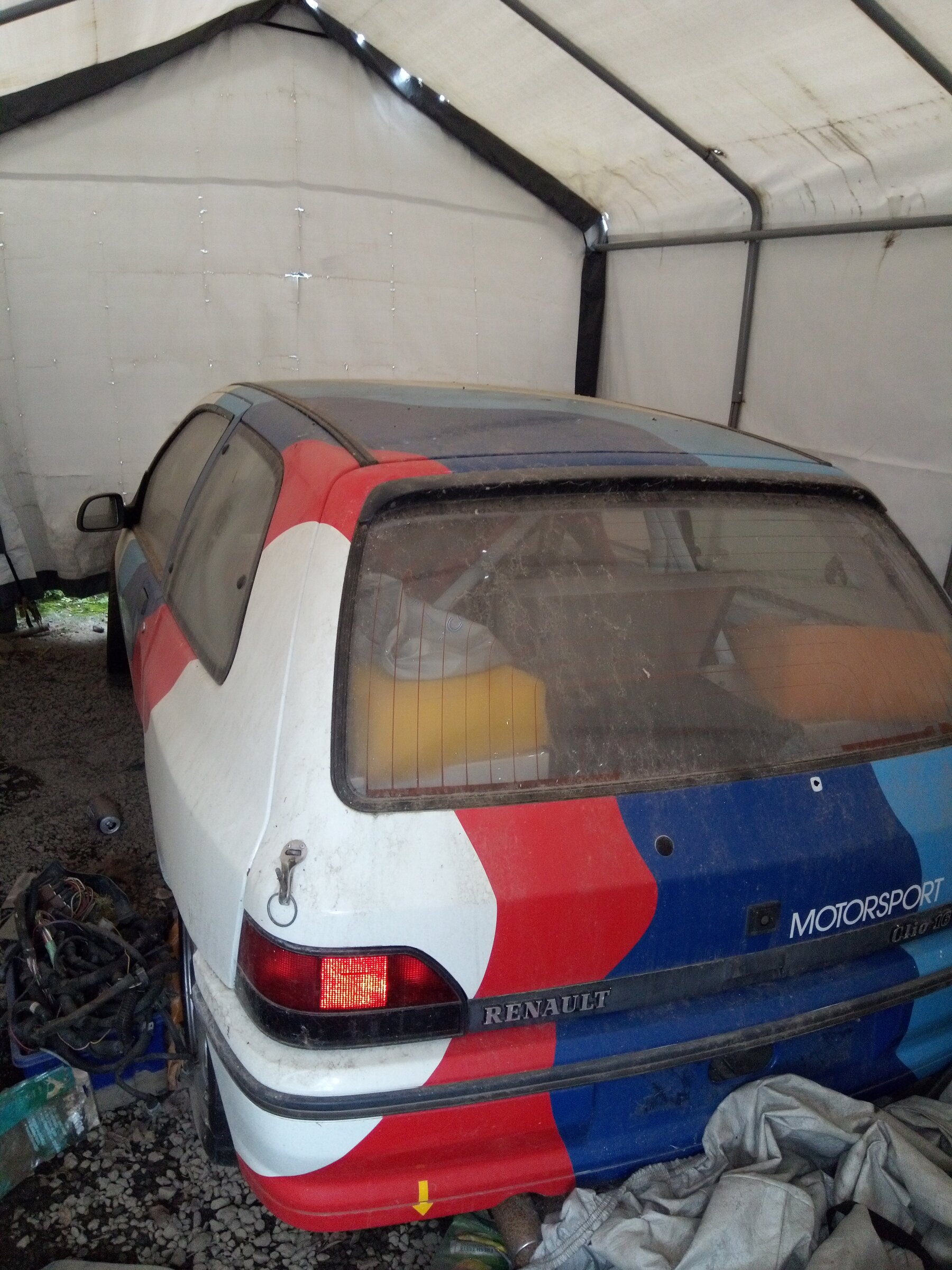

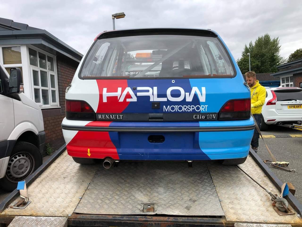

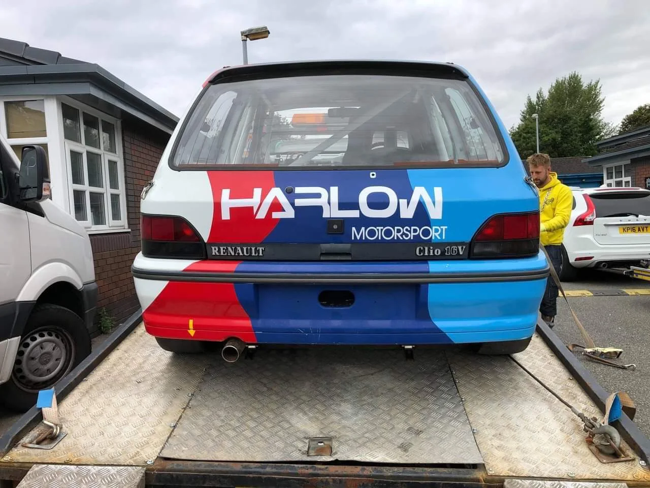

The car was a non runner and was covered in dust had Ferrari challenge bucket seats fitted in the front for some reason and the rear brakes seized on but I got it on the trailer and got it home ready for its recommissioning back into service it had a Williams engine loosely fitted in the bay and came with the original blue printed 1.8 Harlow engine a fibre glass bonnet and a second set of magnesium cup racer wheels needless to say I'm very happ with my purchase here's the first veiw I got of it

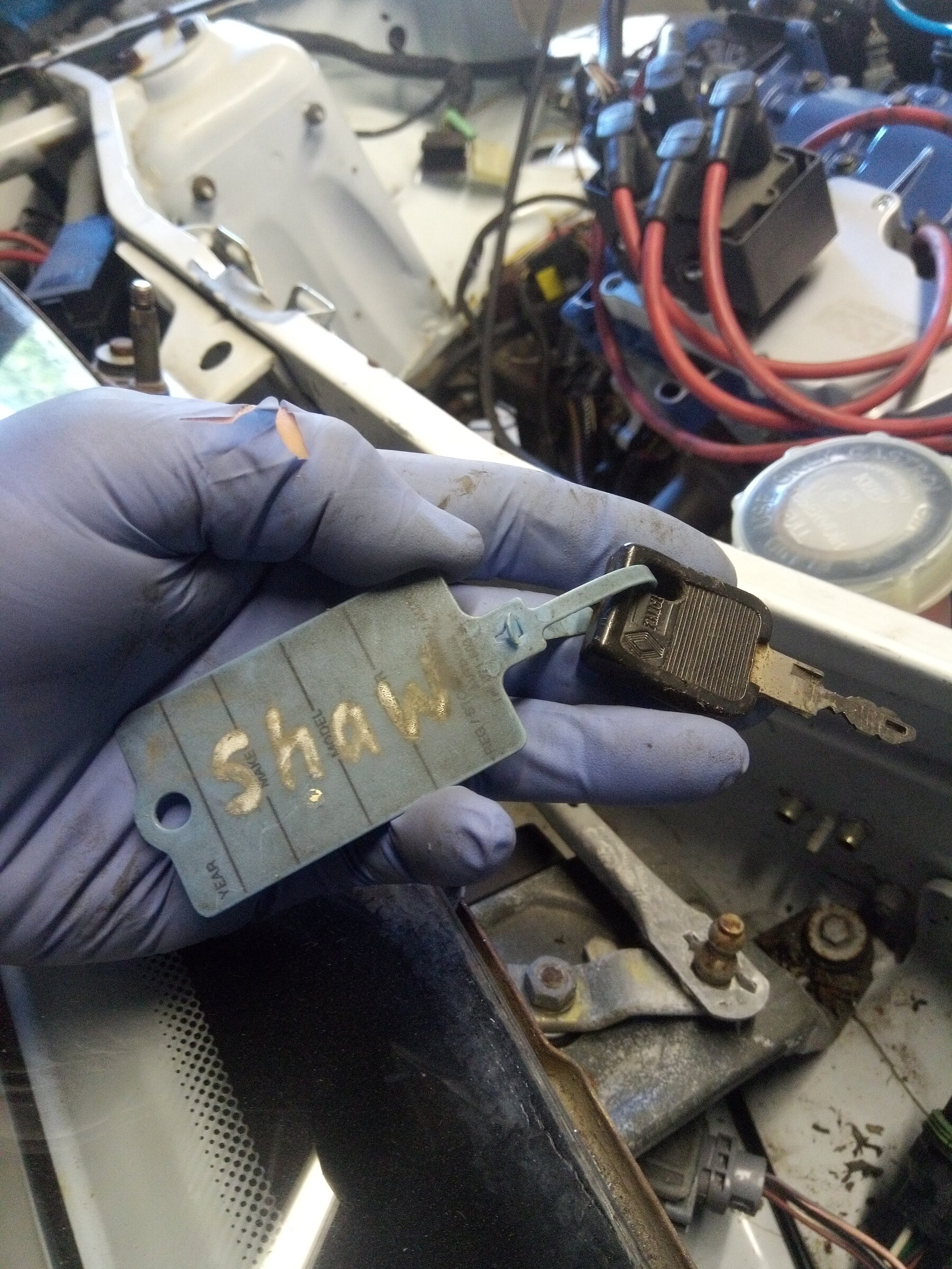

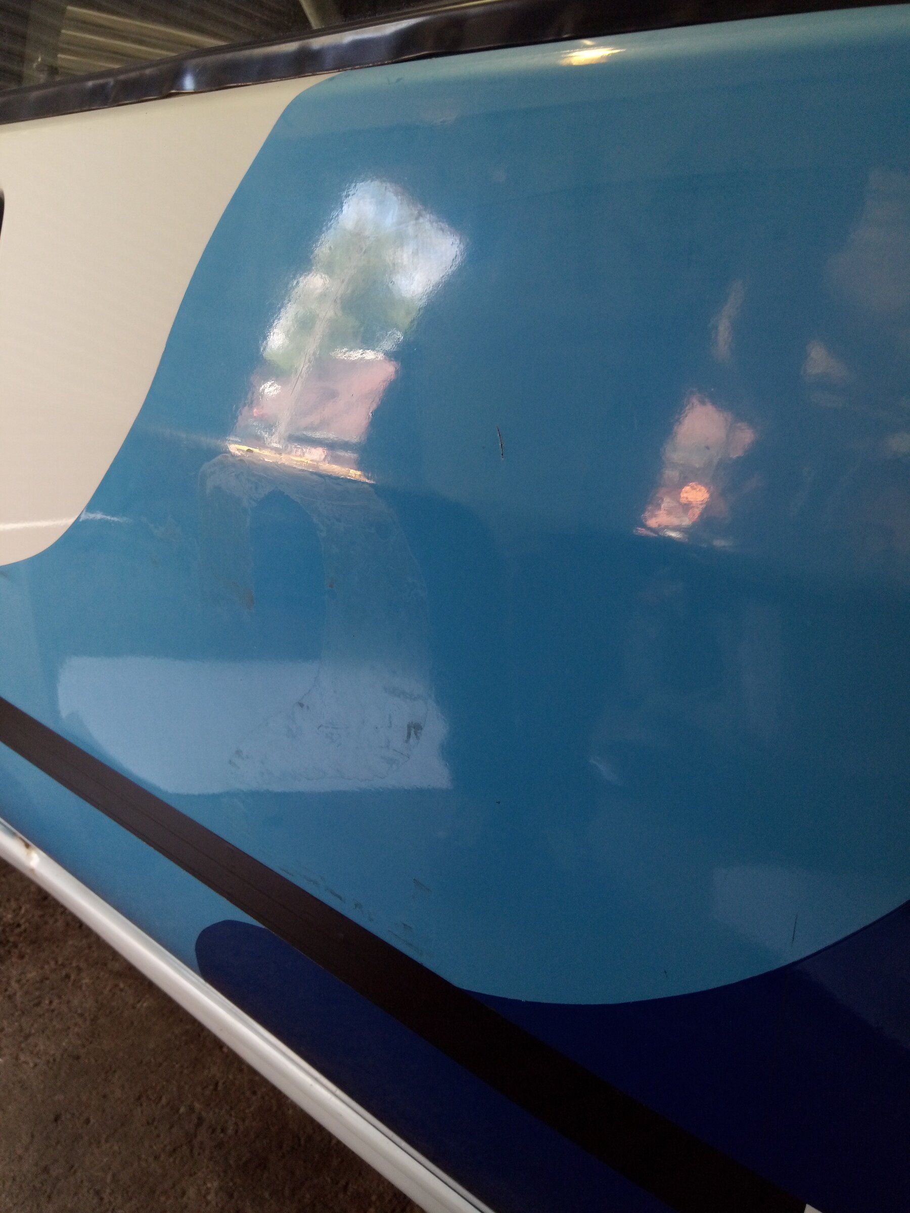

It's quite hard to see in the photo but where the white number square was on the door the sun has faded the paint where the white was and not where the black number two was looks like glue residue but it's not after a month of owning it I also noticed the key would have saved alot of research lol it's nice owning a little piece of history 😊

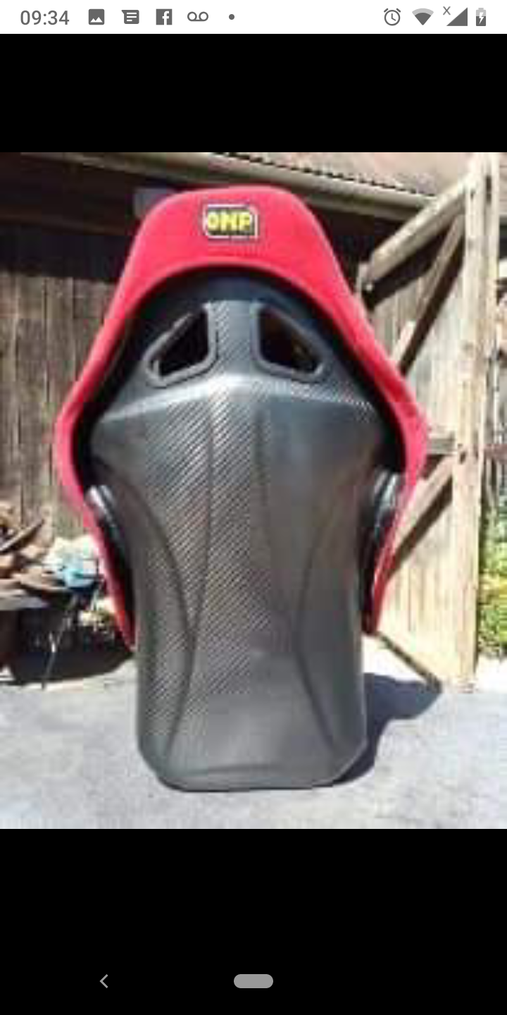

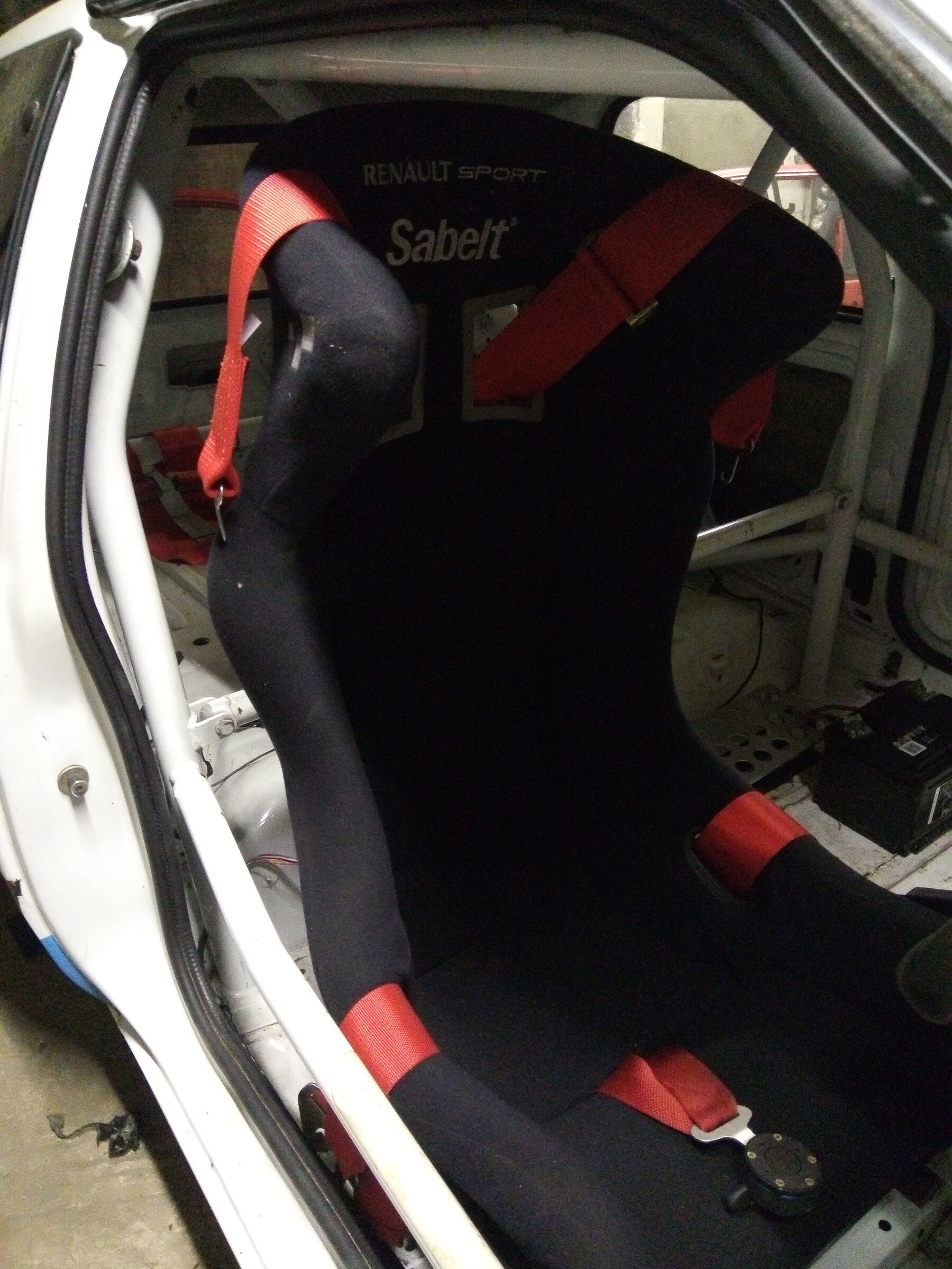

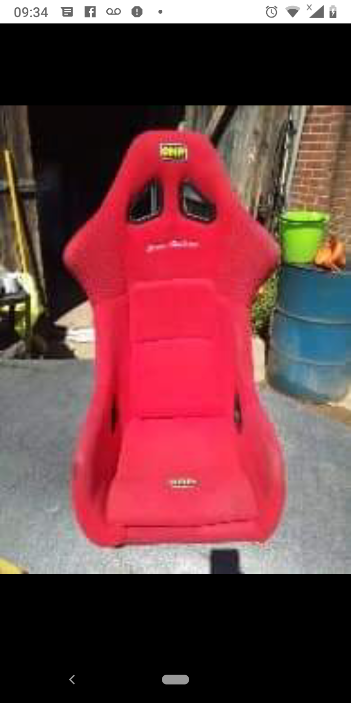

I started with removing the Williams engine got that sold immediately for £1000 I then got shot of the Ferrari front seats £800

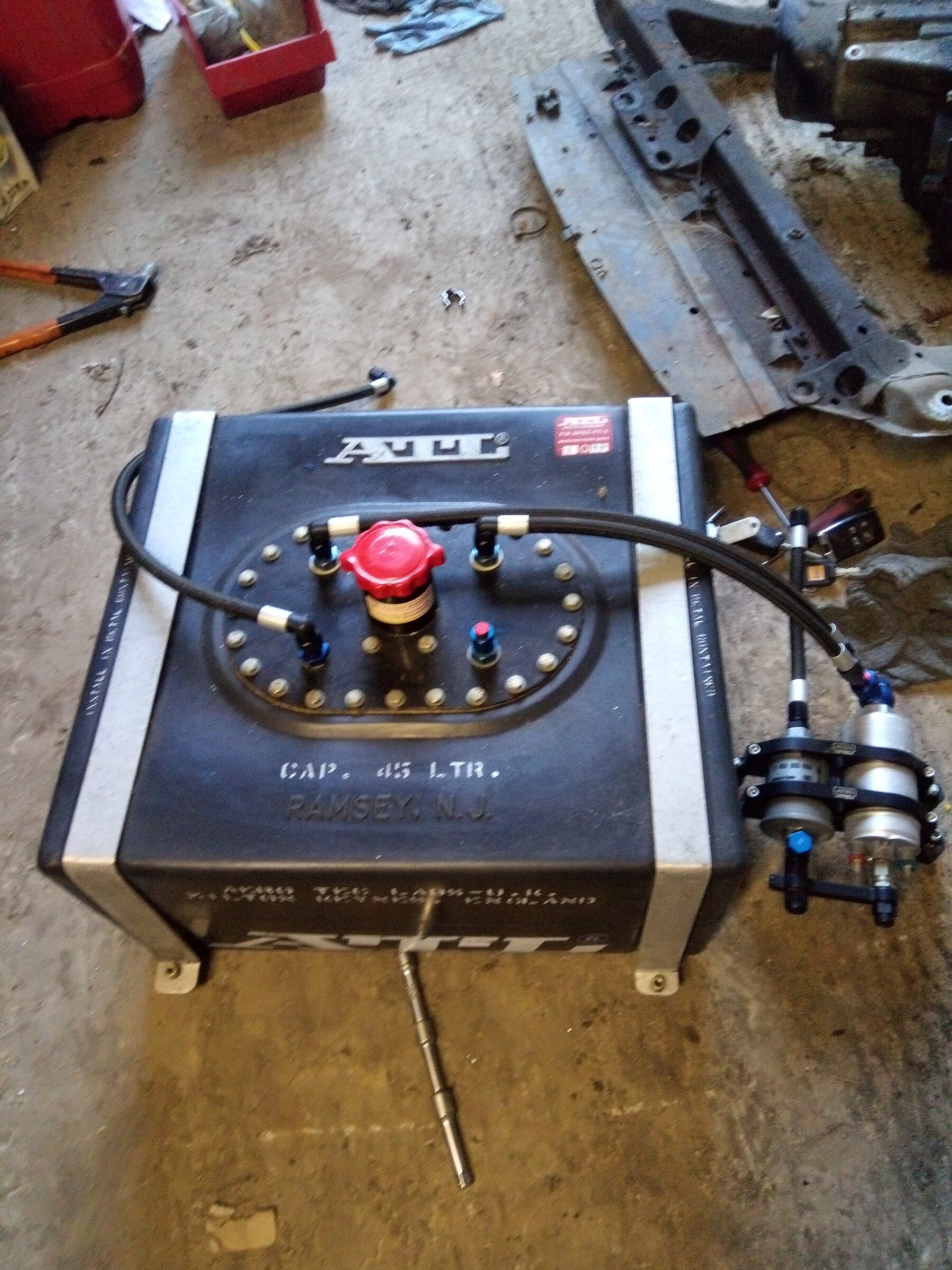

After being used in the Clio cup the car was used in endurance racing as most of them were and had a competition long distance racing fuel tank in the boot that also got removed and sold £270 becoming a cheap project this :)
I've lost the photos of the seats

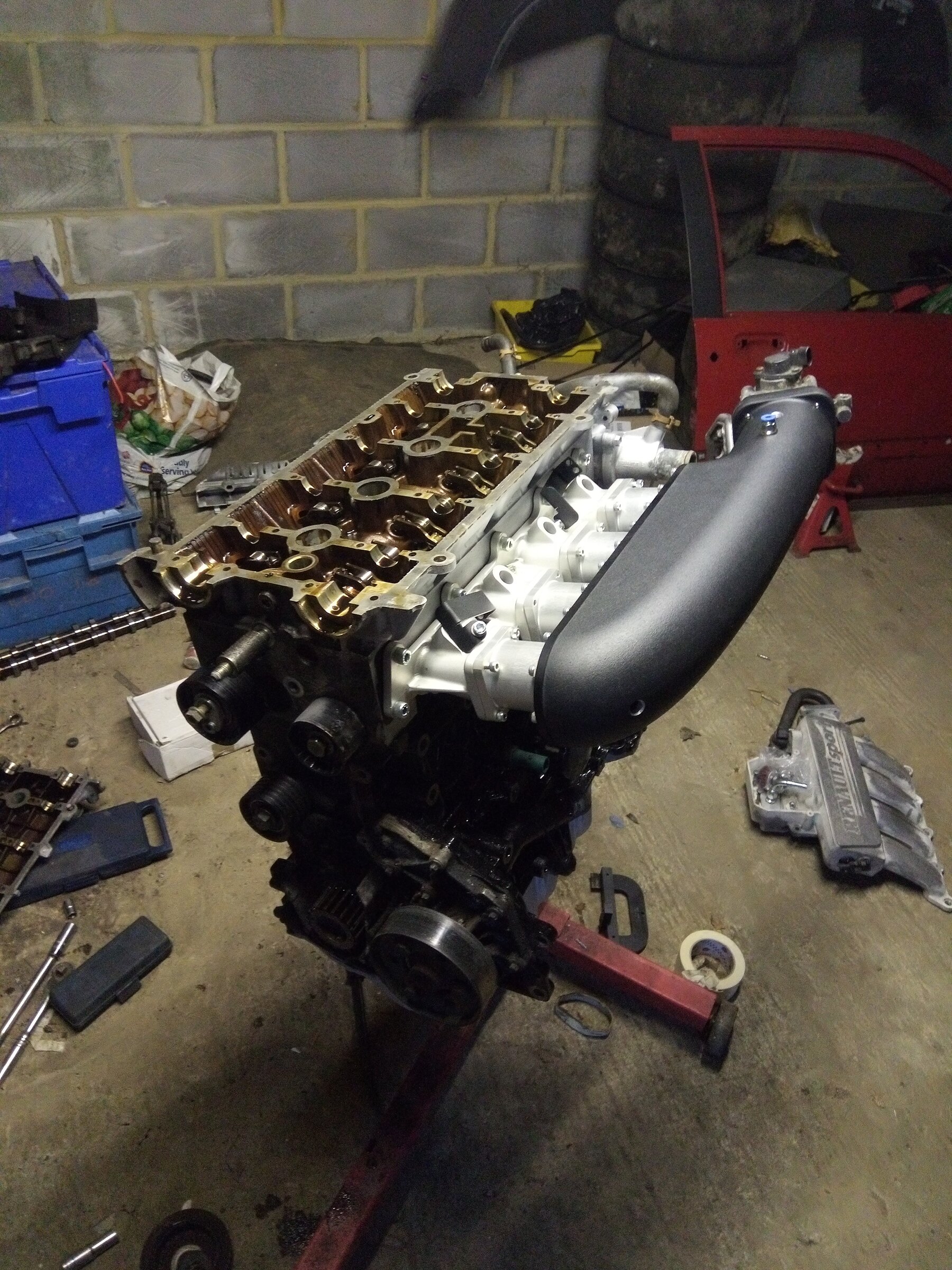

Long story short Im going to ruin it by fitting a f4r there's no way I'm driving it with the original 150bhp 1.8 bring on the hate

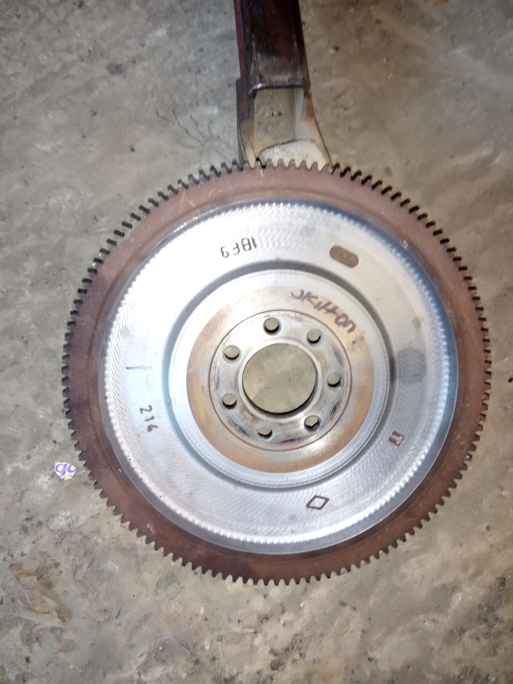

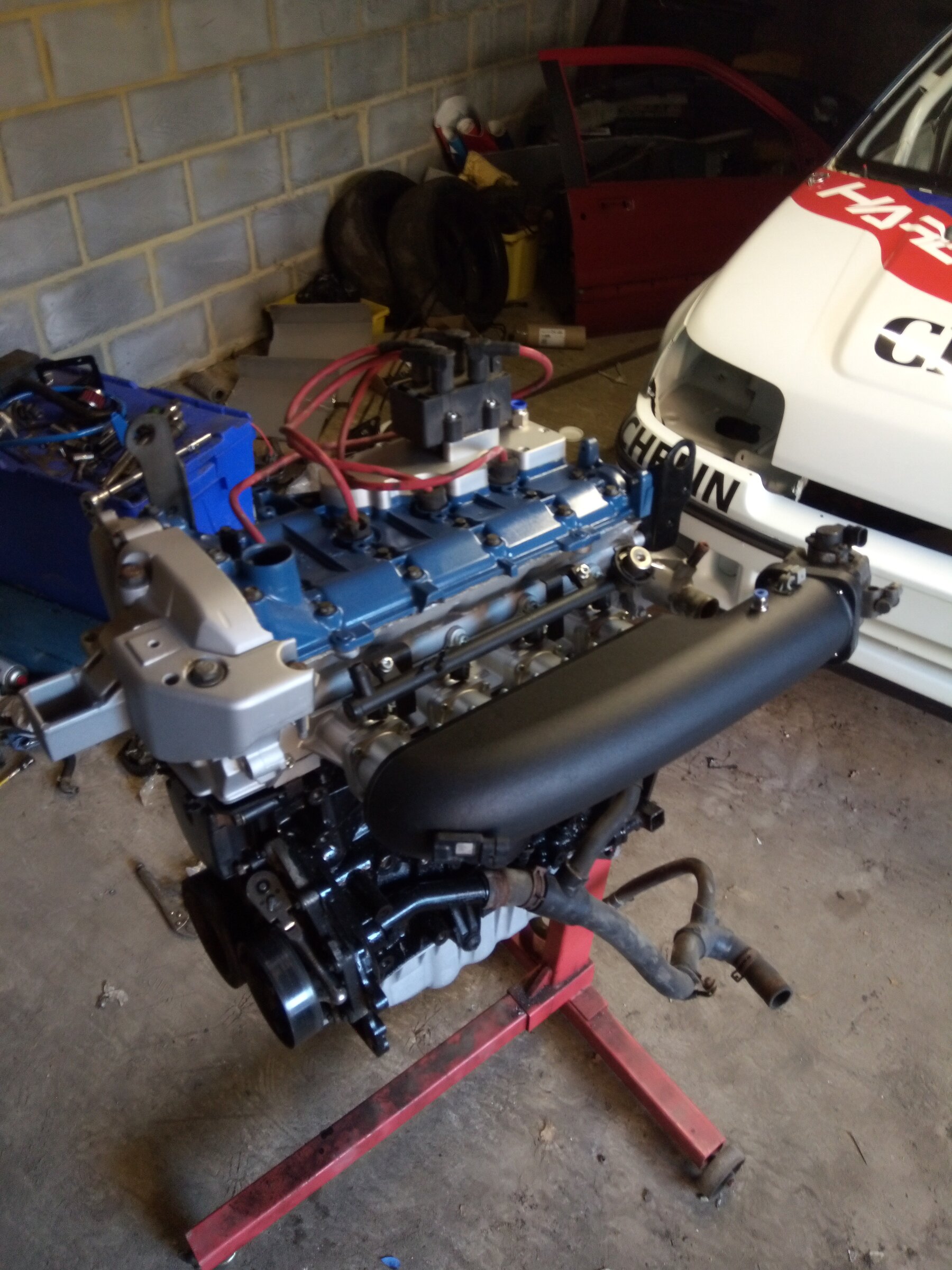

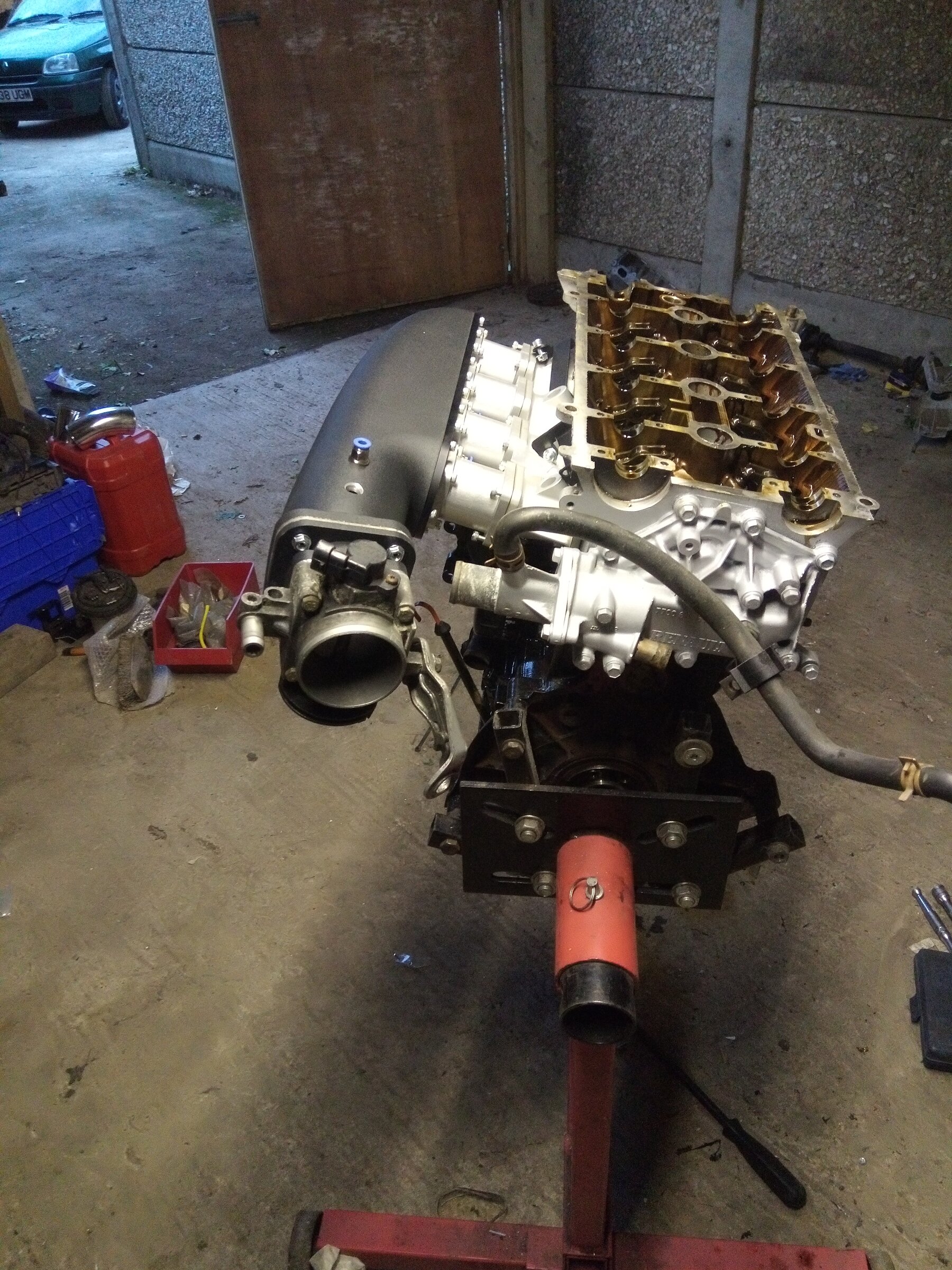

So the engine is a low mileage 172 ph1 engine I bought a complete car and broke it for the engine sold all the bits I didn't need for more than I bought the car so free engine yay I then fitted 197 cams injectors 182 manifold and a Tessa inlet so I didn't have to cut the bonnet I also had the flywheel lightened and balanced

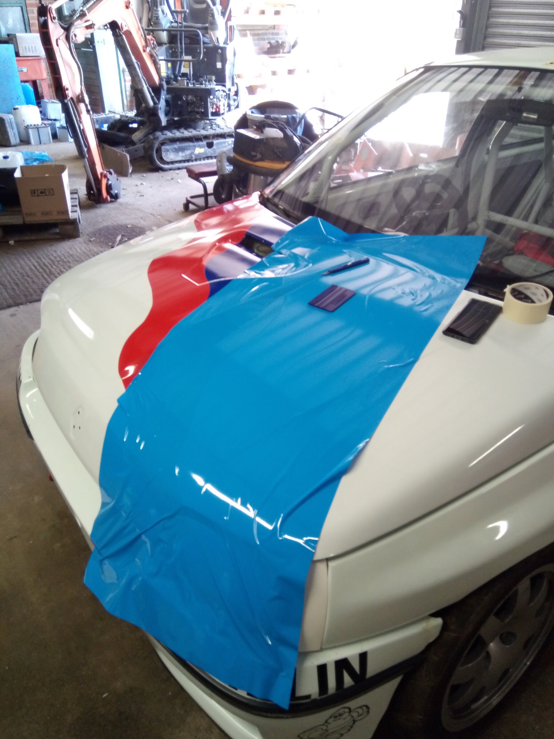

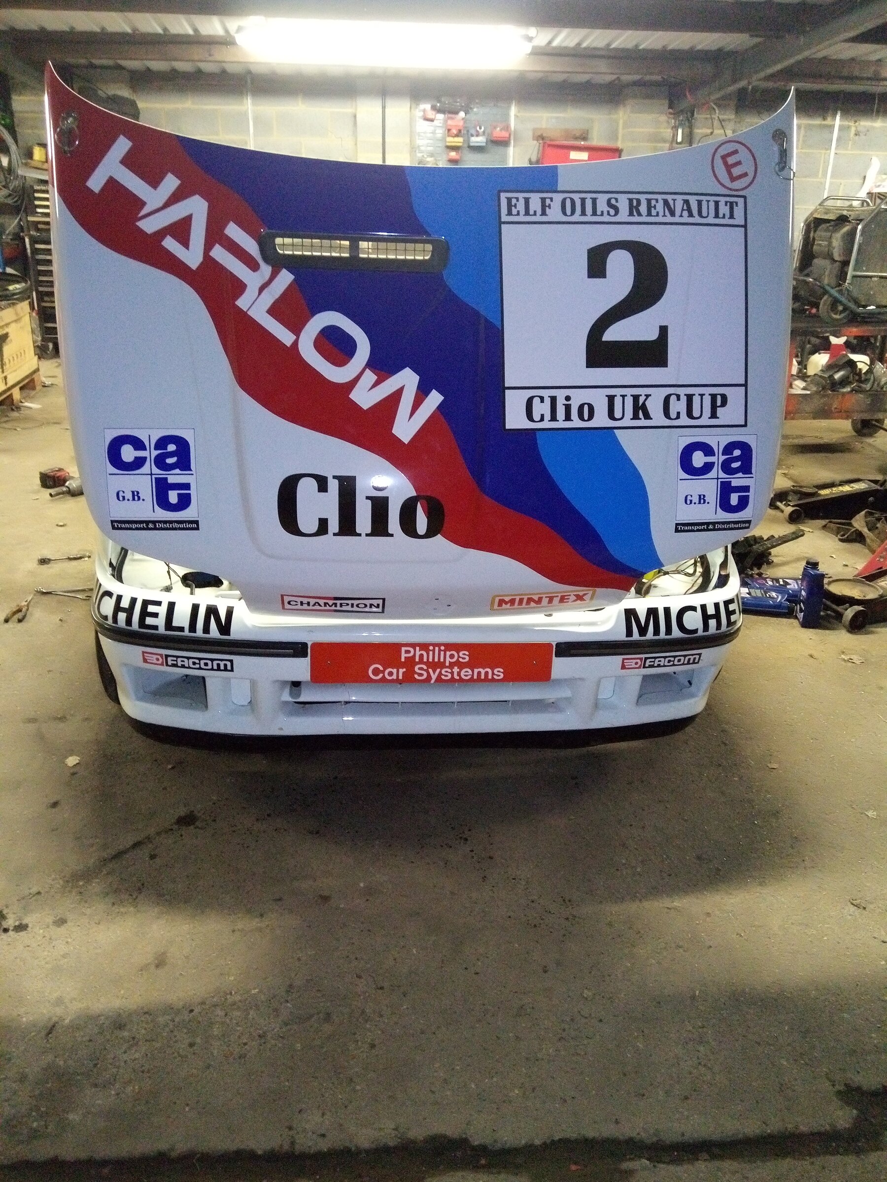

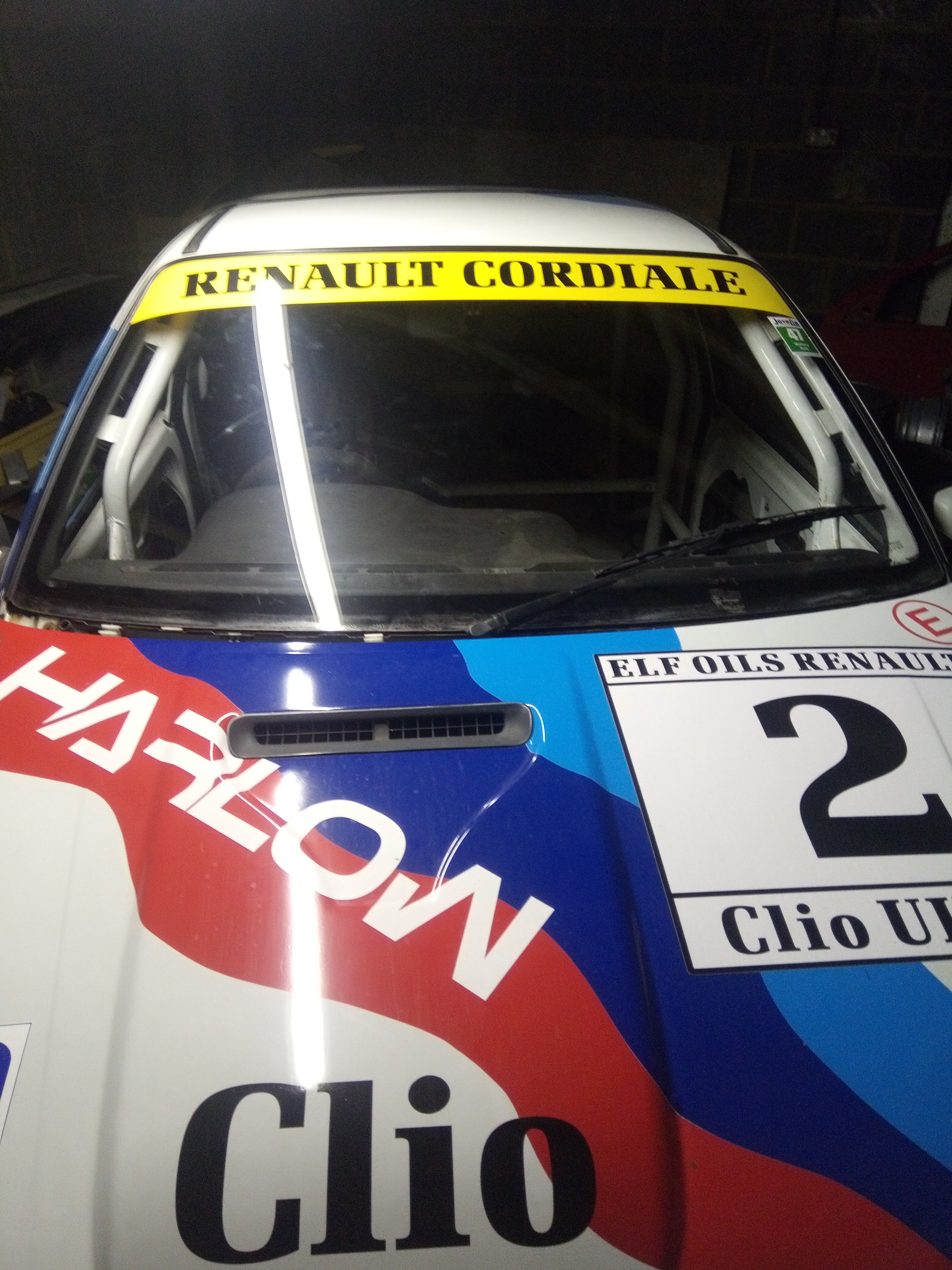

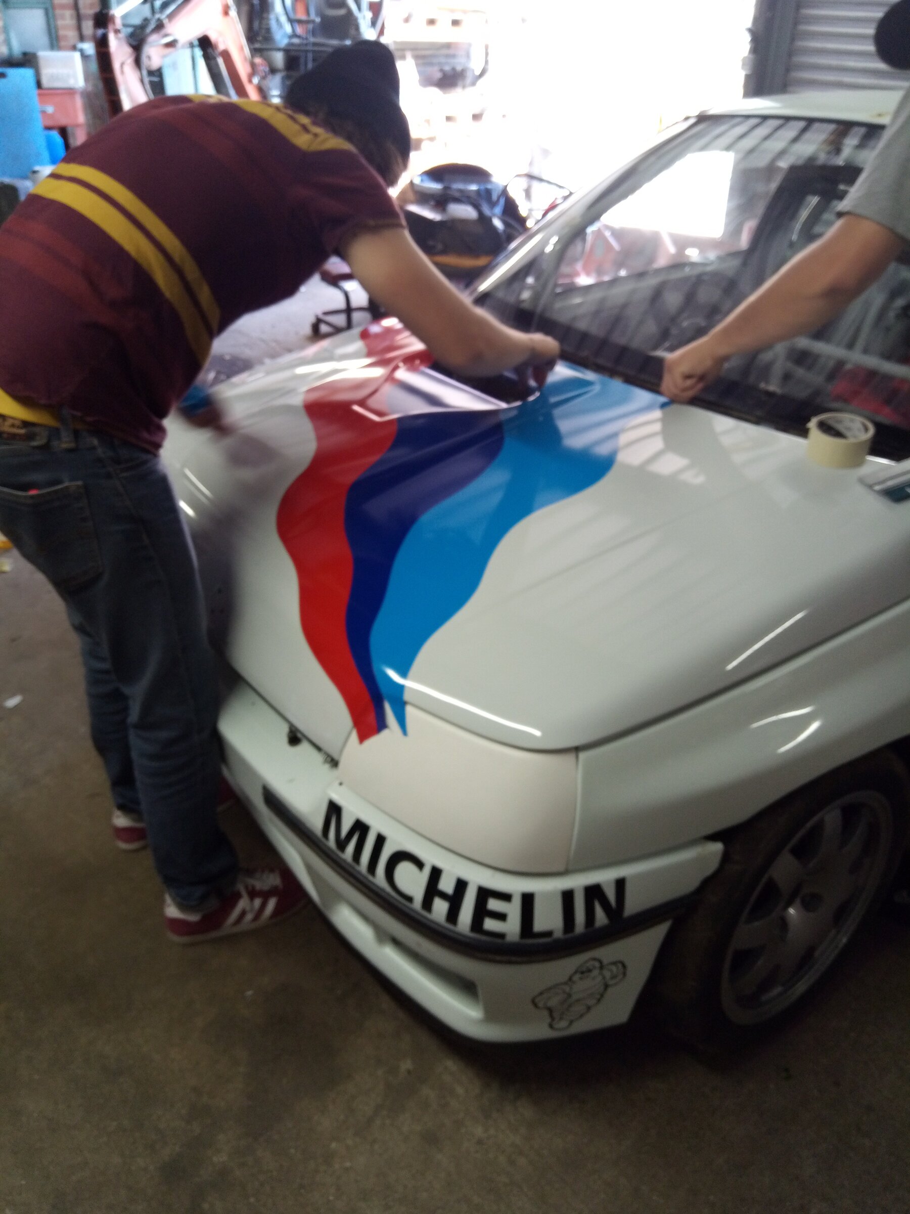

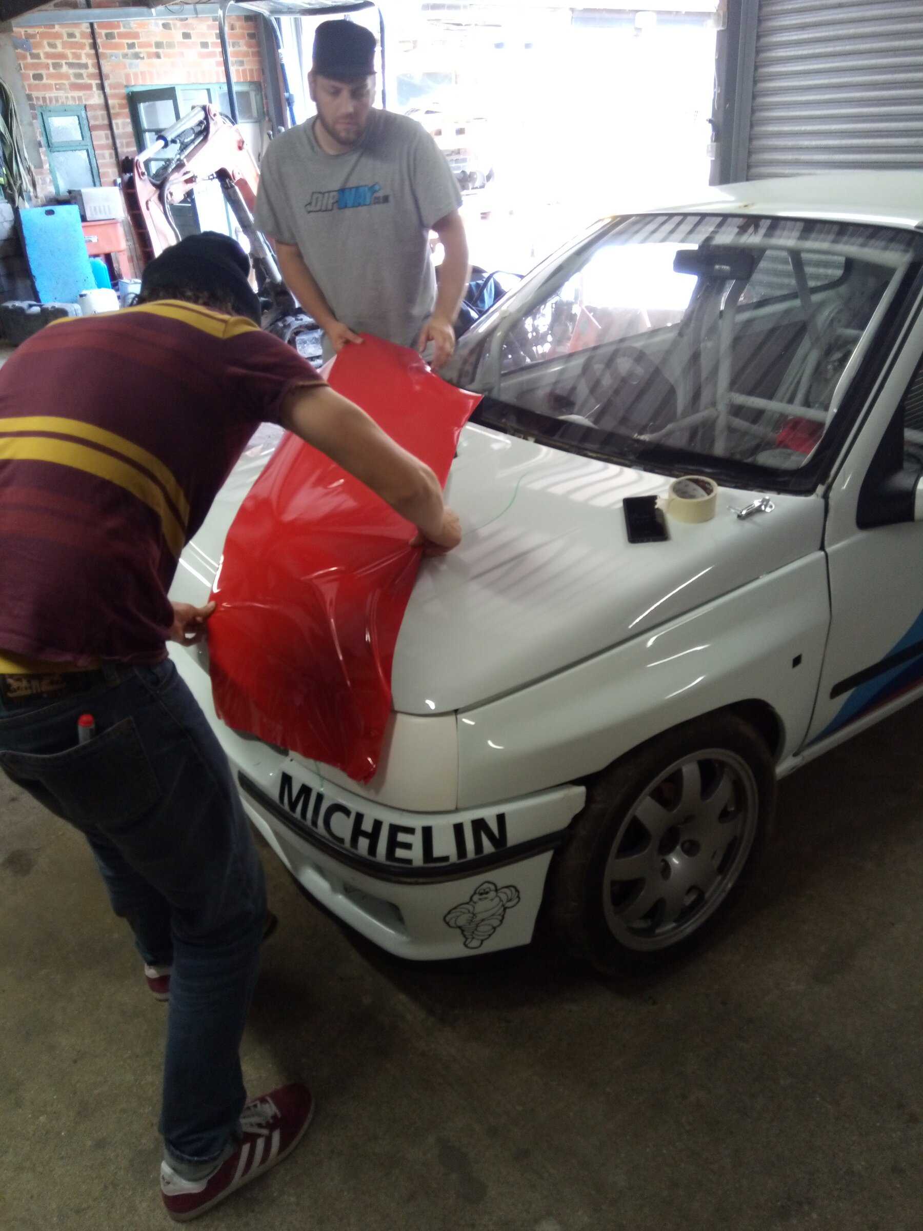

So the car was supplied to me with a plain white bonnet it was crying out for some colour I assume the original was damaged and binned a long time ago

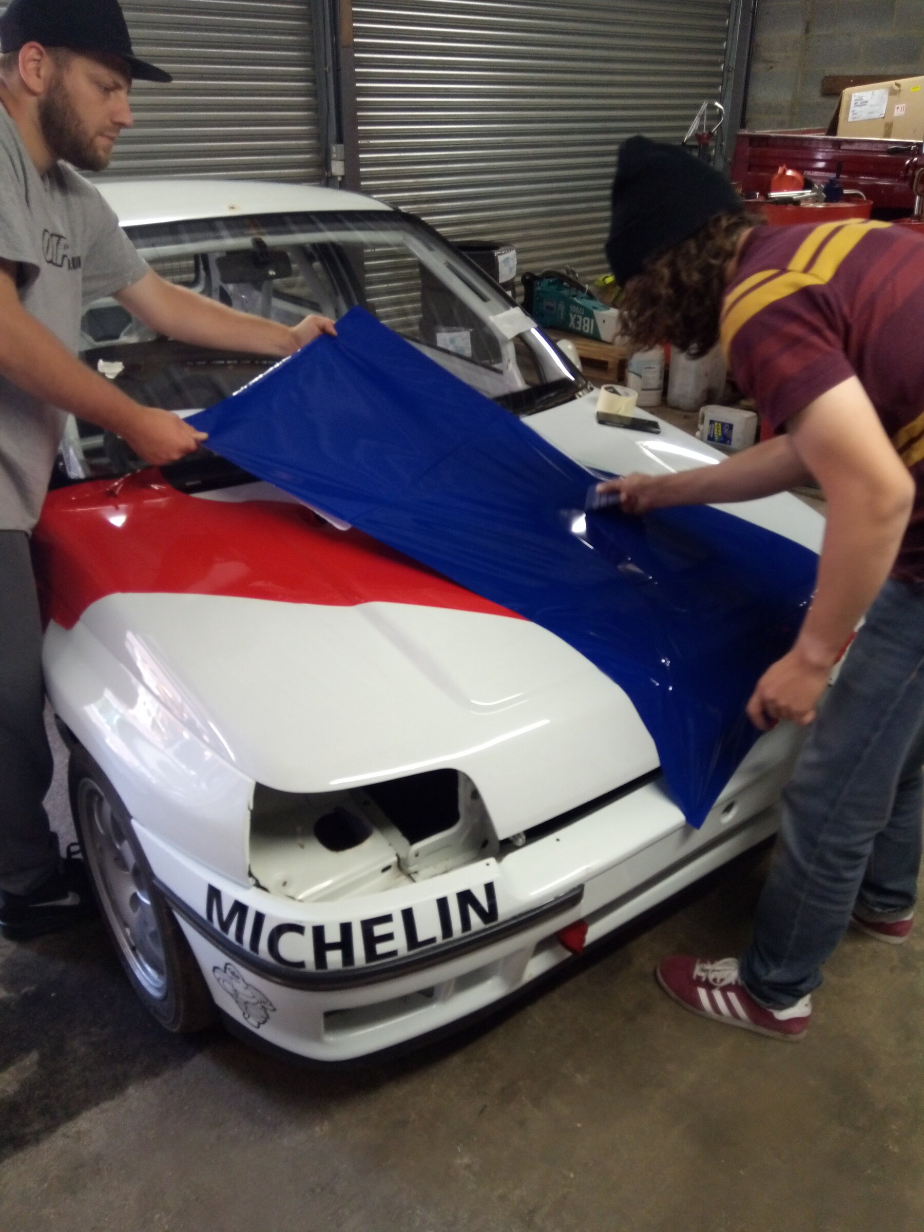

Do the Harlow colours on the car (light blue,blue,red) are painted on I don't have time for that so I had it done in vinyl in as close a colour as possible

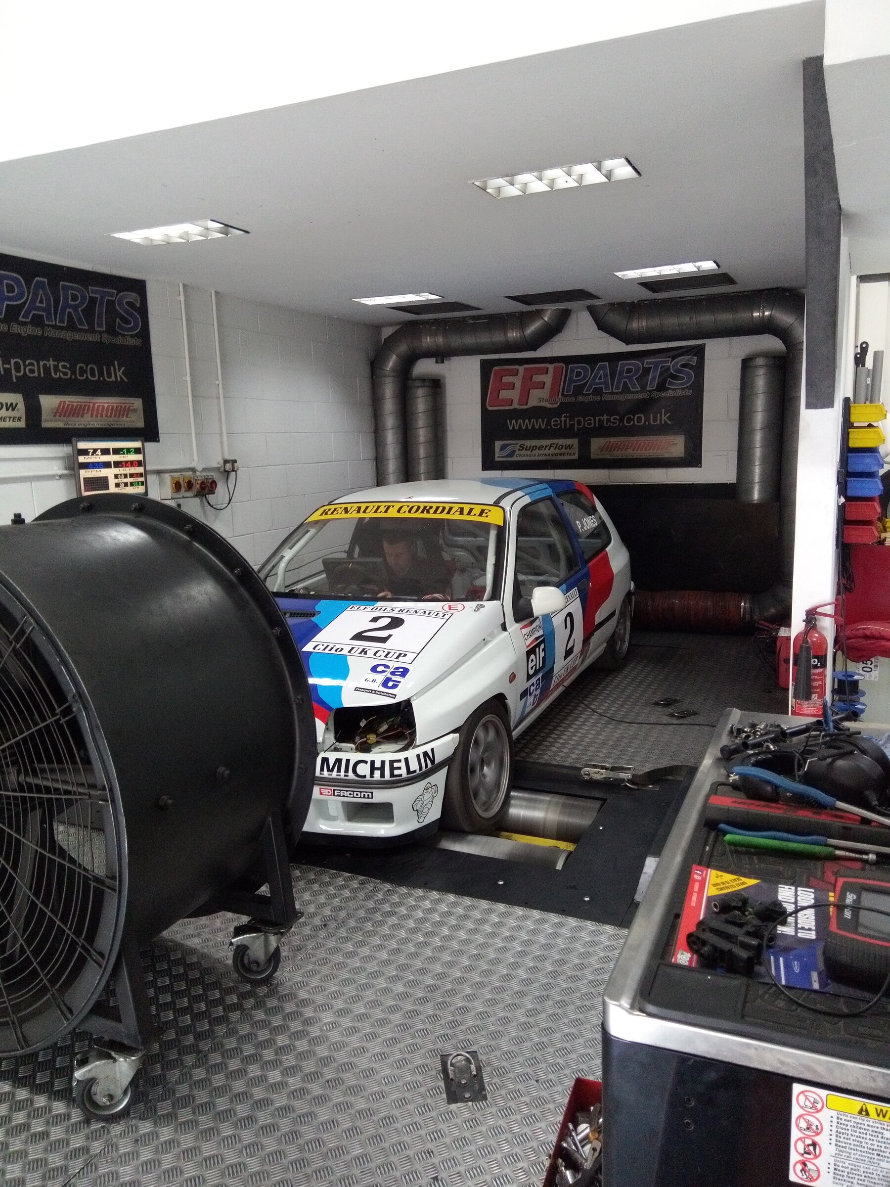

So mappings happened and I'm very happy efi did a epic job as usual power everywhere as usual delivered perfectly feels alot quicker than my 190 bhp yellow valver unfortunately due to my excessive camber toe out and slick tyres we couldn't get a accurate power reading luckily power figures are useless other than pub talk I also got spotted along the way looks awesome 😄

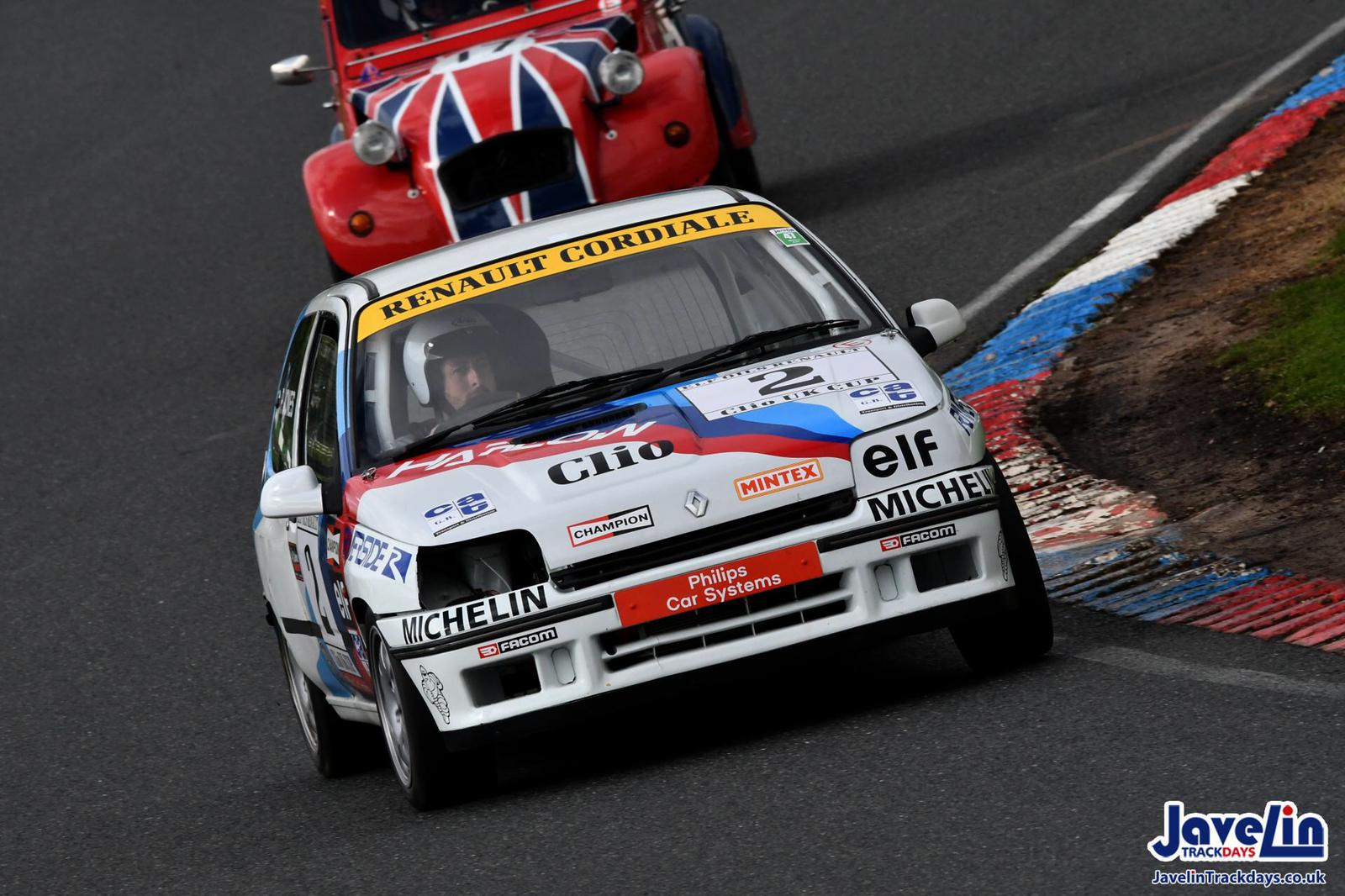

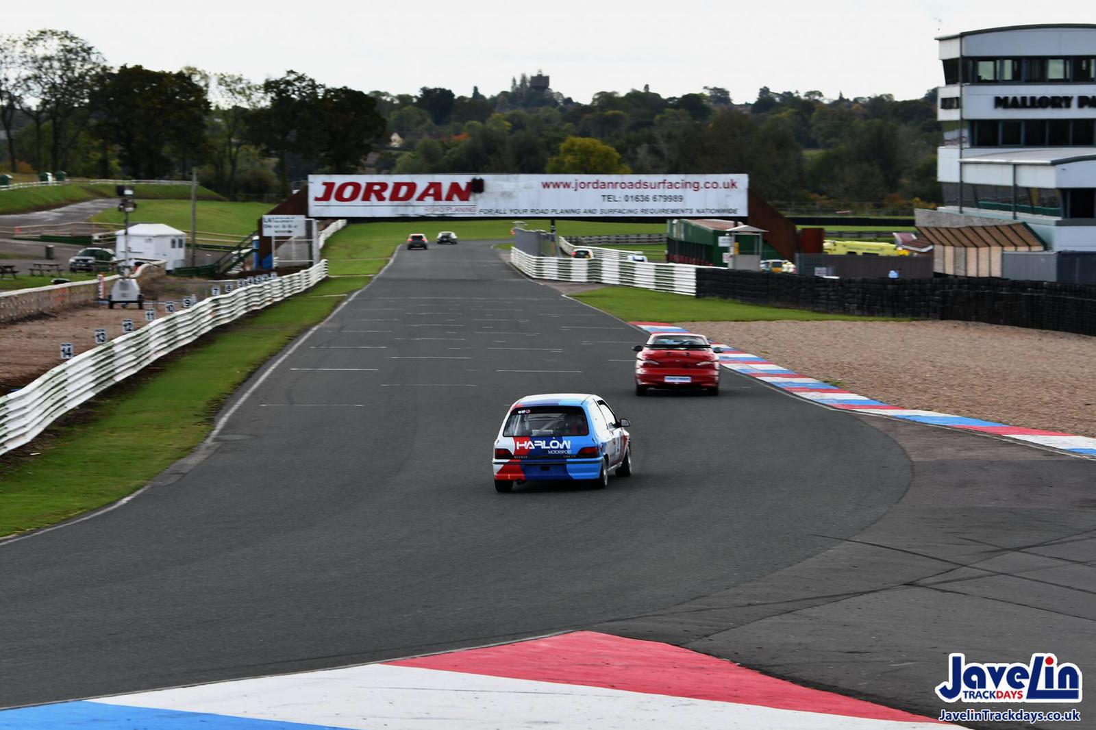

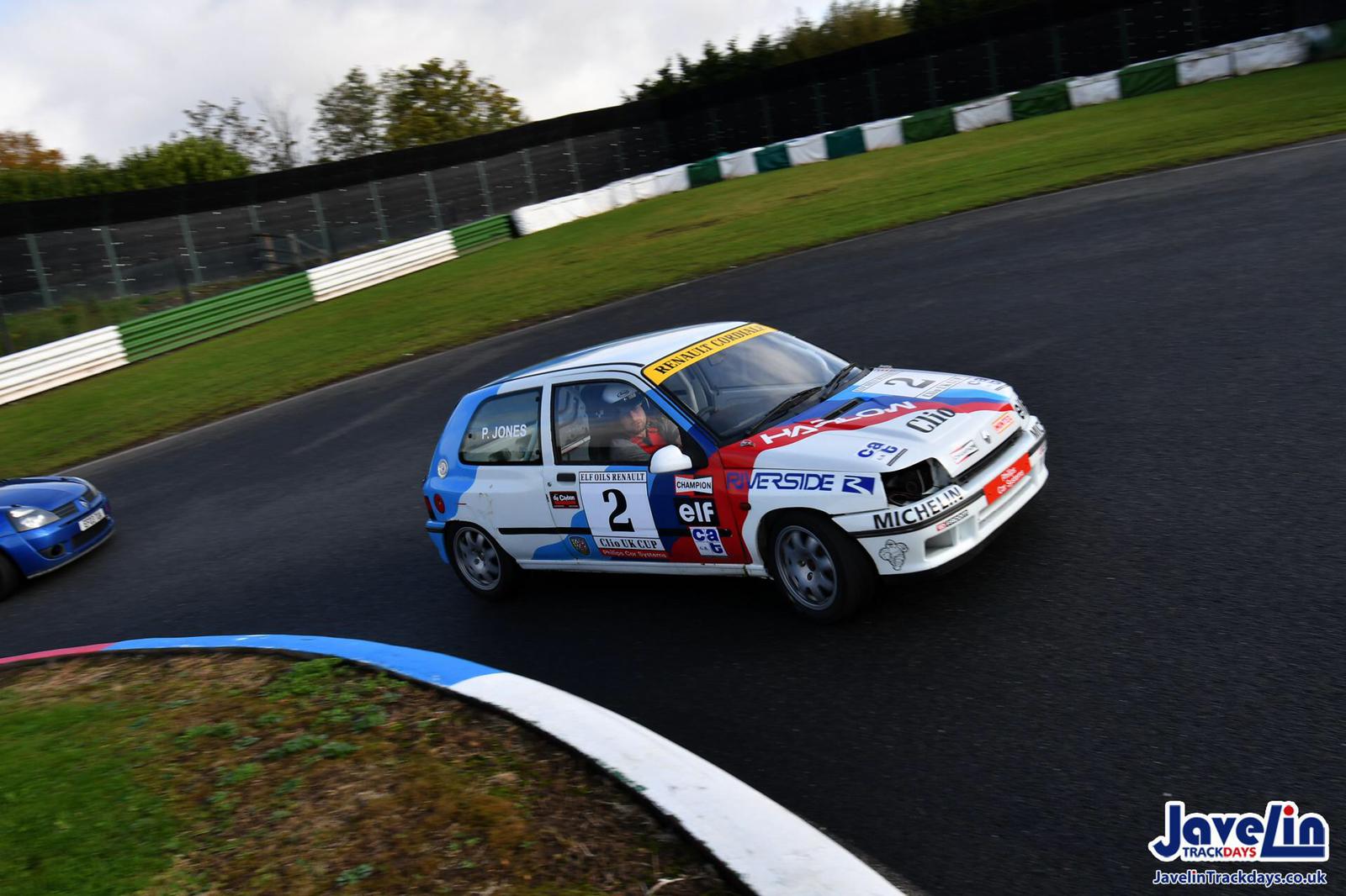

So the cup racer after a small breakdown on the way to Mallory where all the alternator bolts fell out I must of left them loose oops but the shakedown went well throwing up a few problems mainly the wipers not working after being modified to clear the cage
Also the windscreen isn't connected to the car very well ffs the fuel sender wiring rubbed through blowing the dash fuse a few times before I figured it out and the starter motor wire fell off
Other than these little problems it performed really well it pulls really well and handles better than any MK1 I've ever been in and the tyres are also a different level of awesome slicks were great but it's the wets that really impressed me

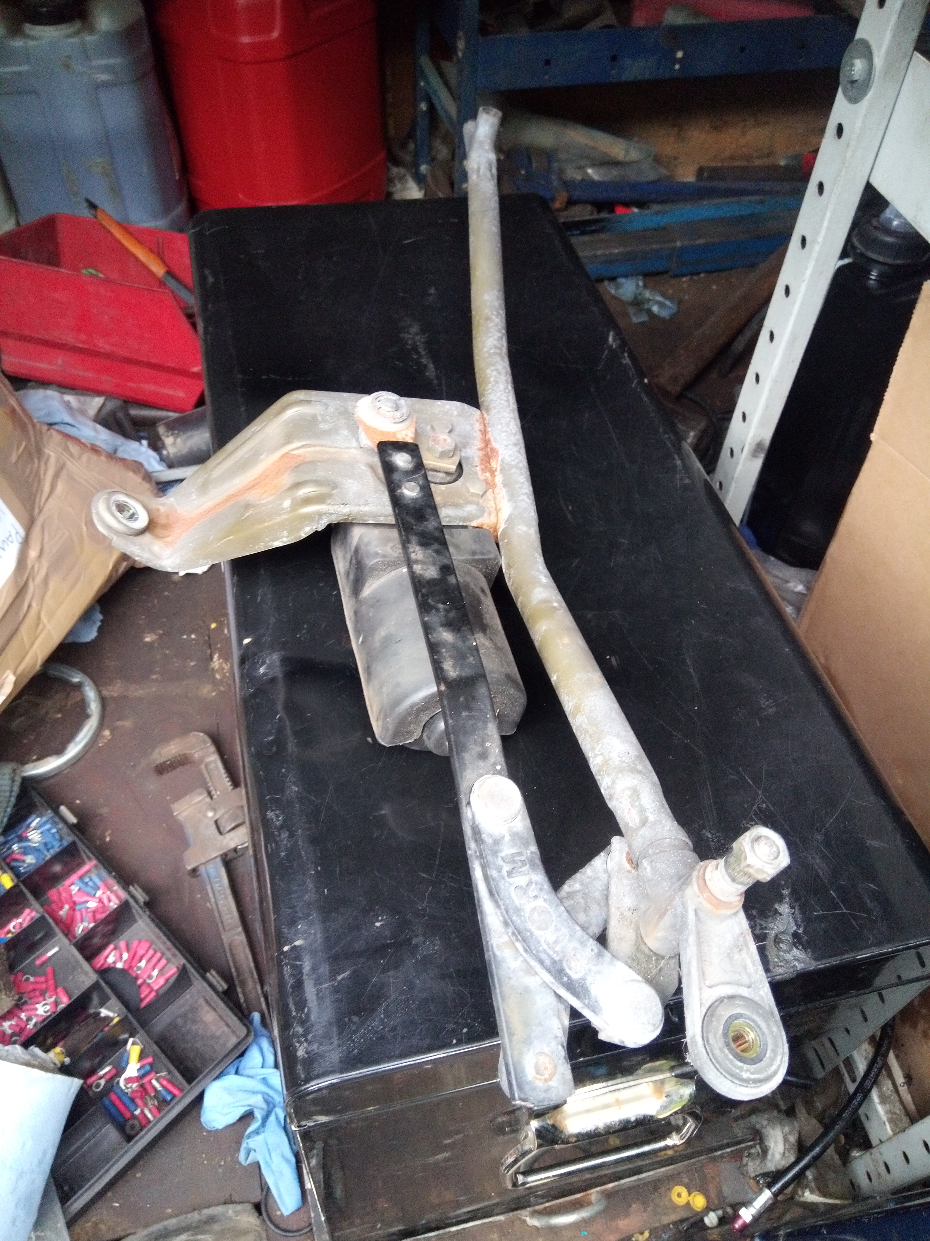

So after my shakedown at Mallory the two biggest issues were the windscreen and the wiper mech the windscreen was easy enough to sort I got a local firm to me to remove and reglue it in place awesome the wiper mechanism had previously been modified to clear the cage however it wasn't up to the job and failed the first time I used it after considering all my options I decided the single wiper conversion was the way to go not what I want to do but it makes so much sense anyway it's fitted and it works and k don't hate it maybe one day I'll be able to find a better solution but right now I just want to get in and drive it

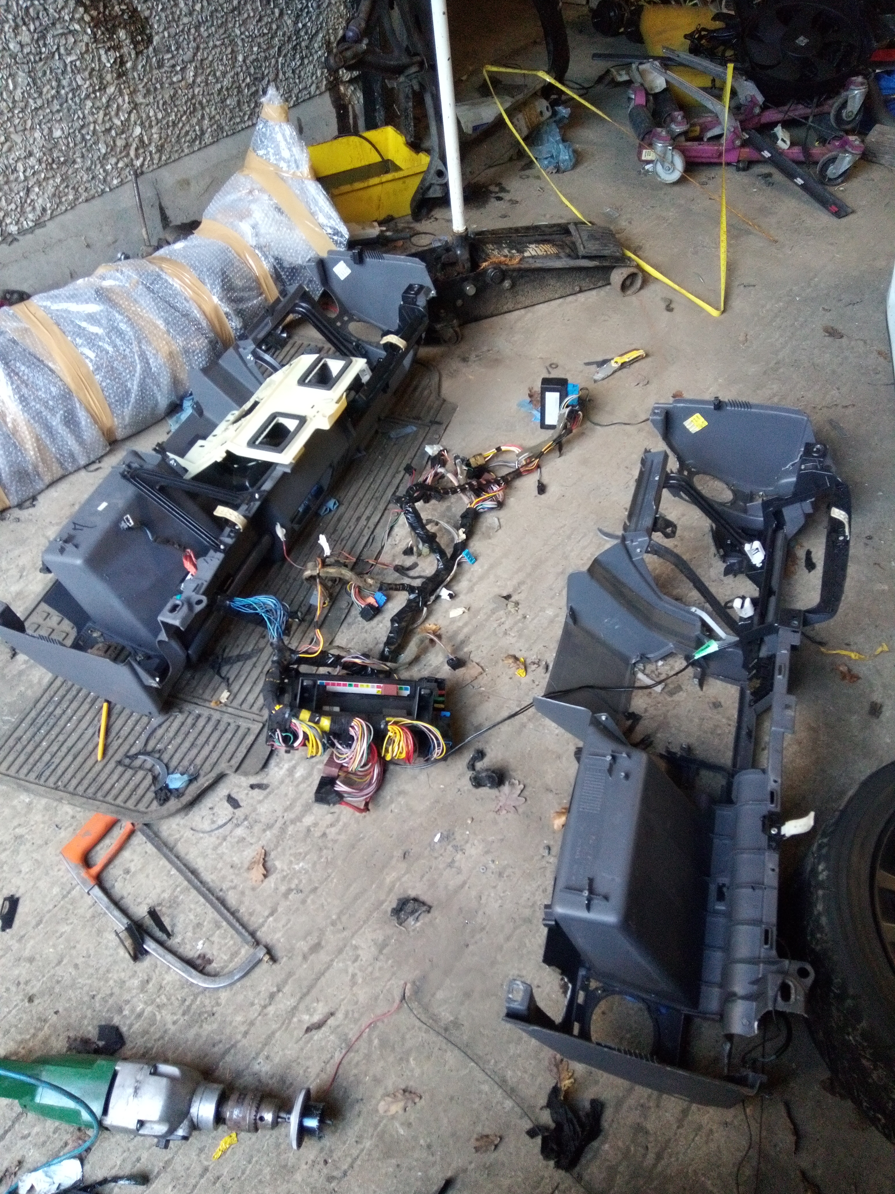

So for some reason I decided it was a good idea to remove all the unnecessary wires from my loom central locking speakers windows etc ended up with a bag full of wires and quite a neat loom

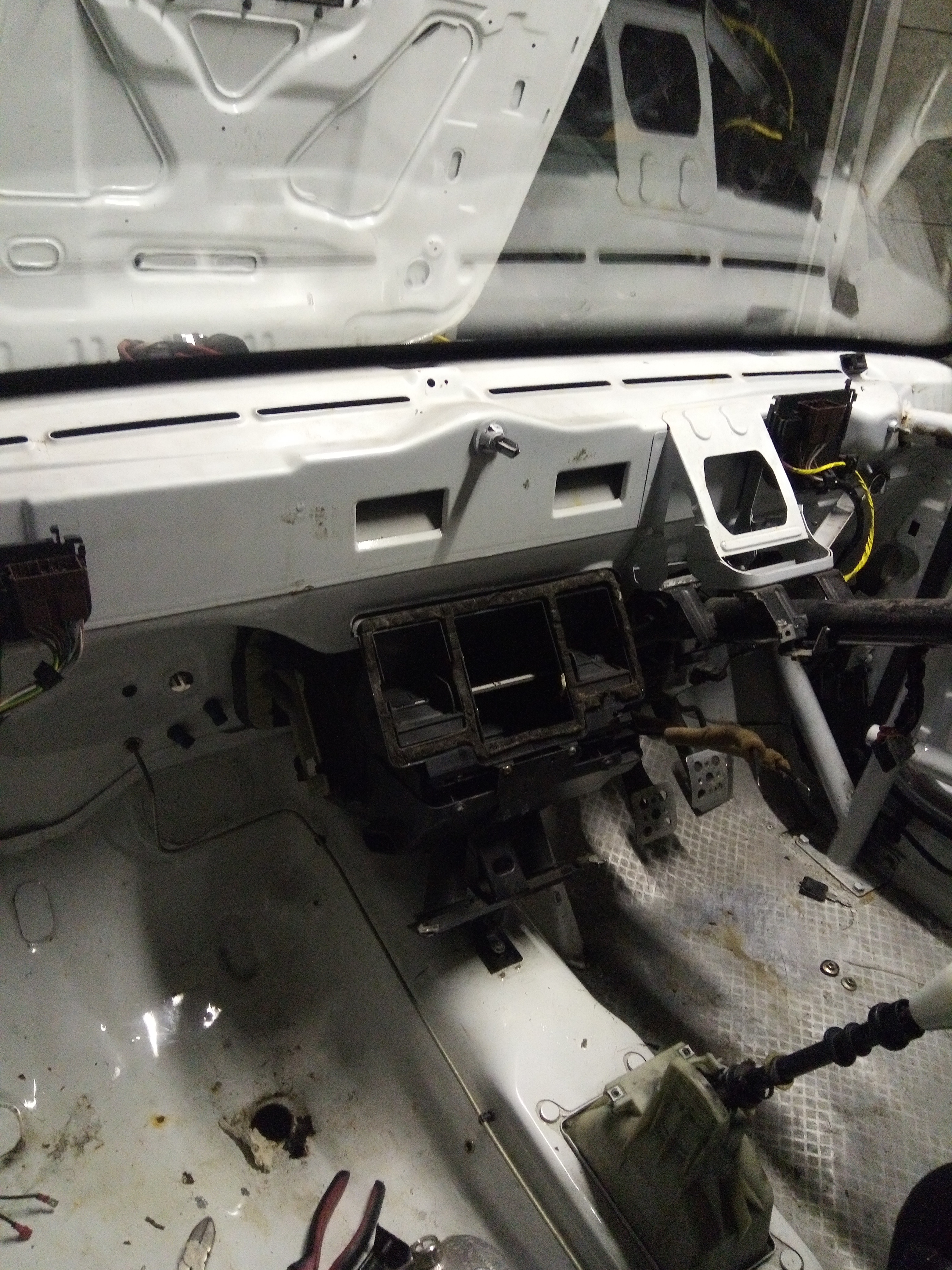

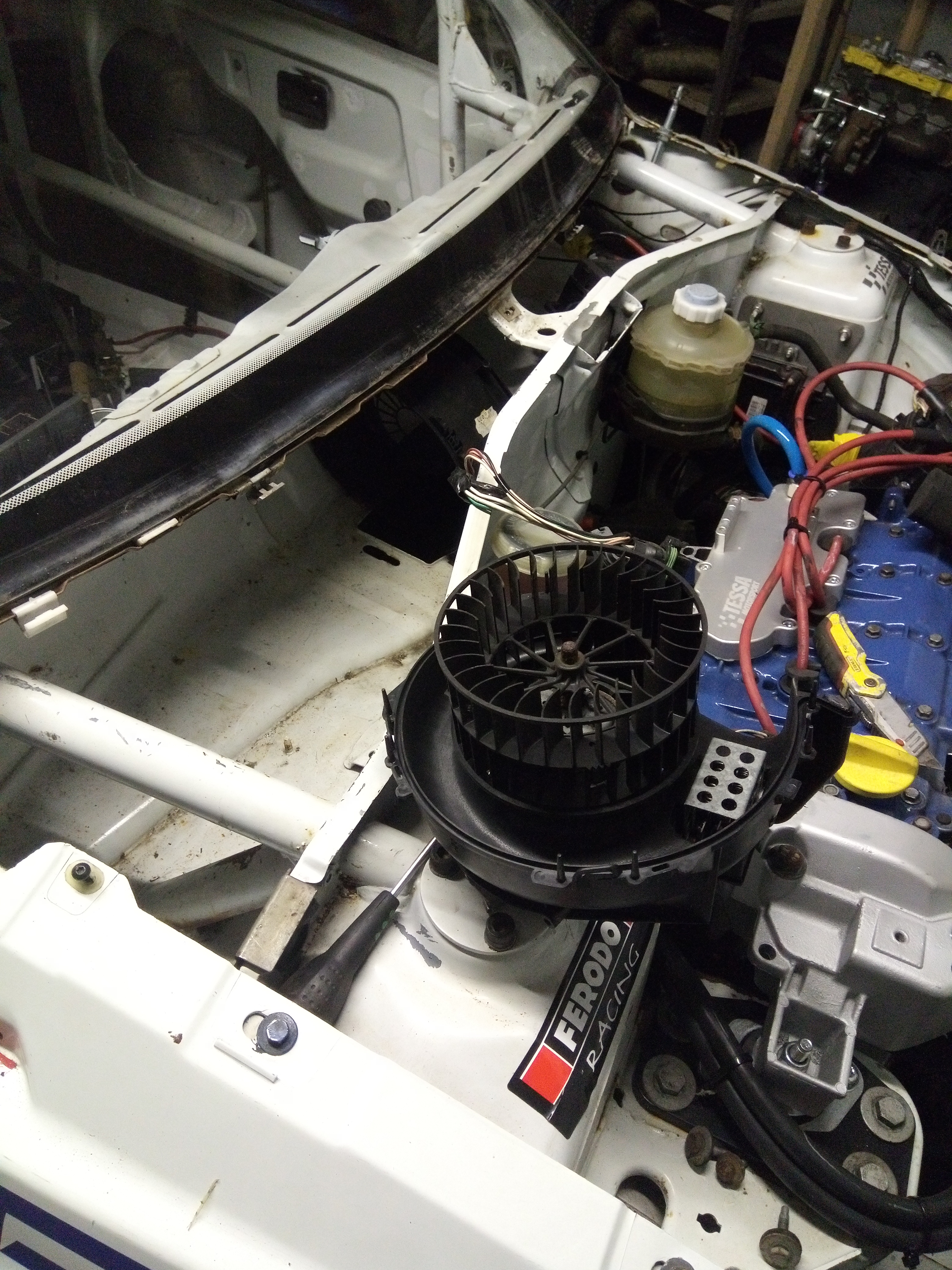

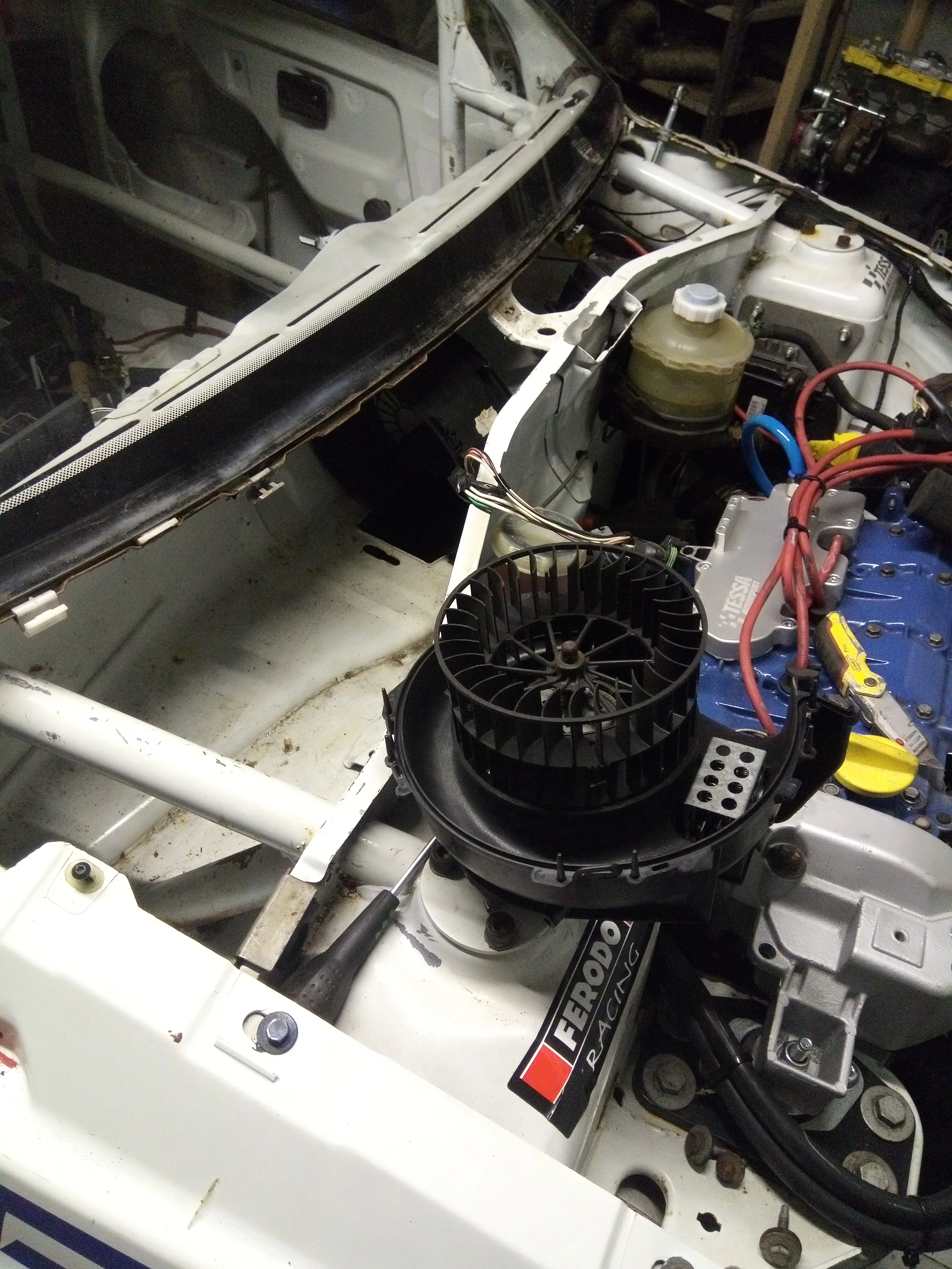

As visibility was a big issue at Mallory I decided to put the heater back in they would of had a heater in when it was raced in the Clio cup it was removed later for endurance racing no more steamy windscreen
I had more issues getting the heater blower in around the cage I had to take it apart and re assemble in situ
