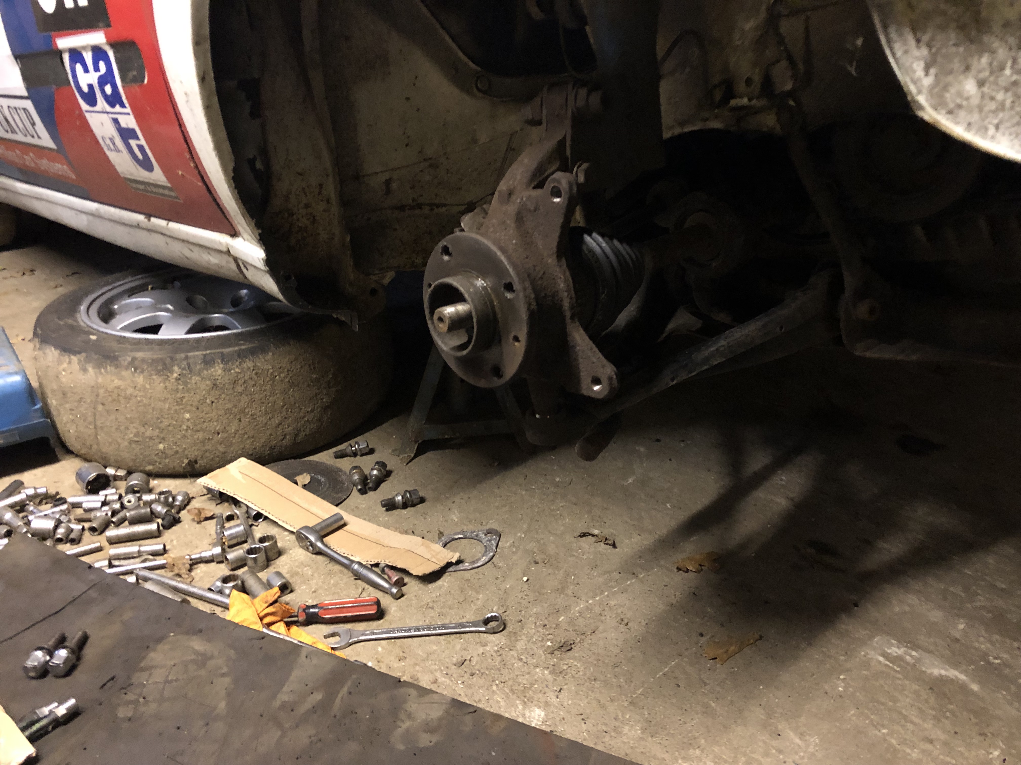

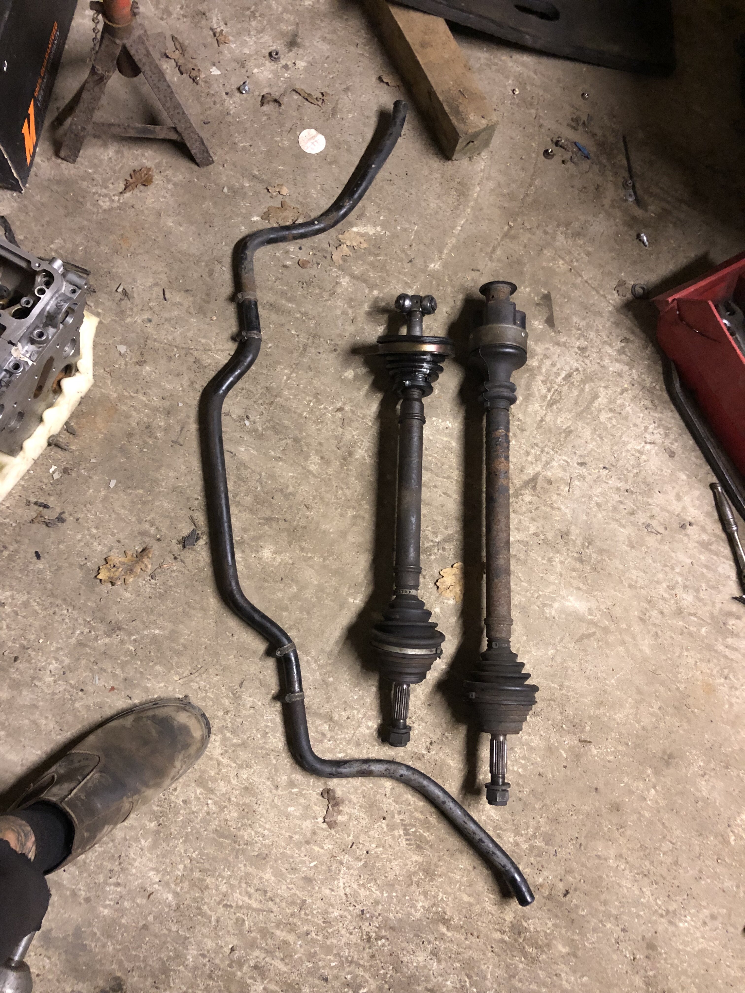

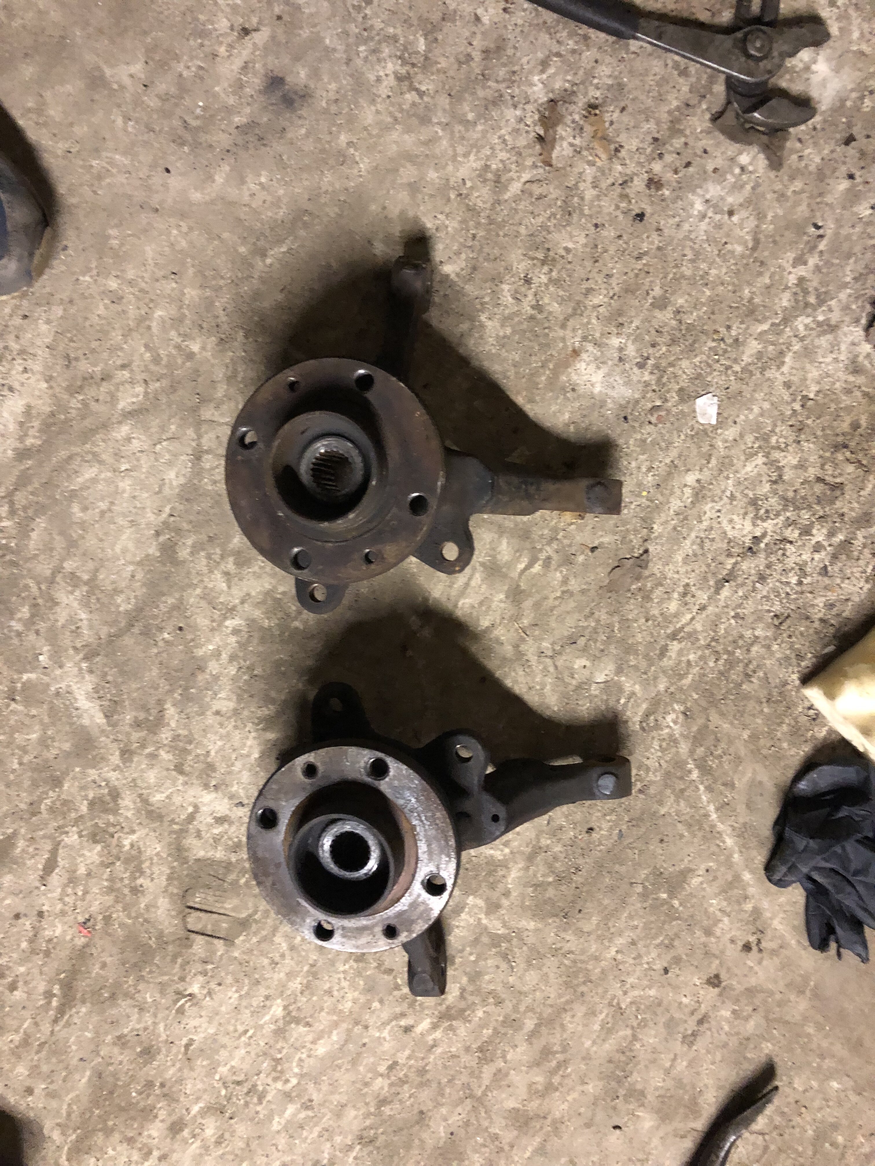

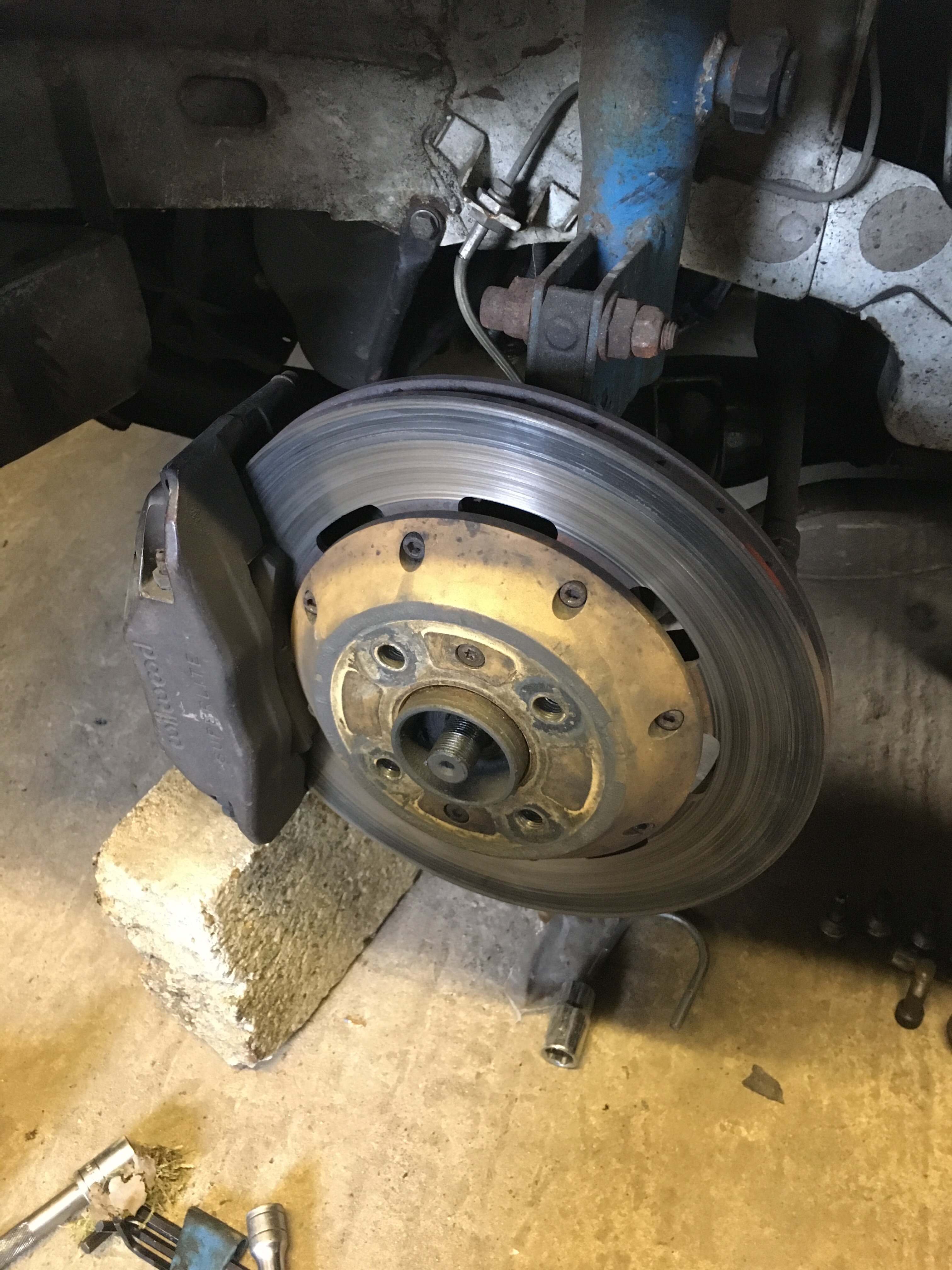

Anti roll bar hubs shafts and the willwoods all being replaced for 172 items
  197 clio 16v

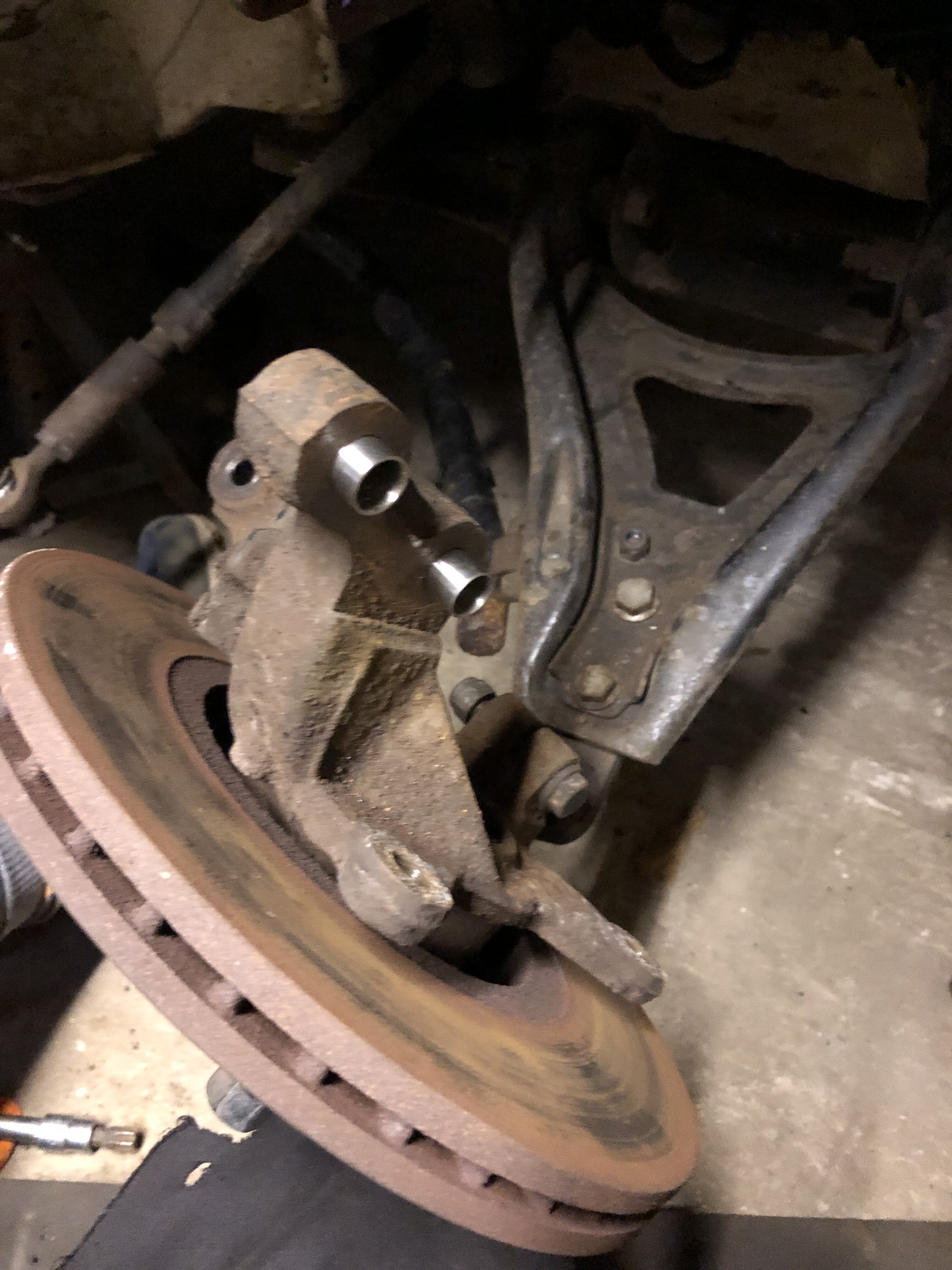

So more valver bits going in the bin and more 172 bits being fitted shafts and hubs gone replaced with 172 ph1 shafts and 172 hubs machined down to fit the mk1 coil overs and shims to allow the use of the mk1 bolts

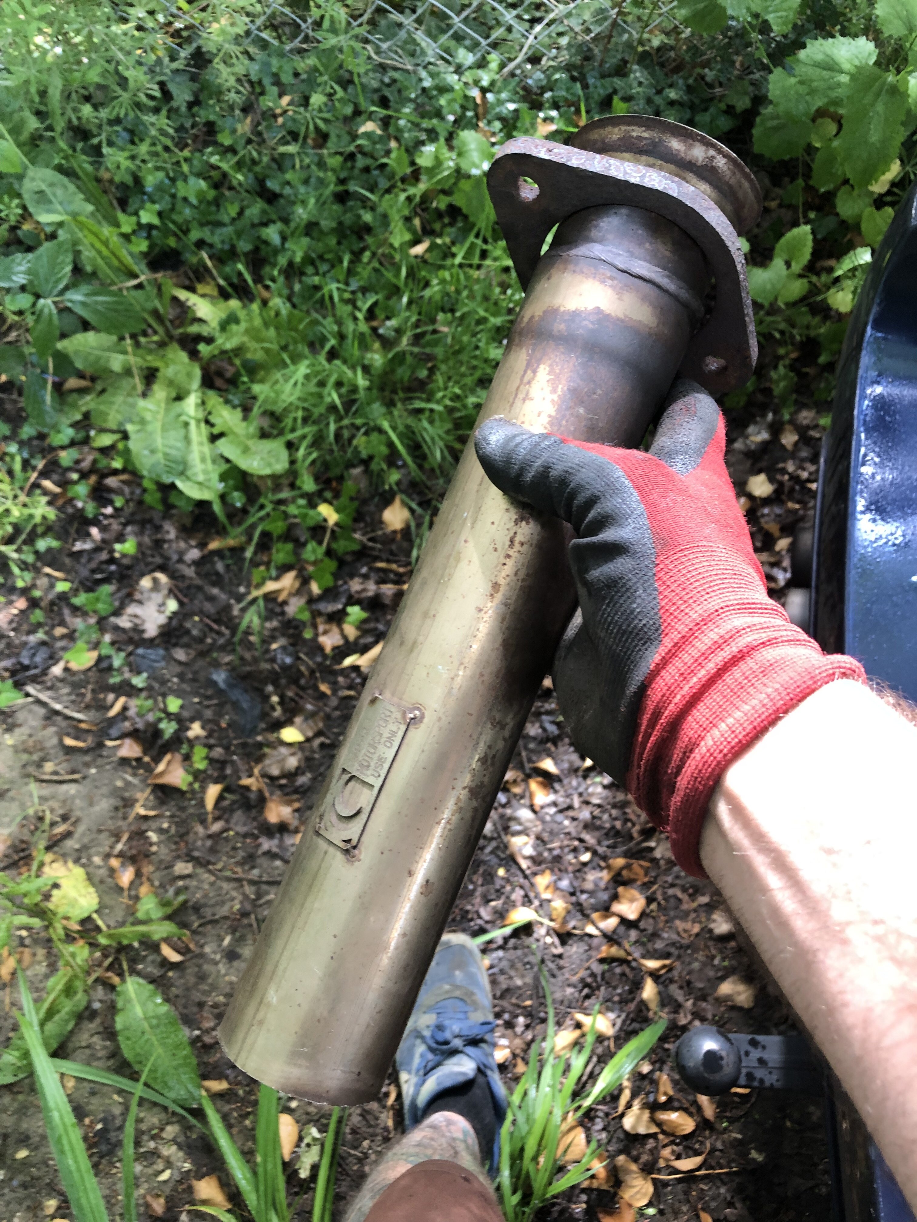

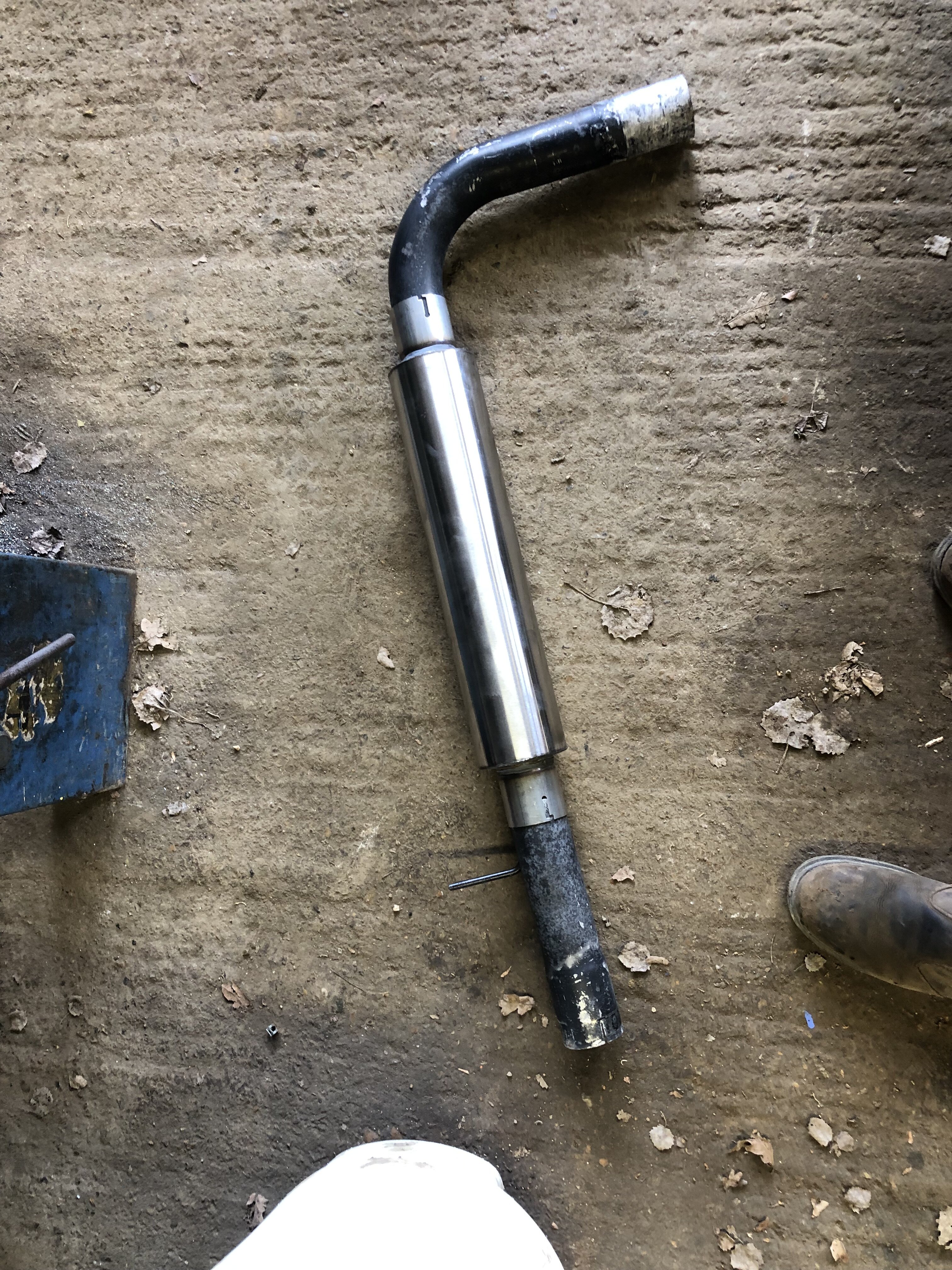

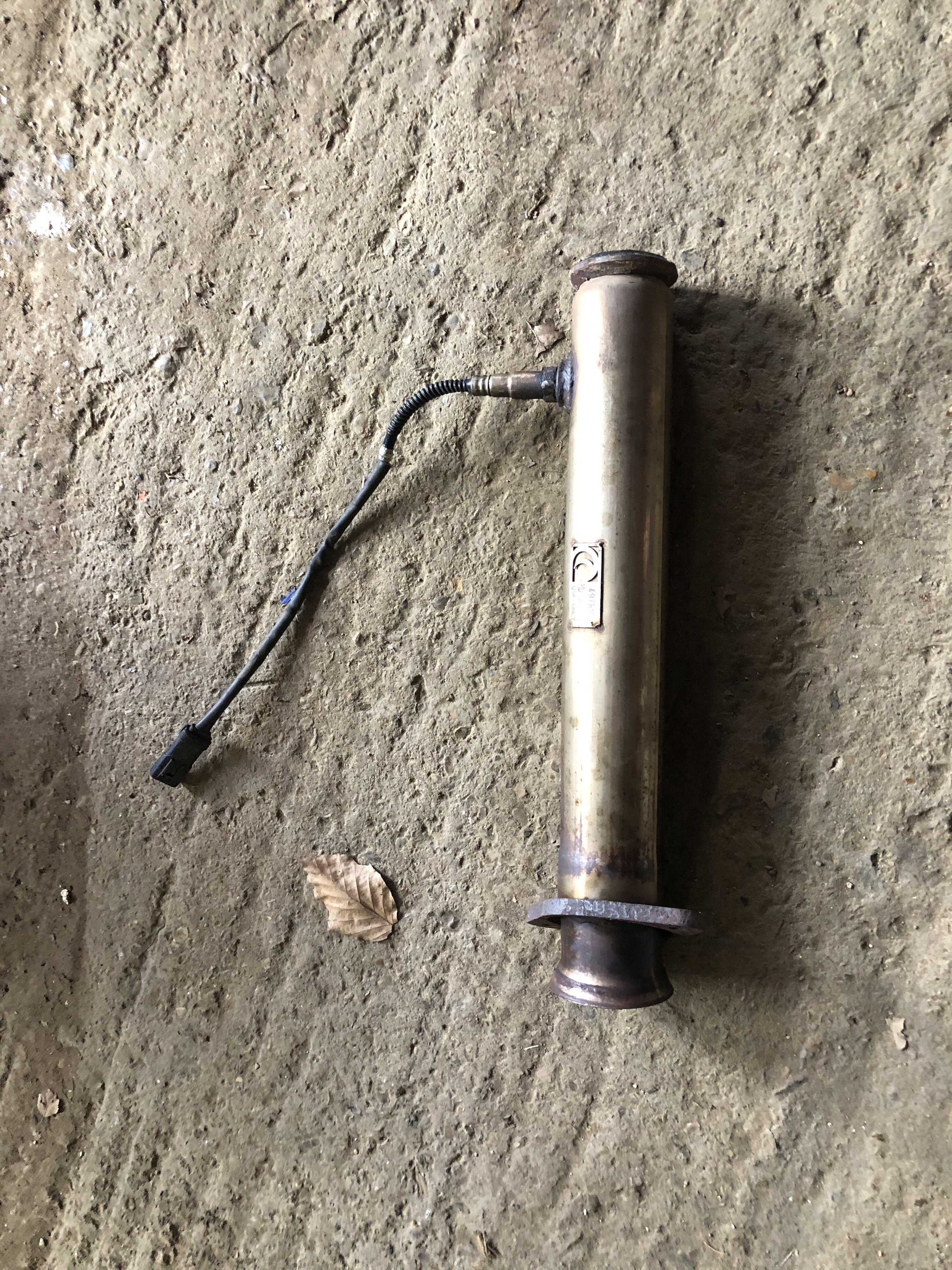

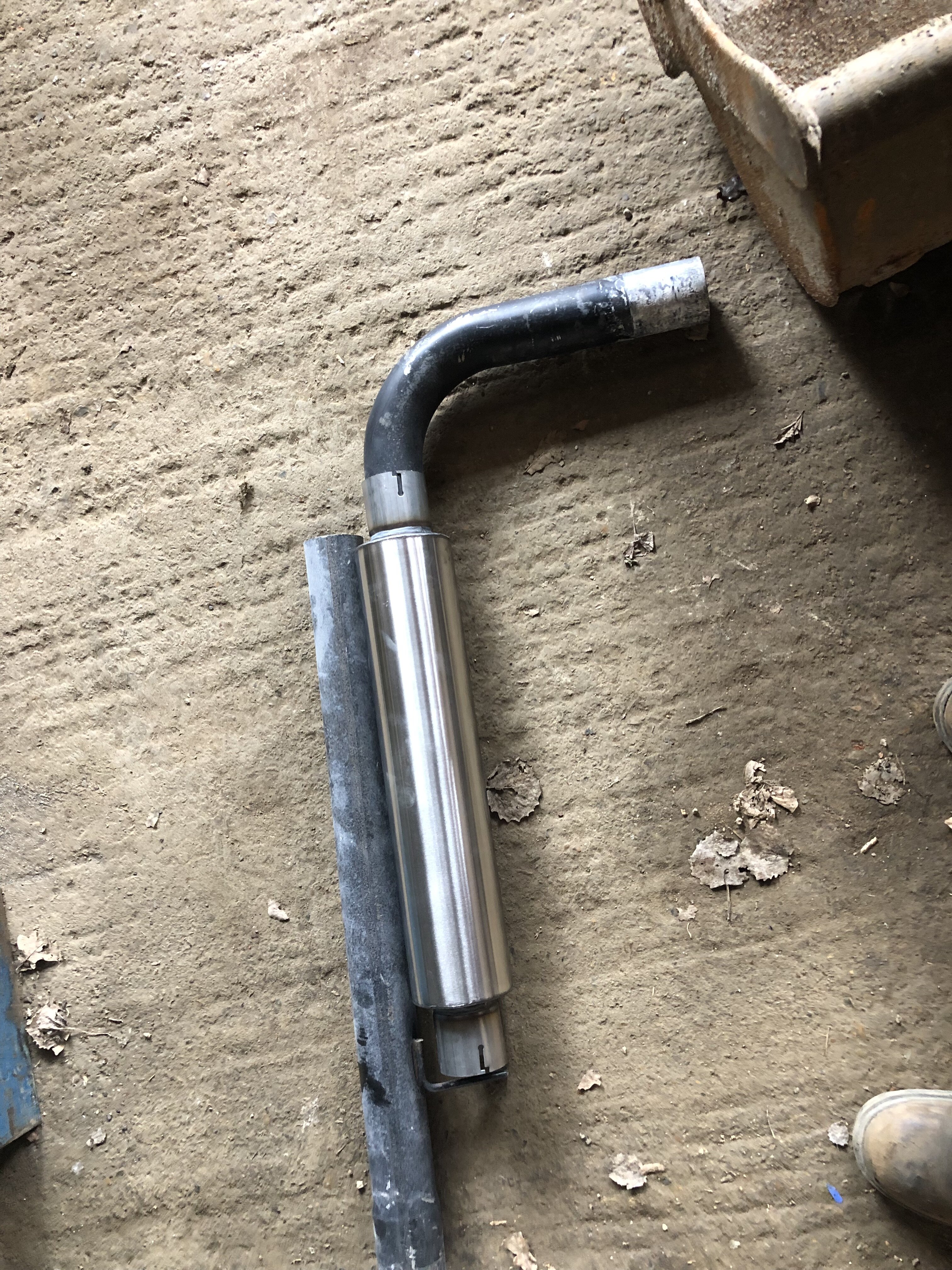

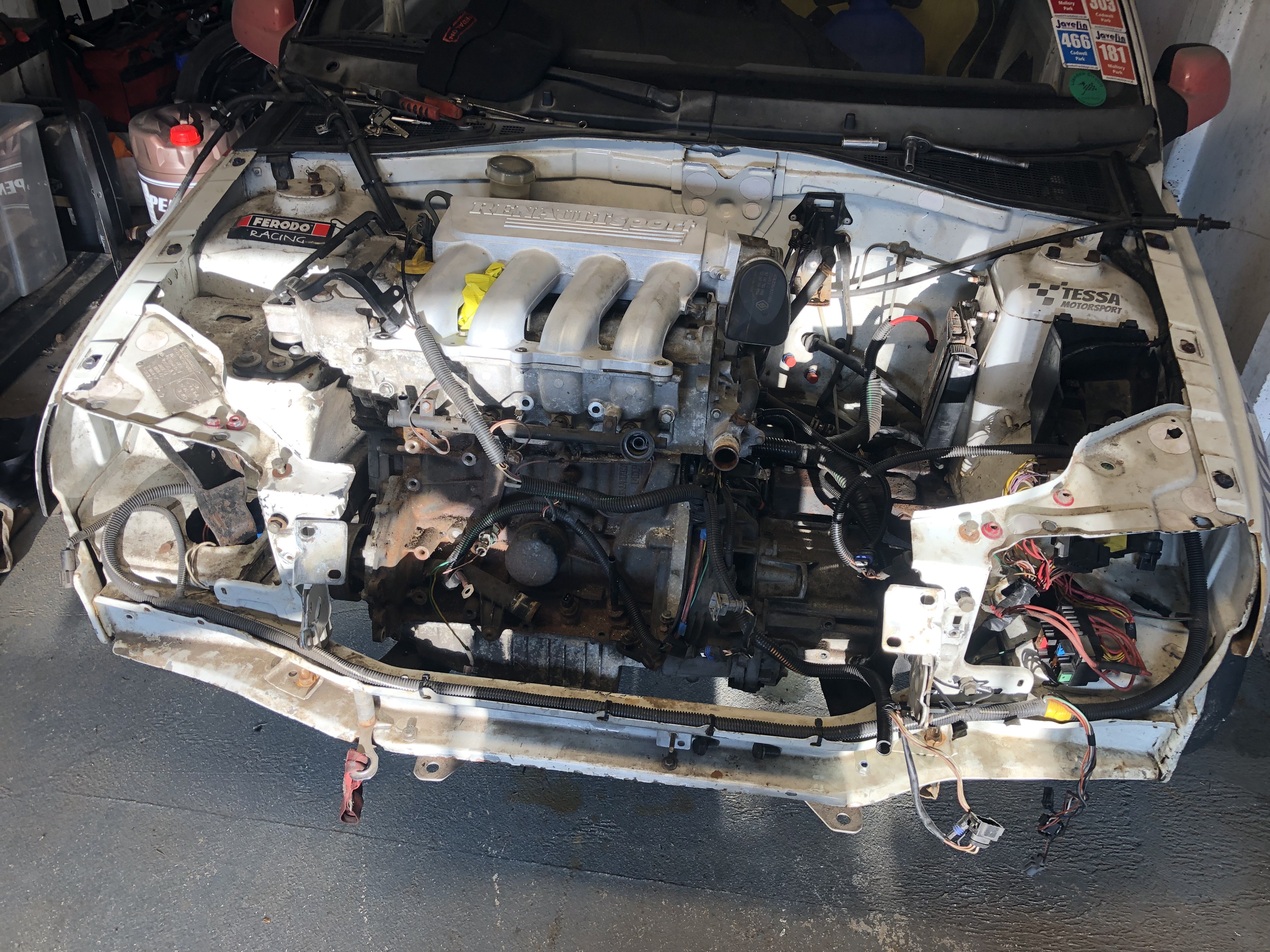

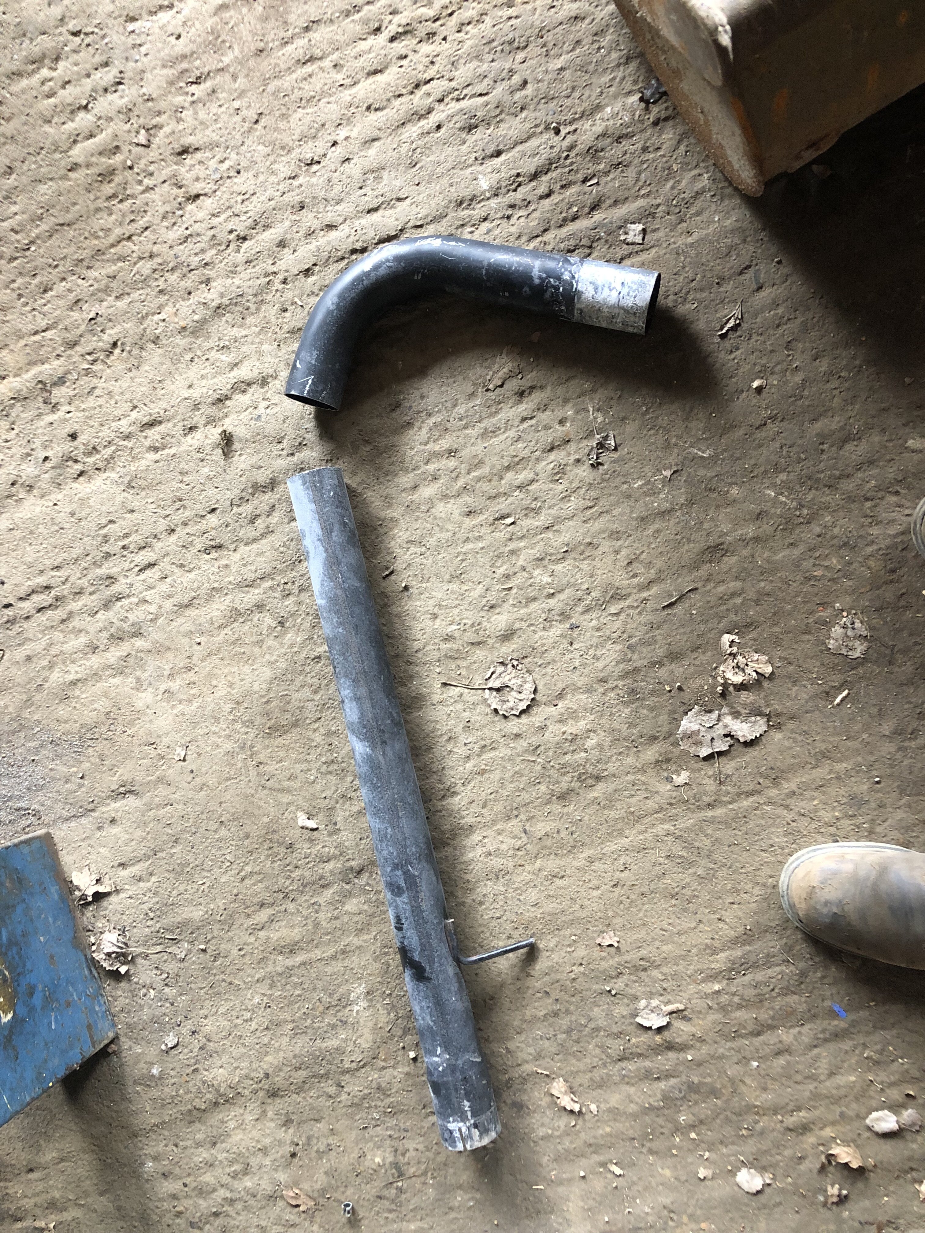

So it’s come time to ditch the tiny exhaust the cup racer came with in favour of a much more free flowing 2.5 inch group n oreca exhaust only problem being is that they are quite loud only having a back box. so I chopped out some of the middle and added in a box then, removed the front of the exhaust then replaced it with a cut down 182 scorpion decat this will mate with the manifold perfect and requires no welding

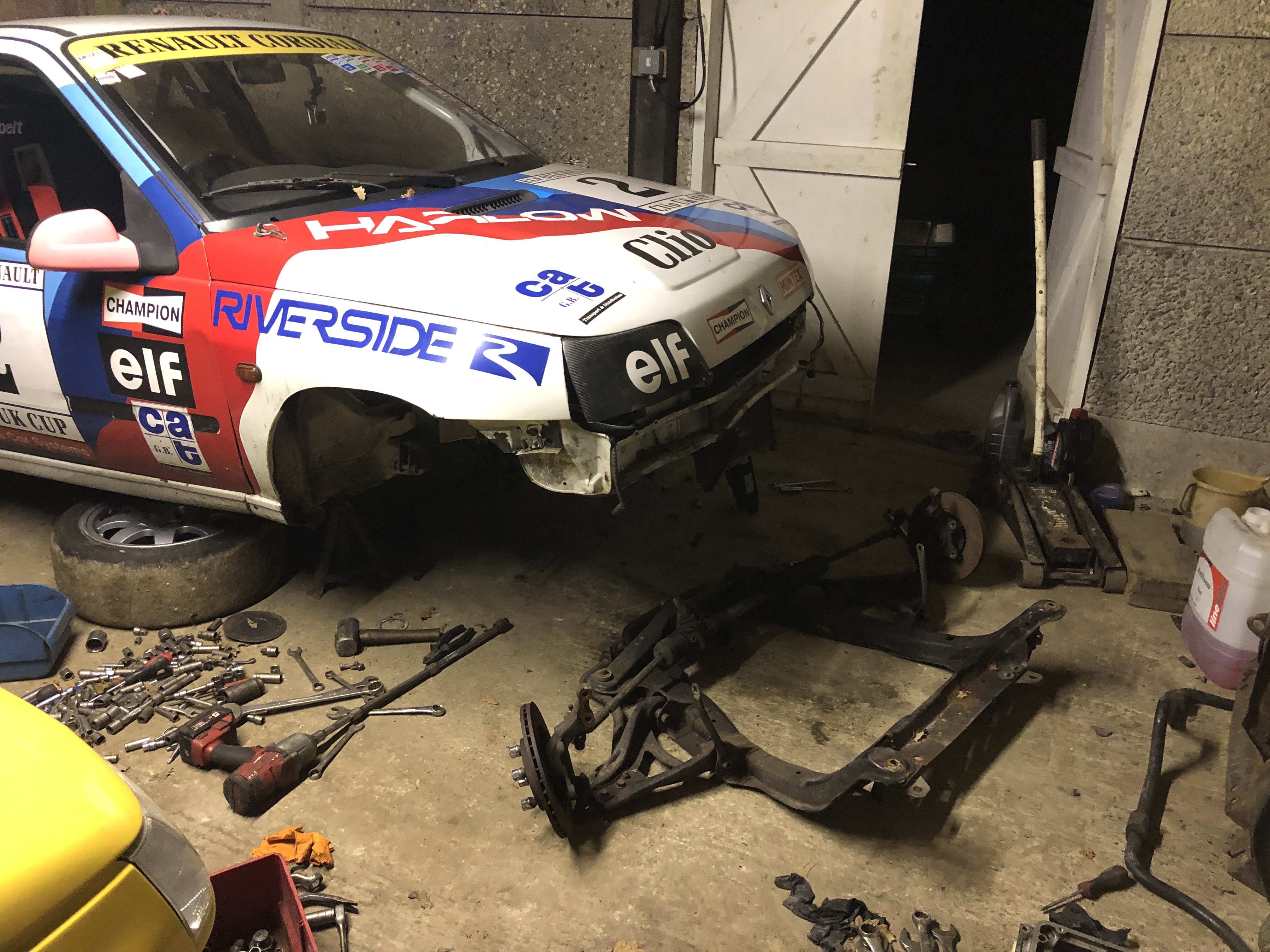

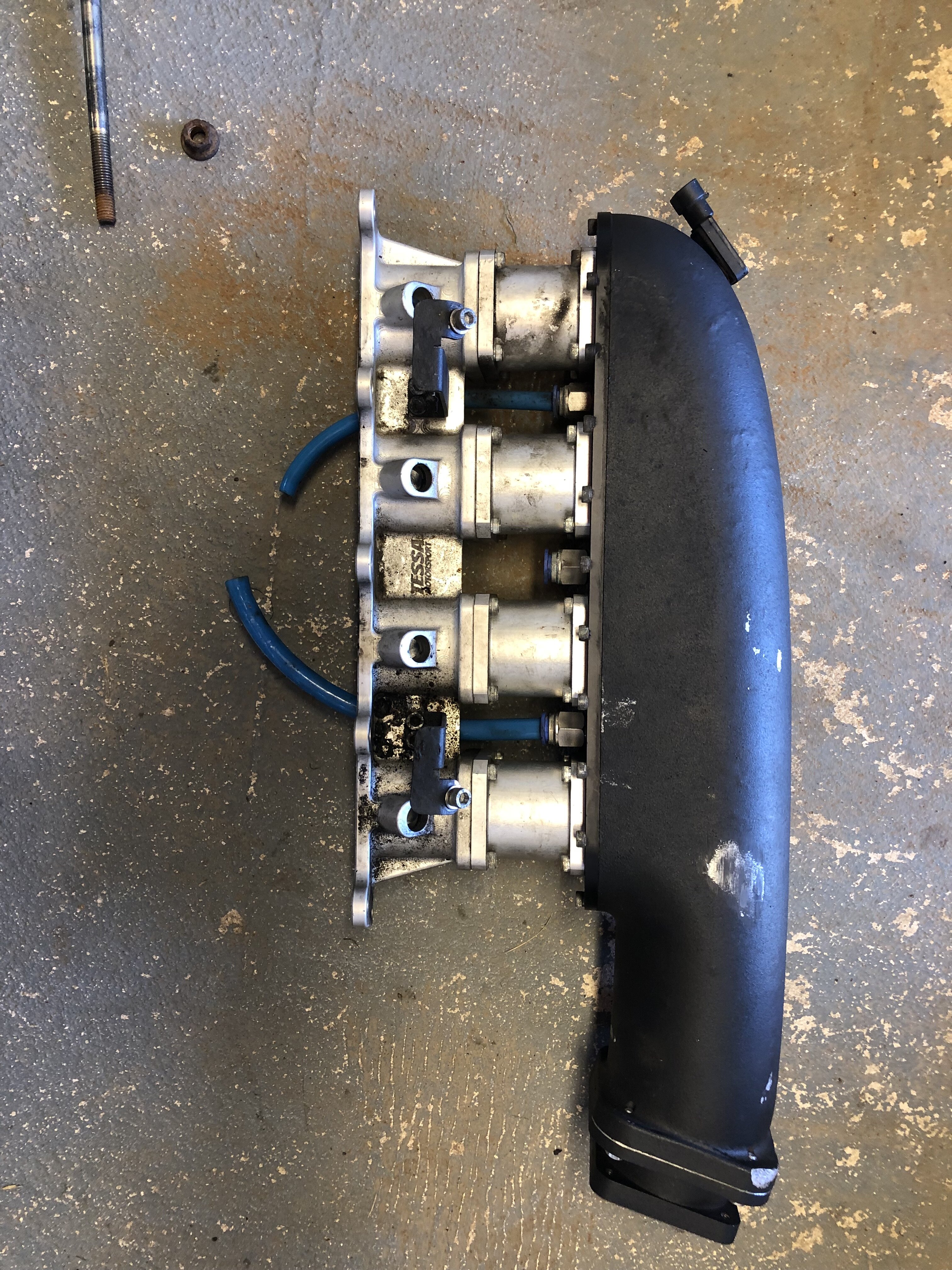

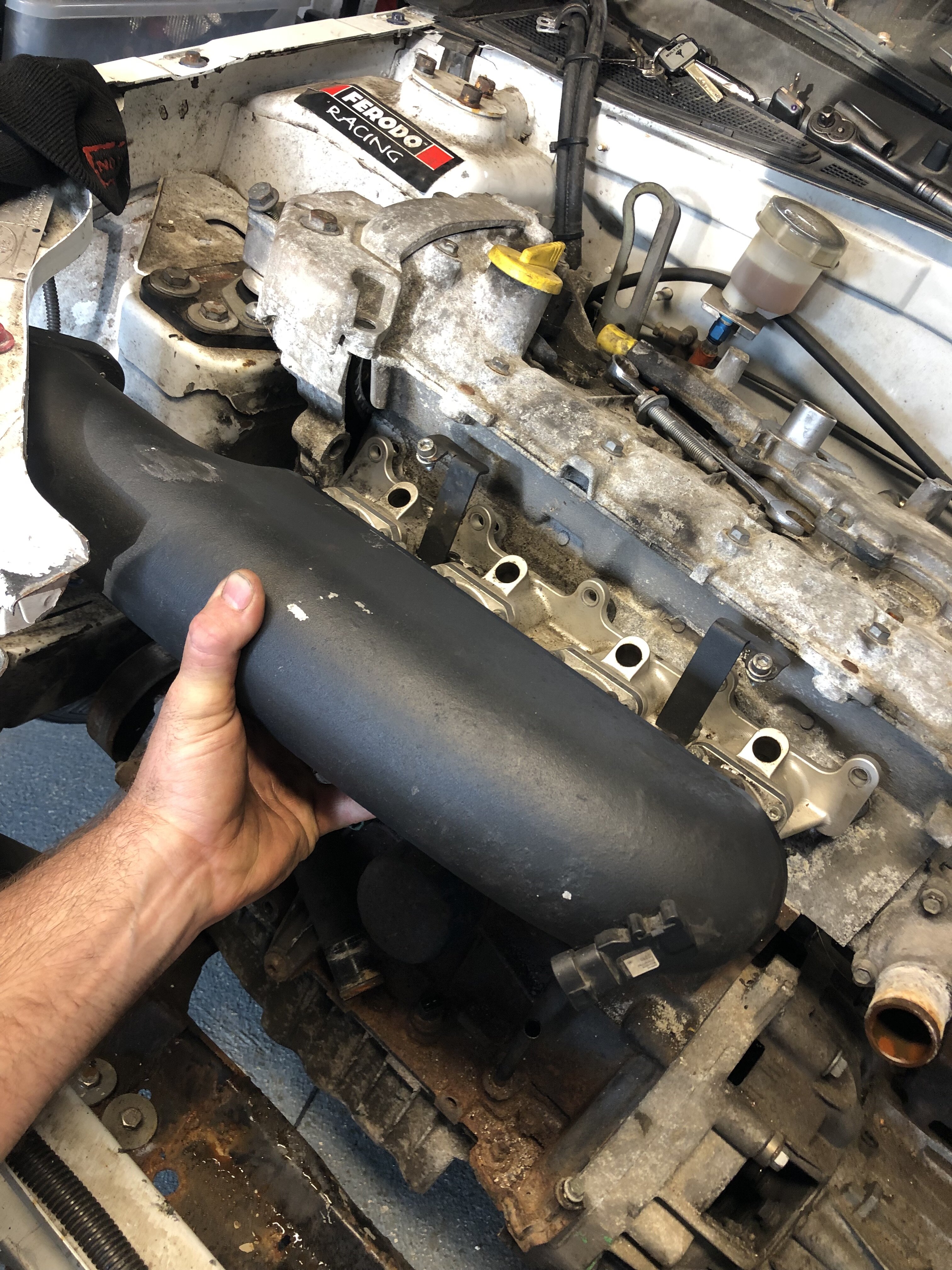

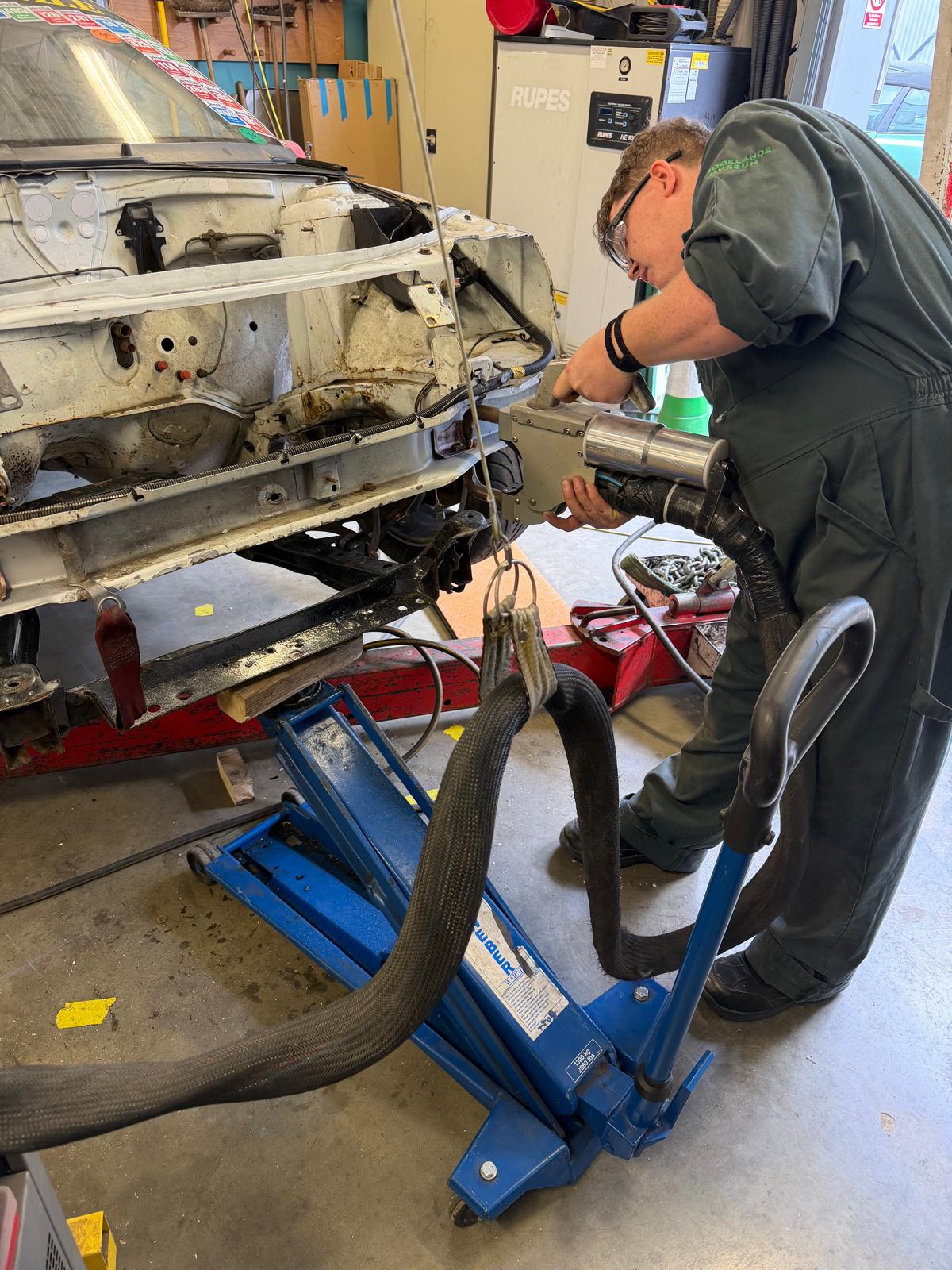

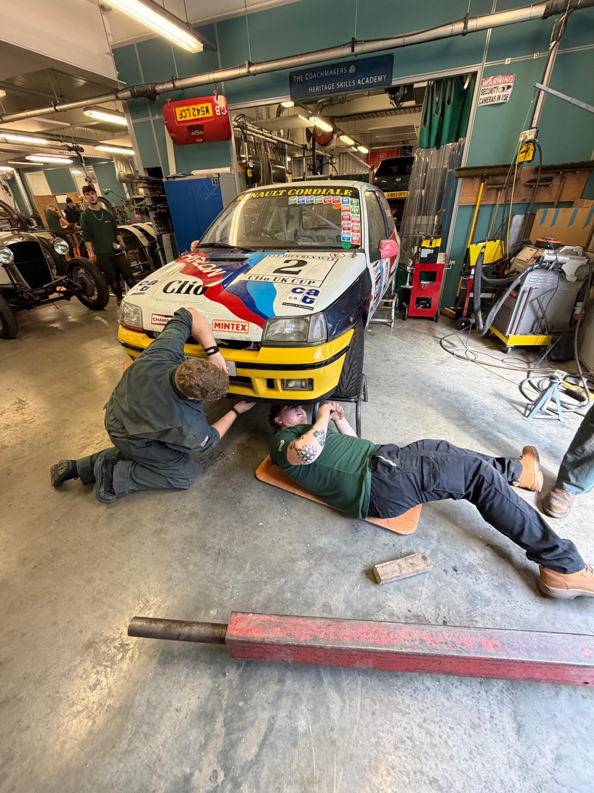

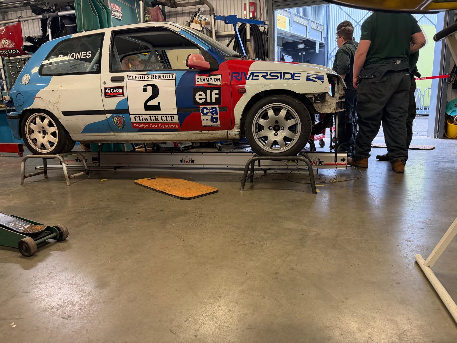

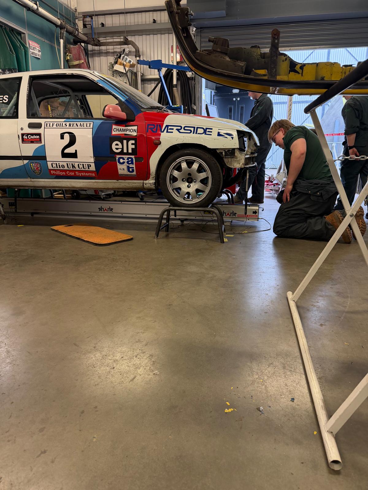

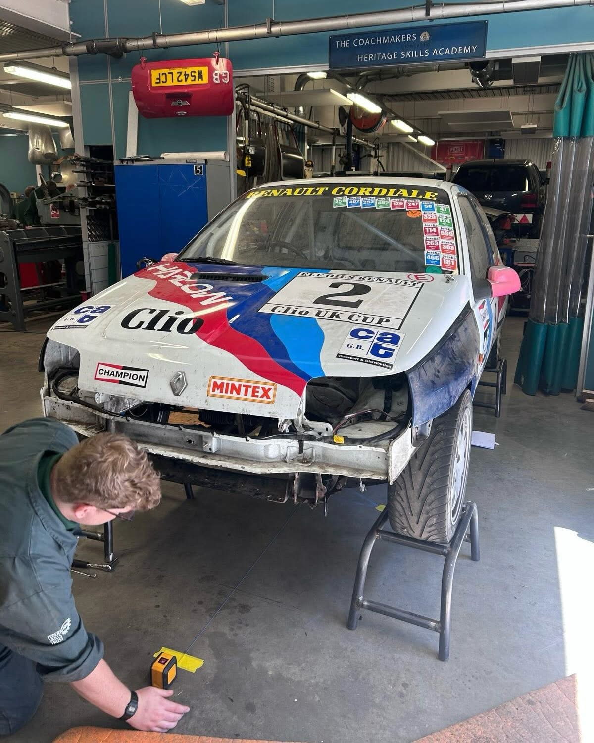

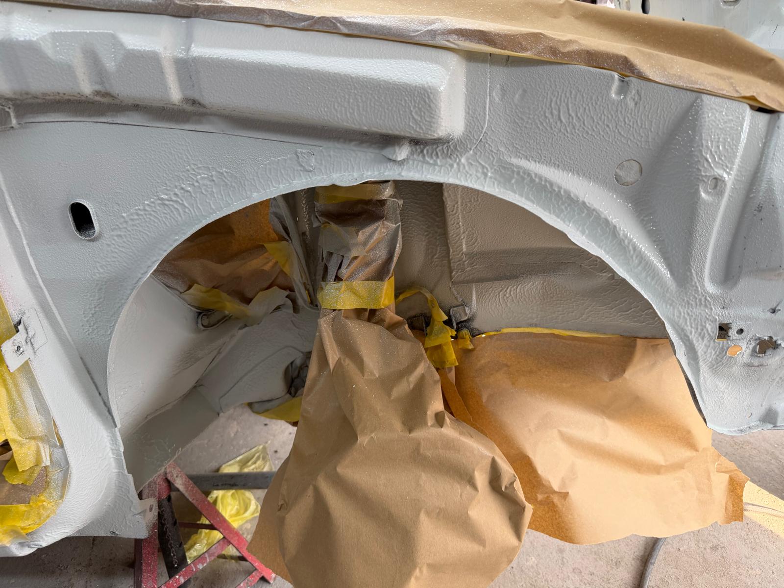

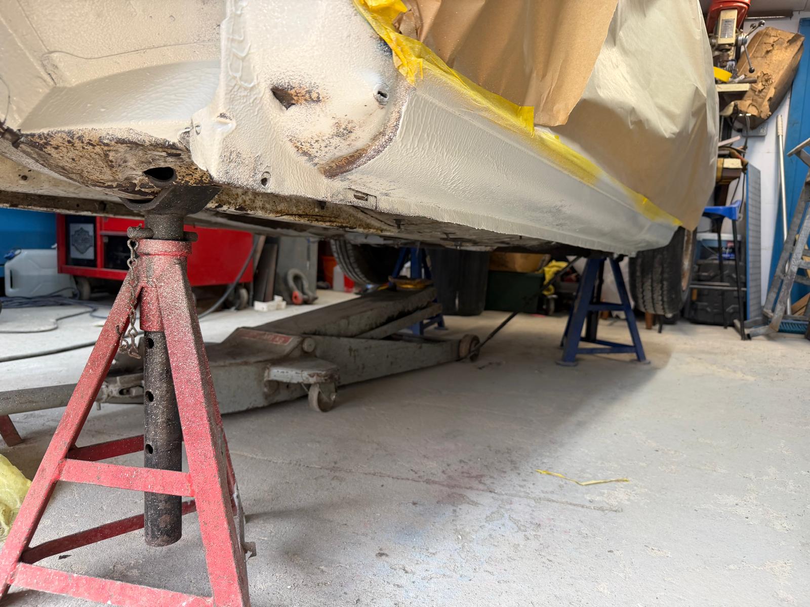

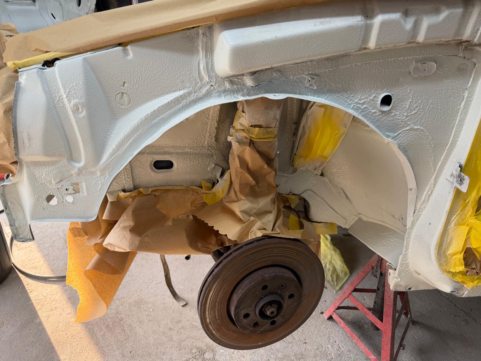

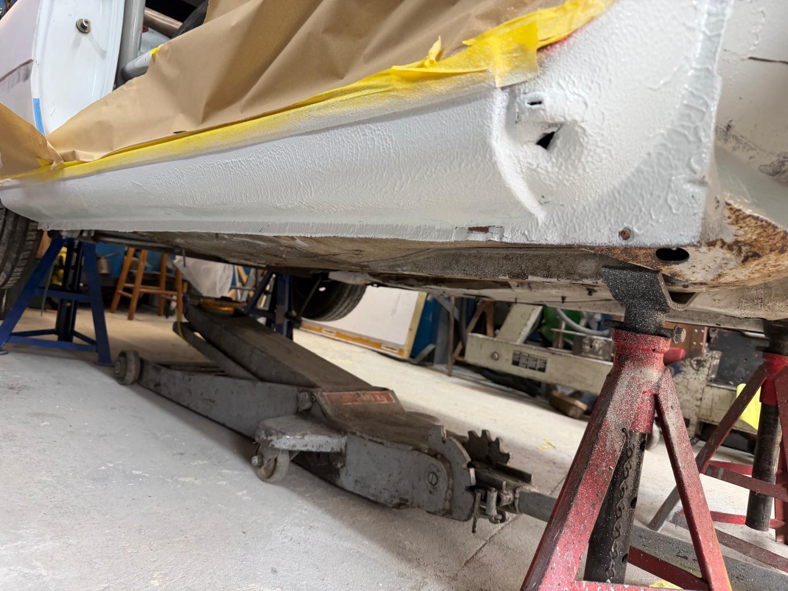

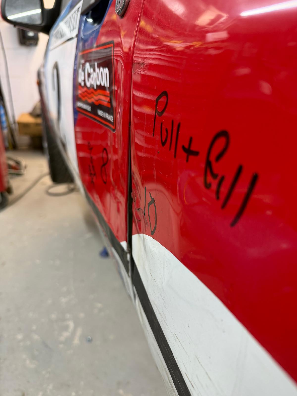

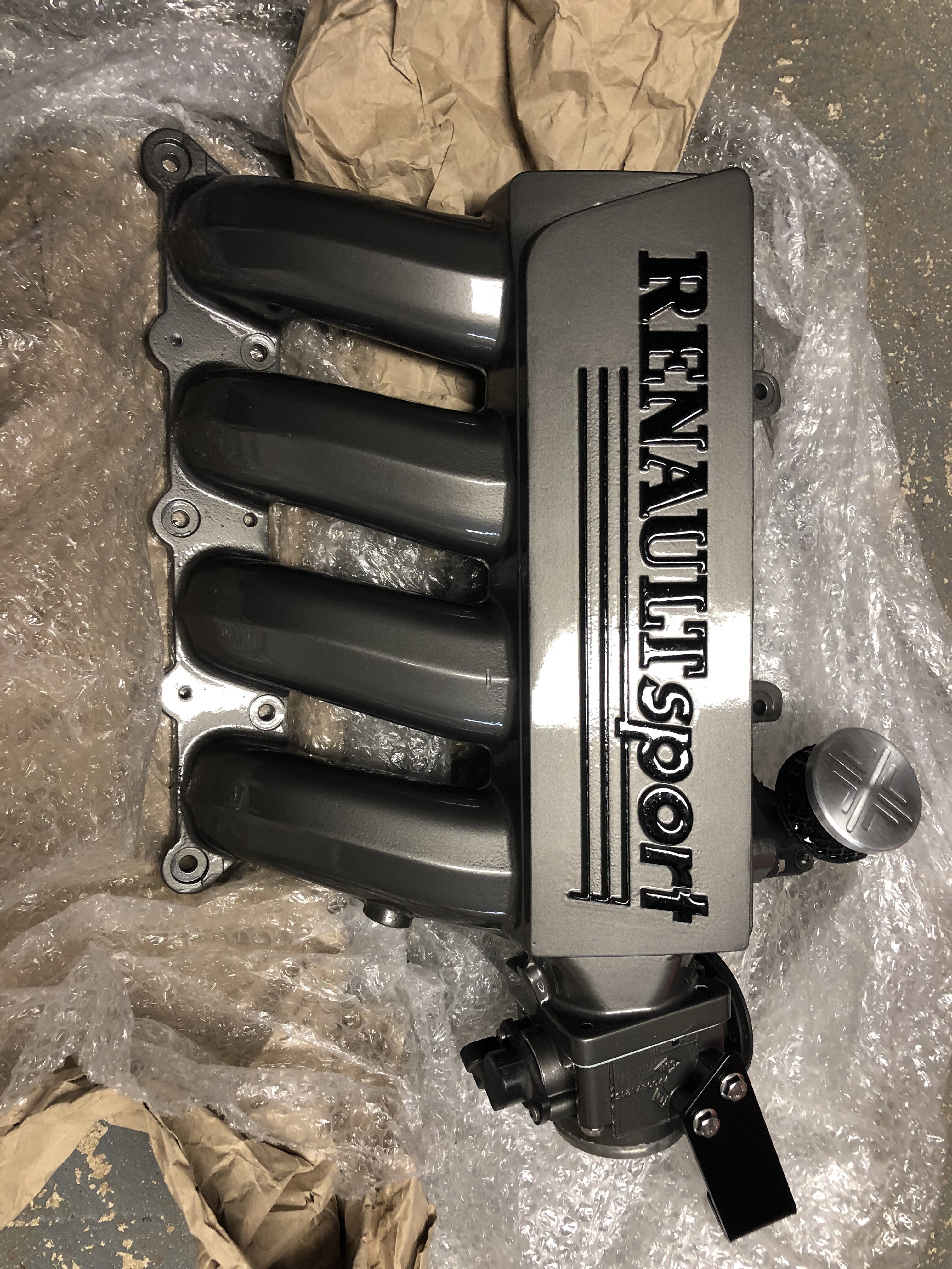

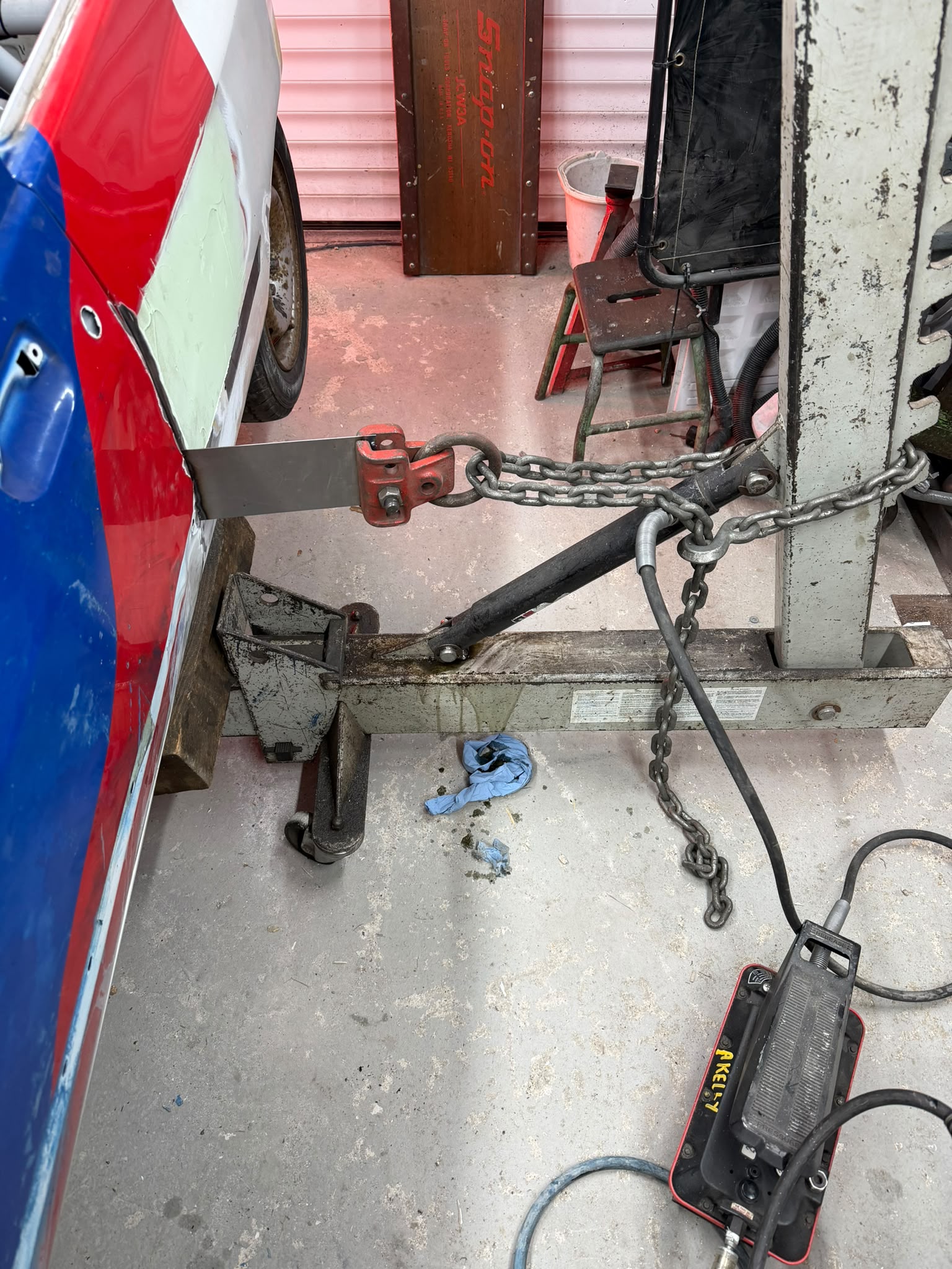

After a lot of deliberation I decided to sell the tessa inlet it sold within minutes of listing its the right decision for this change of direction in the build but before any of that it’s time to get the car put on a jig to make sure it’s straight
  197 clio 16v

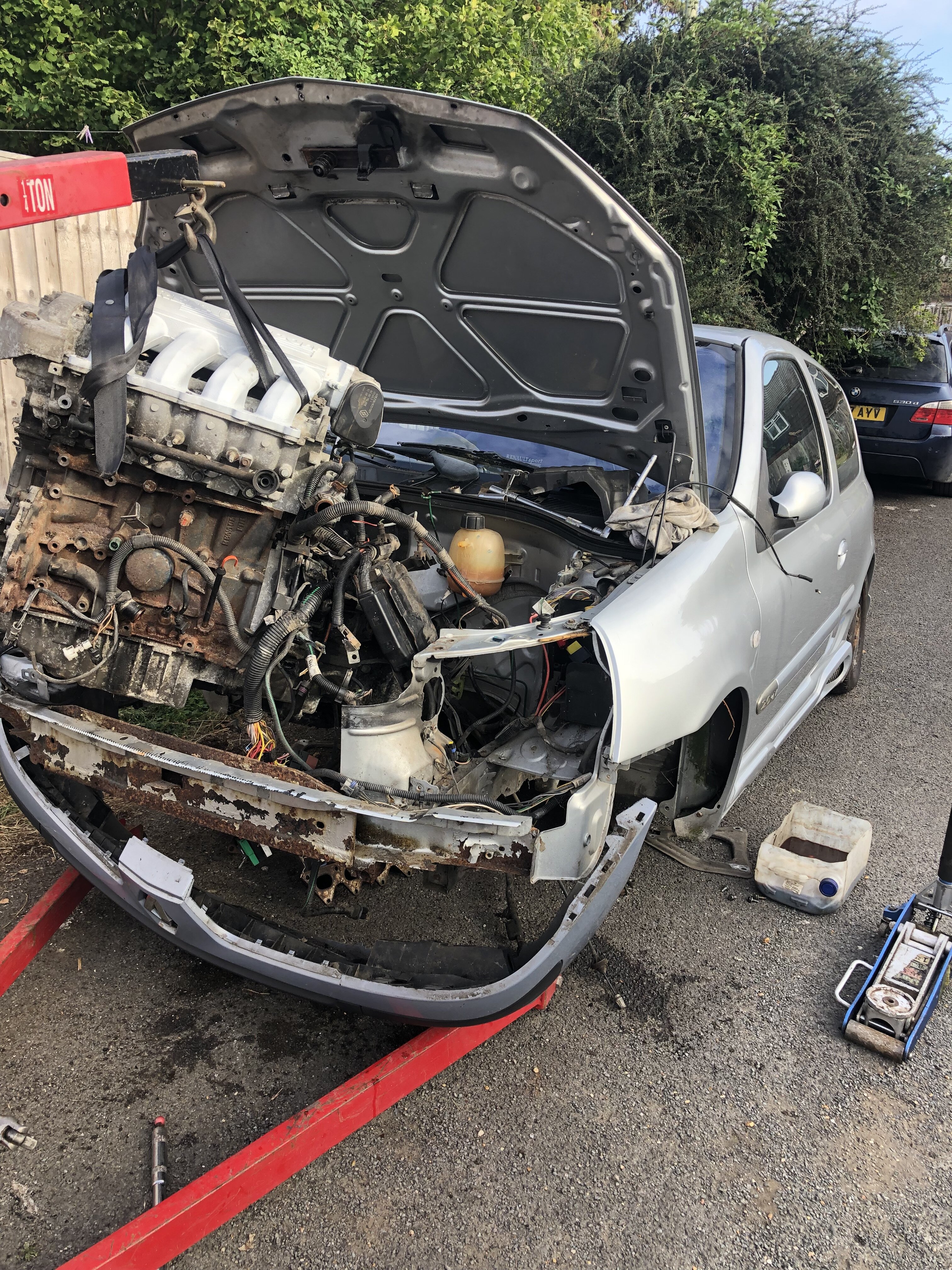

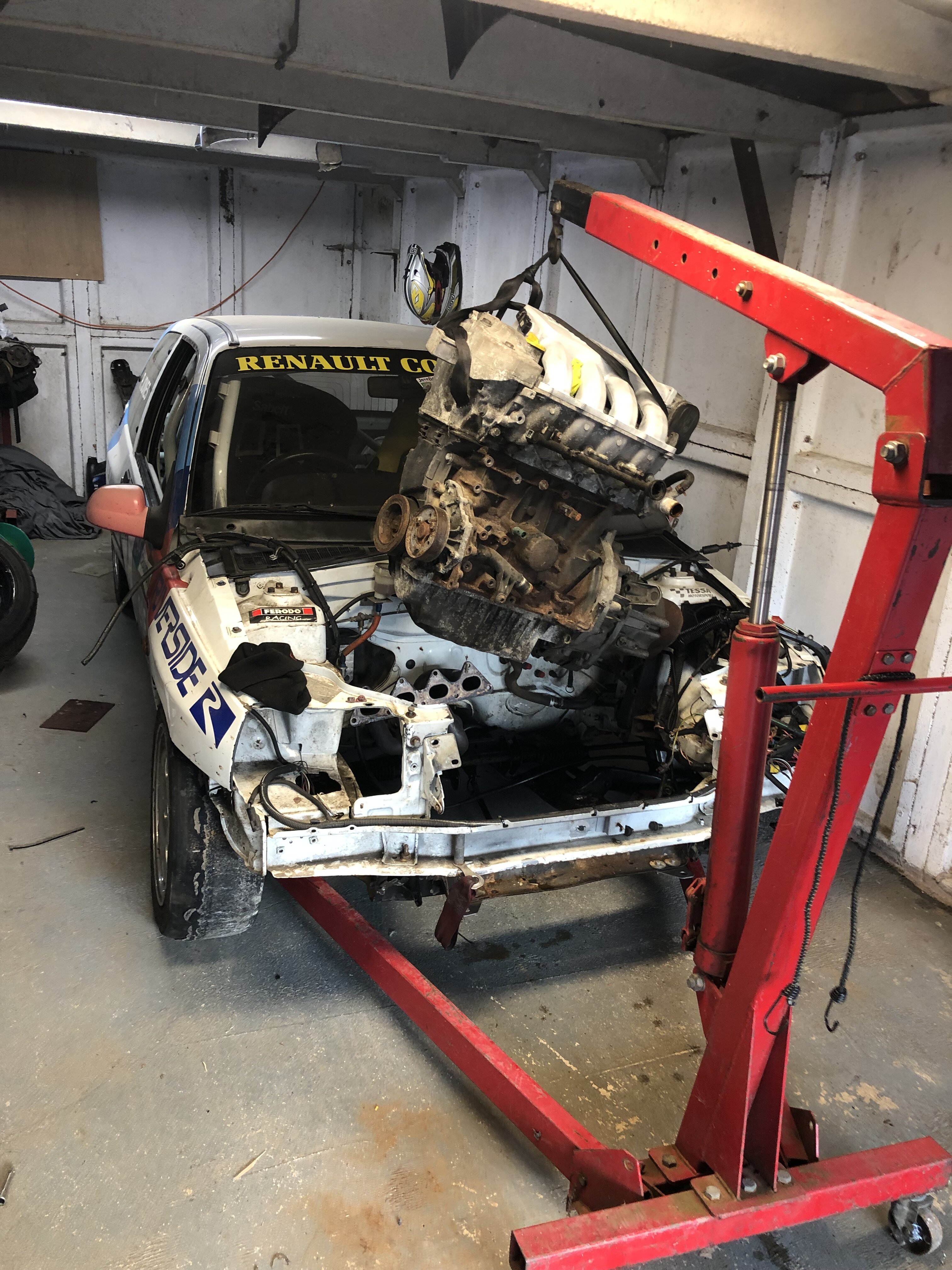

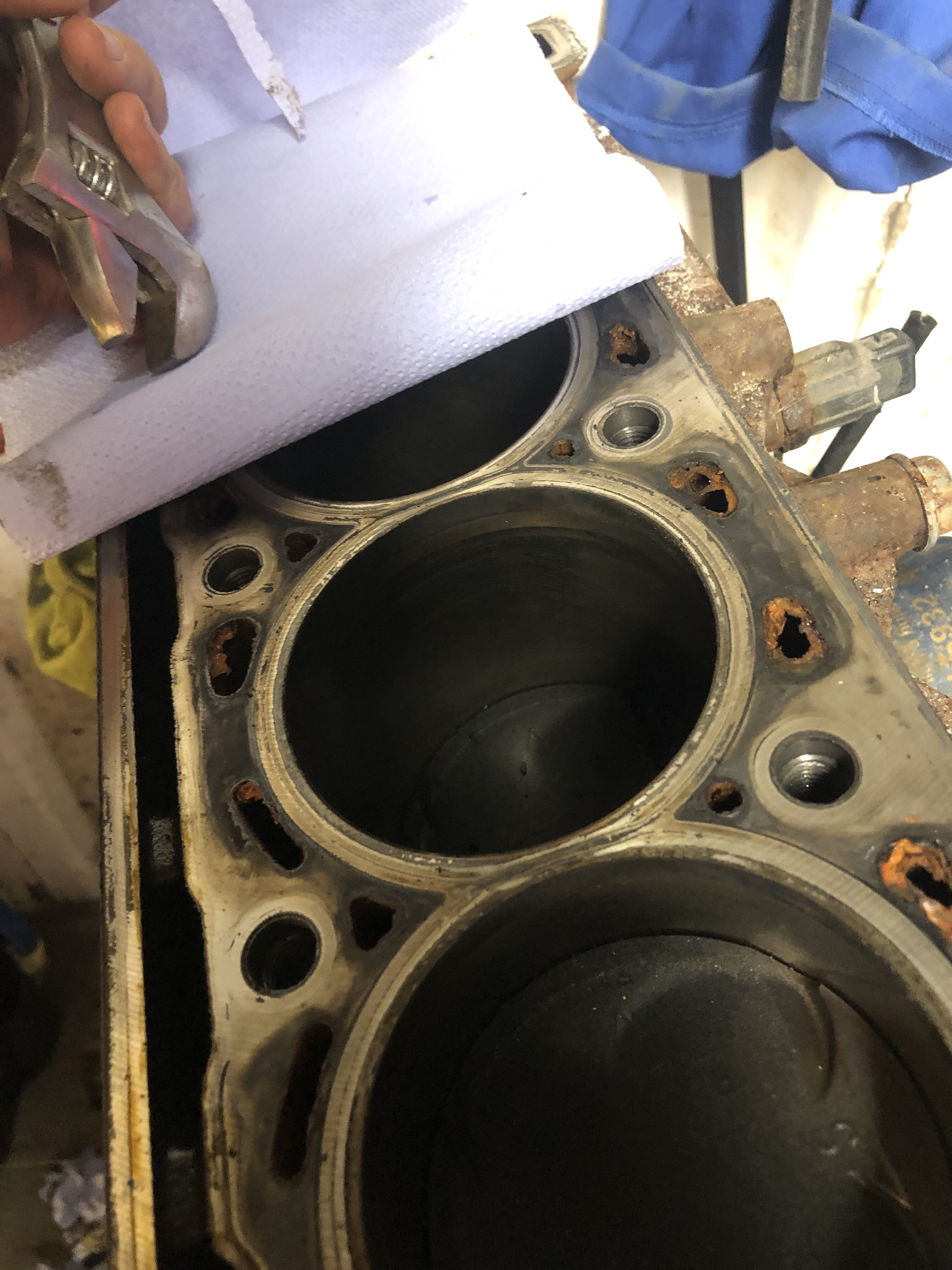

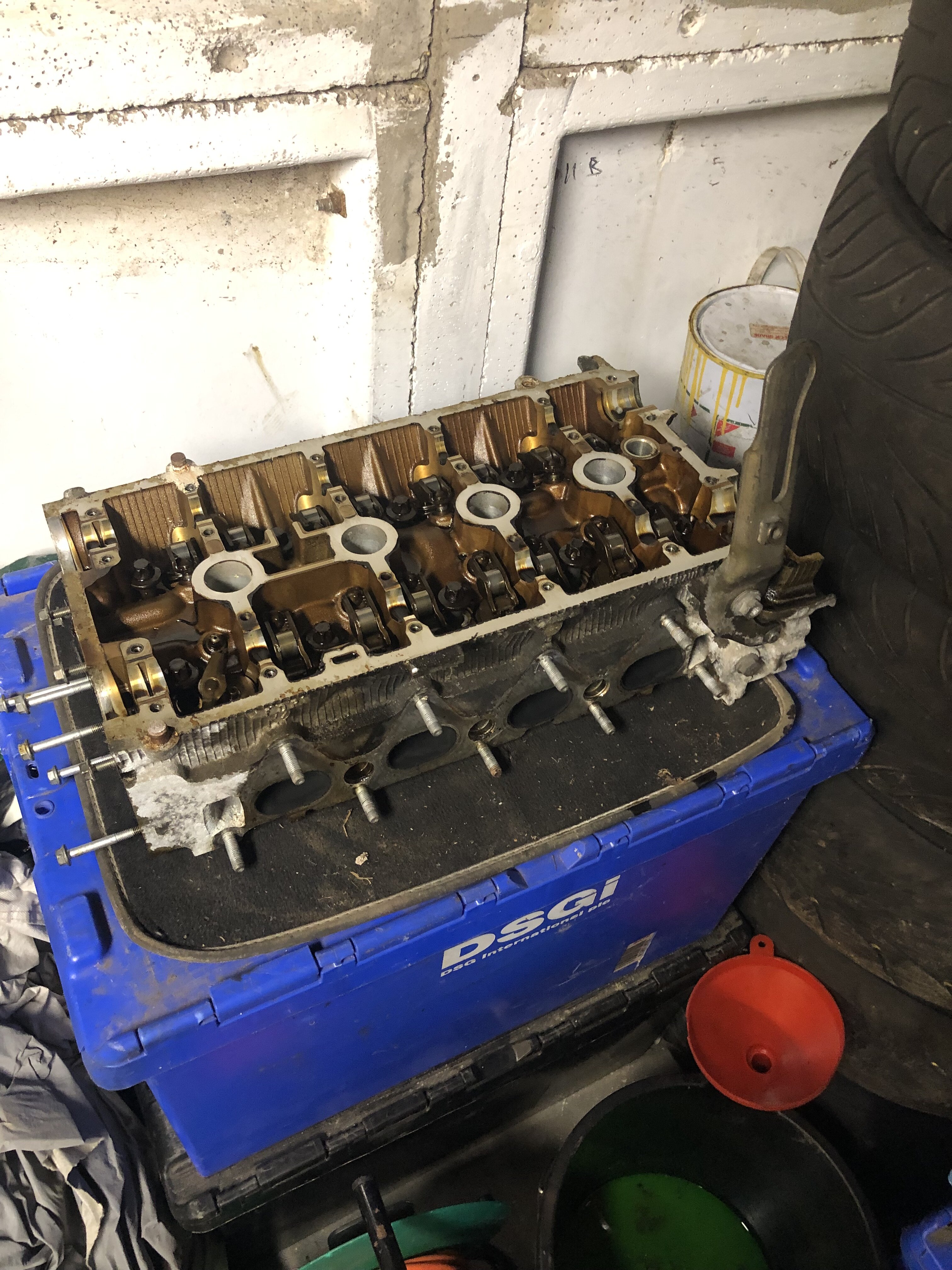

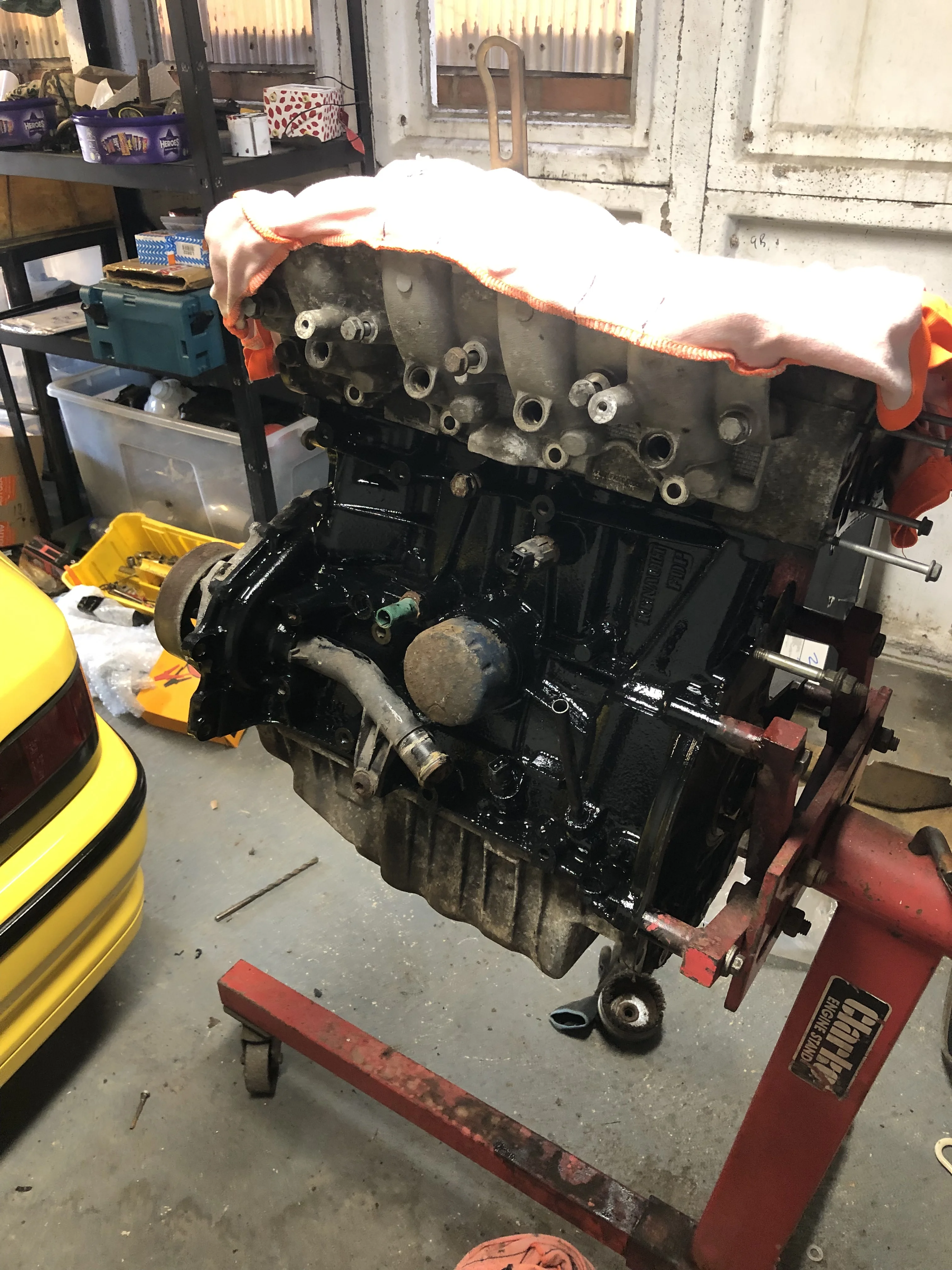

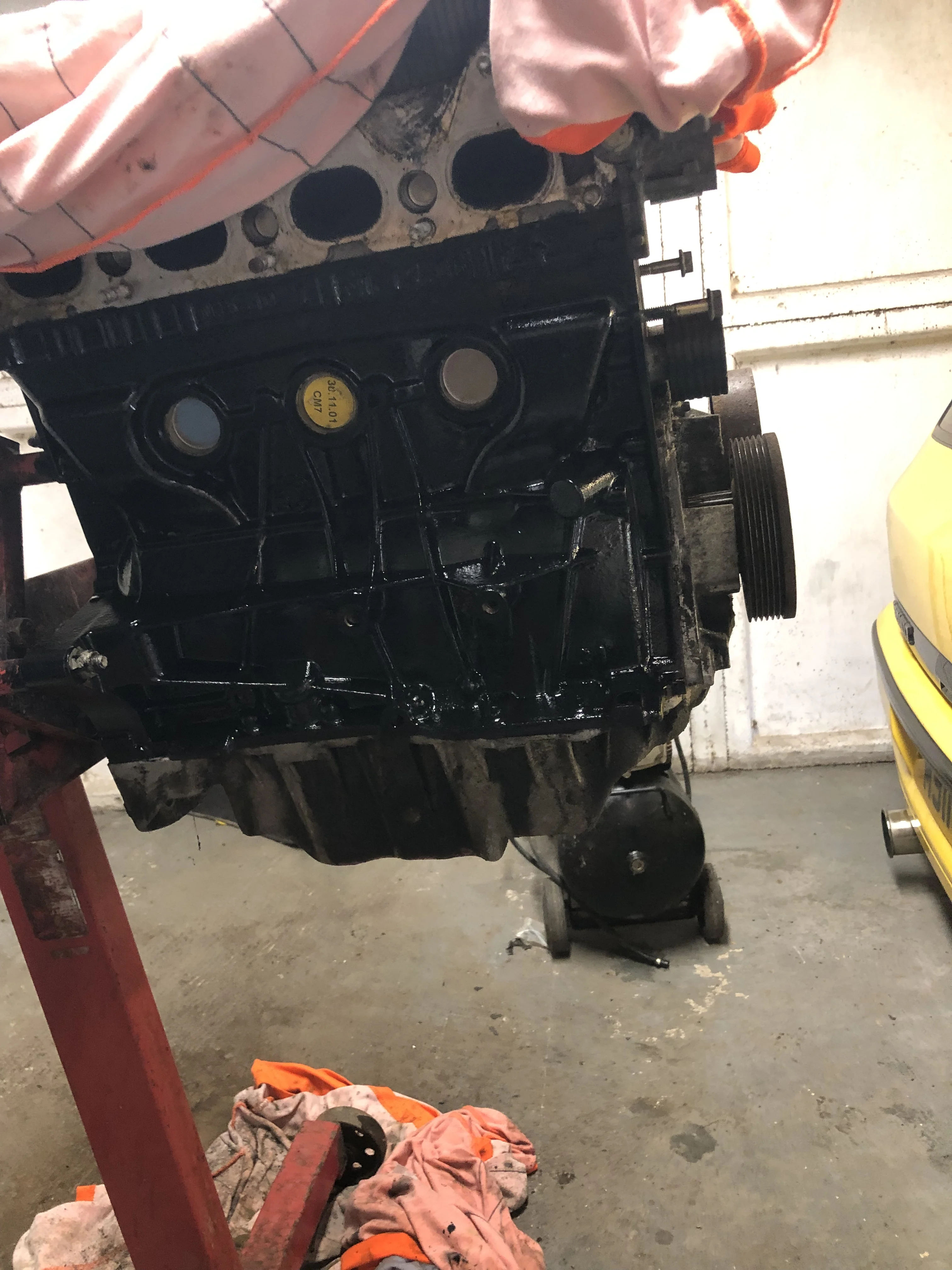

Straight from one project and heard first into the next 😭 I’ve taken the new engine apart just to check it’s and a little refresh maybe a bit of paint

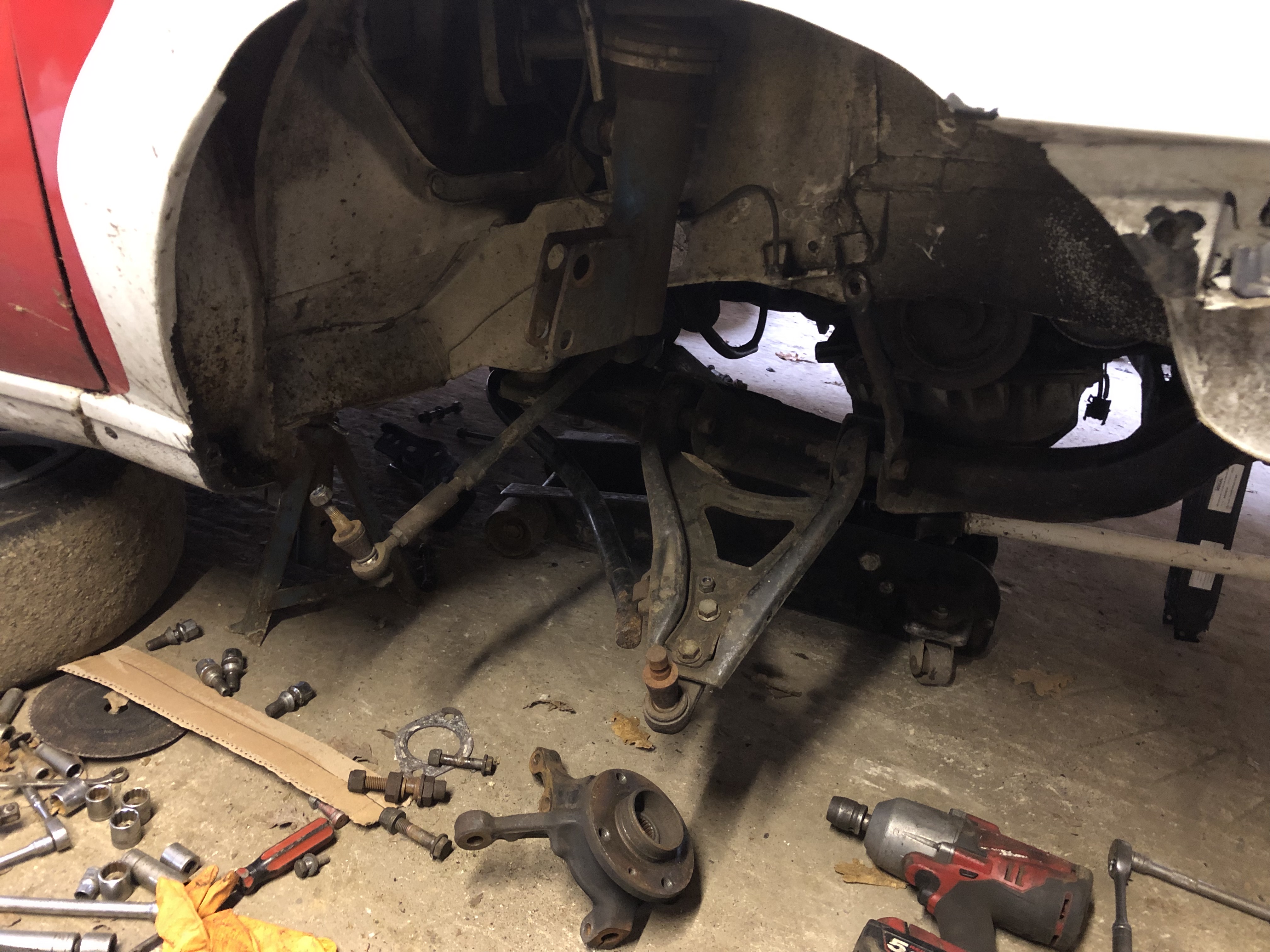

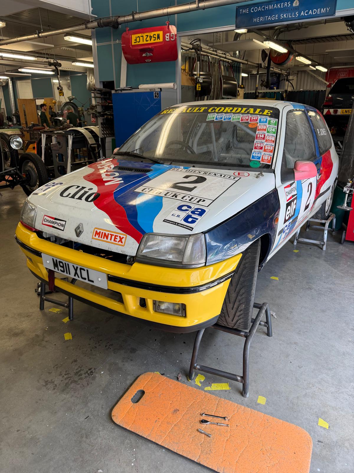

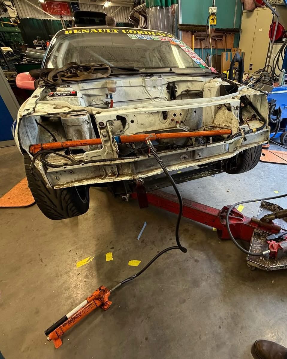

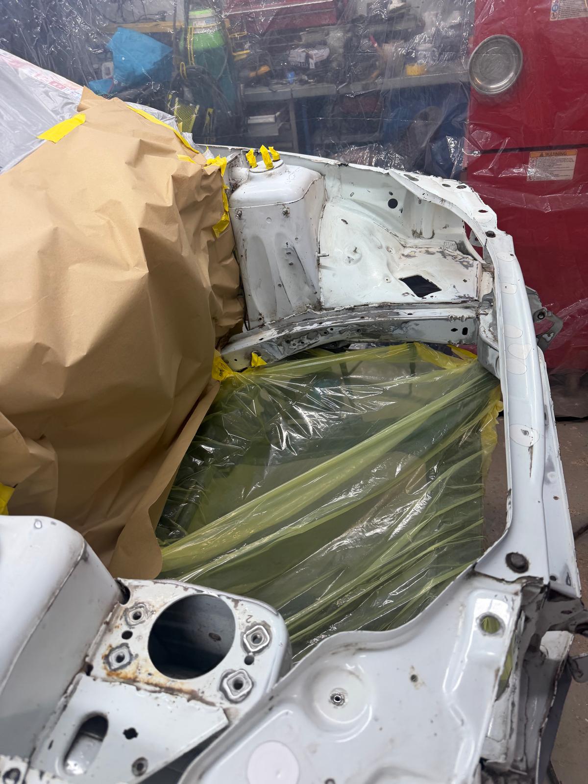

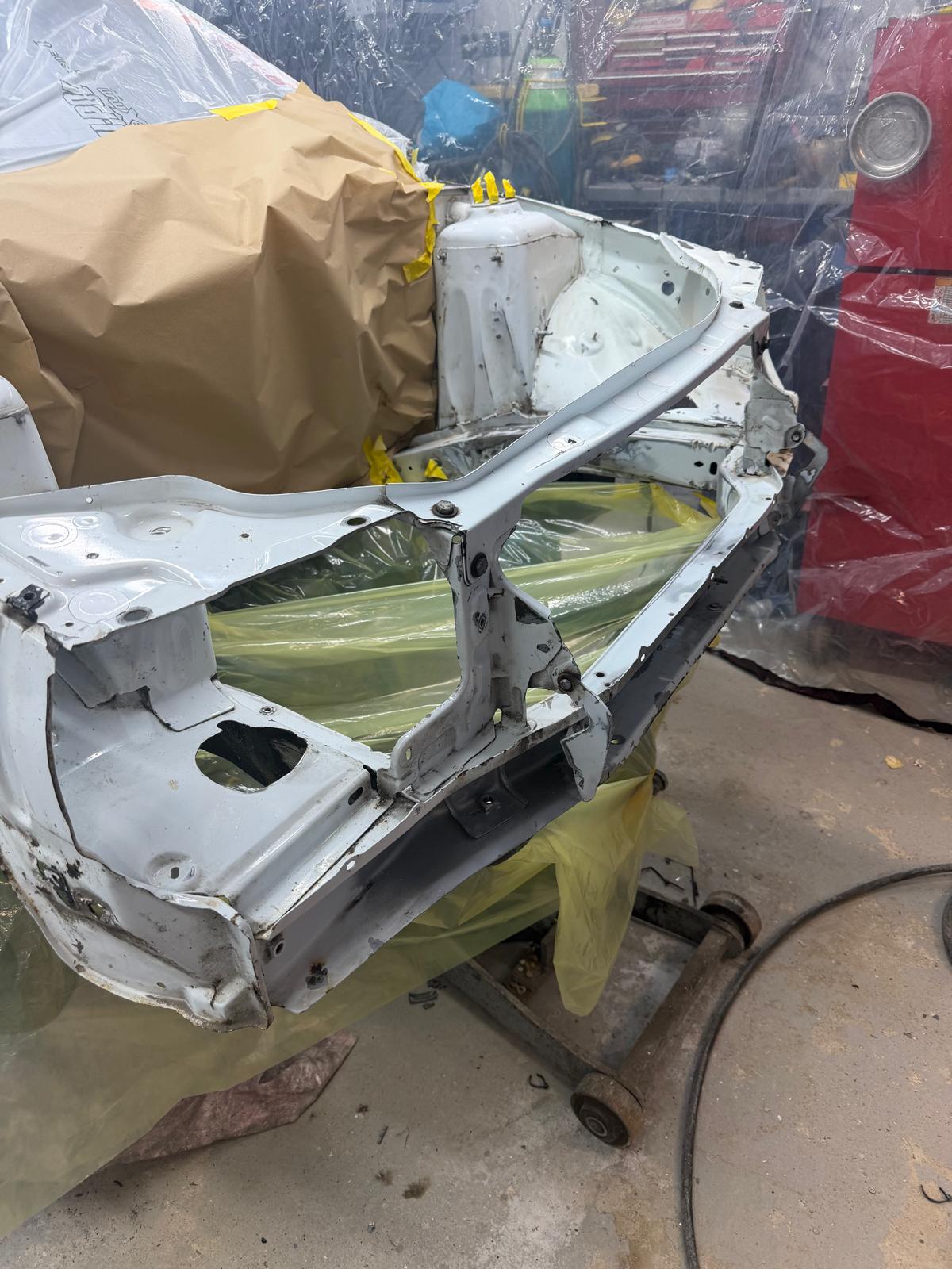

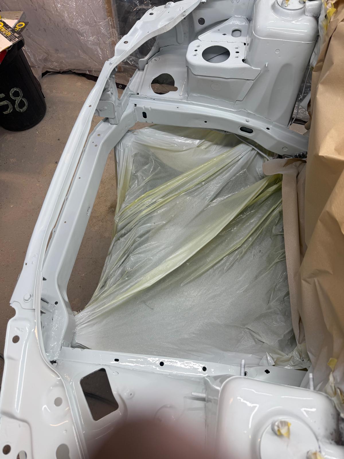

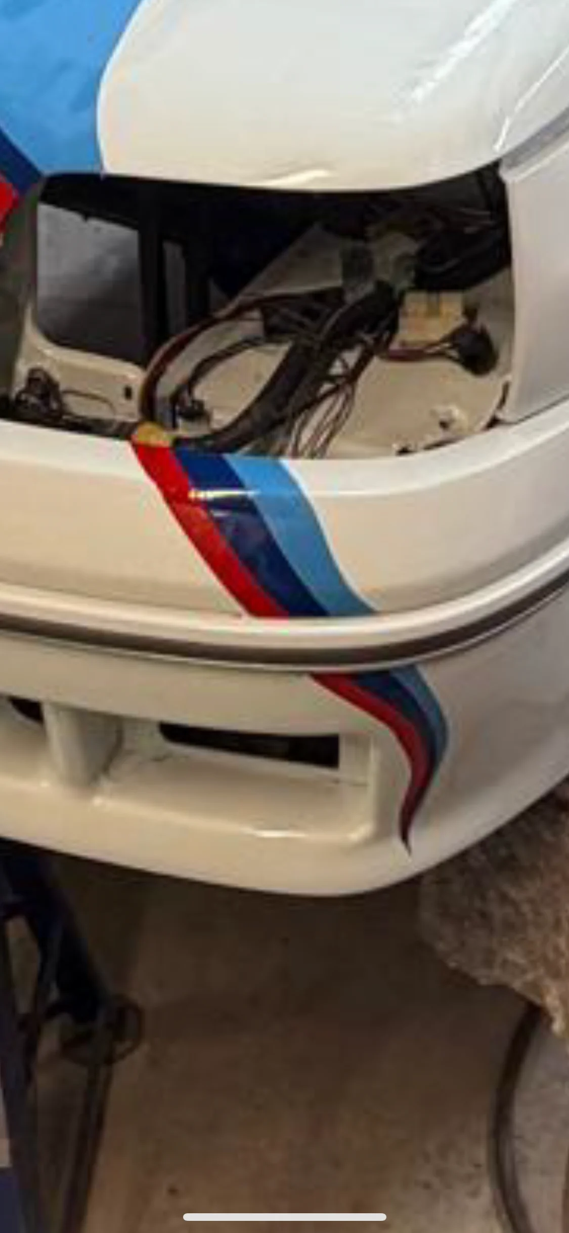

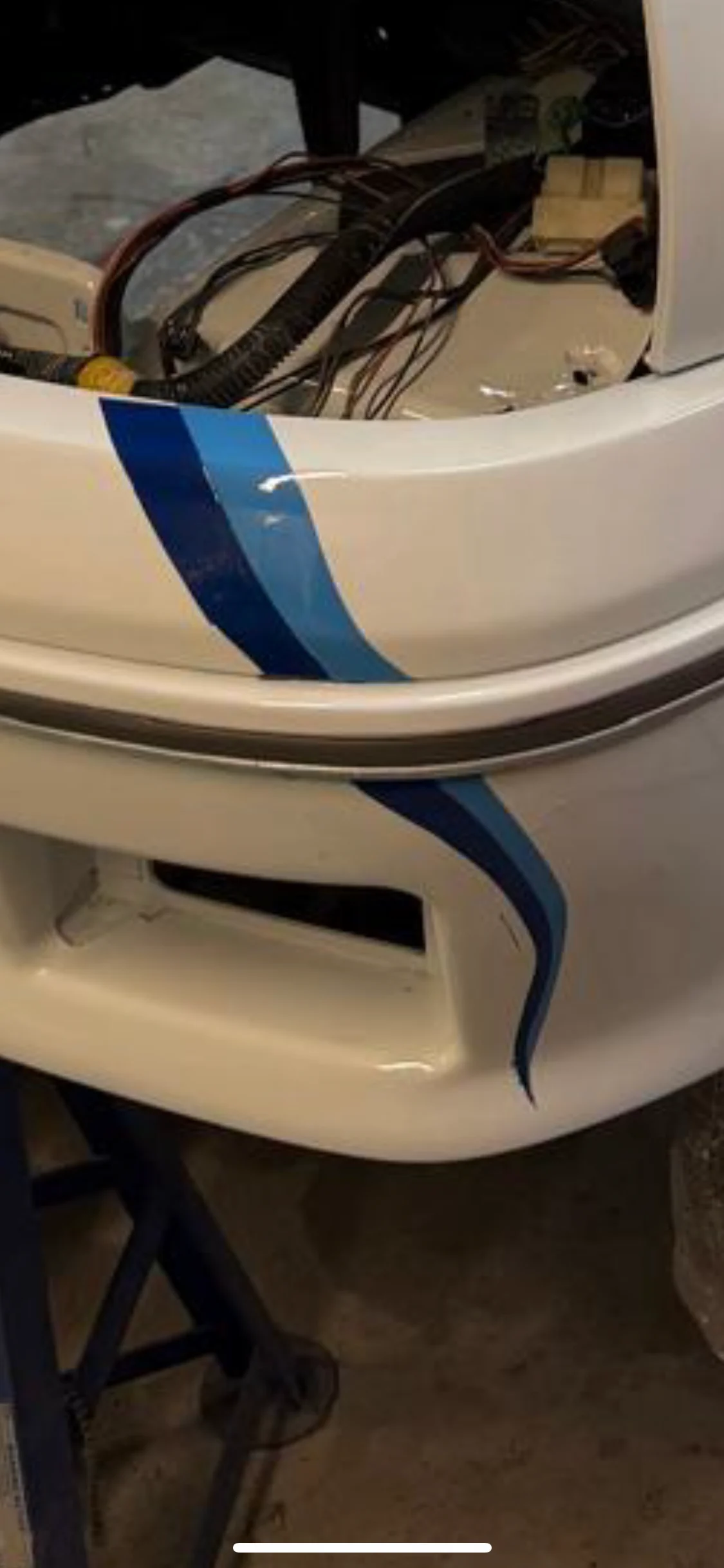

Now the front end and the flitch has been pulled out everything sits really nicely is was so bunched up on the n/s/f before please excuse the yellow bumper I had to take it off my other car it’s the only good bumper I have

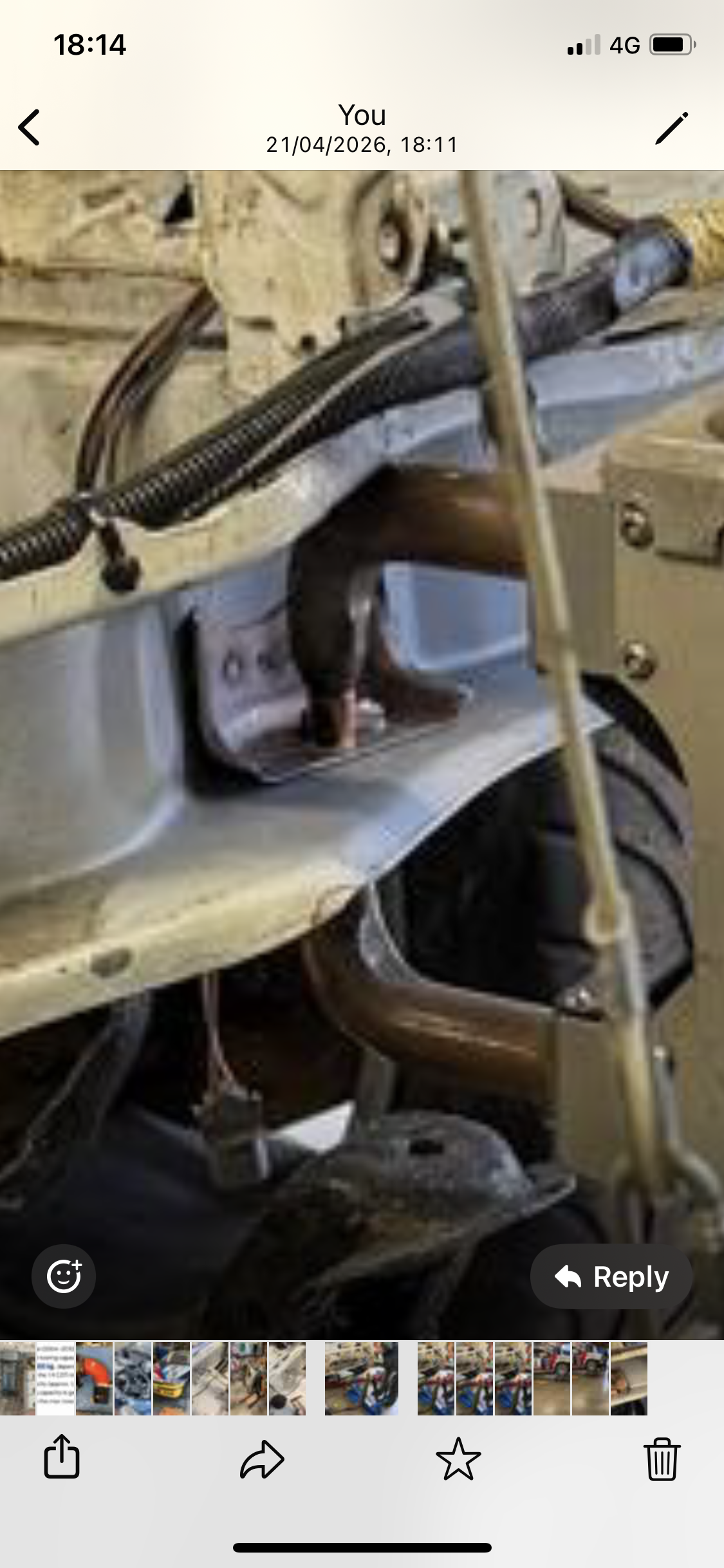

So I had whatever these are called replaced on the crossmember as the front end wasn’t completely straight someone had elongated the holes and removed the captive nut so the subframe can sit straight but now that I’ve had the car put on a jig and pulled straight no need for that anymore
