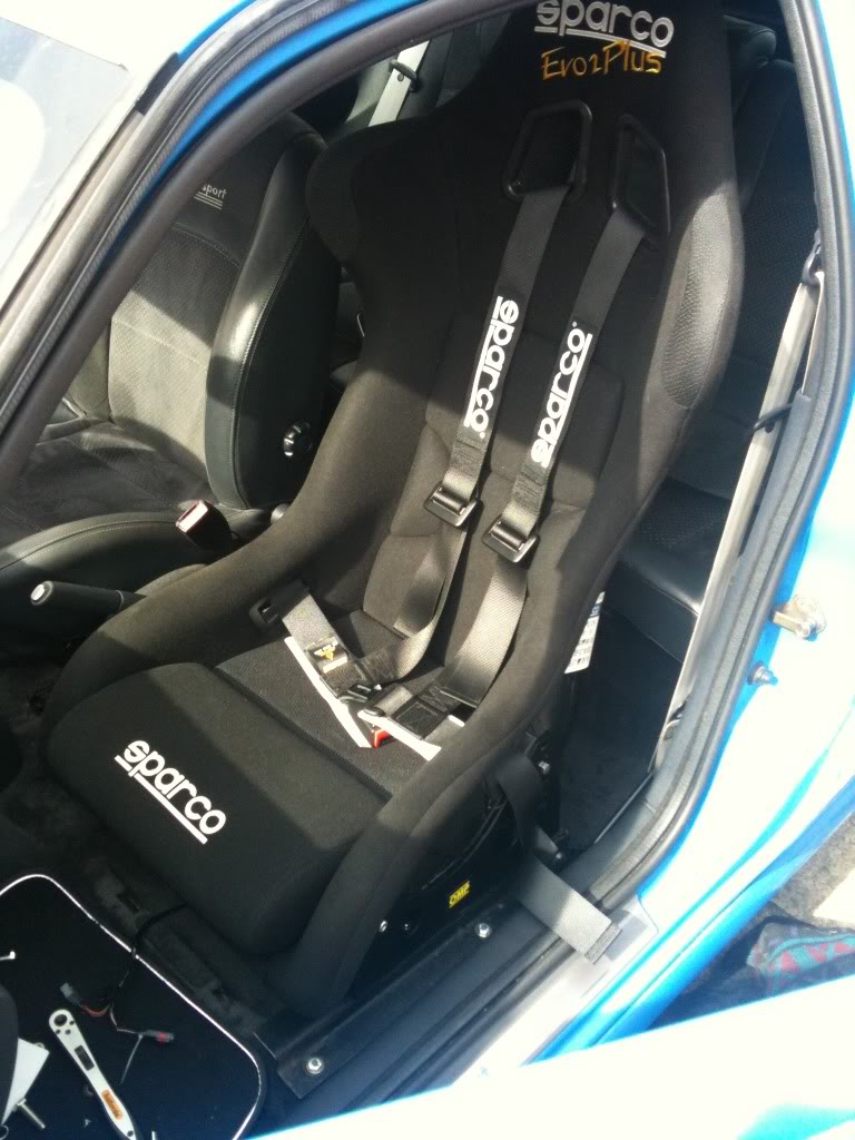

Basically iv removed the back seats and mdf/carpeted the back of my Trophy Clio and Been looking at some Sparco Red harnesses to go with my Recaro buckets but need help on wether i need 3 point or 4 point harnesses...
Theres 2 holes in the top of the seat so assumed i needed 4 point so i cud feed 2 of the straps thru the holes and bolt them down in the bk but IDEALLY wanted 3 point harnesses...was wondering if the harness comes apart in anyway or has anyone seen 3 points fitted to this type of bucket?! CONFUSEDDDD :/
harnesses, be it 3 point or 4 point will all have 2 straps that come through the seats. the 3 POINT or 4 POINT refers to the numbers of points mounting it to the car. so if you buy 3 point harnesses the harness will be mounted to the car in 3 points and 4 point harnesses in 4 points and so on...... it has nothing to do with the shoulder straps coming through the slots, there will always be 2 coming through.
i use 3 points and they are spot on.
i hope that makes sense and answers your question!
I have 3 points, they dont come apart you just have to thread them through.
Only pic I have atm:
