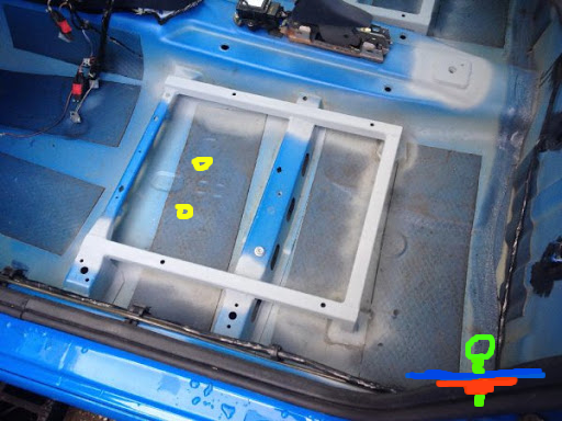

Mine are mounted thru the floor around about here. Spreader plate on the underside.
(not my photo, just stolen to mark up on)
  BMW 120D M Sport
Im assuming thats the other harness mount on the exhaust tunnel?
I’ve just been wondering where to put that one as well, As if i go on the flat floor it sits behind the seat and not sure if that would meet the regs for racing

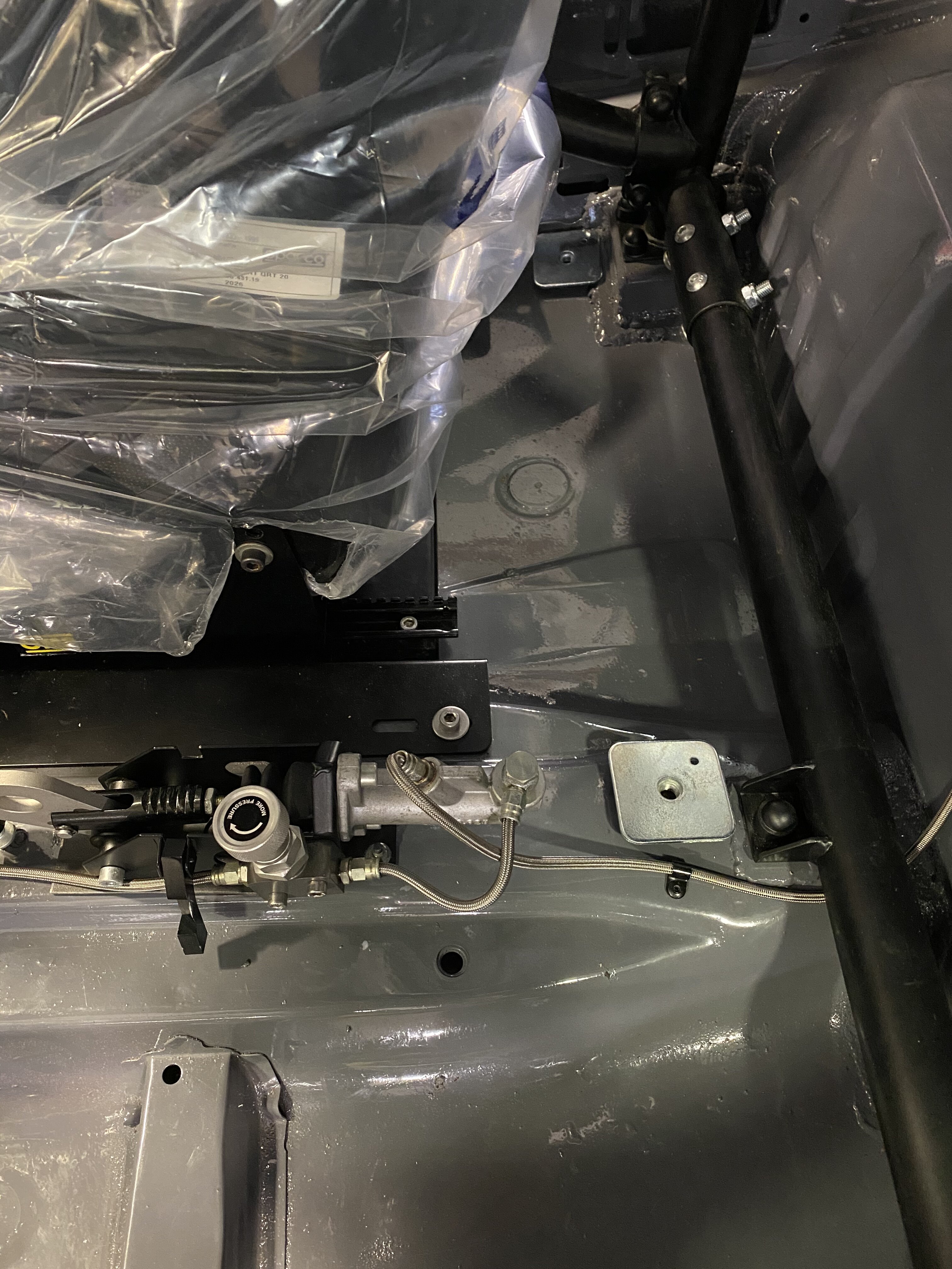

I was going to mount the side strap here, Ended up putting it behind though where that bolt holding the cage down is.
Im just not sure if its strictly allowed when racing, I don’t know if the harness have to come out the seat and straight back?
Bit hard to explain, I’ll try get a photo of what i mean tomorrow
