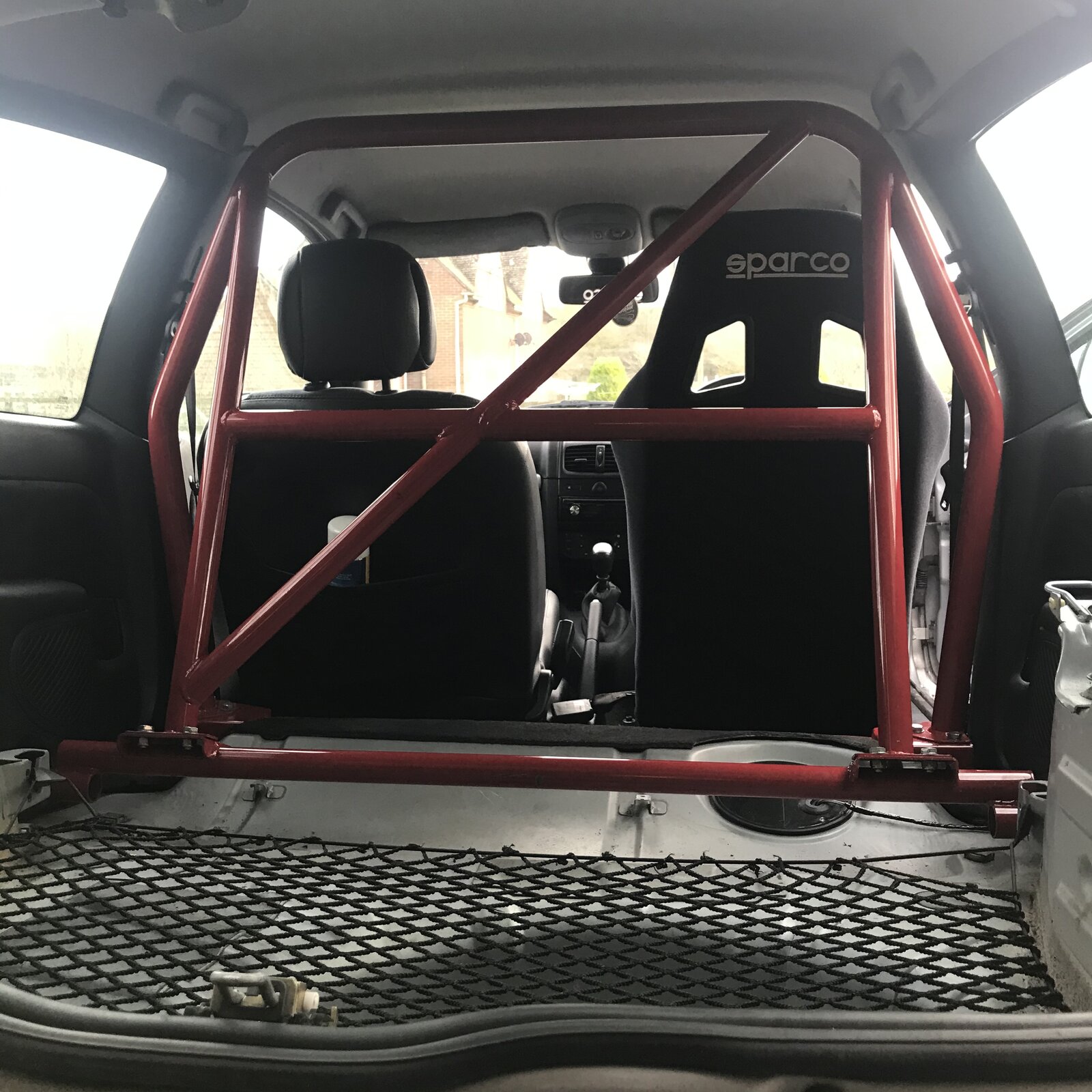

Hi guys, just looking for some advice, so I’ve got the caged/msv bolt in cage in my car (safety devices cage will happen later in year).
I’m just wondering if anyone has got any ideas on how to fit a lap belt of a harness (the one to the outside of the car sat in a seat) while having this cage fitted? As it uses the seat belt mounting point to bolt in.
If anyone has any ideas it would be great because at the moment I’m stuck for what I could do.
Cheers

Will be 6 point again this time round. If there’s no easy way to do it I’ll just wait until I get a proper cage later in the year, then I’ll be able to screw the eyelet in easily

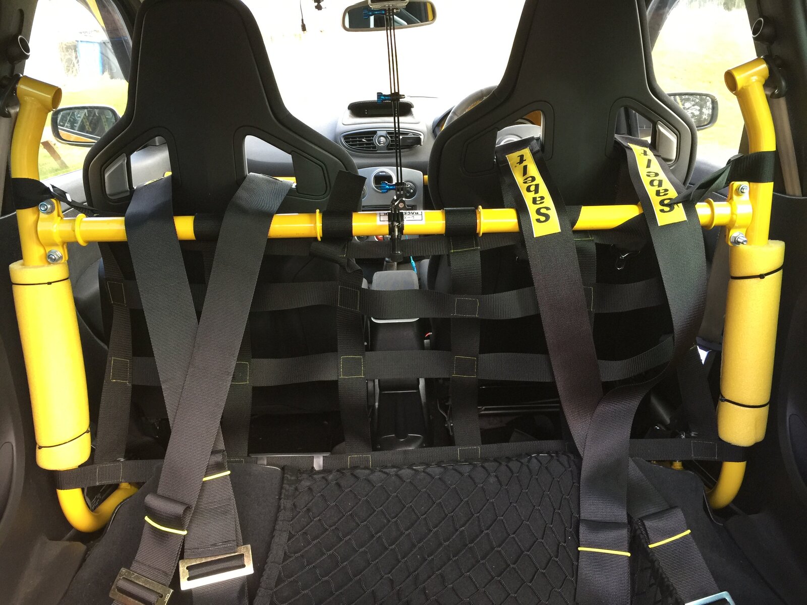

Oooh that maybe could work, hadn’t even thought that could be a thing, cheers
I used these with my MSV cage. I just sandwiched them inbetween the cage mounting bolts for the outer belts.
