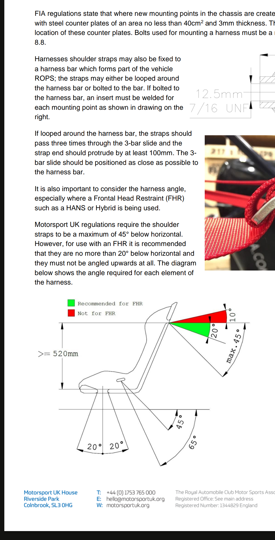

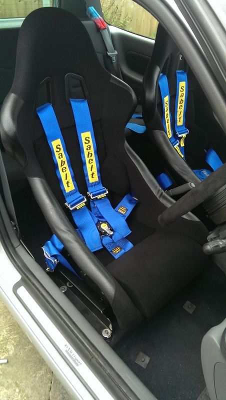

Depending on the height of the harness slots, the isofix bar mounting points in the boot should be ok, you'd have to check the angle.
Refer to MSA guidance for some good verified information.
