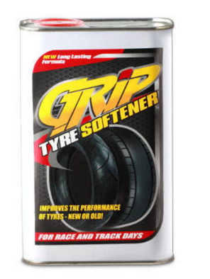

Thinking of getting some tyre softner for some 888's to see how they do as part worn....any one used it or can recommend a particular make?
You can make your tyres overheat easier by using it. I'd be careful using it on 888's if you plan to use them on track. I've used softened 888's on rallies, and they are pretty good, but wear too quickly for my liking.

it just softens the layer that has gone harder due to previous heat cycles so they are back on the money, or on new tyre just softens them a few points on the durometer but as you say it soon wears off.
Cellulose thinners painted onto the tread and cling wrapped for 24 hours works just as well and is far cheaper.
You can also use bleach for the same effect. Depending on the tread pattern it can have more or less effect. A semi slick has less surface area so the compound soaks in less. Tyre softener is a cheeky way to get more grip from the standard road tyres you have to use on autosolos, as it tends to work well with more tread.
