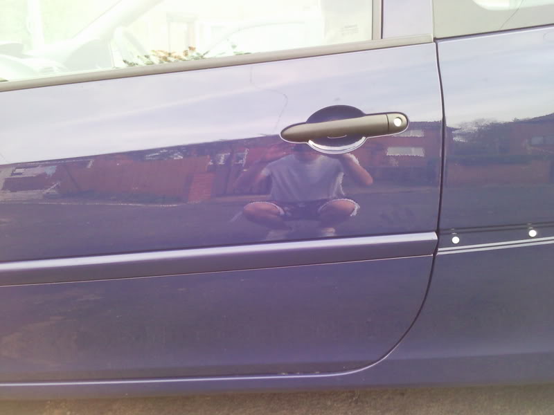

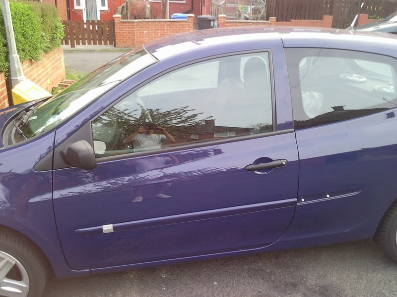

i got halfords to mix my paint, i have got pictures,
but i dont know how to post them on.

Never used photobucket but here we go!!
they need to be laquered, but i had to put them on the car because of the indicators.
Verdict??
Top pic the bump strips look a bit darker , the second pic doesn't look too bad .
Just what I was thinking. If they were laquered they might look a better match. They aren't that bad though.
