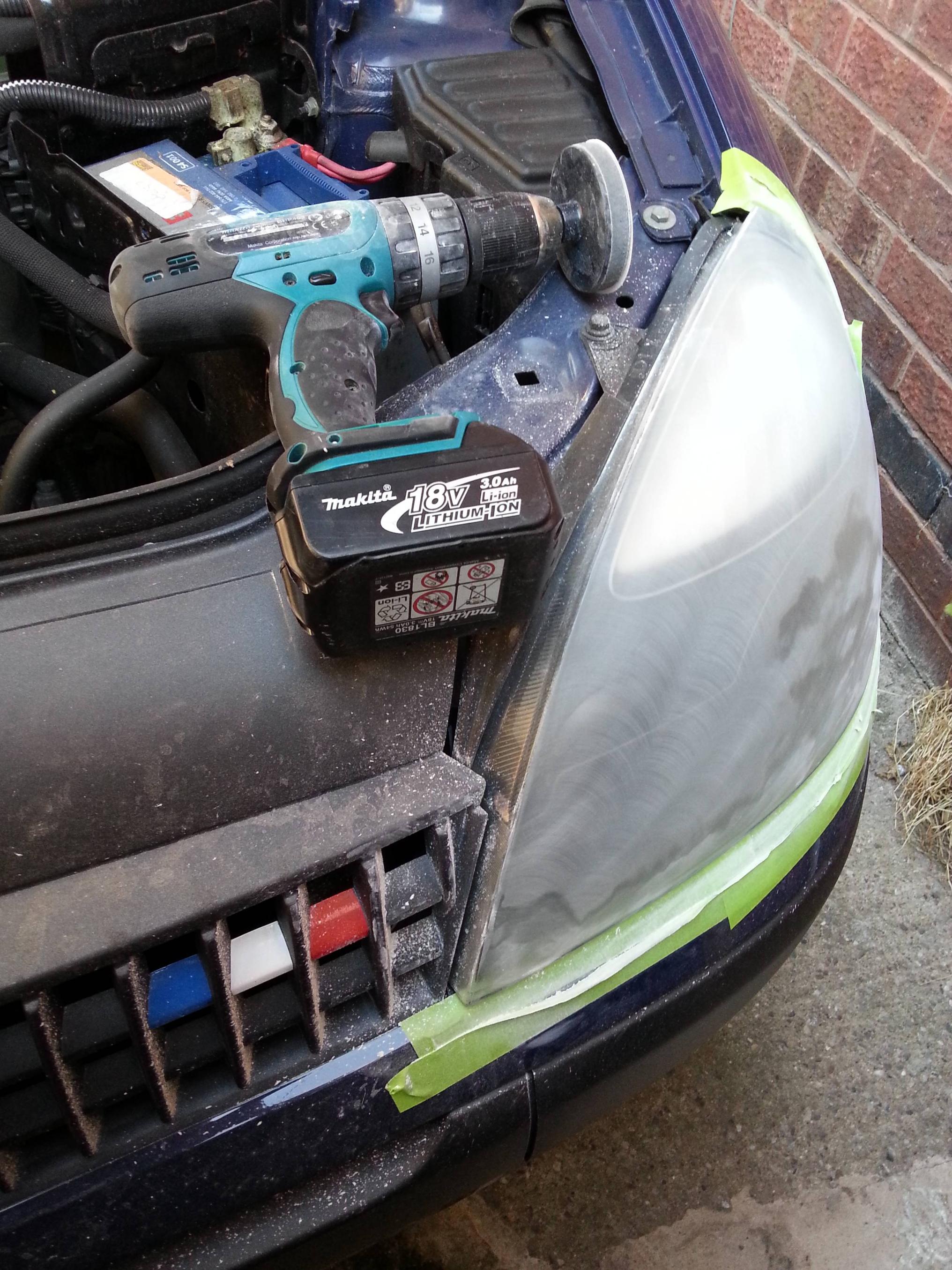

I used the 3m kit but my drill stopped working halfway through the 500 grit so I had to carry on by hand, luckily I had 2000 grit to make the final part easier. They look a mess when the 500 and 800 grit are done but they do come up well once finished.
