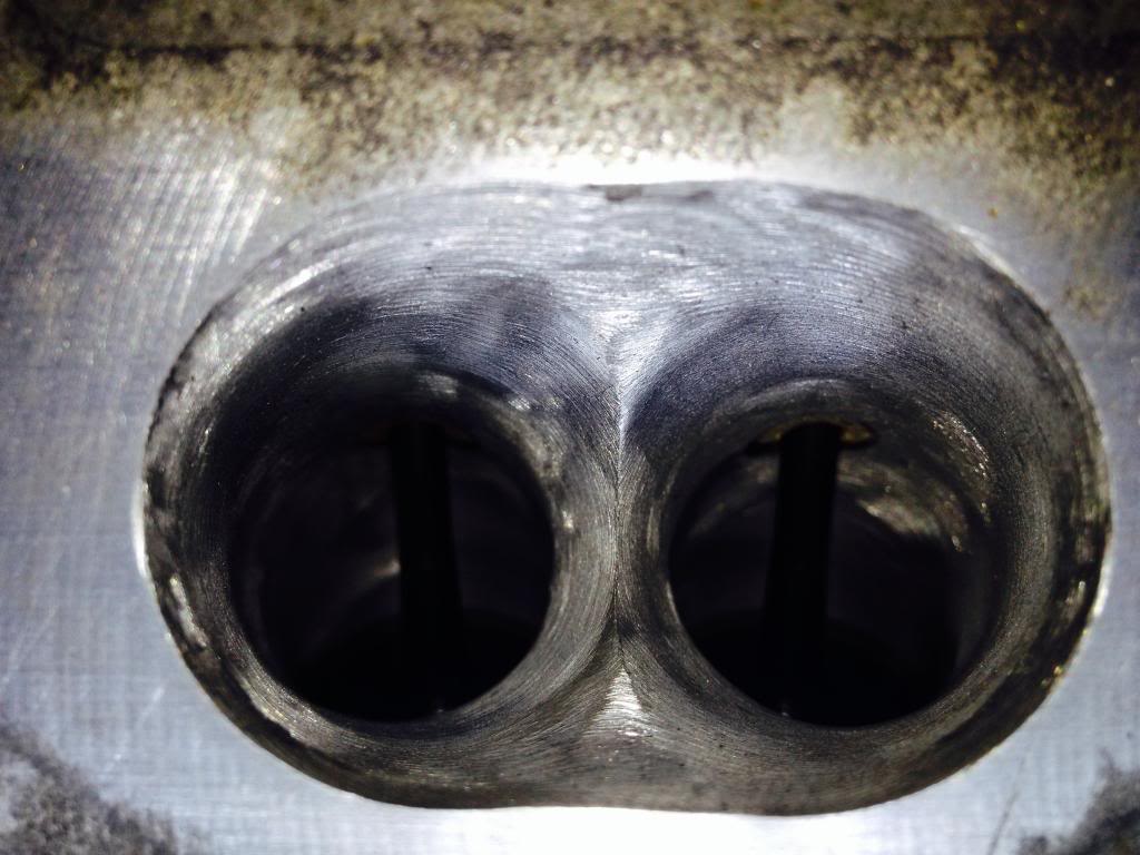

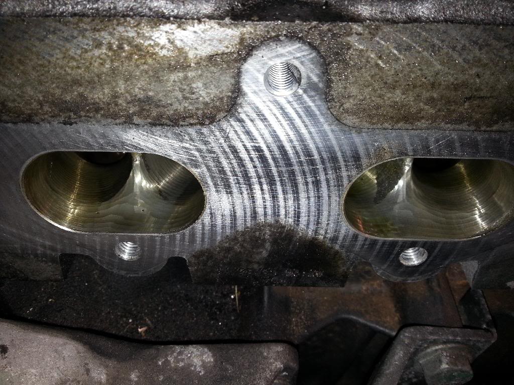

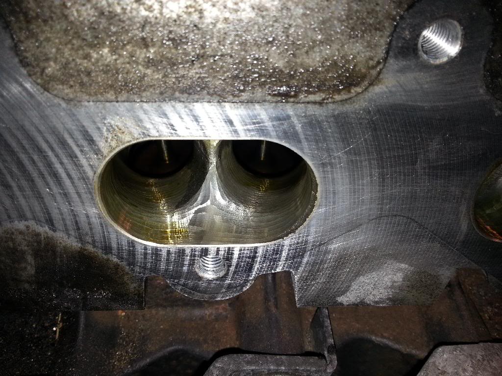

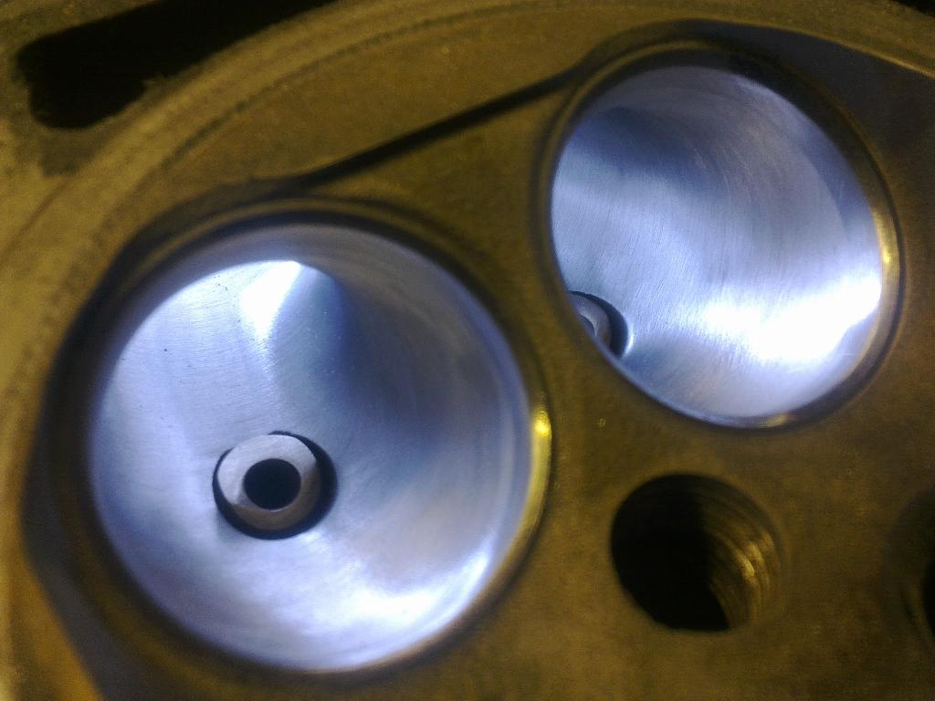

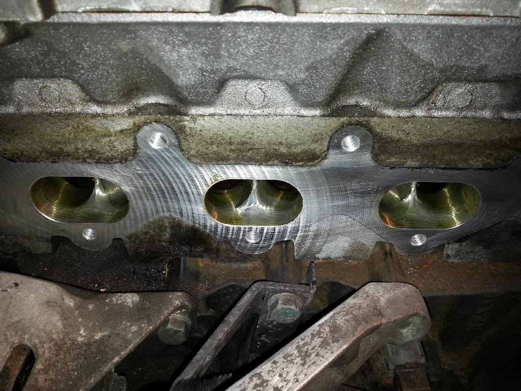

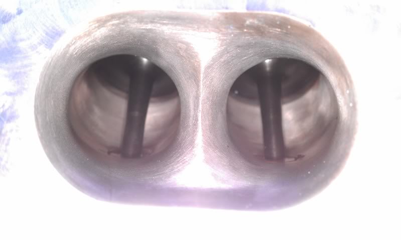

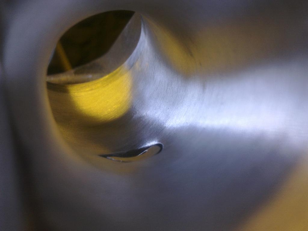

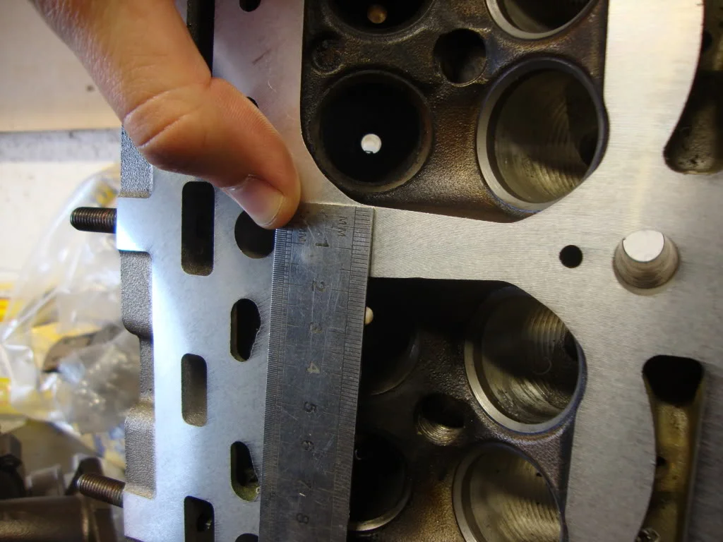

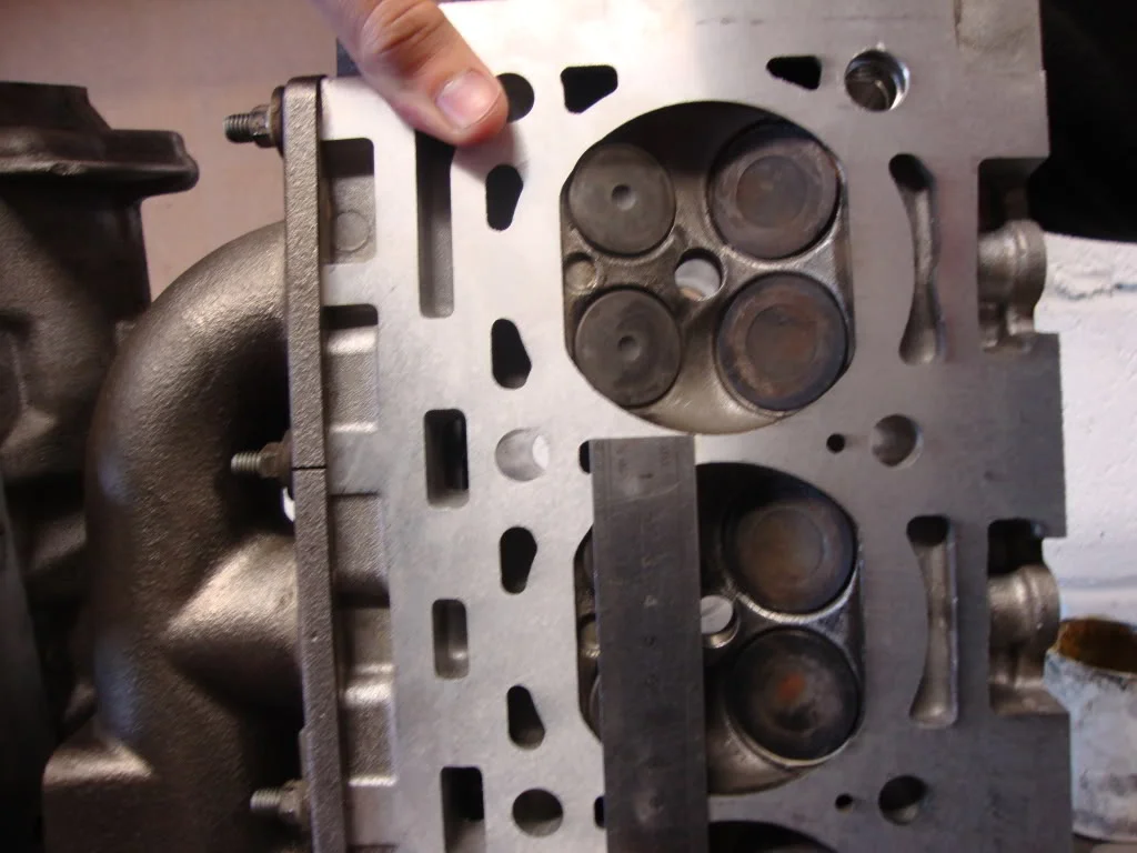

So today I fitted my matched inlets and after taking my lower one off it looks as if the head has had some work done. Has it had a port/polish or is this standard?
neil a
That is standard they are CNC finished at the factory, I thought the same when I first took mine off.

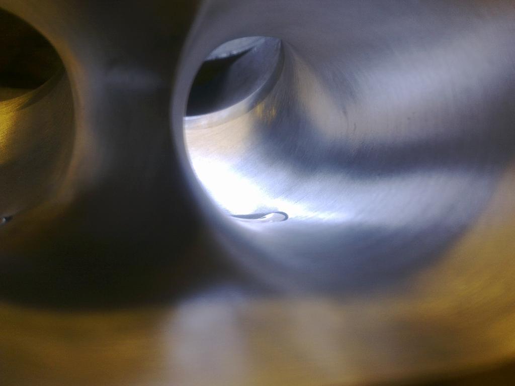

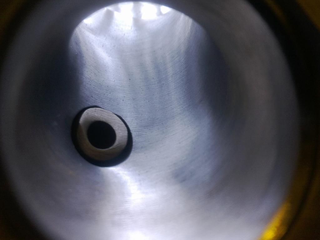

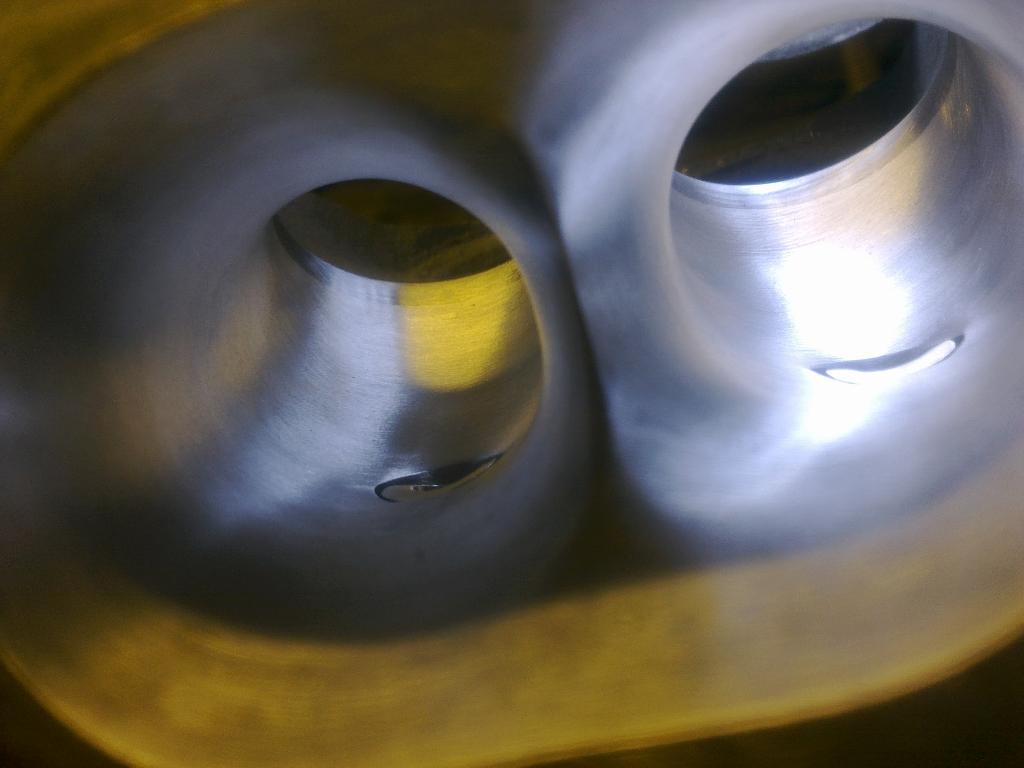

This is a ported head
  Inferno 182FF
Ha ha I've heard good things about him though! Thought I'd struck it lucky and had an engine with the head done. Was like "swweeeeeeet"!
  Inferno 182FF
Ha ha! Very true after seeing these pics! I'd not seen it done before so wasnt sure, know now though!

While were on this topic, some people say not to highly polish when porting and same say do?
Whats others opinions? The argument for not polishing is it creates a small turbulence and gives a better mixture/burn. The opposing is that the air flows better on the smoother walls?
Also when your doing the guides in the throat, do you debur/chamfer the guide or just polish down and knock off what's there with an old valve?
neil a
The guy that did my head left the inlet slightly ruffer than the exhaust, to help keep a little turbulence to help the mix.

I always finish of the ports with a 60 grit for the inlet and 80 grit for exhaust.
no polishing at all. No gains and no point.
All guides are de burred and cleaned up after.
