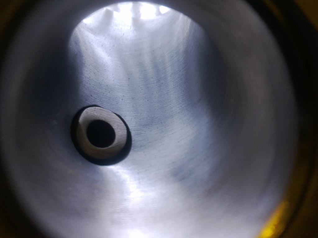

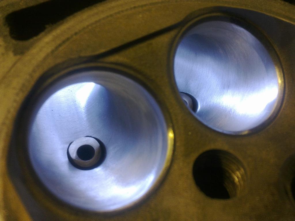

  Clio 172 cup
Some pictures of the inlet ports
Very nice head work! Where was this done???
Just done a Ph2 head and i can say that i much prefer these heads if you plan on modifying one, The Ph1 head will give good power but with a loss of torque, A Ph2 head has smaller exhaust ports and respond better to head work as the port size is smaller thus keeping gas speed up.
