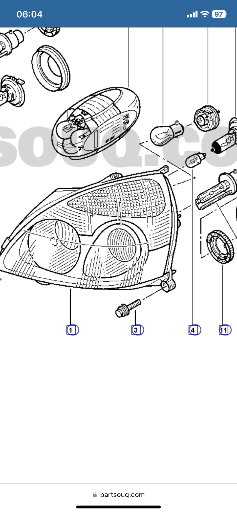

Anyone know off the top of their head what size the 6 bolts/screws that hold the headlights in on a 182 are? I want to order some online and I can't be bothered walking down 9 flights of stairs to take one out and check 😂

If you mean number 3 in this diagram, they’re an M6 flanged bolt. The last lot I bought where from Westfield fasteners. Flange Bolt Hex Head (Unserrated) M6 x 25mm in Bright Zinc 8.8. I think Halfords sell something similar.
