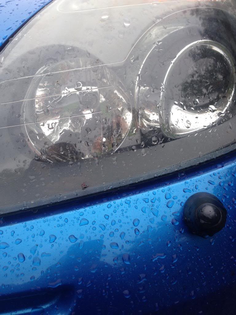

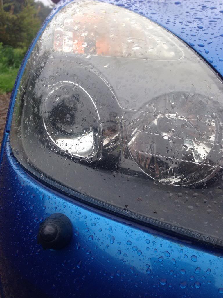

Hi there the lights and inside of passenger side headlight are loose and wobble about just wondering if anyone knows what the problem could be? Here a couple of pics to help explain the problem
first picture is drivers side and is fine(take note of actual headlight and where it sits height wise)
Now this is a picture of passenger side headlight thats the problem

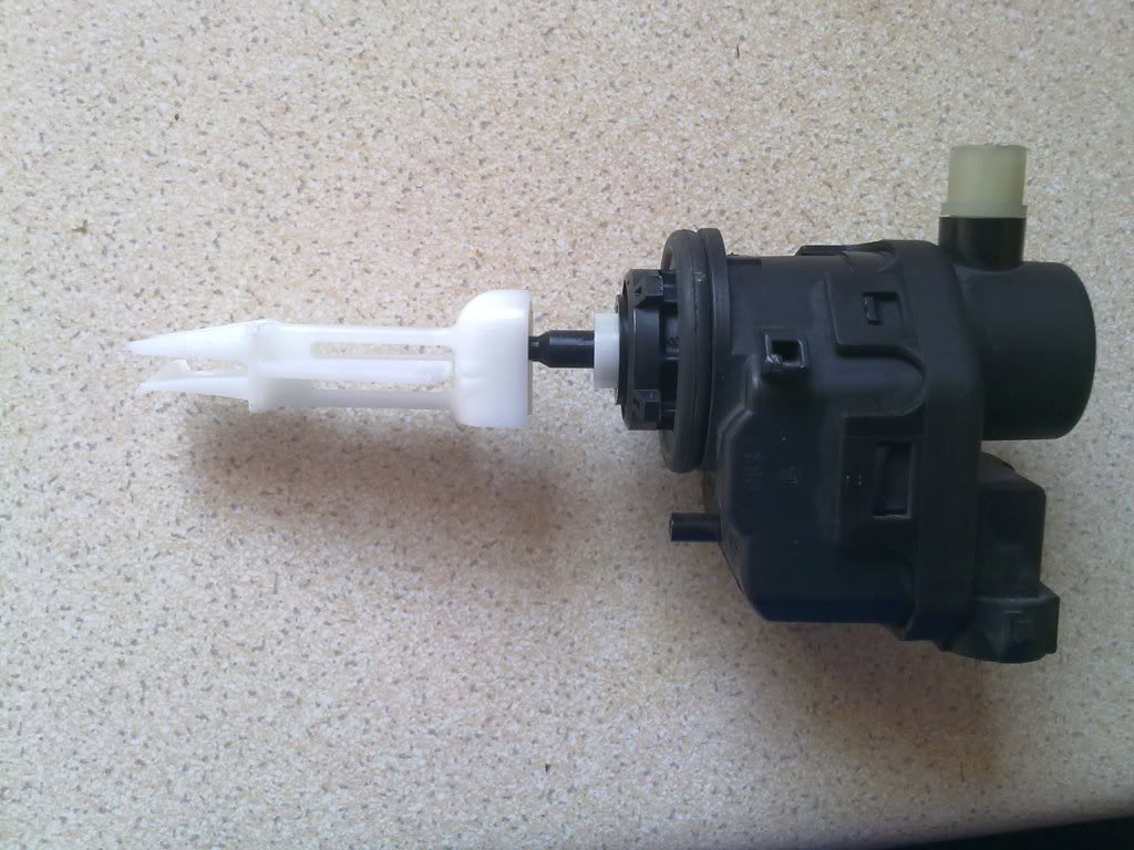

Is it this part you mean?

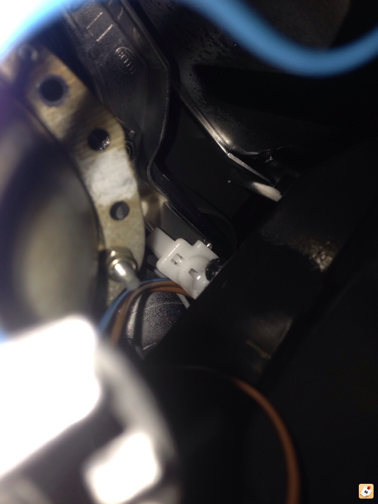

No not that part, but it's the same design its ment to push into the socket, it's directly above that centre motor
The picture I have just uploaded shows the white clip that needs to accommodate the black point just above the wires, anyone know how I can get them back togeather ? Thanks
