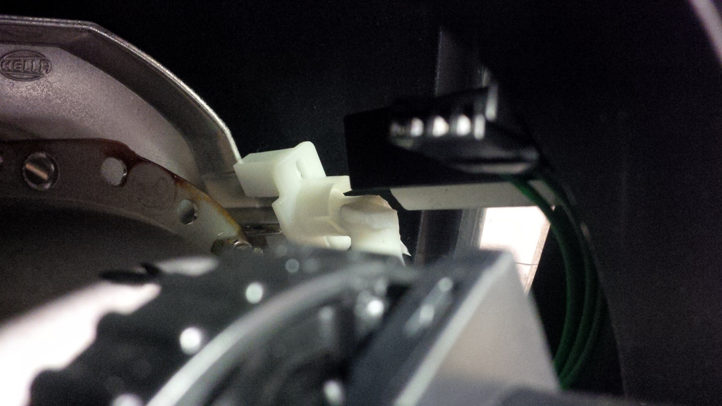

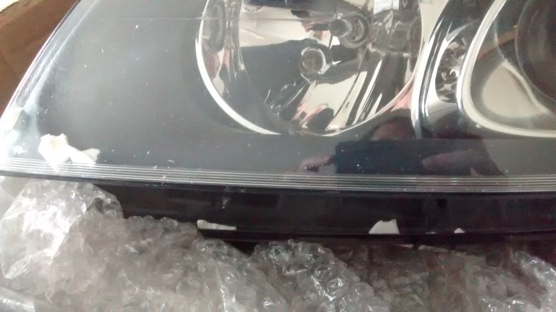

So, after inspecting my new xenon lights from a member on here, I have found out they're broken inside.
They was packaged really, really well so I'm not sure what the c***s at MyHermes have been doing with them, football maybe?
Before I get on to MyHermes about a refund I wanted to know if there is a way I can swap this from my old set to my new set?

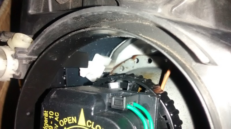

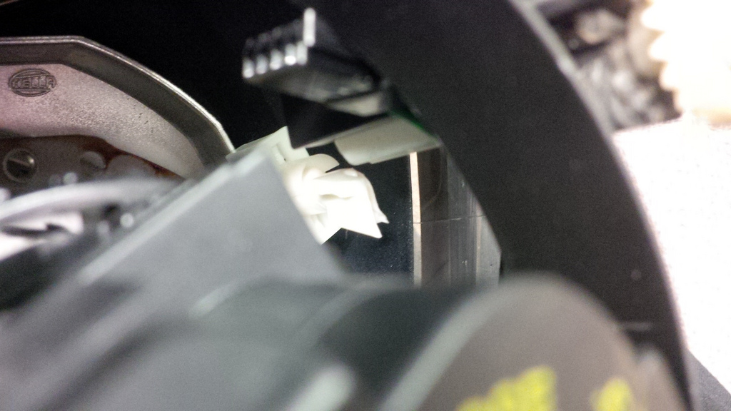

The bit that's snapped is for the manual adjustment, and it's happened on both headlights. Does anyone know how to remove it?

Could you strip them down and superglue it?
The other one is worse to the point where the hole plastic bar thing has shattered so I cant :(
Yeah that plastic ball socket thats pictured would need to be popped out with pliers and superglued back onto where it was originally mounted, if even possible, I glued a post inside my lights it was very tight and I had to use superglue in a hypodermic needle.
I actually fixed this. I cut open a non xenon headlight, removed the white plastic bit really f**king carefully, then really really really carefully fitted it to the xenon, its a proper proper proper pig.
Hardest bit is getting the white bit into the xenon, although that ball is in there bloody tight too, but I think I removed the holder from the light rather than the ball, but I might be wrong.
It is possible then, but just a lot of effort? Hmm, I'll just claim of myhermes!

The other light is worse, the whole white bar thingy is shattered!

I'm sure the couriers must throw them about as the white plastic seems really strong, they also snapped the top lug thing.
