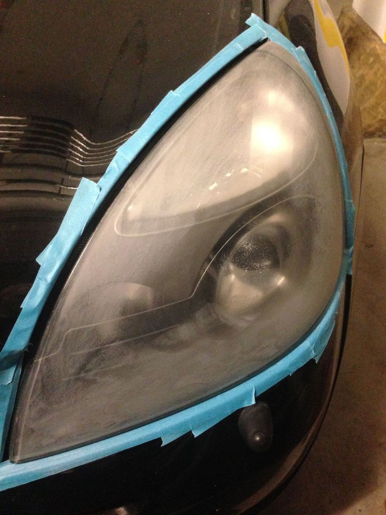

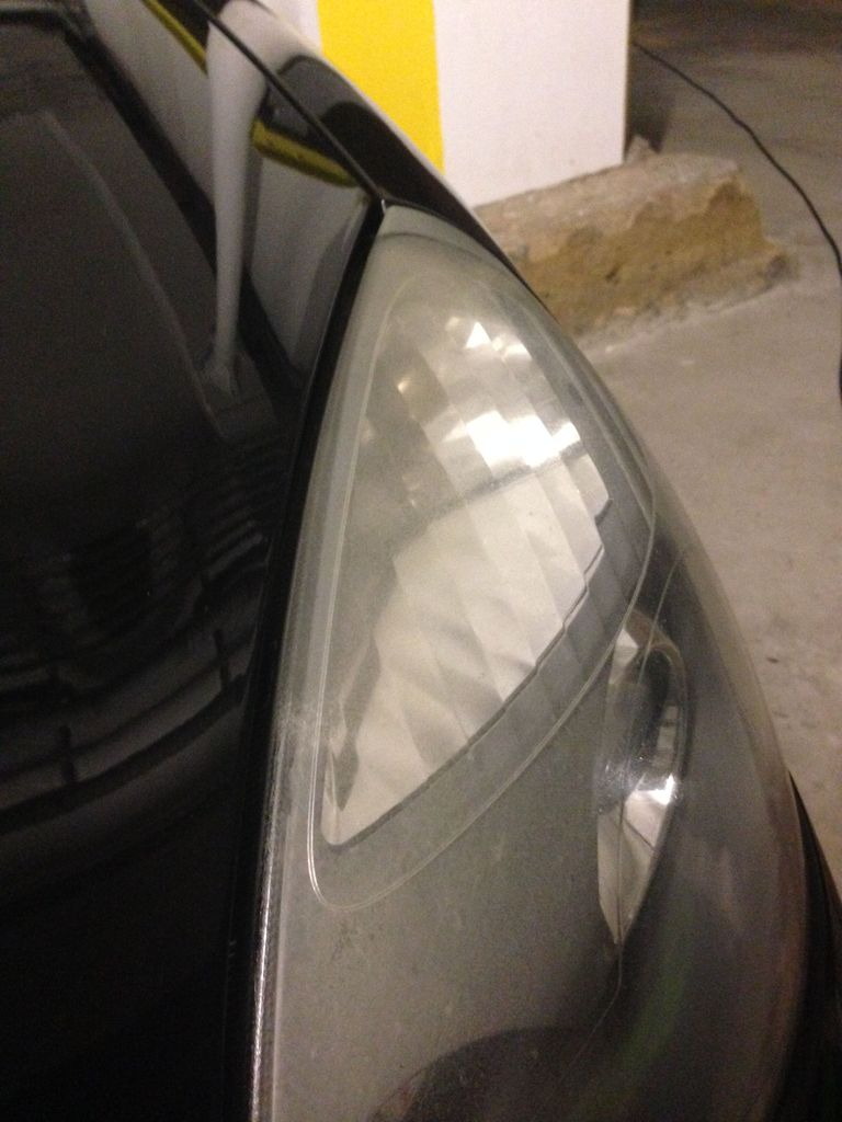

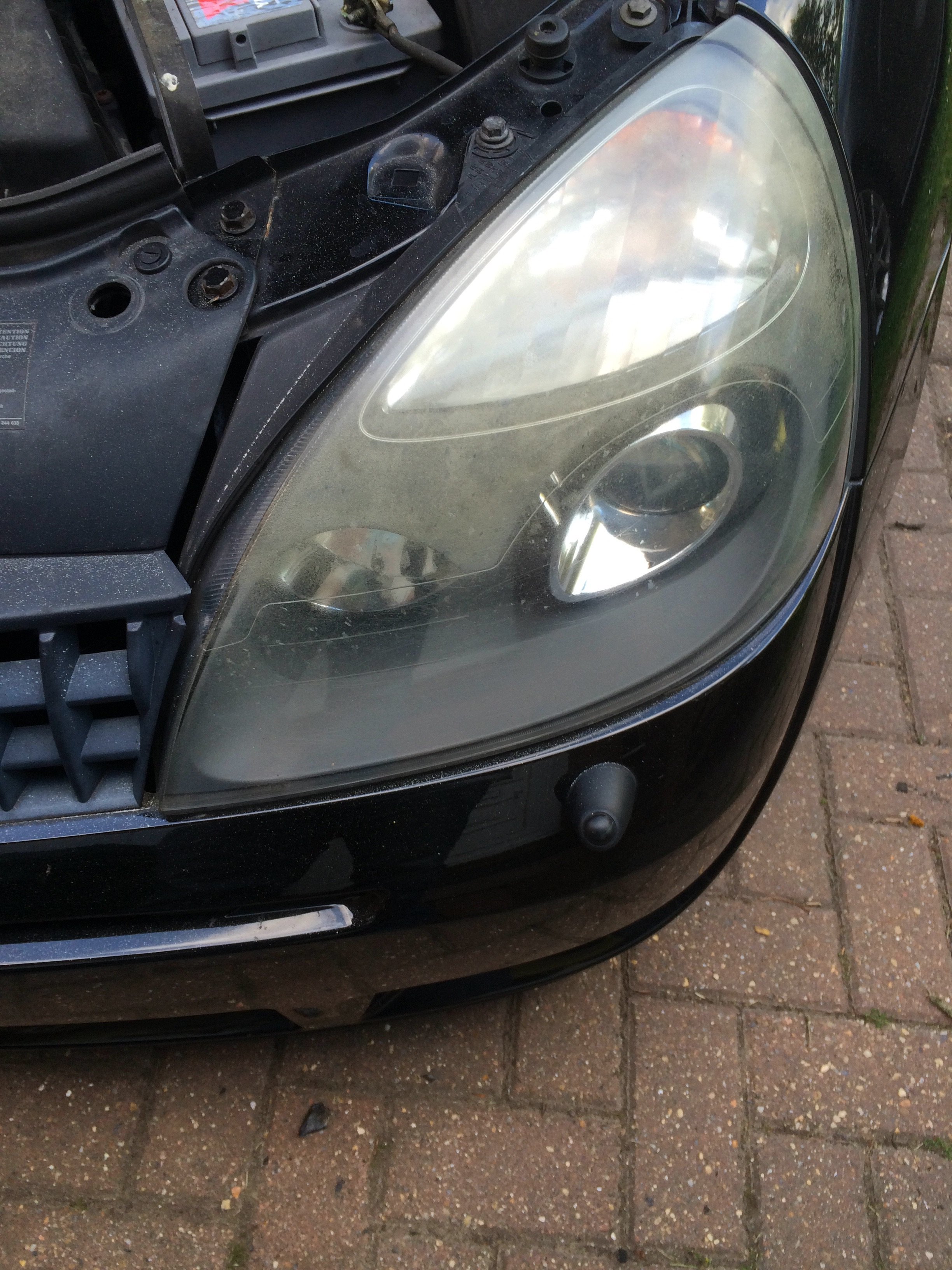

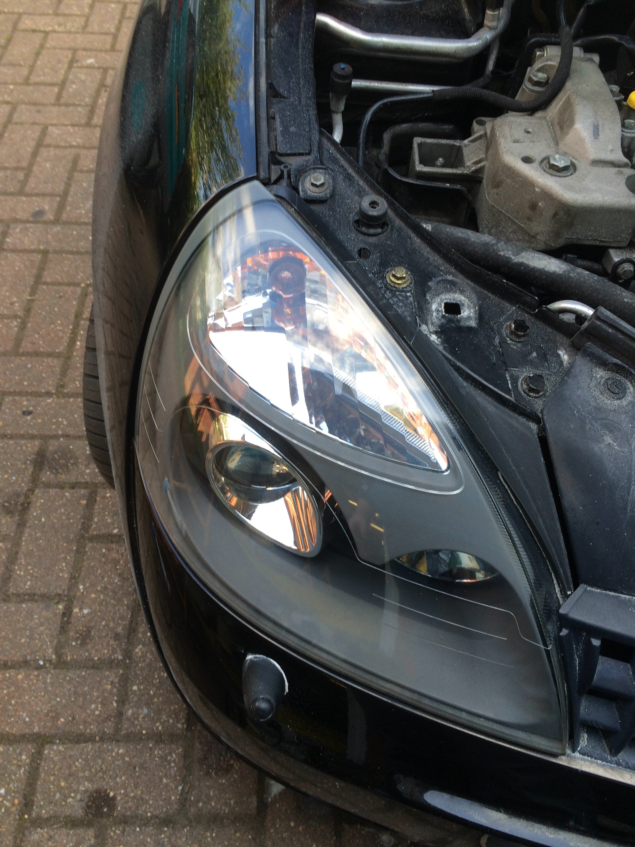

A couple of before shots:-

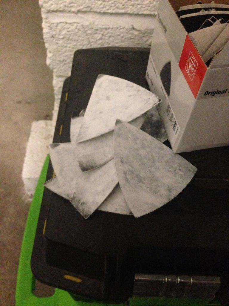

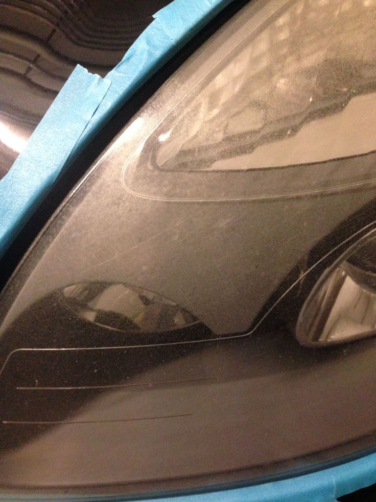

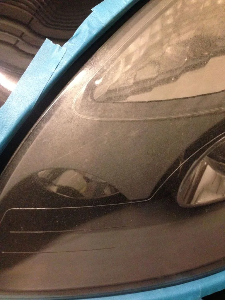

The pads were a MASSIVE improvement over the 3M drill attachment. Far more controllable as a device and very clear as to how much you'd done and how far you had to go. Dusting off the residue with a cloth, made it very easy to see how progress was being made...
All told, I probably went through about a dozen pads - good job I had the box of 50 after all... ;)

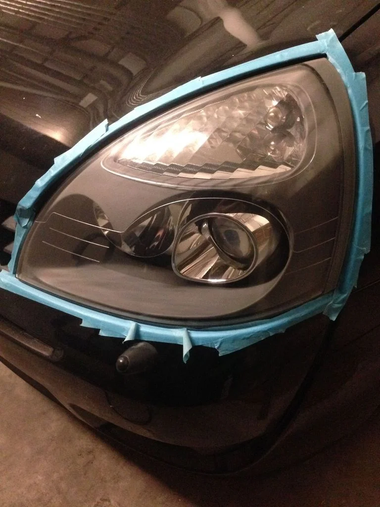

Once the more aggressive part of this was done - I did use the 3M applicator and the 3M rubbing compound, attached to my Sonus Porter Cable. That again, worked a treat and methodically, I went over and over the lenses, clearing up the surface that had been left by the sanding.

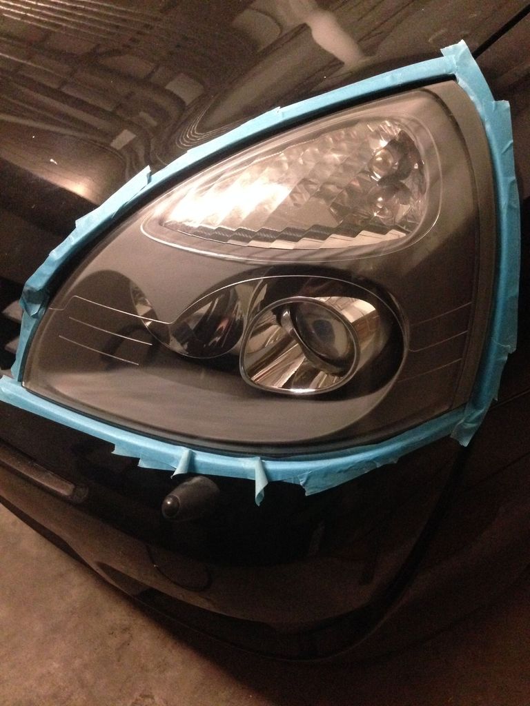

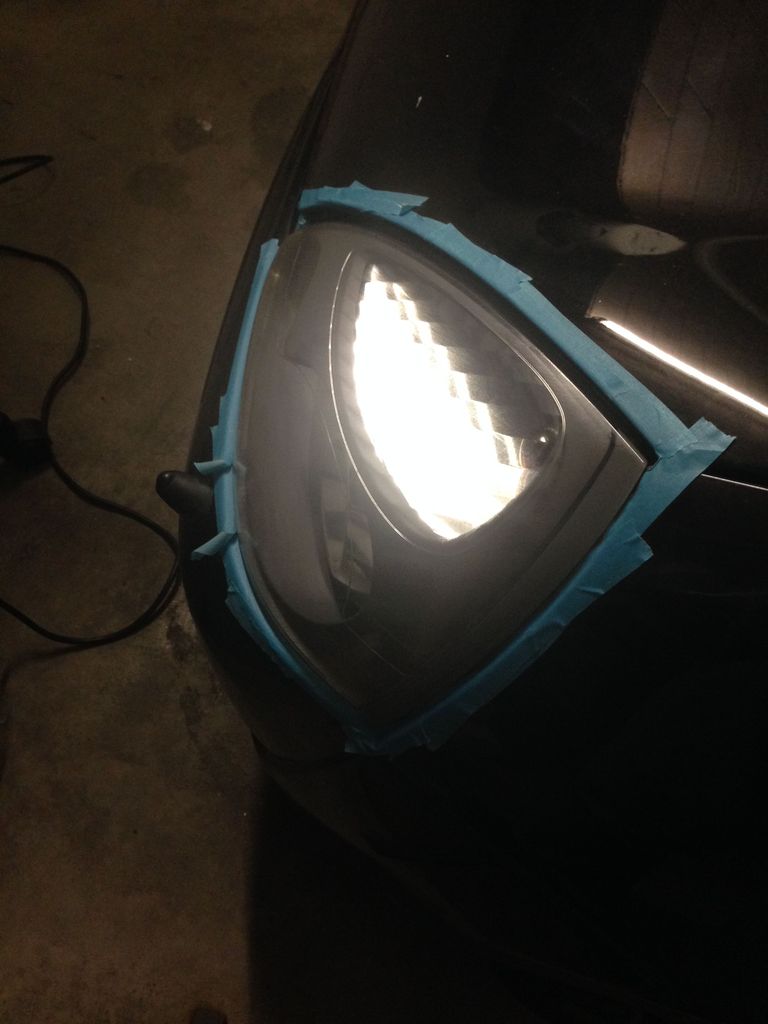

Once that was done - a fresh Sonus pad with little more than AutoGlym's Car Glass Polish was used to sweep over the lenses for several minutes. Once done and wiped clean with a cloth, I was very impressed with the results. Certainly not concours or showroom condition, but a huge improvement over previous - and more importantly, than with the 3M kit alone.
^^^ - a shame that the phone pic caught the reflection of the white wall at the top of the lens. It makes it look like nothing has been done!

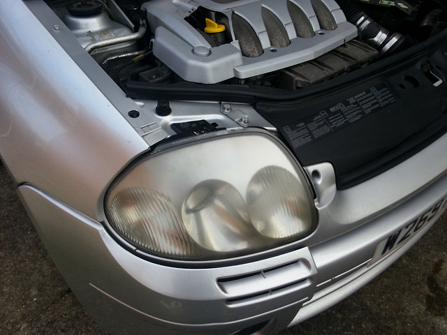

Before:

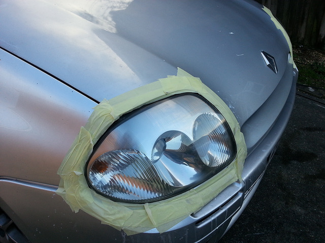

After:

^ they look much better!

Came out ok but should have gone a tad harsher on wet & dry i think,

I know what you're saying about a 'tad harsher'. The original 3M kit comes with 500 and 800 grit pads. I went straight in with the less course 800. When I redo them - I might get a slightly more abrasive pad before switching to the 800.
Your results do look very good too though.
