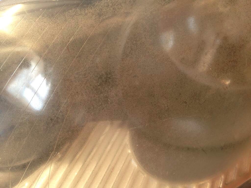

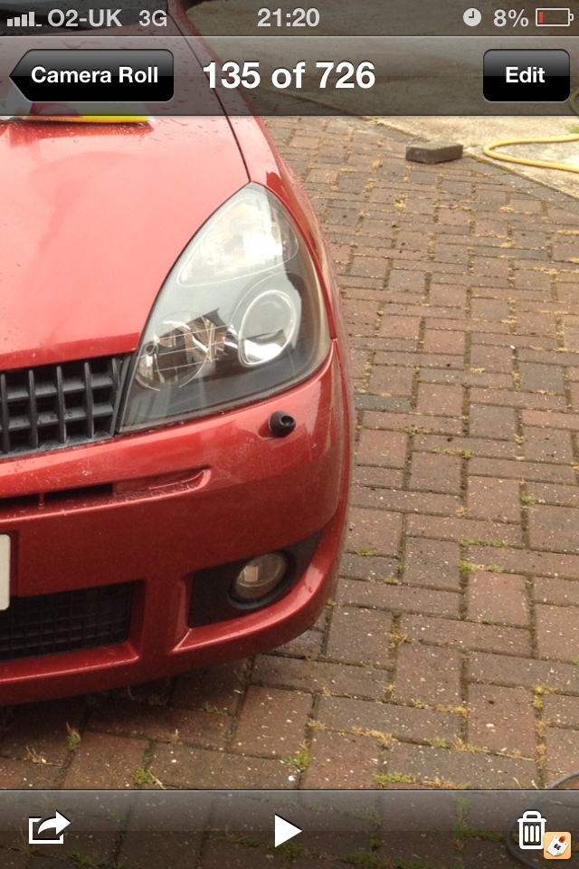

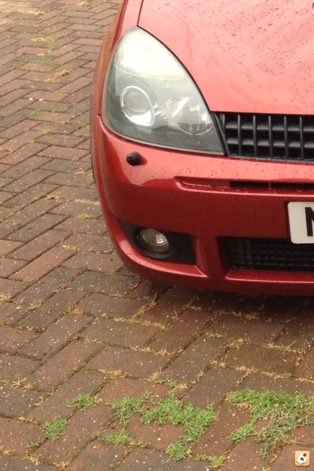

I purchased a Restoration kit from Halfords for £19.99 and to be honest I feel like it was the biggest waste of money I have ever spent. My headlights had what seemed to be oxidisation on them so I started by using the sponge drill adapter and attacked them with the cream the kit provided. However, after spending about 20 minutes with it, I noticed that it was little to no different from what I started with. I did not take any pictures before trying the kit but here are some images of what it's currently like.
I have read on this forum that 800 Grit Dry and Wet sand paper works a dream. But I don't want to try this unless it doesn't work and makes it worse, not to mention where I would get it..
Left
Right
Any idea where Im going horribly wrong?
Thanks,
FuSSionZ
You really need to flat them down.. Honestly using anything like 1500 will not touch them try 800 then work up to 1500.

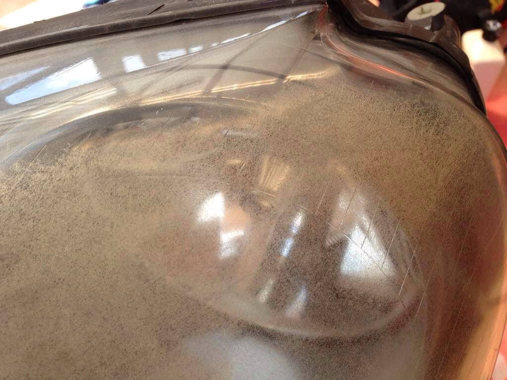

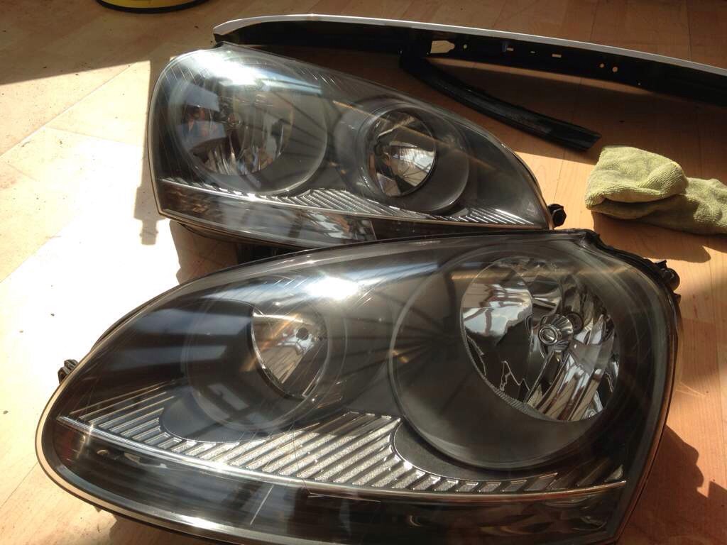

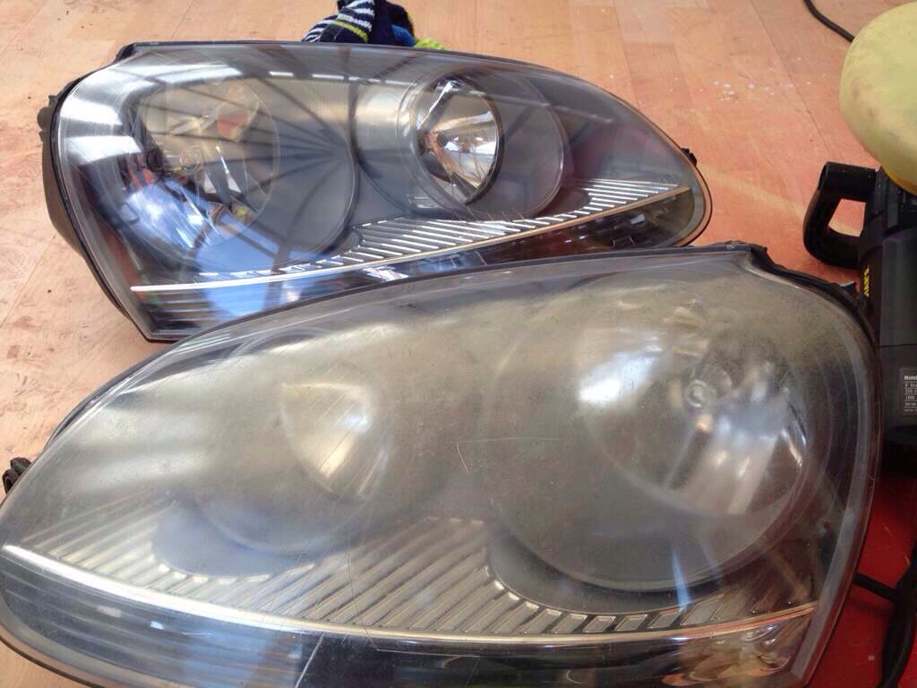

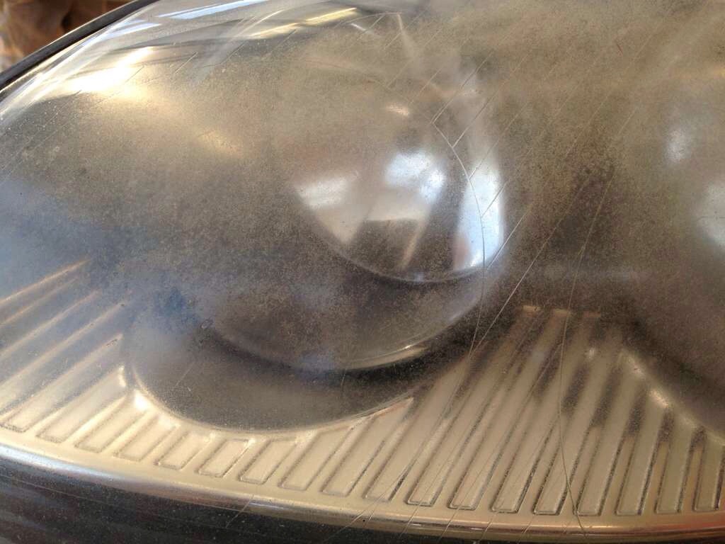

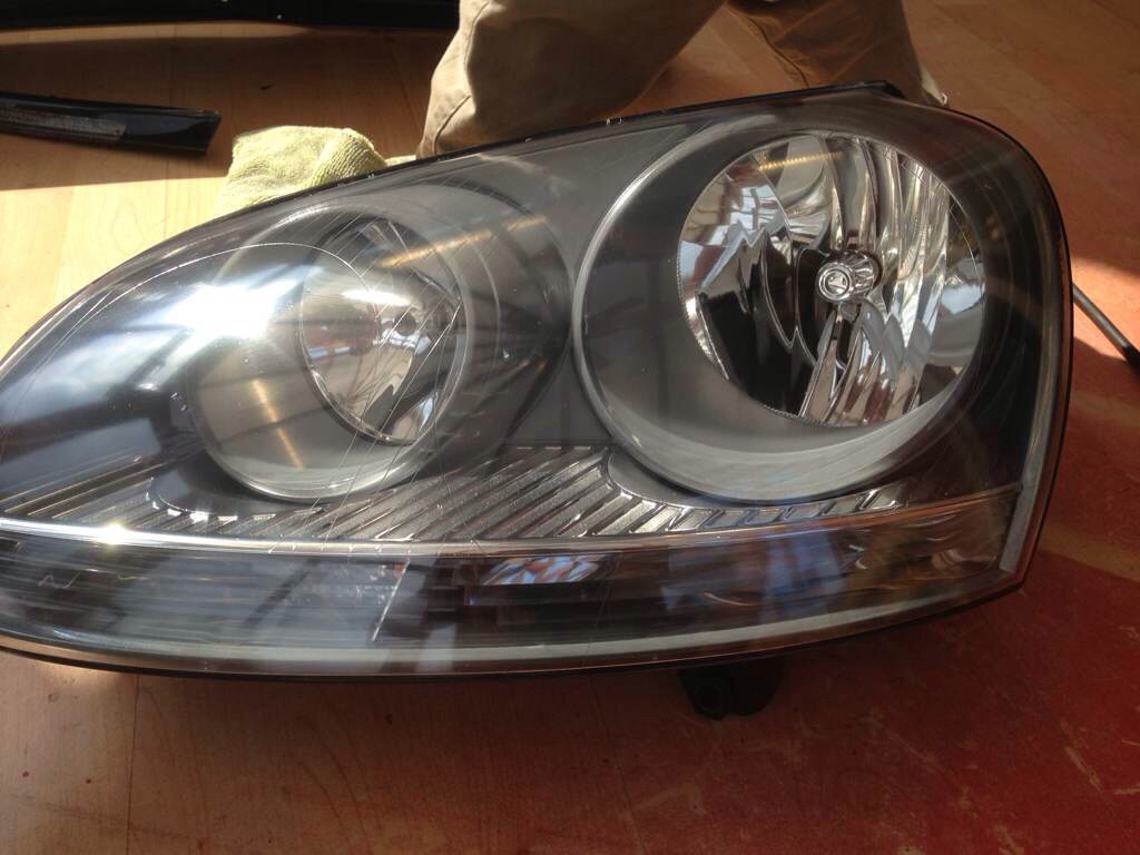

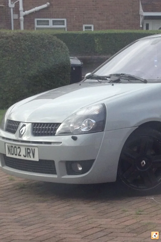

This is my work I did for my mate, done a lot of these now for family and friends and started with 800 grit, soapy water In spray bottle to keep spraying down and wiping to unveil what it was looking like.
So il keep using that process.
Used megs 83&82 ok cutting and polishing pads.
Wow that is defiantly the result that I am after!
Megs 83 & 82? Is that Polish then?
