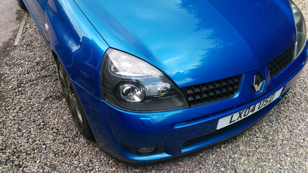

Would happily do it for you for free if you lived closer! Took me 30 mins the other day to do both
Infact just checked on the maps, you're not tooooooooooooooooooo far away! If you ever want to come down to leeds i'll do them to the standard below if you are getting worse than that. No worries at all.

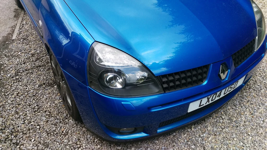

Took me 2 hours today but they do look good now though. Like you , they arent perfect which is a little annoying as you dont see the imperfections till the final polishing stage and by then there is no f**king way im starting the wet sanding again.
Went from 600 (only on a few chips) ->1200 -> 2000 ->2500 grit. All sanding with a hose trickling water on the the light.
