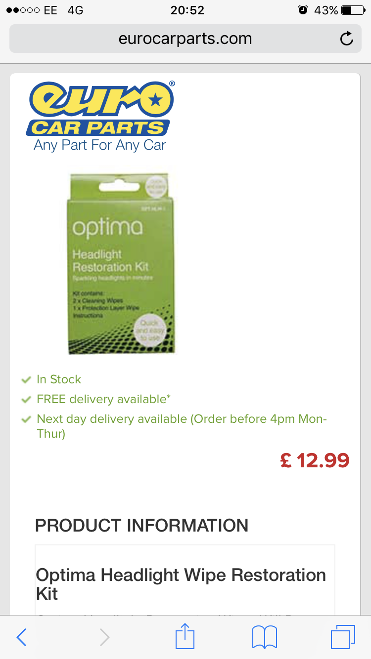

You used it?
  dan's cast offs.
nope, not convinced on the whole 'wipe' thing. might grab one to try on a scrap headlight one day.

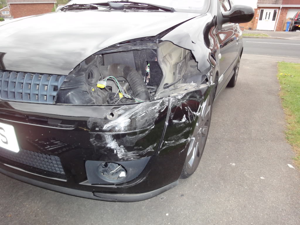

Flol!!! My thread got locked after that banter! Lol. Yea coz my headlights didn't really look brand spanking new, they had phantom irreparable damage apparently!!!? #whatatool !!!

Just don't get the Quixx kit that's designed to be used by hand. It's absolutely shite.
