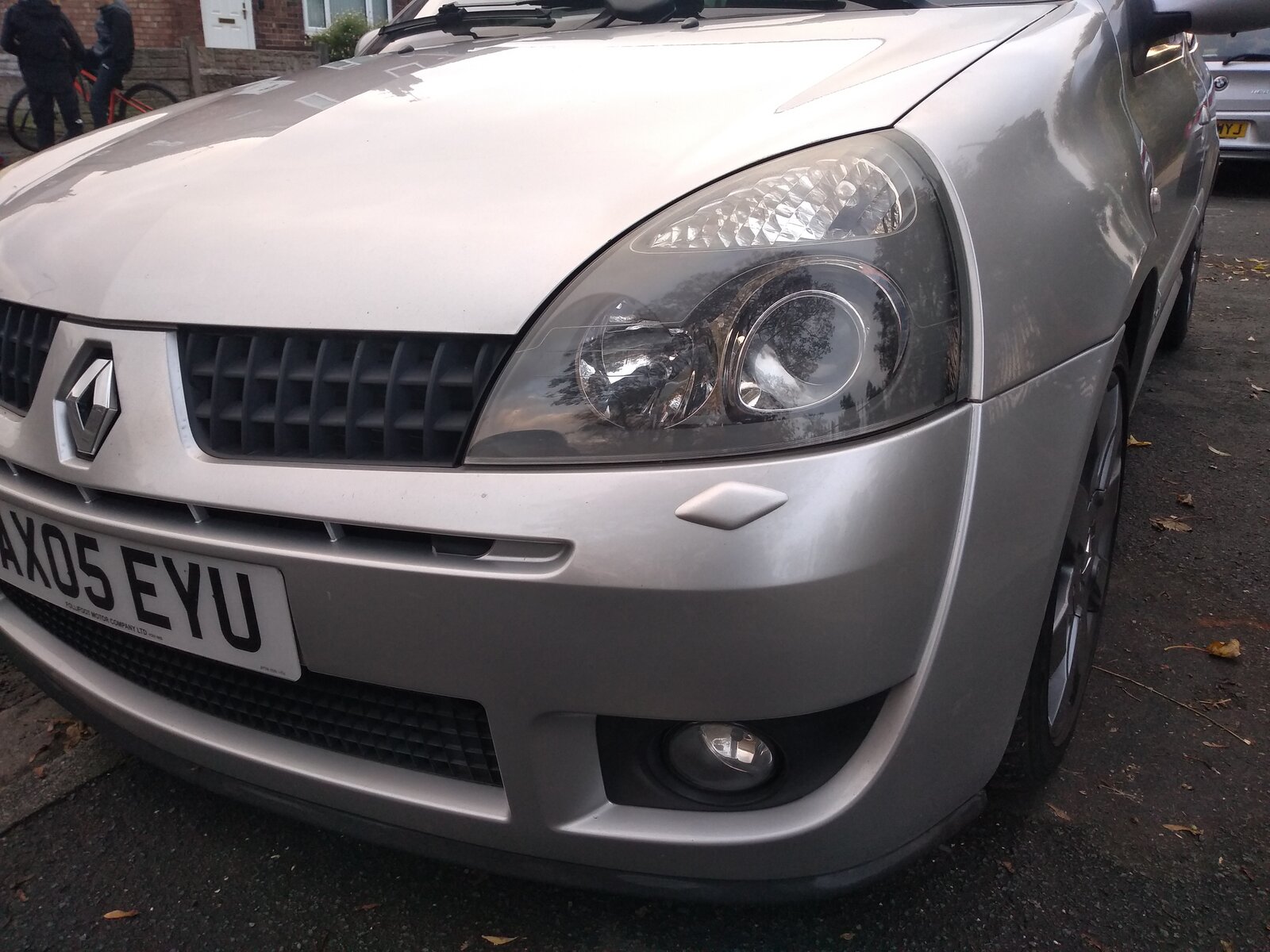

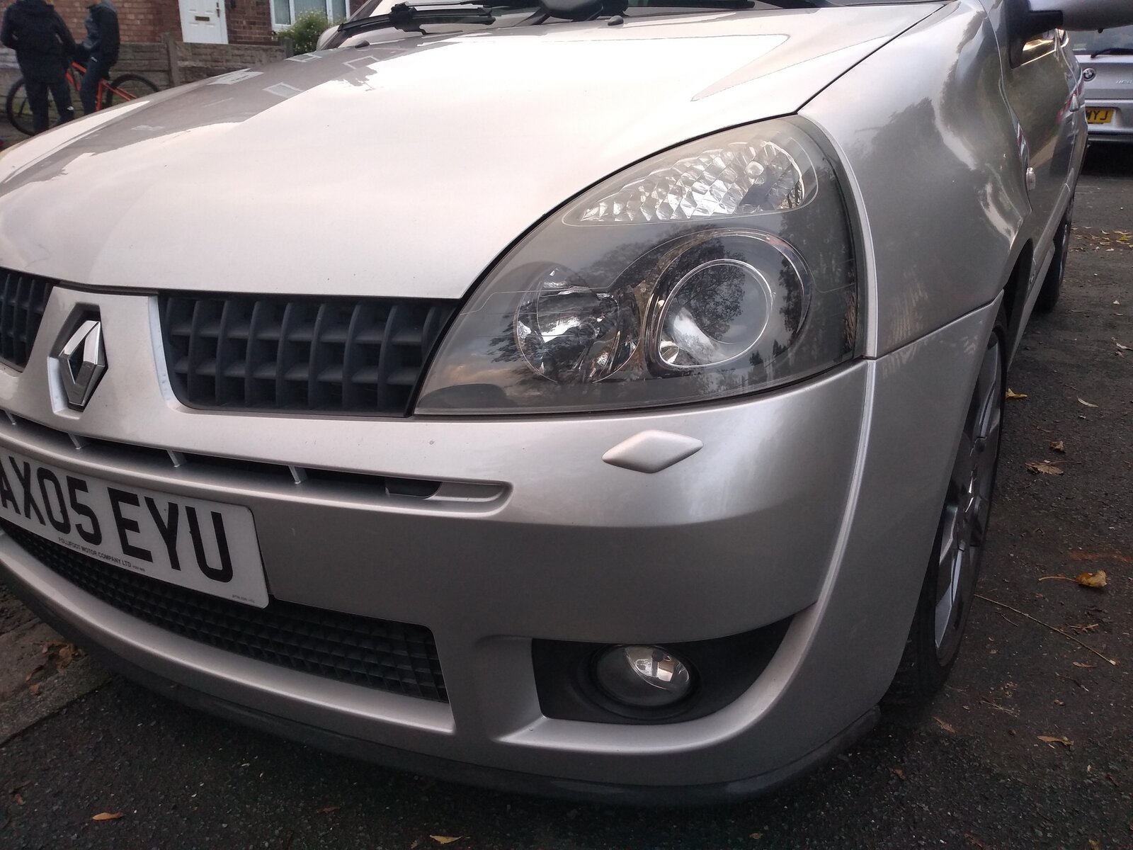

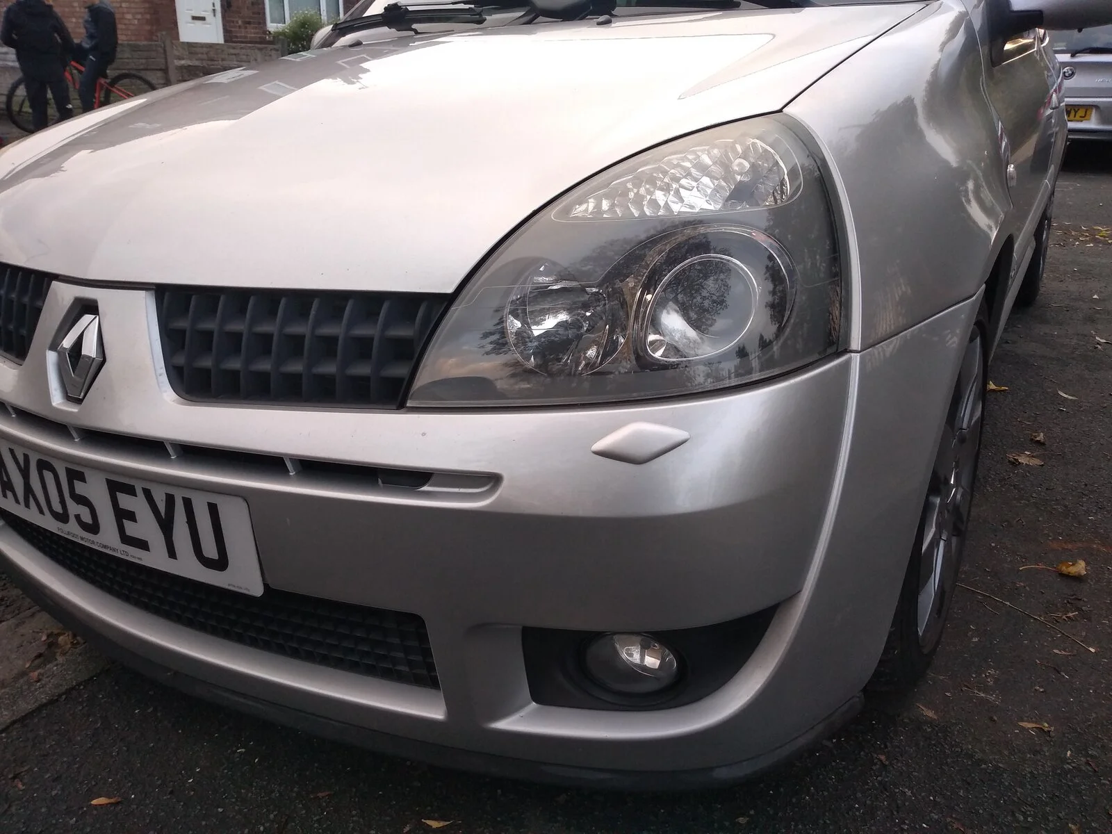

Am I making this up or did a recent revision to the MOT rules make NOT having headlight washers on Xenon lights a fail?
It's a fail for them to be non-functioning or missing where fitted as standard.
If you've got proper washer blanks just argue it's how it left the factory.
It's not like the tester will have a ton of 15+ year old French Hot-hatches through the door every day.
So am I now going to have to put standard headlamps on as well as refit the bus steering wheel for mot? Fml🙄
Another thing I've been thinking of doing is a smaller steering wheel, is that also a fail then?
It was mentioned a few weeks ago, something about standard safety equipment (airbag) not being fitted. Just need to refit the standard wheel, doesn't need the airbag connecting it just needs to be there and the dash lights to work as they should.
Headlight washers aren't a testable item on pre september 2009 cars, so you are fine.
it was part of the test when it got changed but then changed again so as above, pre 2009 not part of the test.
a lot of things when they are 'missing' can't fail test as they can't actually be tested so therefore can't actually fail.
