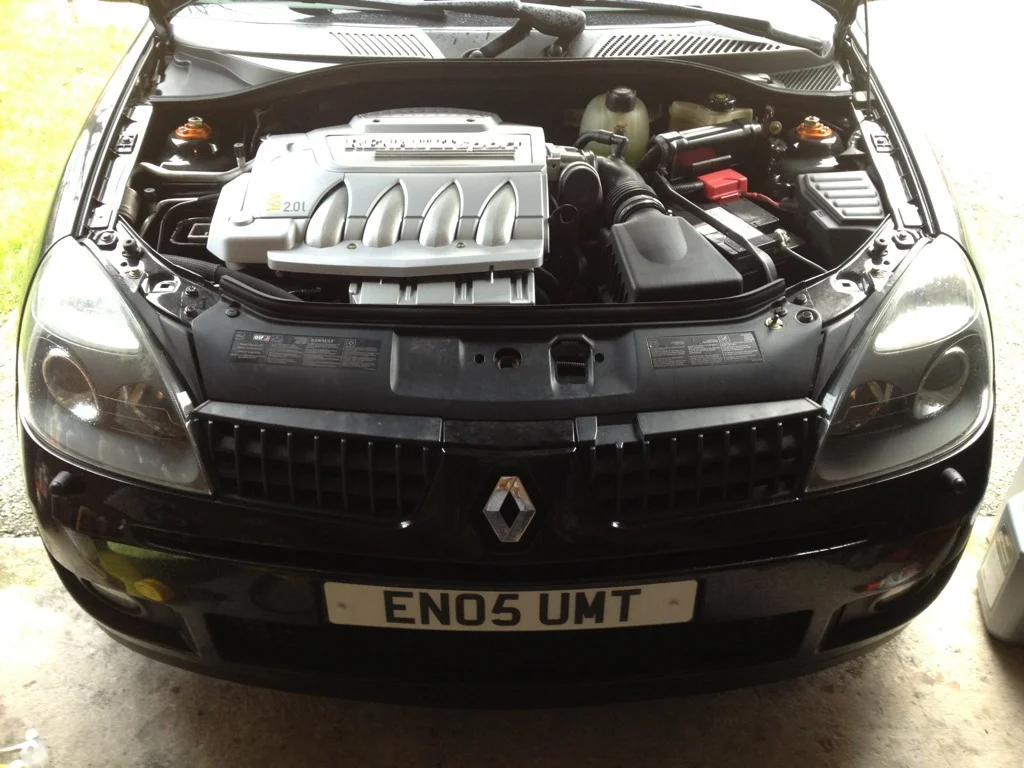

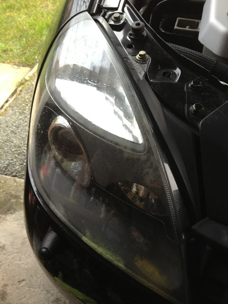

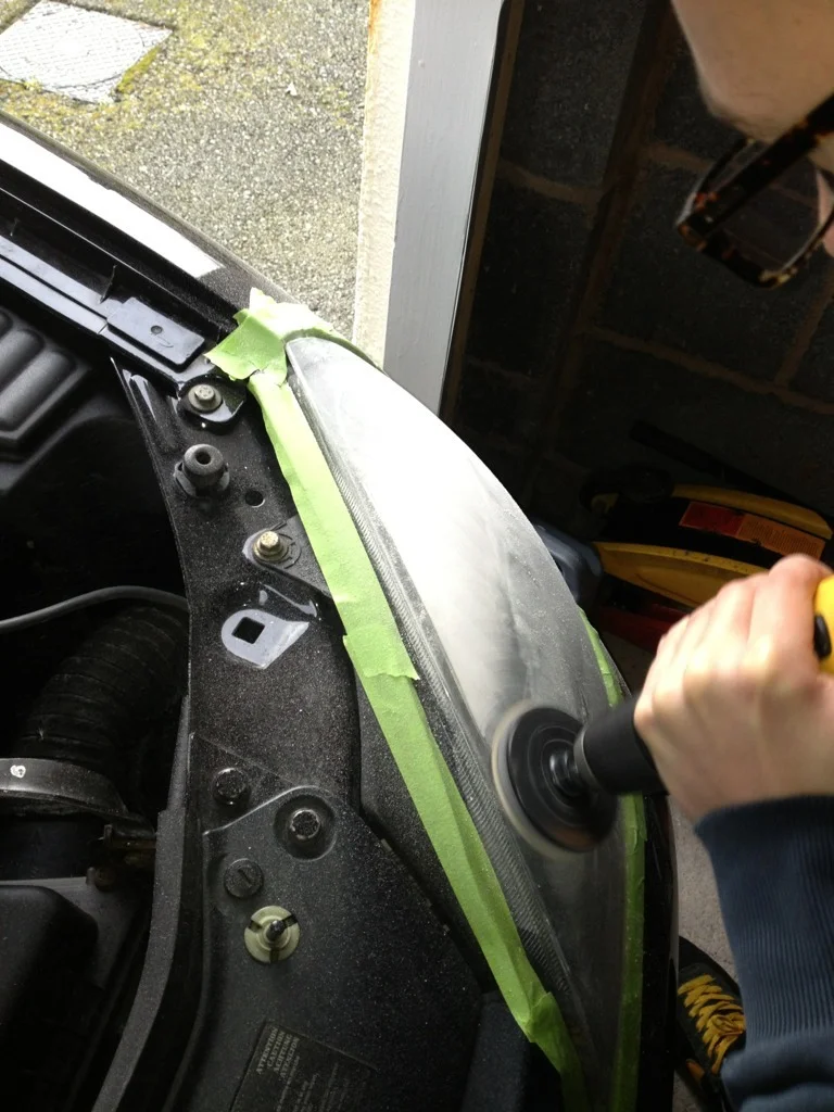

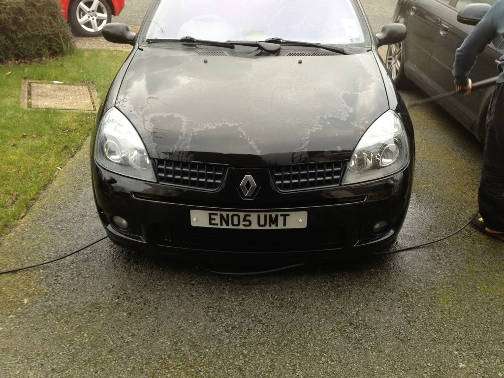

So today I thought I'd sort out my yellowey hazed and swirled headlights using the 3M kit off eBay.
Before: these pictures don't really seem to show how bad the dullness and yellow patches where for some reason but they where pretty grim in real life.

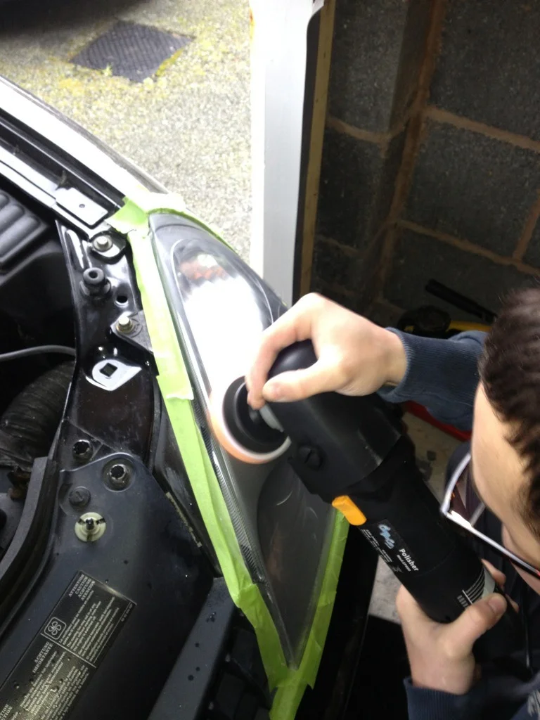

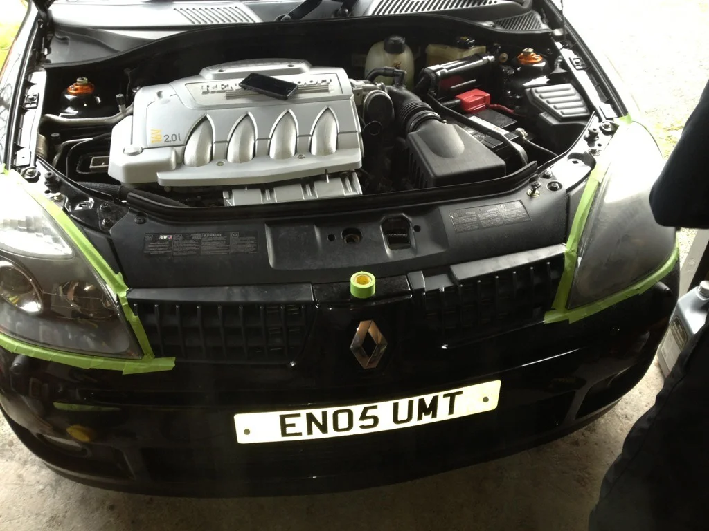

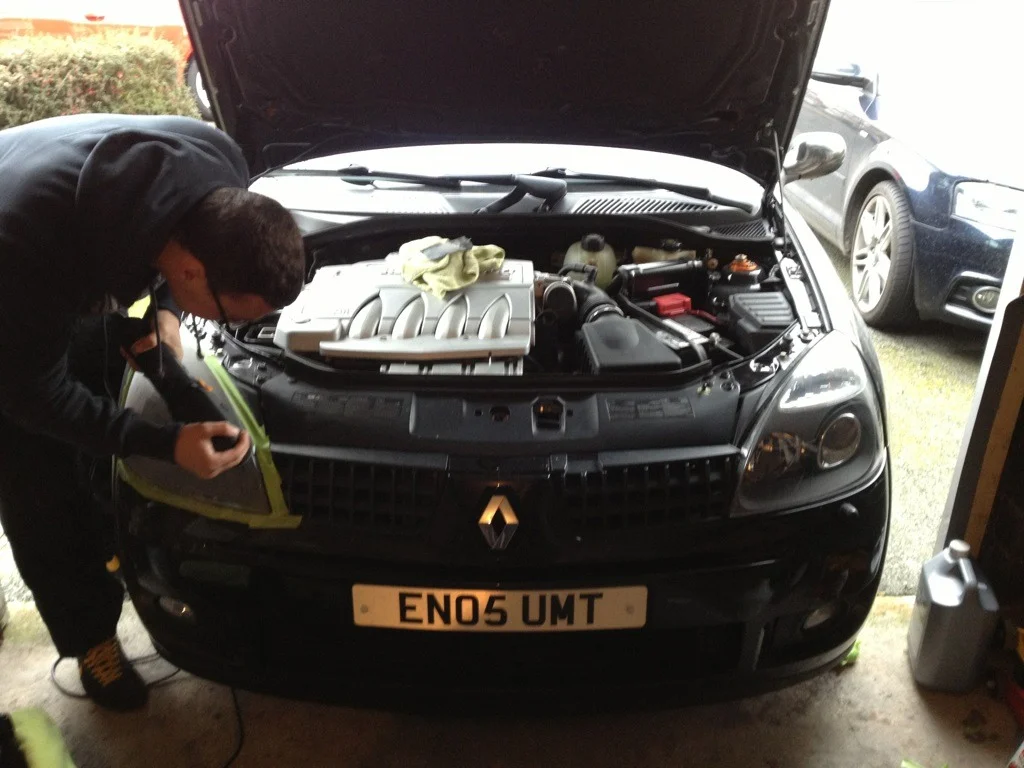

During:

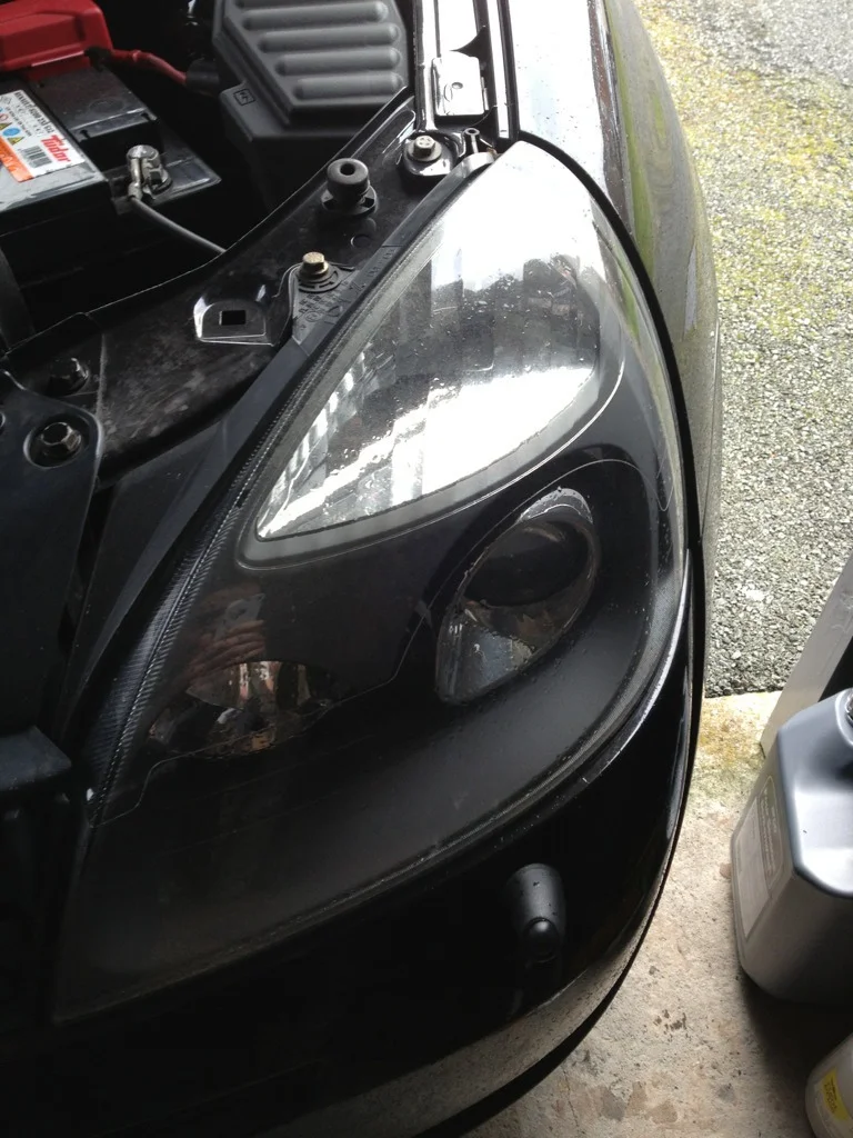

One done:
Result:
Iphone pictures don't do it much justice but they've come up a treat, like new. I would recommend the 3M kit to anyone.
Da as in a air driven body shop sander or Dual action polisher. Yes it can be done.
Forgot to add lol, that kit works wonders, paintwork looks nice and glossy to!
Yeah, can be done, small backing plate suitable for the sanding disks
Never ventured into DA polishers so I don't know exactly what's needed.
Unless you mean, use the 3M kit and then polish back up with the DA, which in that case , you'll be fine :)
i used a Da sander to do mine started off at 800 grit then upto 1000 then 1200 then 2000 then machine polished them they look mint
Did mine using this kit and a 18v black and decker cordless drill, awesome results!
well impressed
