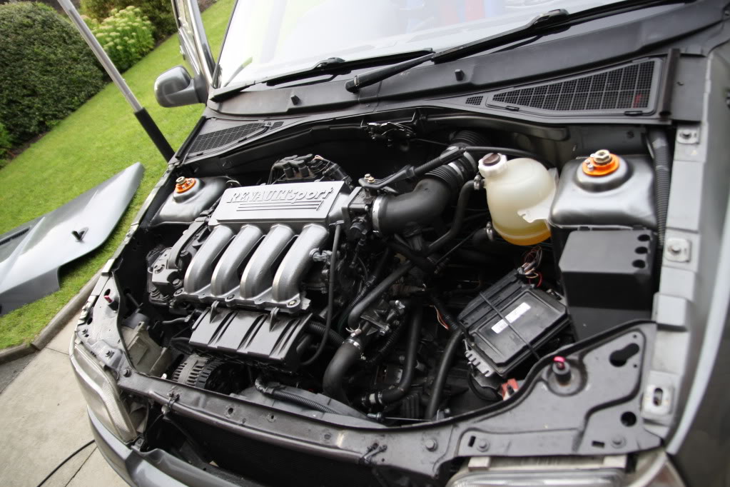

can just about see it under the thermostat housing, along the top of the box and down the front of the block...
but yeh, join them together if you dont want it to piss out everywhere so it creates a loop
