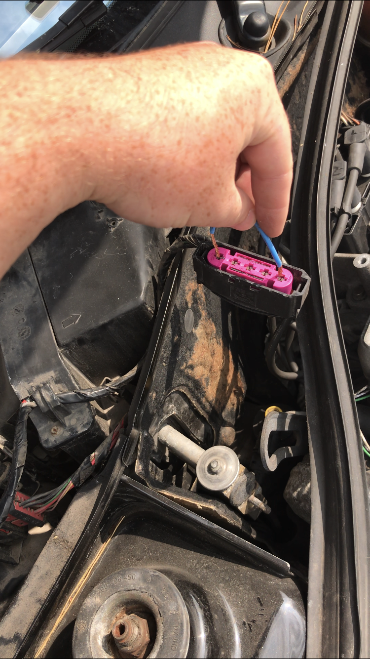

Owned it for a few months and out of the blue the heaters and blowers stopped working. Thought it was the resistor so bought one on eBay swapped and nothing changed so thought it was a duff unit. Bought a guaranteed working one and again didn’t solve the issue.
Shorting the 1st + 5th terminal on the plus causes them to come on full blast so don’t think the blower is dead.

As I’ve read bridging the first and last pin puts the blower on full power so just lost as where the issue is
Not much use I know but if the blower definatly works when bridging the pins and the resistor pack is known working then I can only assume it's not getting a signal from the heater control panel.
Either due to a faulty panel or a broken wire between it and the resistor.

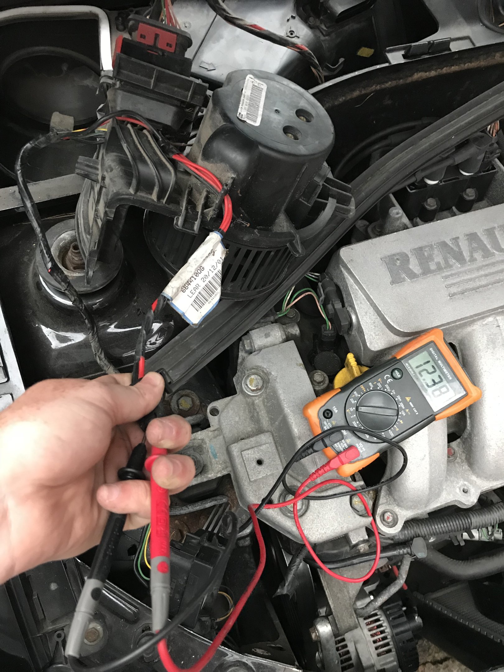

Multimeter came out and had 12v at the resistor and also at the fan blower.
Fiddled around and unplugging the motor in the drivers footwell brought it to life. So will replace these motors, no idea why it mattered but apparently it does. I thought they just control flaps and vents.
