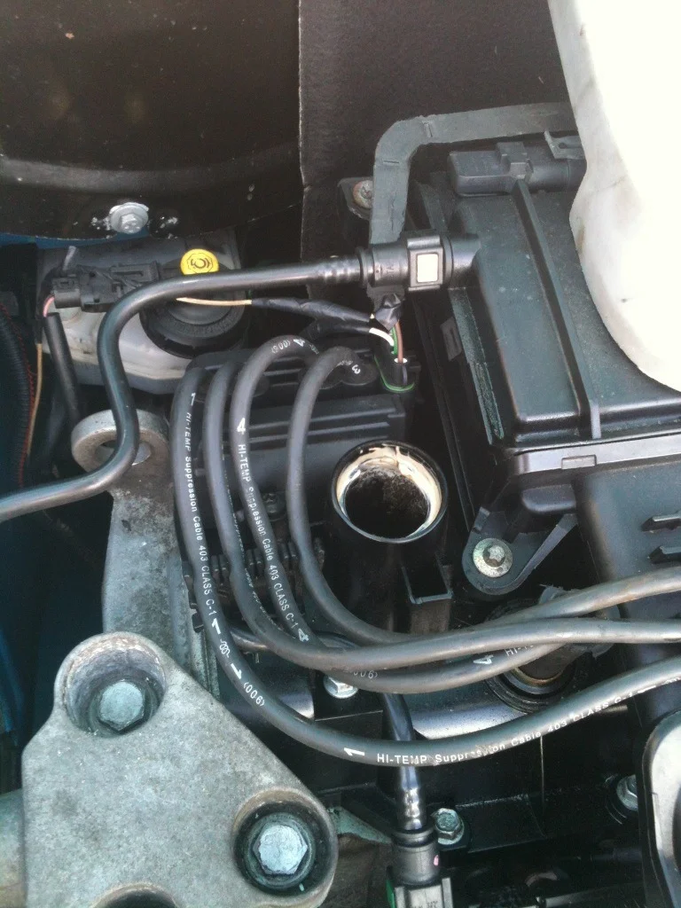

There also no excess gunk under the filler cap. From what people have been saying it's normal on 1.2 to have maybe half a cm worth. See pic.

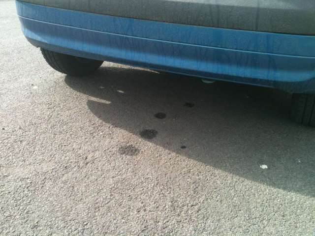

Went for a run to asda and noticed these patches when I returned where I was last parked.. You could say take it to the mechanic.. But I've got a feelin that they would try to fleece me.. Still not found a trust worthy one yet :p
With the potential it being the head they could see it as an opportunity.
This looks like a leak somewhere down the pipe work/ thermo?

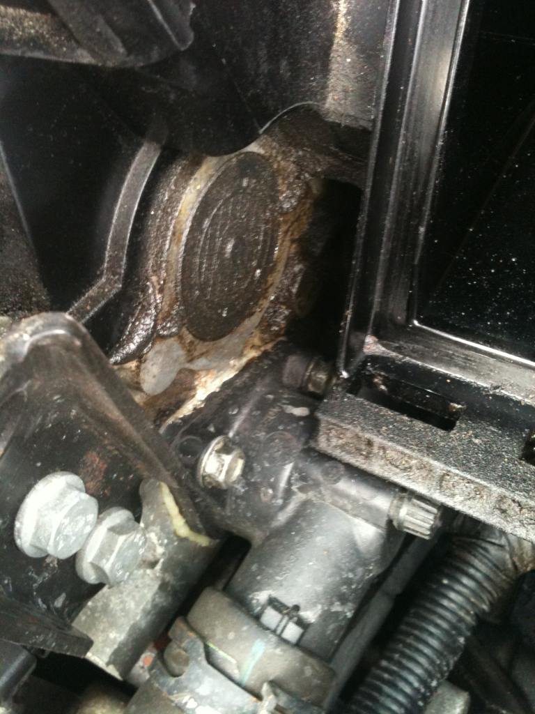

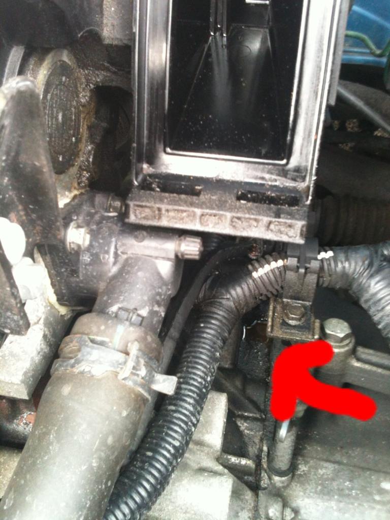

Took the airbox off today..
Looked under it and noticed a pool of what looked to be a yellow liquid in a nook on what i think is the gearbox?
And I've got yellow coolant So I can only assume it's leaking air in and coolant leaking out somewhere.
So I rubbed all around the pipes to see if I could find any liquid but didn't so tried running along the seems of the thermo housing and low and behold.. Found a flapping bit of the sealant stuff which is coated in a residue just like the pool on top of the gearbox. Weird....
