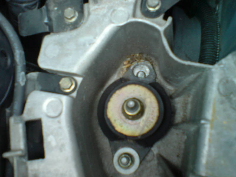

I've been having a knocking noise pulling away and when stopping, so I just took the battery out and noticed that the top bolt has sheared?
I'm guessing this is the reason for the knocking and creeking i'm getting when pulling away.
Will I be able to get a garage to drill out the bolt, re-tap the theard?

unbolt the other one, then unbolt the battery tray (4bolts from memory)
then you should be able to unscrew whats left of the bolt

Clidge, undo the battery terminals, then look down the right hand side of the battery and your see a grey bolt/torx which clamps the base of the battery, undo that and rail attached to airbox.

Dan, they are just nuts and bolts. Knock the old, broken one out and get a replacement.
I changed them on my Sons car as they had worked loose, I used "nylock" nuts to stop this happening again.
I have titanium bolts in this as its happened to me a few times previously

Its relatively easy to push the new bolt up from underneath and put the washer and nut on, but its a whole lot easier if you have another pair of hands to help you.
I did it on my own so I know its not impossible.
I don't remember the size of the bolts Dave, I just found some new ones from my spares box that were the right size and length, from memory they were about 50mm long and probably M8 but check, as I am not sure.

update. ive tightened up the gearbox mounts as the 2 screws were slightly loose and its sorted the knocking problem i was happening on the near side, the only one ive got left is on the drives side but im putting that down to the top engine mount that is visably bent! so thats next on the agenda.

13mm socket for the nuts and the bolt holding the battery clamp down.
Unless your like me and it has already snapped. :(
