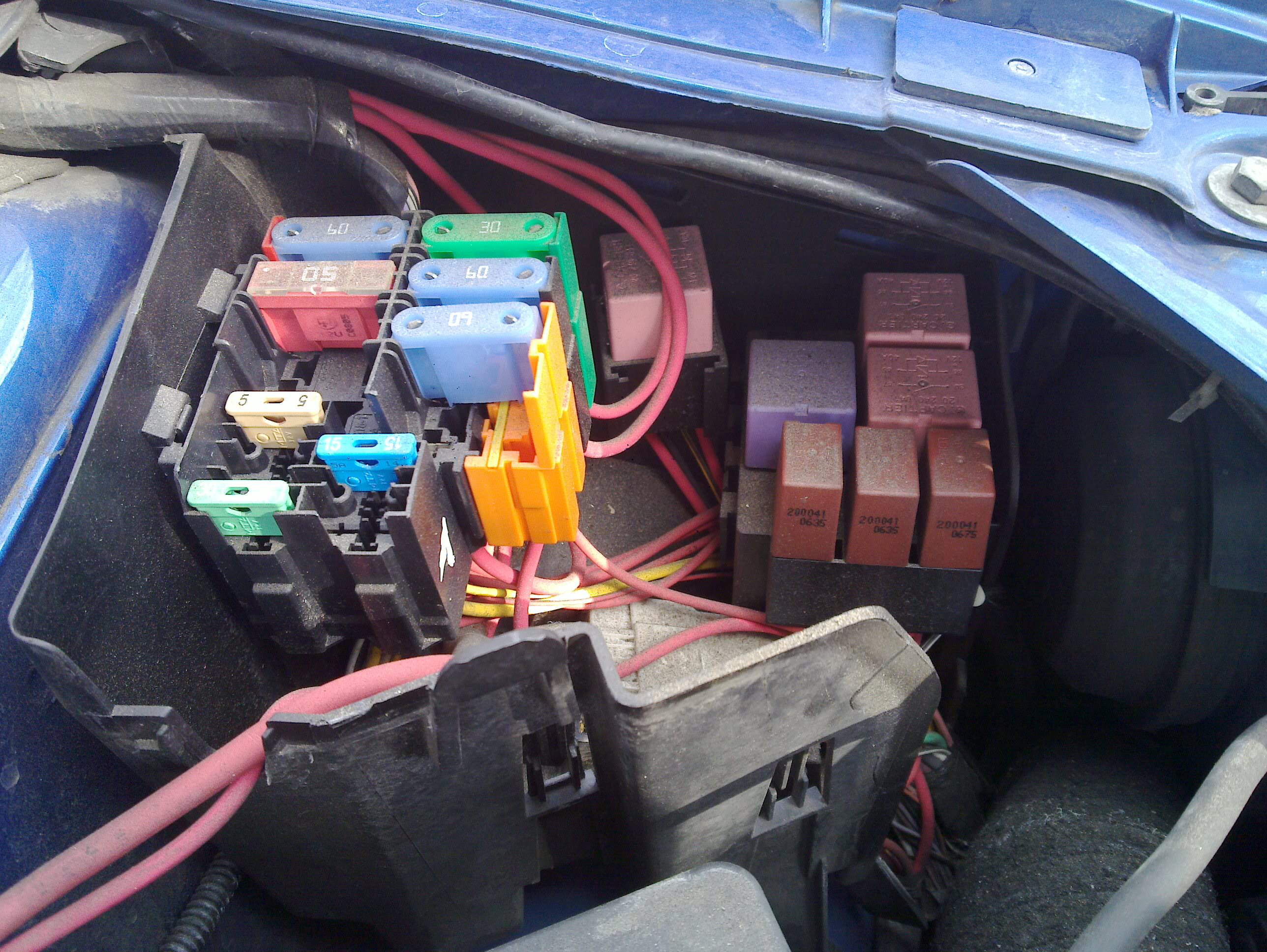

checked the fuses and its not them
anyone got any clues what these fuses and relays are for?

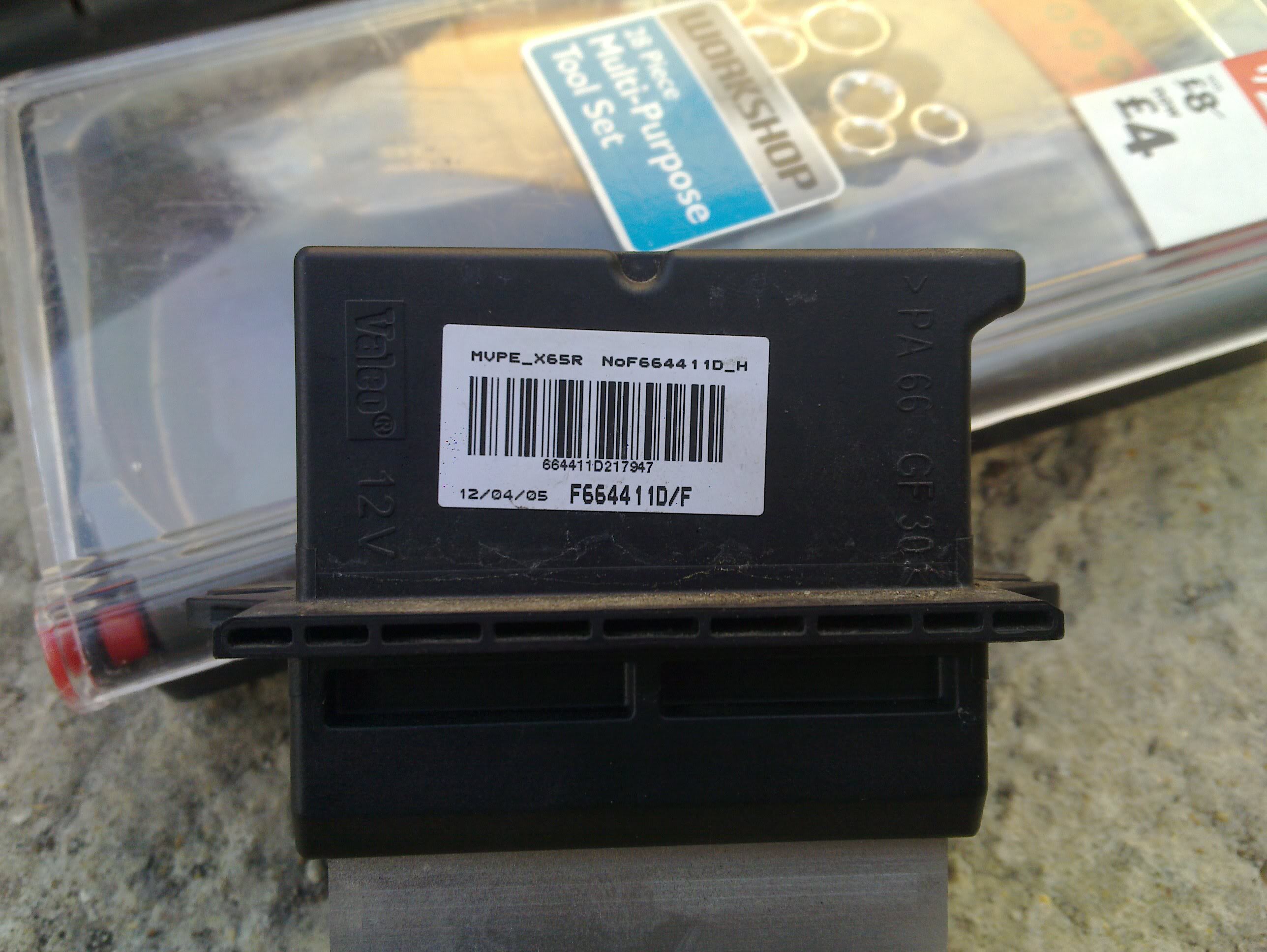

Think that there is some kind of resistor under the scuttle panel. Often fails due to water damage. There is a thread in the common faults/fixes section I think. Replacement part is around £35 from renault.
  french bit of tat
i would bet my wang it is this, mine went a couple of months back, ordered one from clio spares and fixed in ten mins.lift the scuttle on the left and it is the big connector on the right.
you can bridge 2 terminals out and get it to work to prove it is this. cant remember which ones though. do a search.

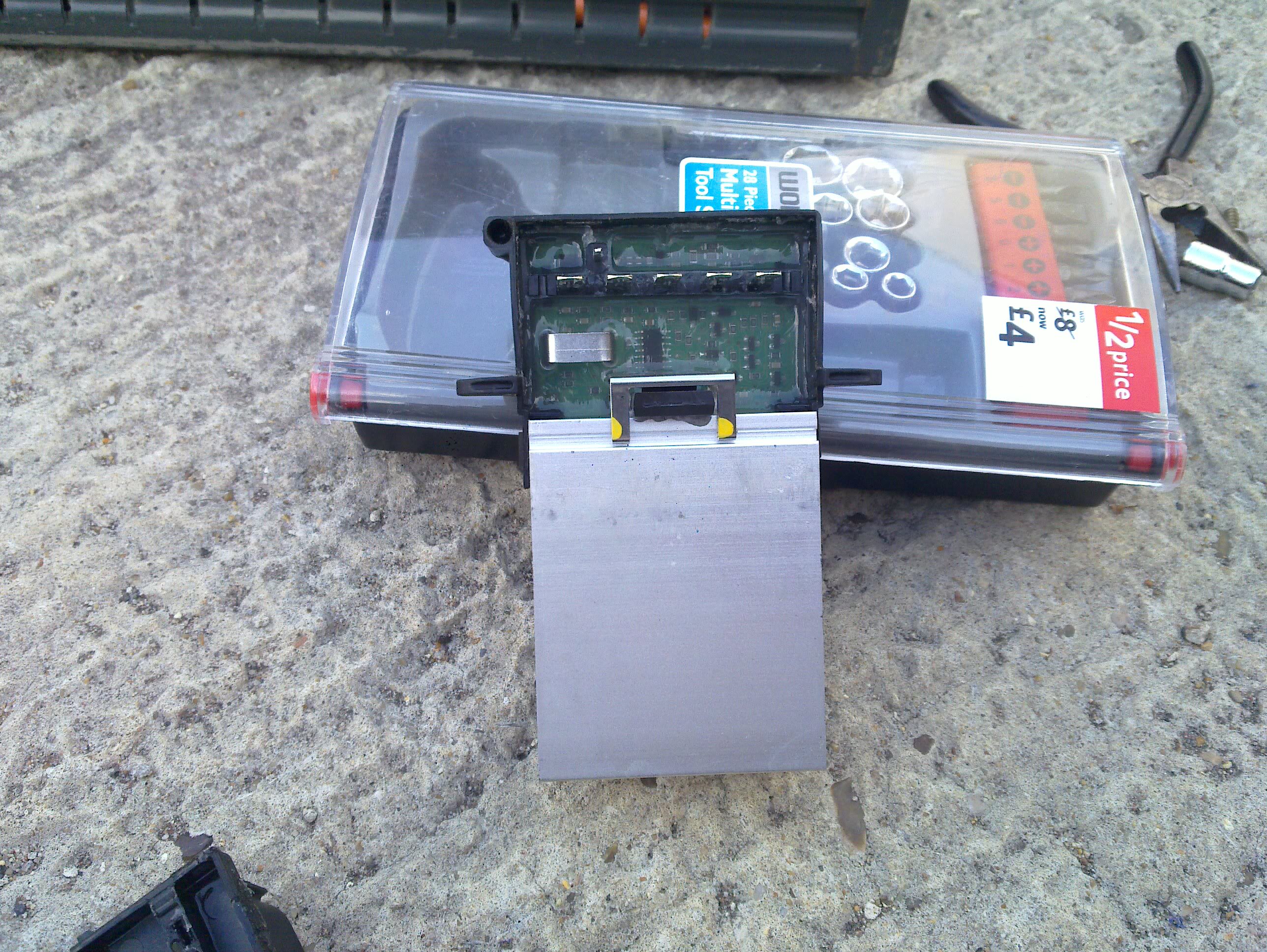

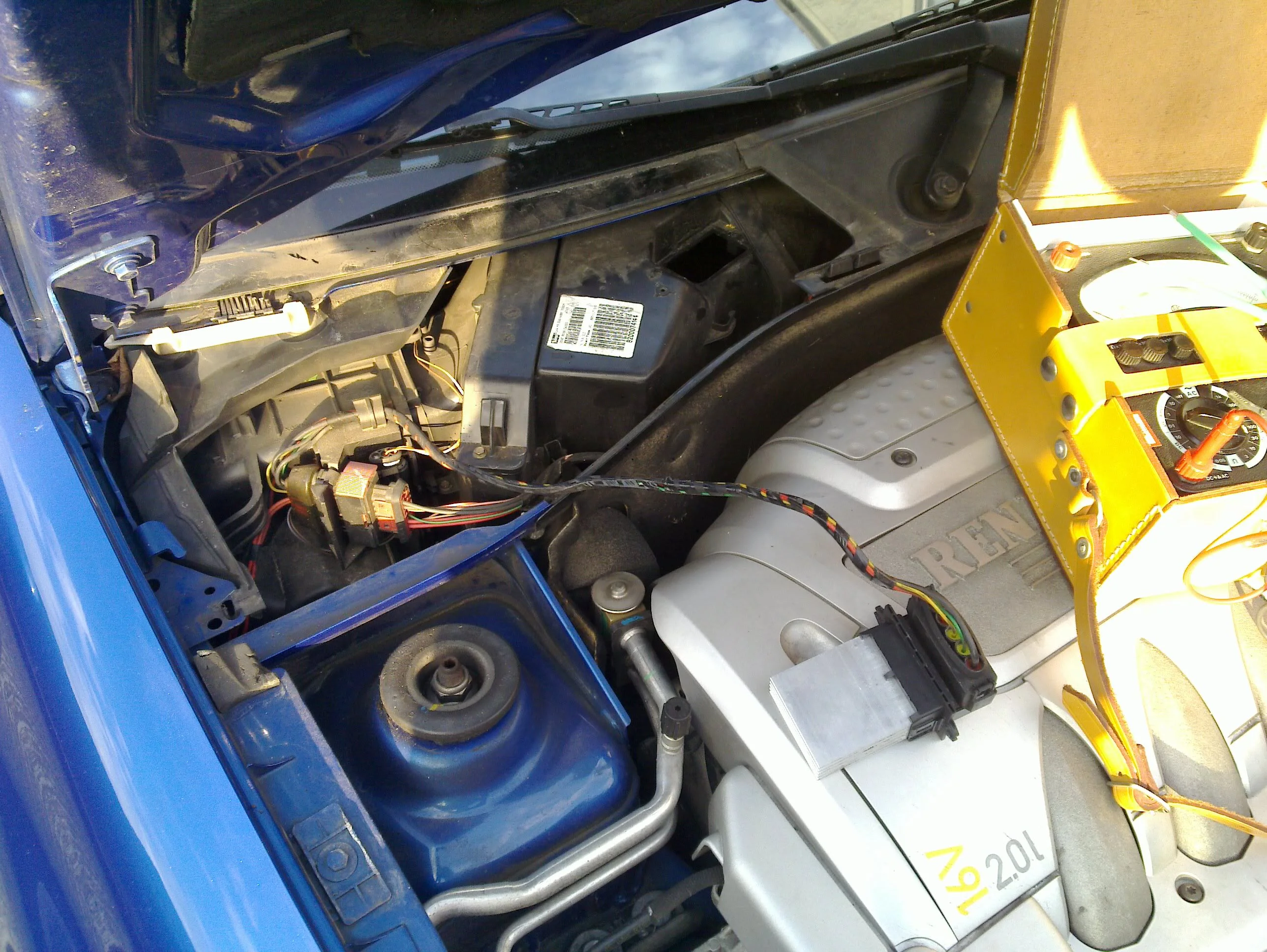

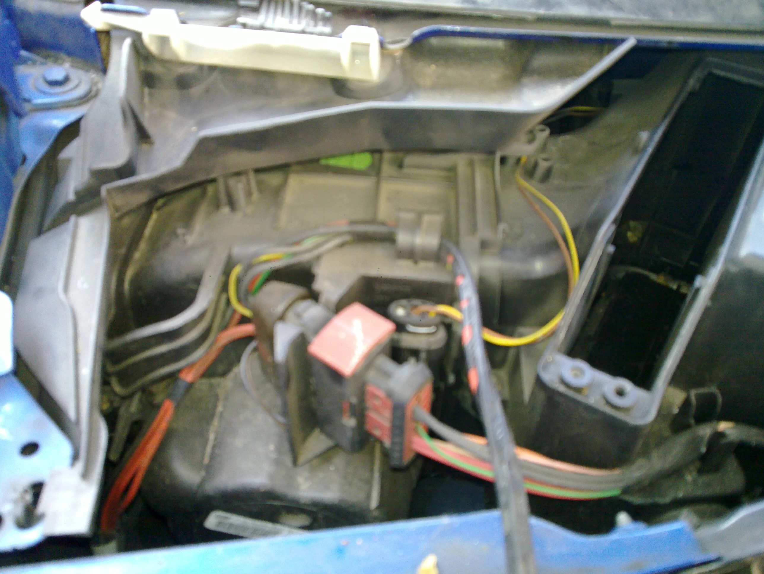

ok i replaced the transistor on the resistor pack and ive gone from dead blowers to a small amount of air coming out which is a start i suppose.

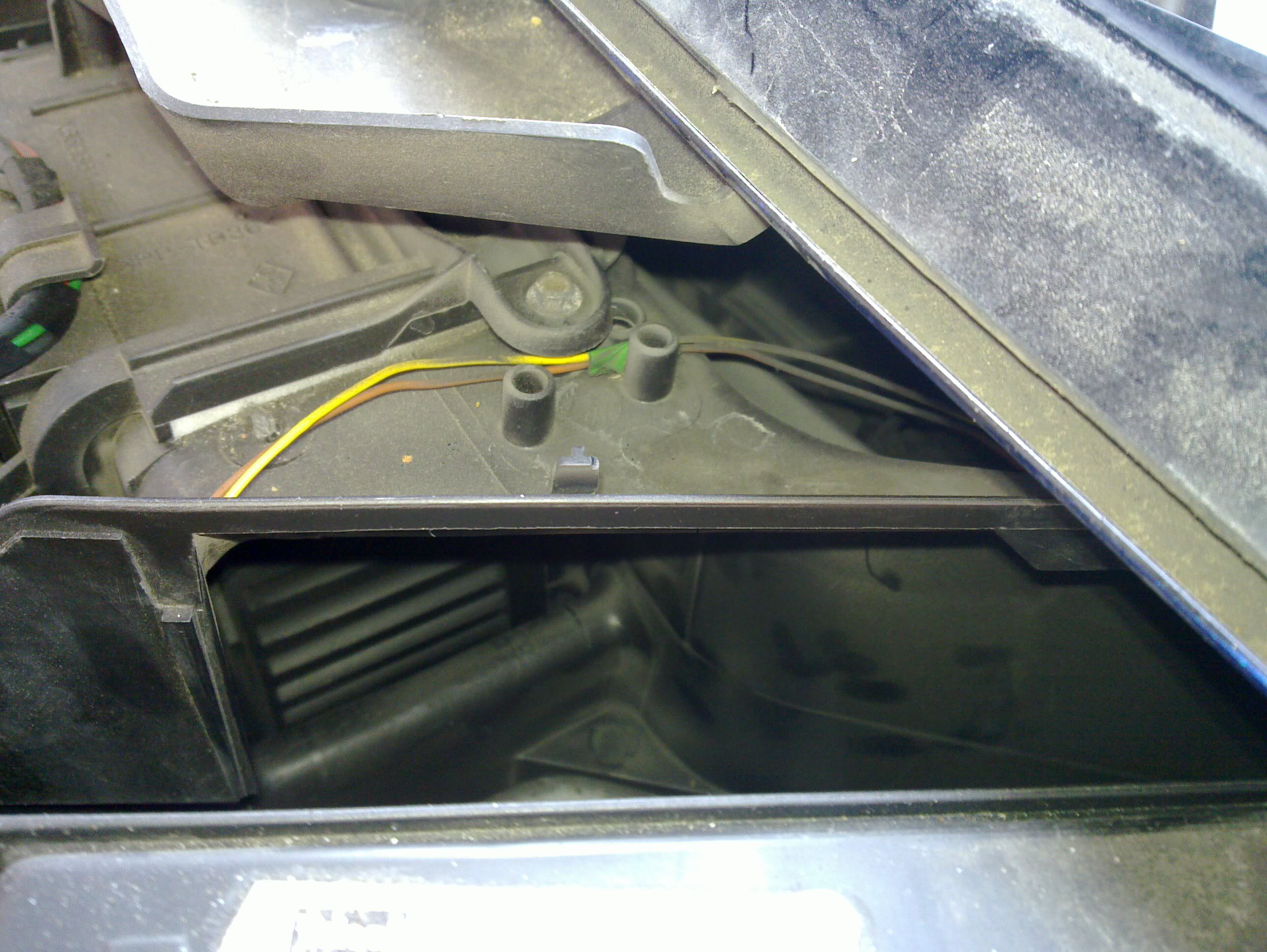

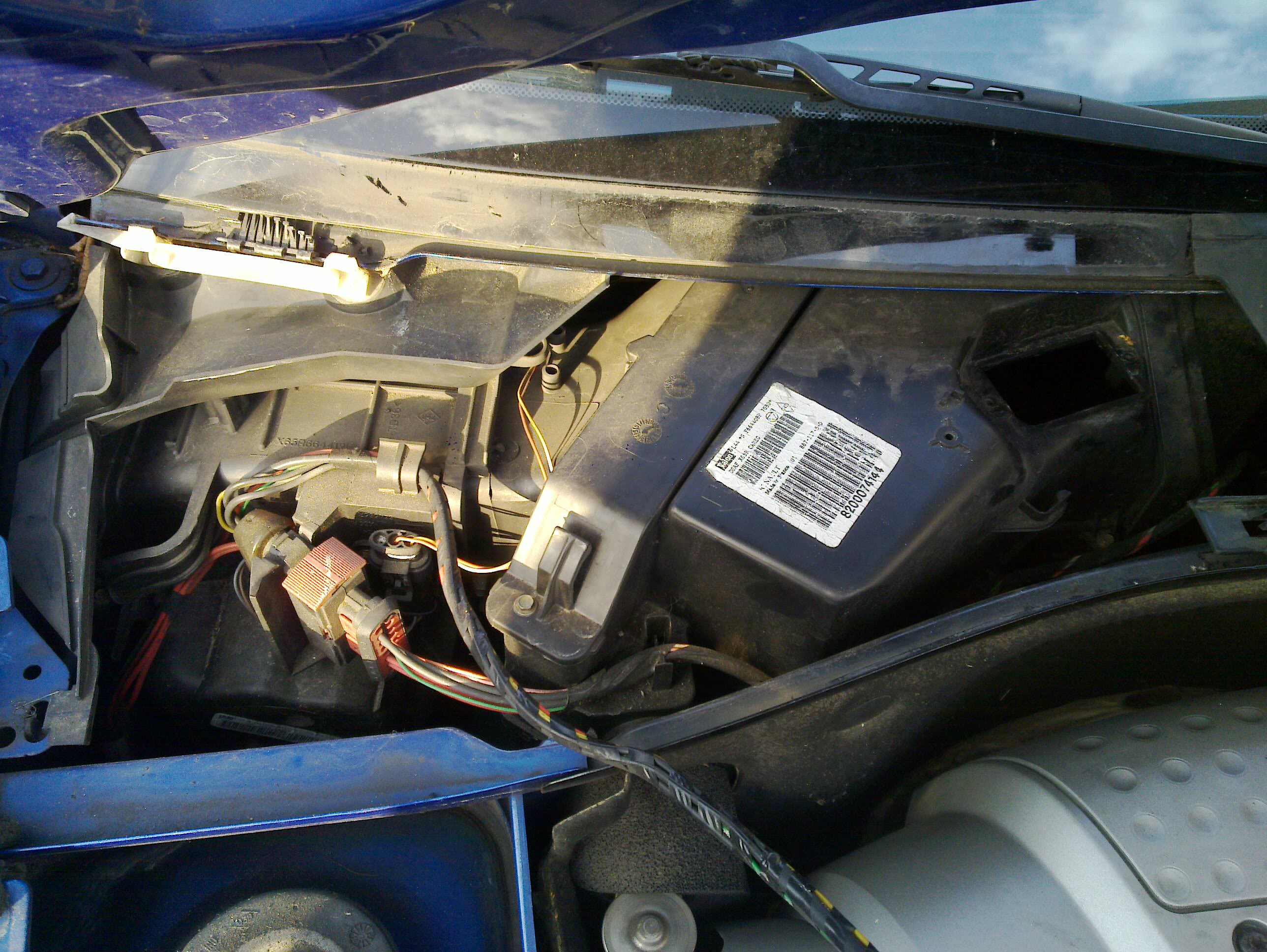

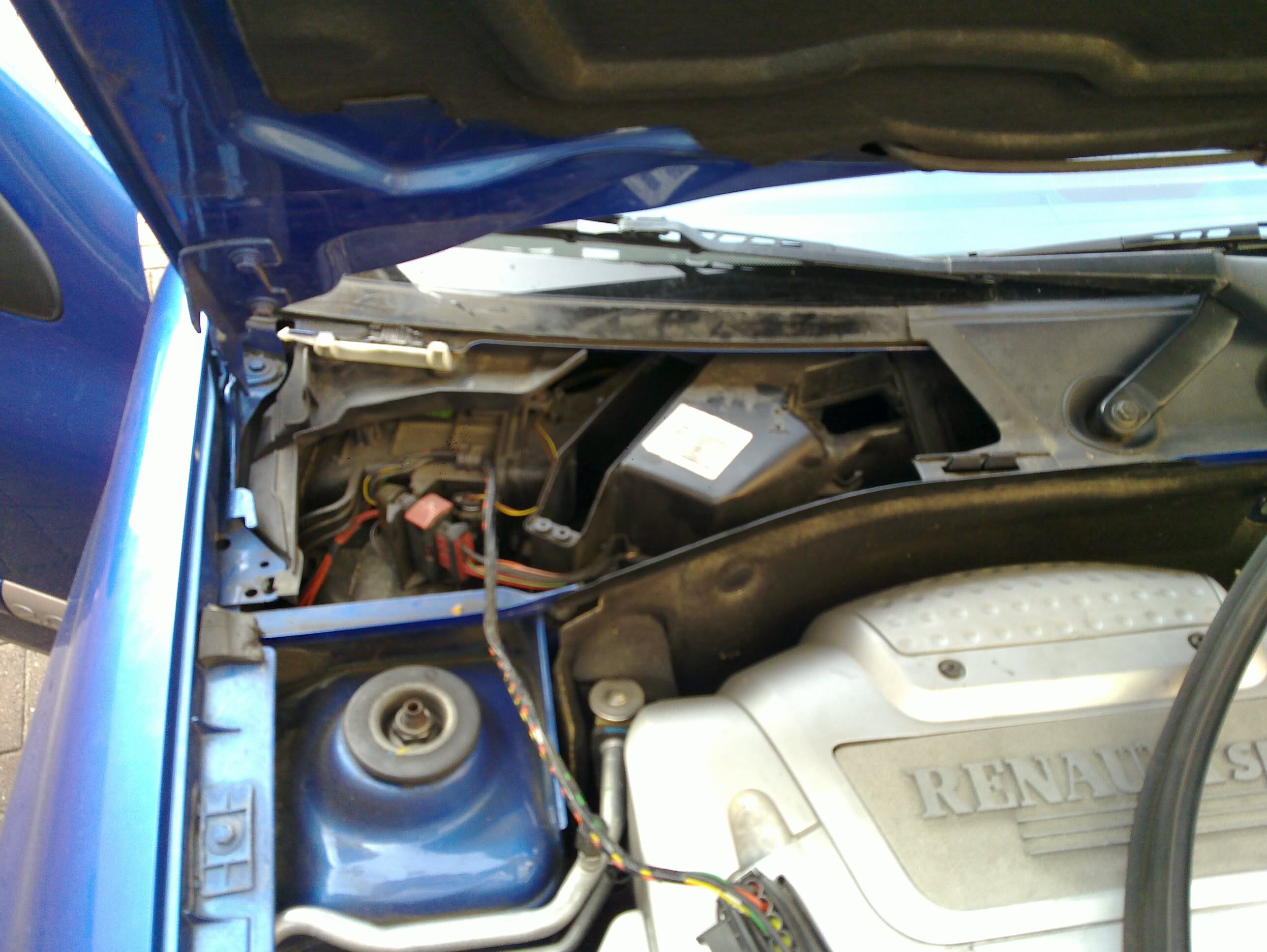

where is the fan located on the 182, i need to check its not stuck or blocked?
am i looking at the right place on the below pics?
if so how do i get access to it?
im assuming the filter ive taken out here is the pollen filter?
im assuming this is the fan?
how do i get full access to it?
  clio
first u need to take the water catcher off where the white clip is at bottom of window driver side after thats off you can see 2 x 6mm bolts take them out and fan should just slide out and theres a black and red wires going in to it
