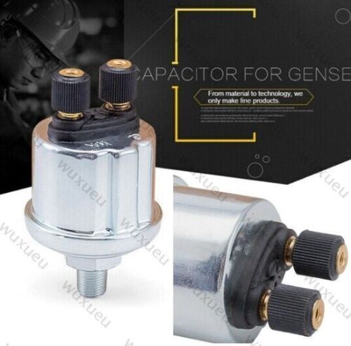

Two years ago, I installed a "Dragon Gauge" oil pressure gauge (It was complete with gauge and sensor unit) in my car.
It worked very well!
Until after nearly a year, the sensor blew... (It leaked oil from the other side, where the cable was).
I bought a new sensor unit (I will link it below), but I can't manage to get it working.
-The gauge is turning on and reads hot (100 psi), but if I ground the signal, it reads cold (0 psi).
-The sensor is grounding, so it's correctly attached.
When I turn the engine on, the gauge reads cold.
(If it wouldn't ground correctly, it would read hot).
What am I doing wrong?
