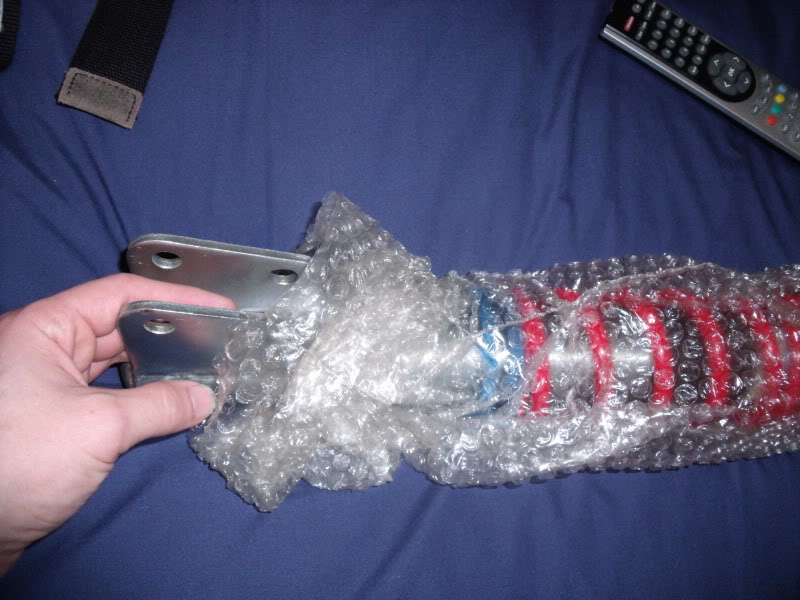

I recently got some Vmaxx coilovers in a group buy.
But went to fit them the other day and the bracket is wider than the bit it fits on too.
Shown where my finger is in this picture, the gap is 28mm, but the bit on my car (don't know the name) is only 23mm.
What I want to know is I'm I better trying to get the correct ones, if this is possible.
Or can I get away with putting washers/spacers in between the gaps?

hmmm that doesn't sound right!
I thought the "upright" part of the hub where all the same width? (although I may well be wrong)

Does the rest of the unit look as though it will fit?
As Gray said, I'm pretty sure all of the MK2's have the same dimension for that part of the hub (?), never noticed any difference on any that I've lowered, are you sure they are the right set for a clio. Might be worth checking the part number with someone Vmaxx or someone else who has them?

Everything else seemed to fit, bolt spacing was correct and the top mount bolted on correctly.
Will try and find someone else with them to give them a check.

The width of the hub does very across the models, along with the bolt spacing.
The part no on the strut is 60RE02/xx - with xx being the bolt spacing - this can be 52, 54 or 58mm depending on which of the 3 versions you have.
It does sound like you have the wrong struts. As you bought through the group buy, speak to Speedbox who I am sure will help resolve that.

I dropped an email to Speedbox (organised groupbuy) who have confirmed I have the wrong front struts.
Just waiting to hear back. The part no. on mine was: 60 RE 02F/54
So the bolt spacing was wrong too as I need 52mm, which is what I asked for.
Will see what they ask me to do next!
