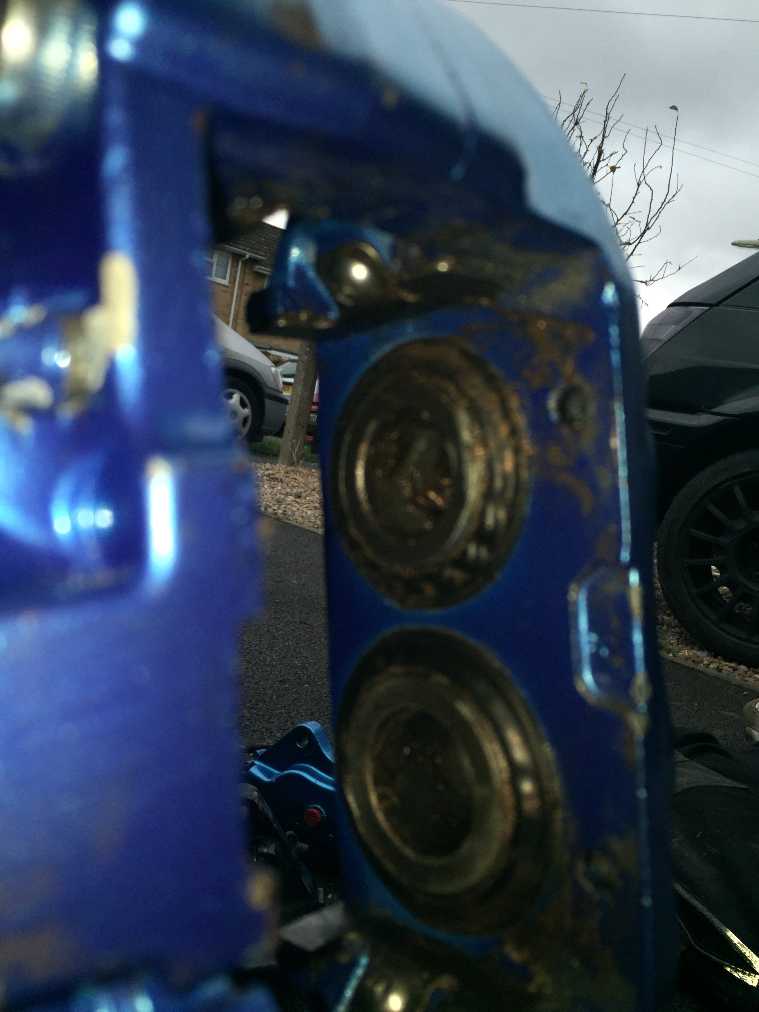

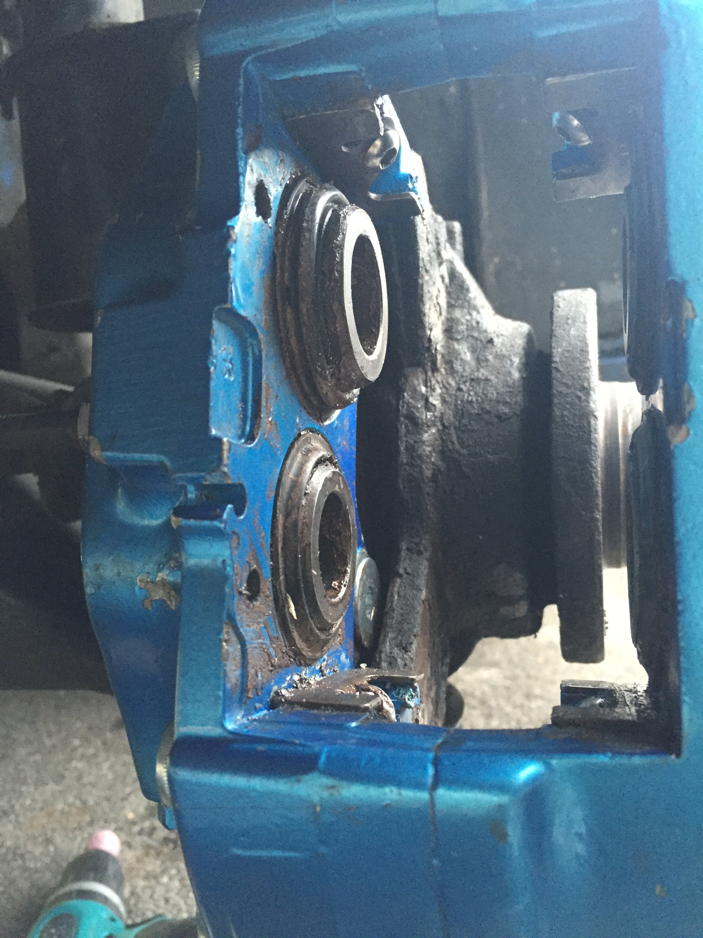

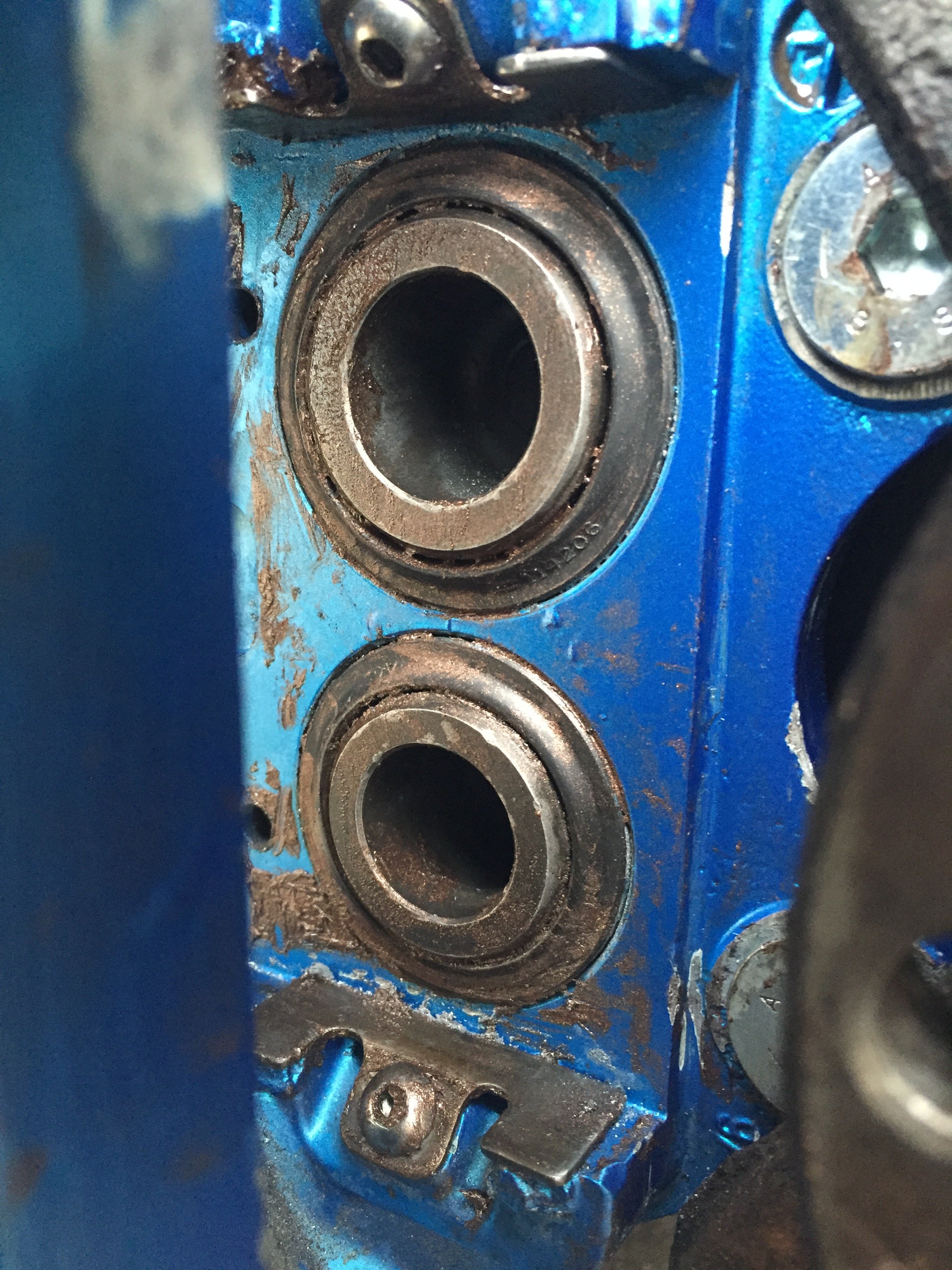

The picture is of the passengers, side both of the caliper first one the lager piston is at the top the lower picture the larger piston is at the bottom and there the same as the other side vice versa but the drivers side isn't make and noise

  182
300mm discs and 406 calipers on the motex brackets?
The outer edge of the disc fouls the inner of the caliper. And gets worse as they heat up, once the tiny bit of material has wore away in the caliper the noise will go. No problem imo with those caliper pistons (bar the dust seal)
Fit them back on and give the brakes some stick and and heat them right up. Dont worry about the scraping you will get as its just doing what i daid above.
