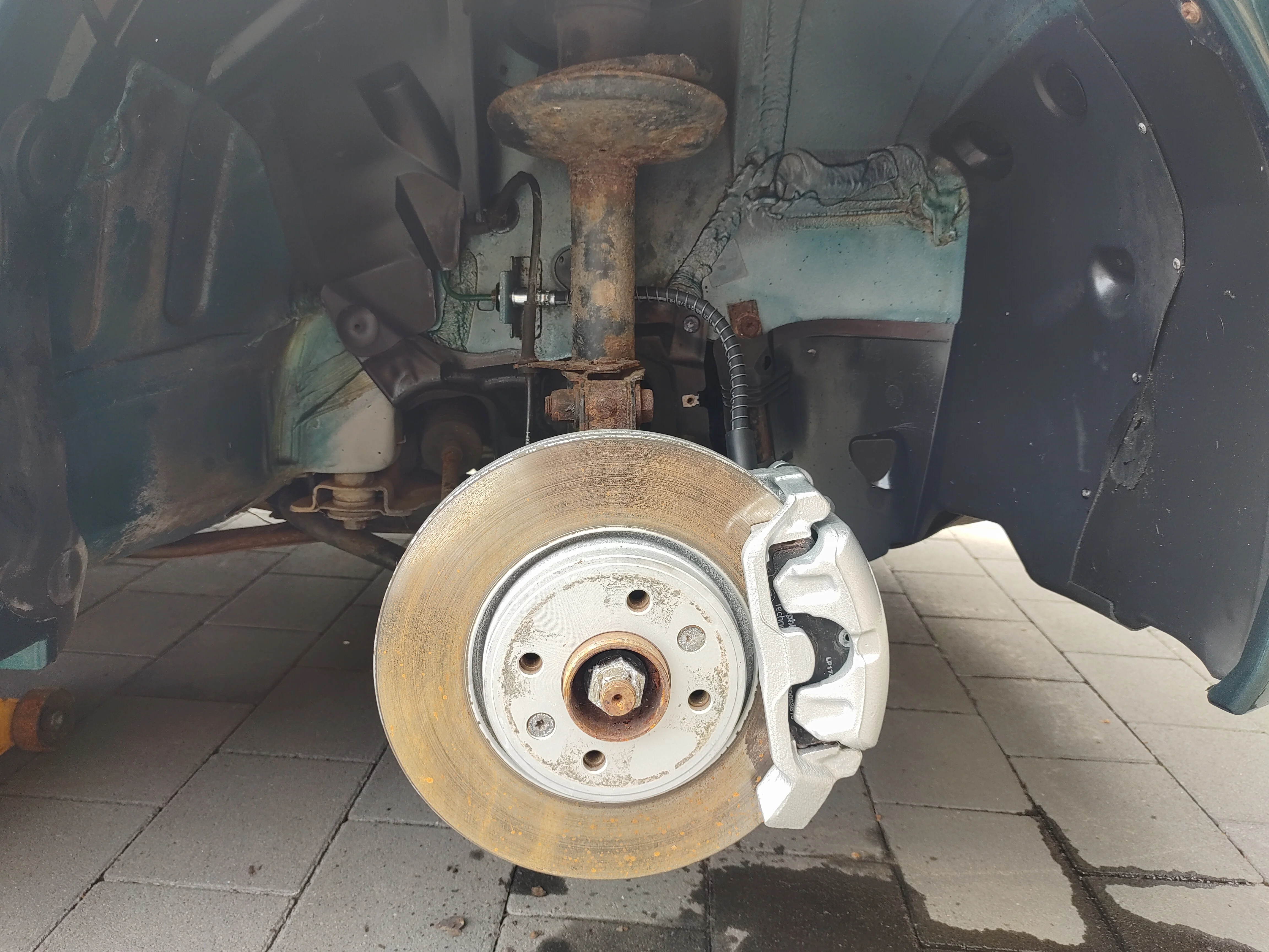

  clio 172 ph2
Alright, first of all, thank you all for the input.
I think ill go with rebuild calipers from Bosch on autodoc.
They are not to expensive and look the most like genuine calipers from renault but rebuild and from a company i trust.
